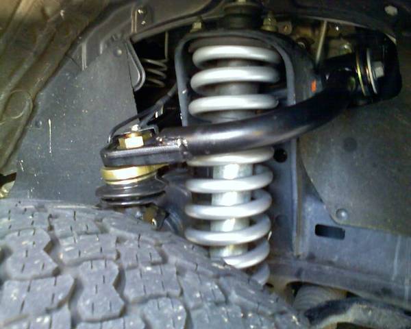

    I have the Light Racing UCAs and the Toytec adjustable coilover. I like everything so far. Be aware that it's possible to install the LR UCAs wrong. If you look at this picture notice the gold plate just under the control arm. The way it's set up here is backwards. The flat side of the plate should be facing the wheel whereas on the two pictures below, it's facing the coil. If it's set wrong, you won't get a good alignment out of it (camber will be off).
    These are set wrong:
    This one is set correctly (the lettering is on the flat side of the plate, toward the wheel).
