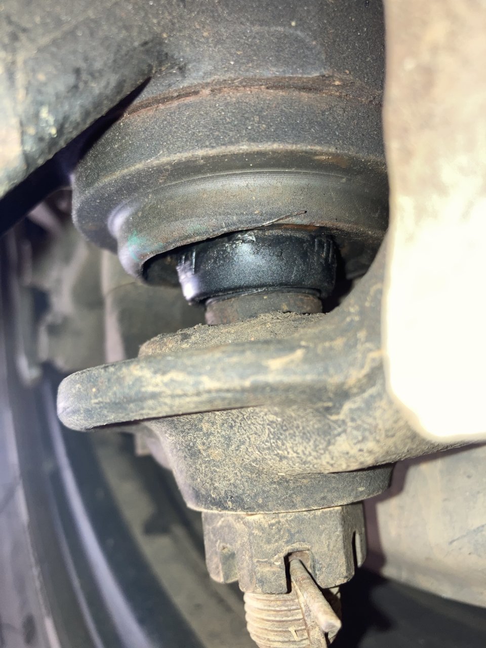

    Is this the low-profile boot that hugs the stud pin?
    Kinda unexpected because the $$$$ Dirt King LCAs use the same Moog ball joints:

    That's what the lowers I installed look like. They're supposed to be a solid design update from the information I found.

    Yep those look like the same type of low-profile boots. That sucks.
