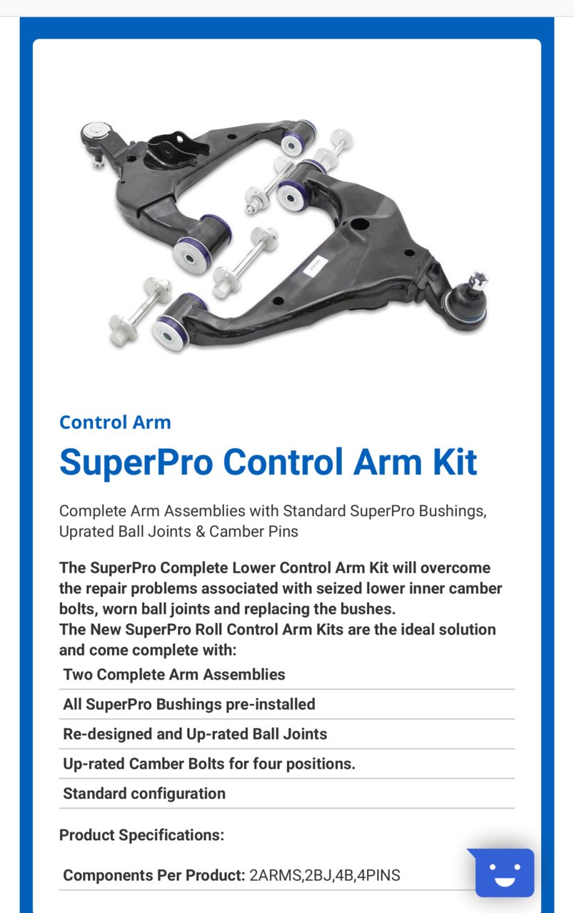

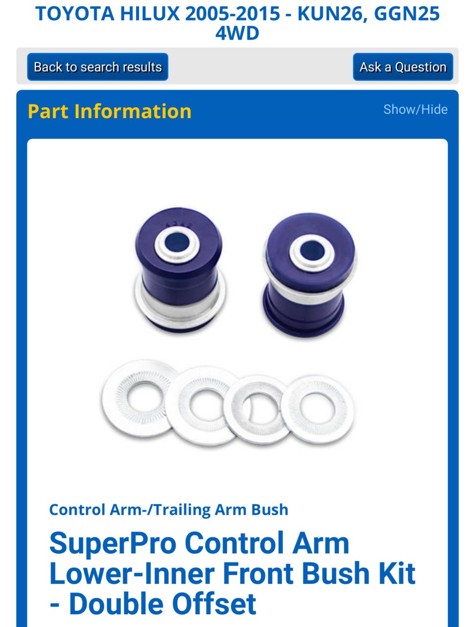

    Thanks for the input guys! Has anyone tried the double camber offset bushings for additional adjustment. From what I've been reading it looks like mainly the Aussies use these. I checked the part numbers and the Toyota Hilux LCA part number is the same as Tacomas, so the Hilux offset bushings would work on our trucks. Anyone have experience with these?
    https://superpro.com.au/show-product/superpro-control-arm-kit/orphan-TRC471
    https://superpro.com.au/find/superp...25-4wd-/productnr-SPF4342K/cid-999501237/vid-

    Any one have any experience with these offset bushings? The whole assembled LCA's with standard or offset bushing and ball joint, shipped is only like $500. Just having my the LCA's already setup with polyurethane bushings and new ball joint is worth $500. But the double offset has me intrigued. combined with SPC UCA's you should be able to move the wheel further out and still get alignment in spec.

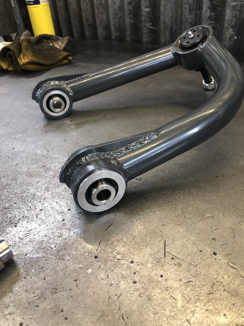

    I’m currently working on a sealed uniball conversion for the stock lowers at the moment. You press in a machined aluminum insert into the stock lower and then the uniball goes into the insert with dust seals pressed over. Very similar to what I do on the LT kits

    I found a post from a guy on a 4Runner forum that installed the offset LCA's. He posted the alignment printouts. They look pretty impressive! If I could verify that they would fit Tacoma's I'd order some!
