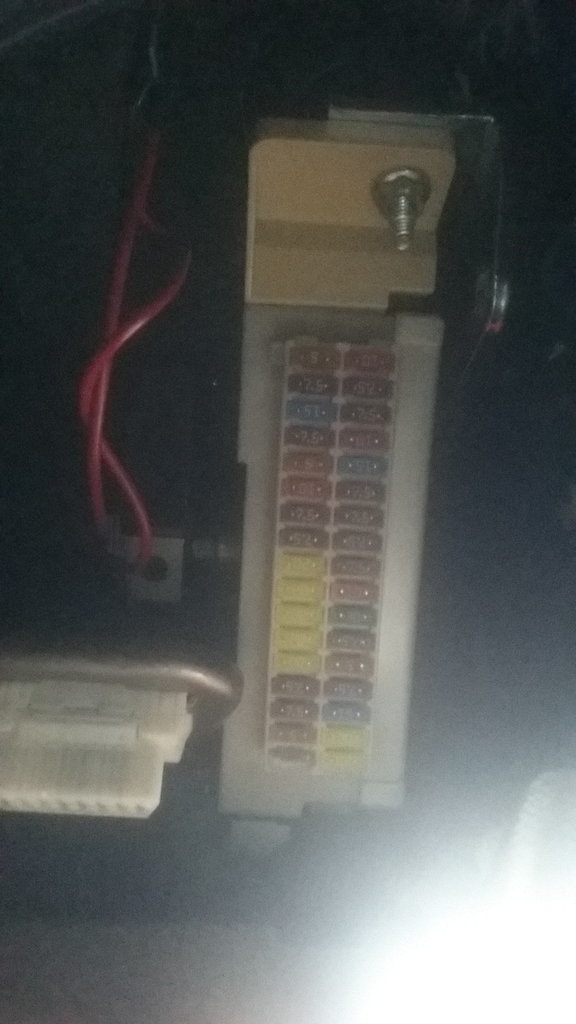

    Hey.. I want to wire my CB and old school days, I simply wired into fuse boxes like this. But is this still the way to go?
    Any suggestions on doing this? I searched the forum and didn't see anything related to this. Thanks.

    I'm at work and certain pictures don't load (I can't see what you posted) but the best way to wire a CB is directly to the battery. That way you can talk with the truck off and it's also the cleanest power source for transmitting.

    You can still do it that way with an add a fuse.

    Its not that hard to grab power right off the battery and you can sneak through the existing cable boot that the factory harness uses to pass through the firewall.
