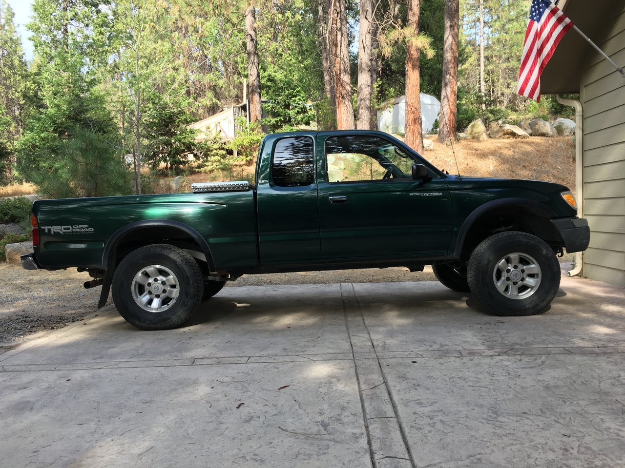

    My new ride! Back end to be addressed later!

    BUCKLE UP! It makes it harder for Aliens to pull you out of your Truck.
    Looks great!

    Nice truck! Welcome :hattip:

    Like your truck, what are you thinking for the back ?
