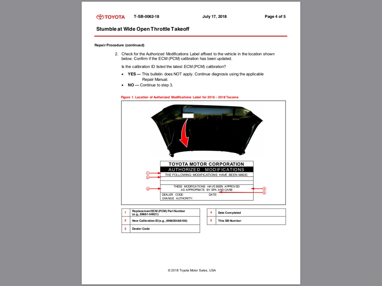

  15. Jan 29, 2019 at 11:14 AM
    #95
    Tacoma3rdGen
    Tacoma3rdGen Well-Known Member
    Nov 7, 2018
    #271933
    904
    New Mexico
    2018 Tacoma Limited
    This label from the TSB should be on your hood at the indicated position if SB-0062-18 was applied by dealer:
    JNG, cubie[QUOTED] and shakerhood like this.
