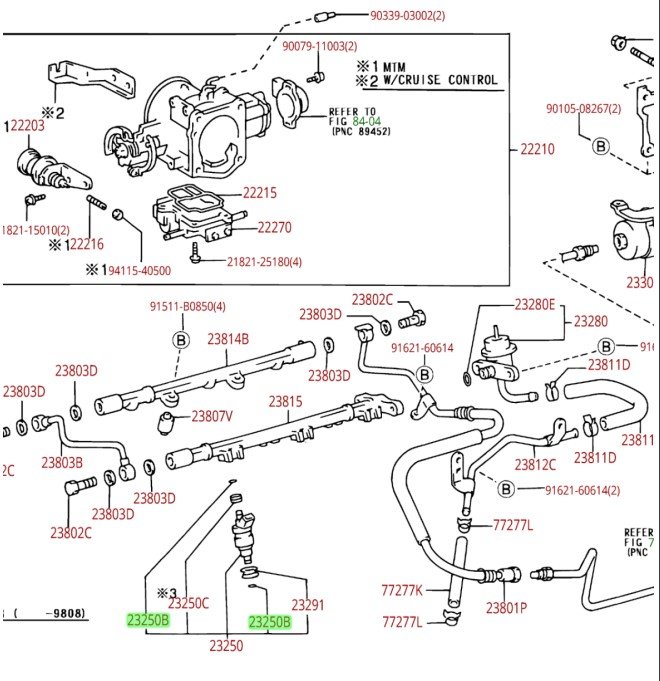

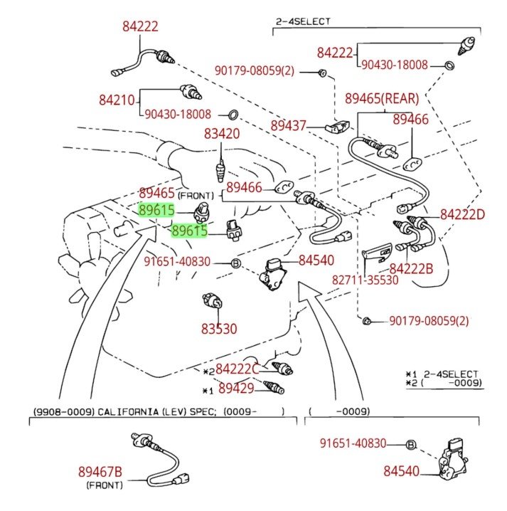

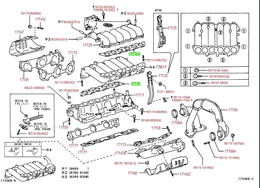

    Okay all, looking for a little more help here. The items highlighted in green in the photos are what I have ordered so far. What else was I missing?

    Copper washers for the fuel line banjos 23803D
    I'd be doing valve cover gaskets and cam plugs of they're questionable
    I don't see a throttle body gasket on there, can't remember if it has to come off from the upper plenum
    rluis05 likes this.

    Just like b_r_o said 23803D, since you’re there might as well change valve cover gaskets and plugs, also 17177

    Valve cover gaskets are not that old but I'll redo them again if I'm going to be in that deep. I'll get two 23803D and 17177 ordered.
