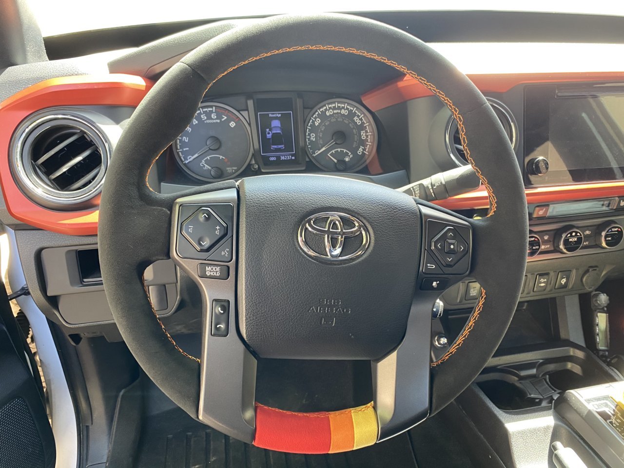

  6. Aug 2, 2020 at 1:04 PM
    #26
    Epic3rdgen
    Epic3rdgen [OP] Well-Known Member
    Oct 9, 2018
    #268872
    237
    A-A-ron
    2016 ACab OR
    +2 TC LT Fabtech 6’’ bracket w/4link on 40’’ KM3-s Raceline Wheels

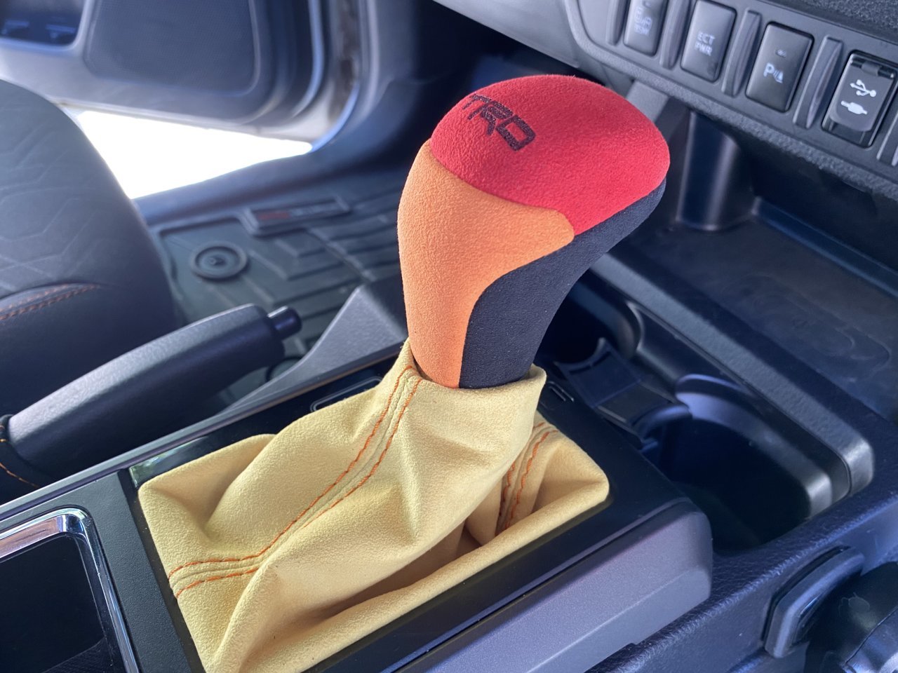

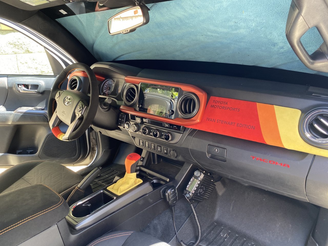

    BF76C599-C035-4E80-8EB5-67F1DA045DDD.jpg A5CA9D6E-773A-4C7D-9ABB-AFB6C1F08E82.jpg EC6FD846-7889-40BE-AE01-D1328C342A17.jpg Truck is back tougher! My sound system is the best! Thank you MR Marve! Just got the interior parts from Suade It.. Steering wheel ,Center console pad , passenger dash pad , gear shifter boot and knob , E-brake boot done in Alcantara. This looks so nice now I want to wrap all my interior panels.

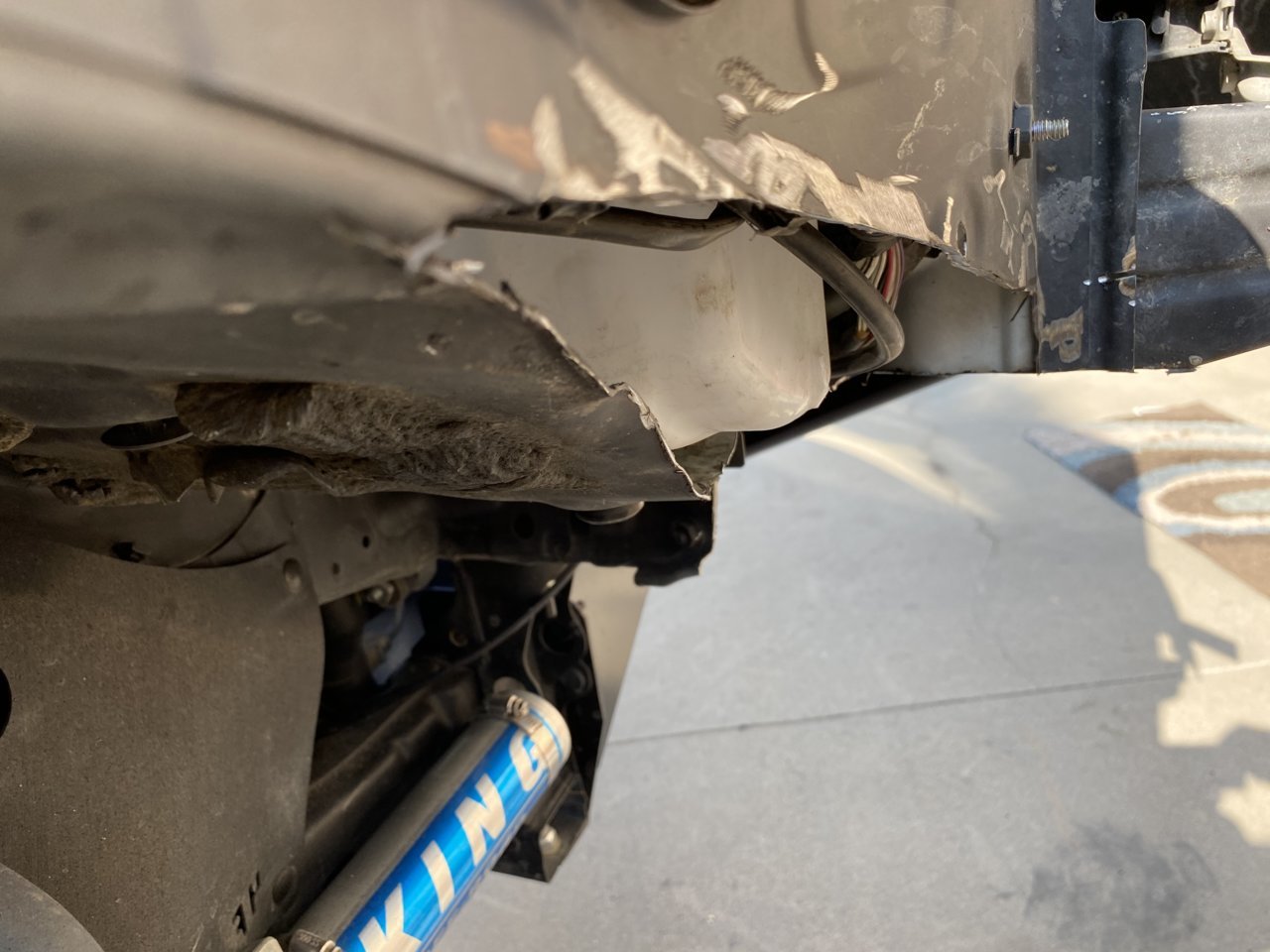

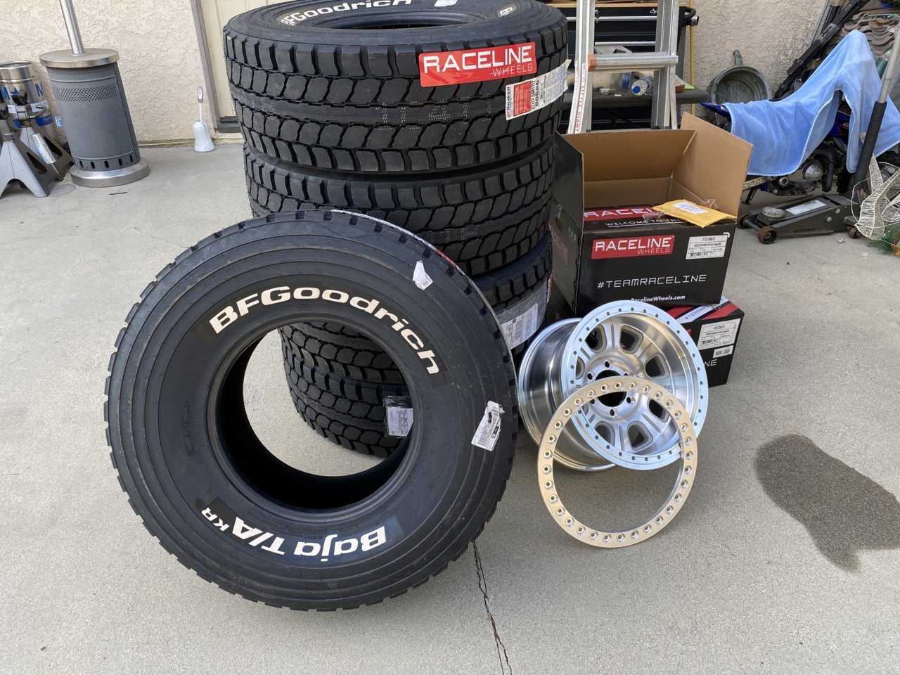

    385C5C49-4437-48DF-A187-7B272C2B7927.jpg 640B2883-6831-47BC-9033-2A64129711F7.jpg Ok no turning back im going to 37s. Looks like I’m doing some cutting and welding this weekend. BEB298DB-9361-492F-AF1F-7B75BBE9FFFF.jpg

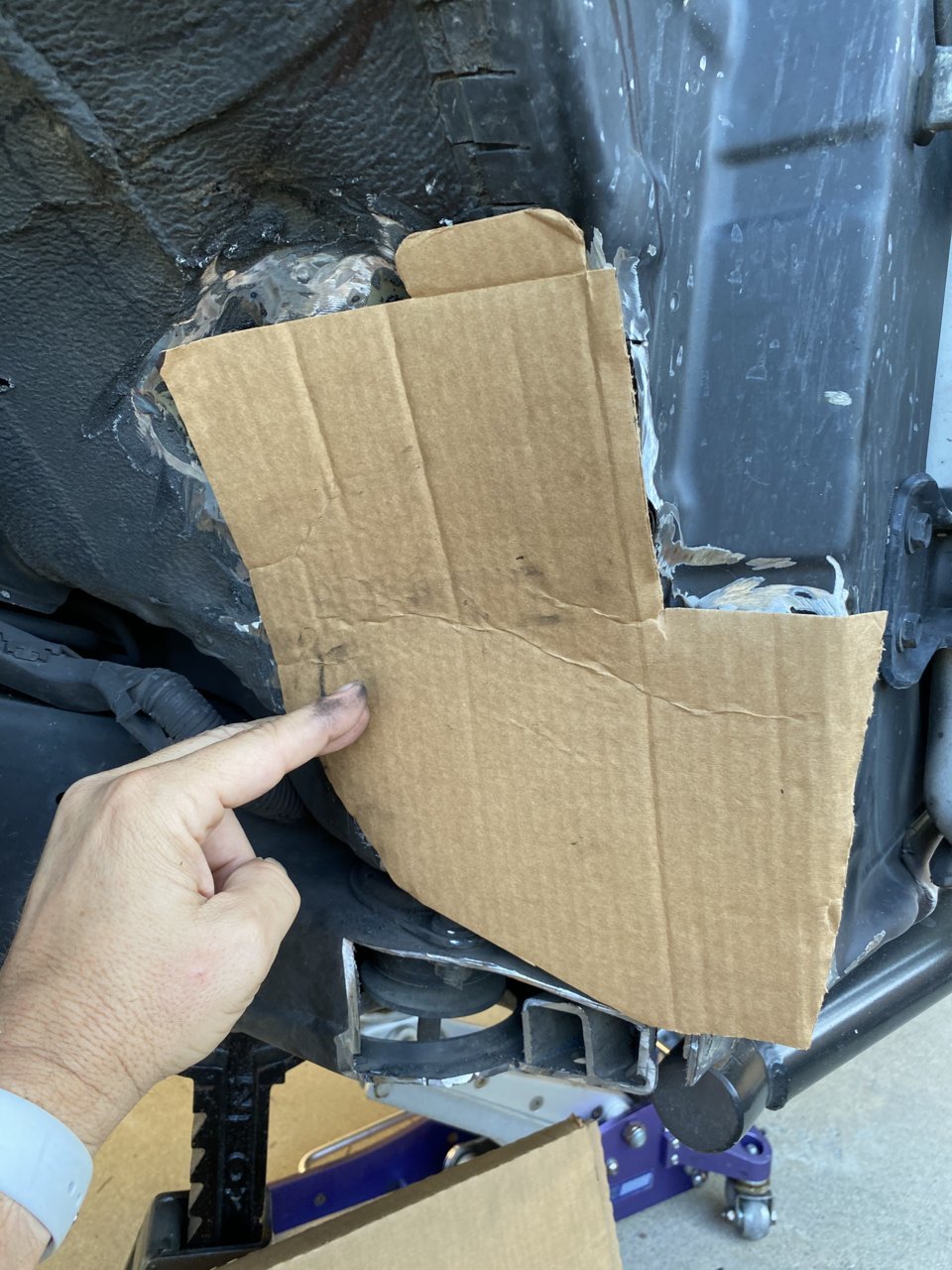

    985D83FA-798C-4CB3-B83D-88D5B34BD574.jpg 18614C18-436D-40A6-9B32-CCC09C699306.jpg 2B0206E2-A9C4-4FB7-B00C-5202645279D3.jpg Time to cut and make room 2F0C37C5-9B31-487B-A2F9-4E7A16FB47EF.jpg

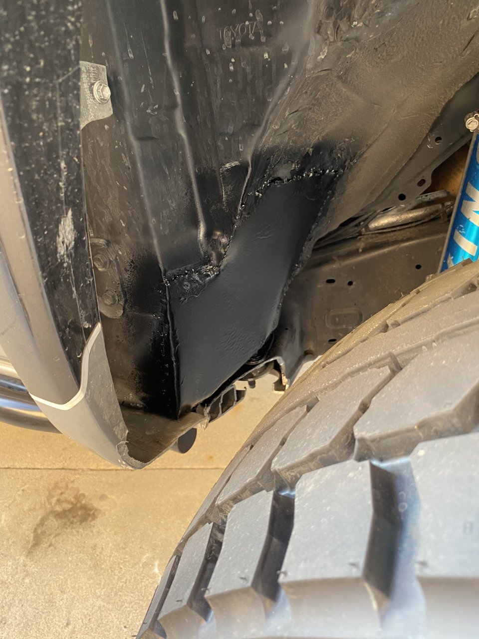

  11. Aug 26, 2020 at 10:27 PM
    #31
    Epic3rdgen
    Oct 9, 2018
    #268872
    237
    A-A-ron
    2016 ACab OR

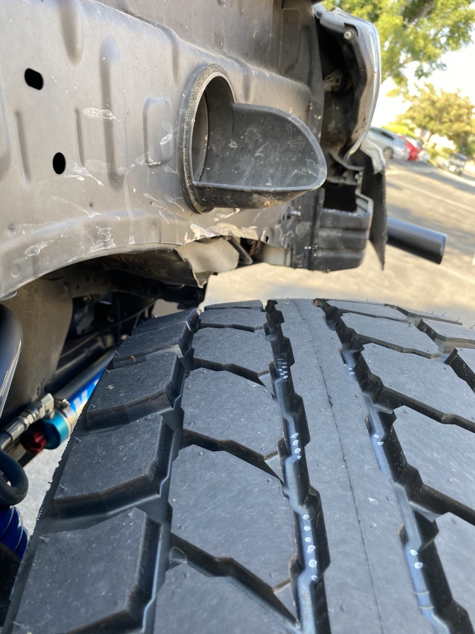

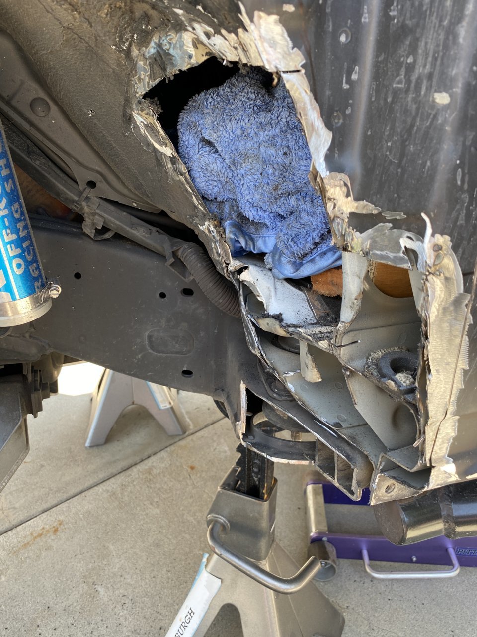

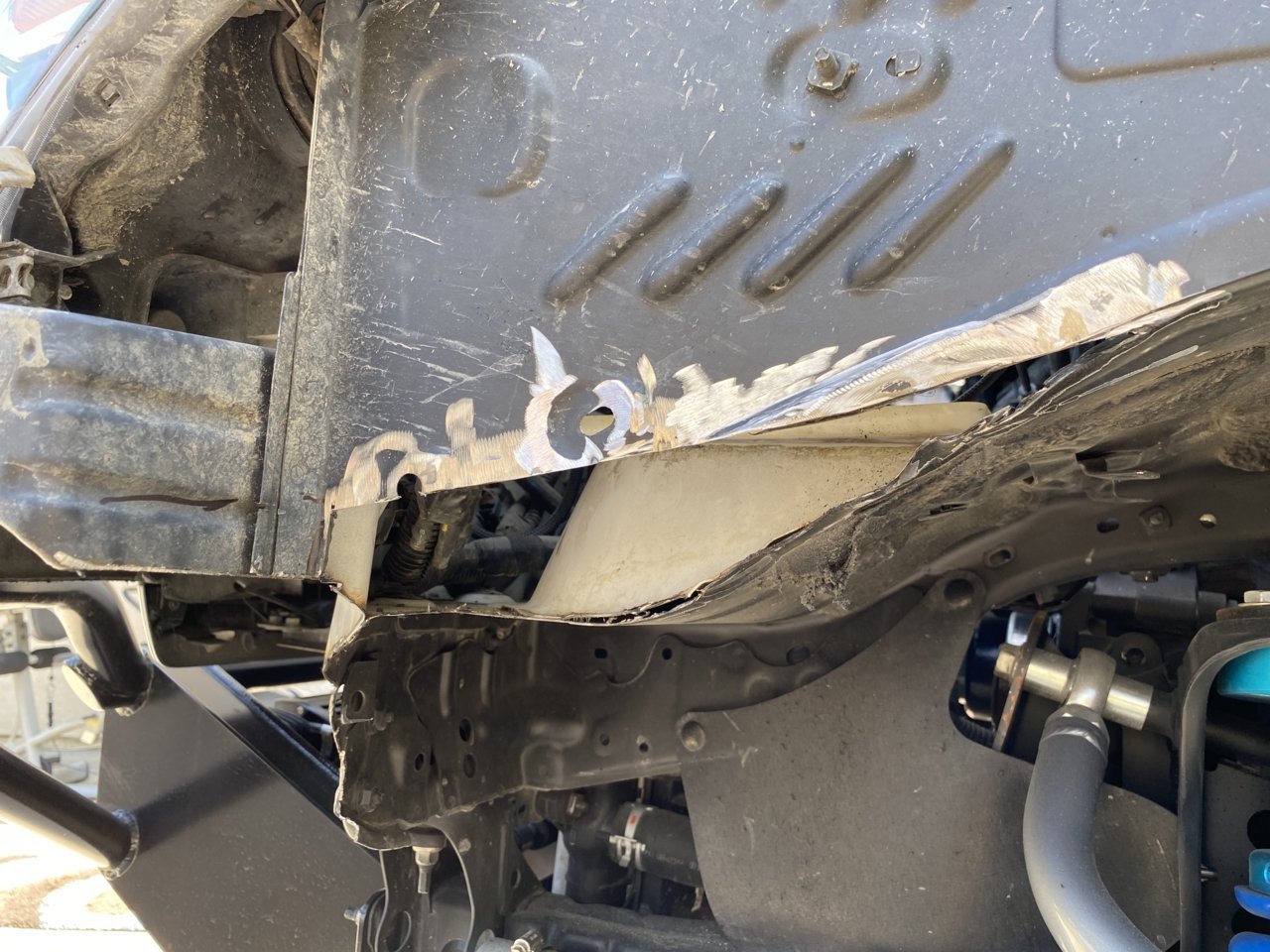

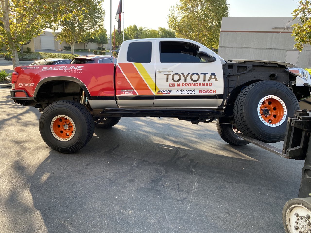

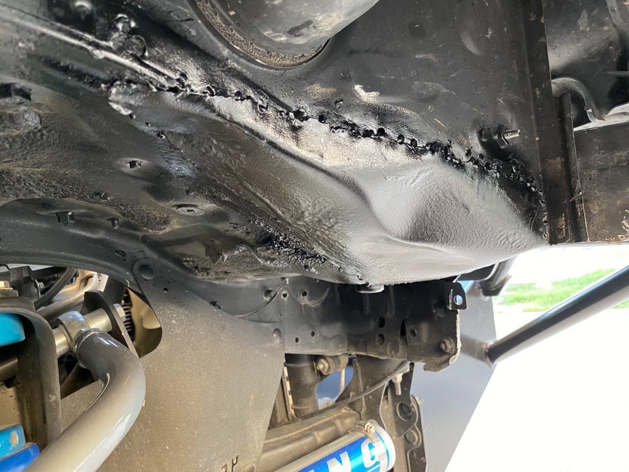

    F3E3A58E-9C76-4D94-9A2E-C869C32E8485.jpg C6ED5ED9-C969-4F33-BCF2-44958908C15C.jpg F8DBCB4A-3F12-4B8C-B679-FD1AABF4133A.jpg Ok so I have About 20 hours to do this mod. I started 3 fires in my truck. That insulation gets just a little heat and it ignites. So we jammed some soaking wet shop clothes underneath the upper carpet insulation. I’m glad that I kept the windshield fluid tank and just worked around it. Tested my truck at work at full stuff with the forklift and we’re all clear. I cut the patch pieces on a band saw 22 gauge and boom and 5 hours later.I was all welded up. 37s are no problem. 76F3935D-659C-4646-AD01-D21AF6E62C02.jpg

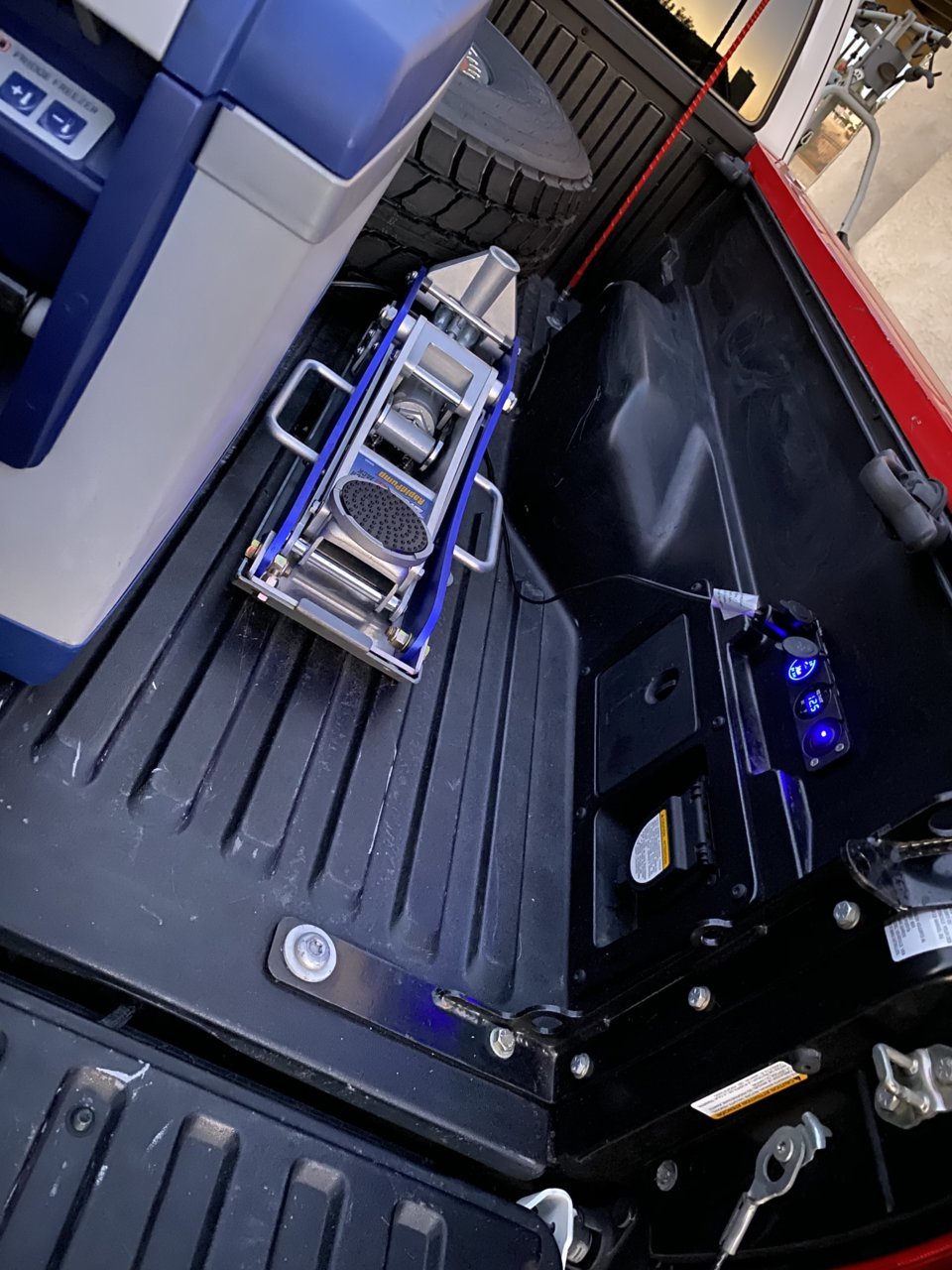

    4E5D9D4B-EE6A-4A8C-9B6C-CD7F2DA303D0.jpg 0921E36D-10E1-4B25-8B3E-0EDD54D15F63.jpg Got a Solo Motorsports jack mount and 2.5 ton jack. The stock bottle jack will no longer cut the mustard with 37 inch tires 931563C6-3463-4C65-A9CF-F72A815E619B.jpg

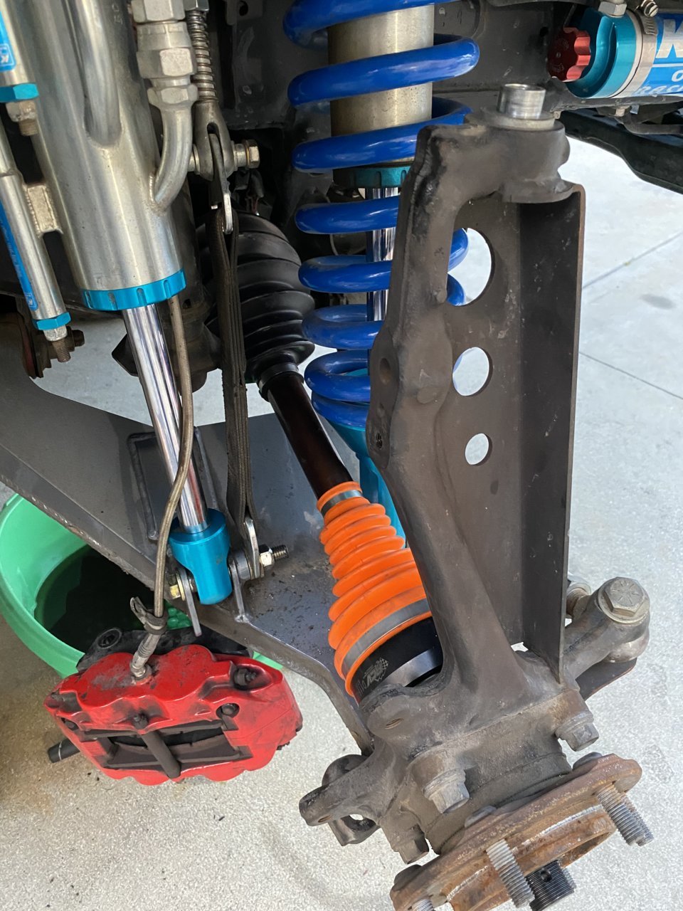

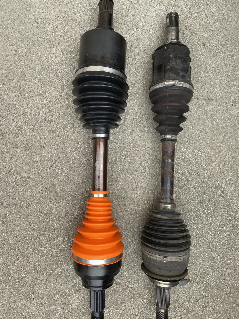

    DFD9702C-C00C-4A29-8178-798276361CD3.jpg 5A3D0C1A-933B-45C5-A311-664BB25CC6FF.jpg And today I installed RCV axles . Wow look how much bigger they are than stock. And the old ones are TC 4340 +2 cryogenic treated that spun all 4 37s on my Rubicon trip. Got these because ahh why not...

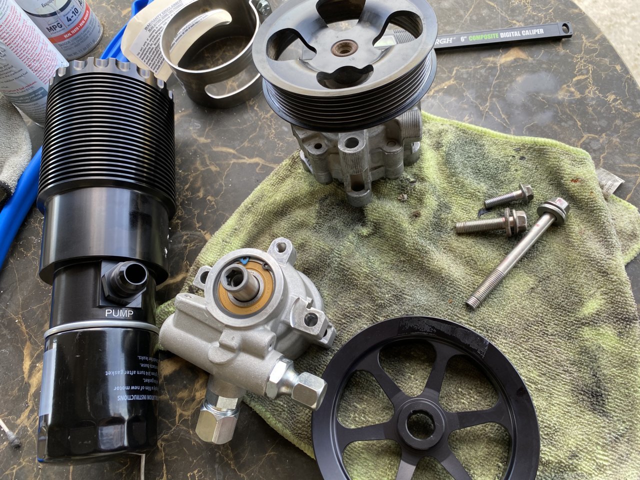

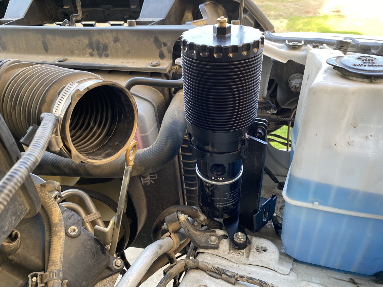

  17. Oct 10, 2020 at 6:26 PM
    #37
    Epic3rdgen
    Oct 9, 2018
    #268872
    237
    A-A-ron
    2016 ACab OR

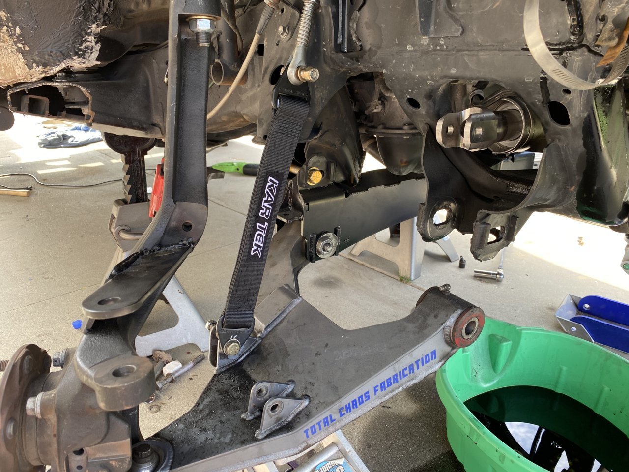

    7136EC91-3F16-4039-8227-CC008CE71AEC.jpg Today was the 1450 psi pump install. And the 16” limit straps. Truck is getting there. The Total Chaos/Fabtech 6” bracket lift is coming along. Made a steering reservoir mount out of the stock mount. Got the rack back in the truck. It was fixed with no charge under warrantee. B71C7781-6E9E-41E9-B5B2-CE684D9465FC.jpg5A46389C-BF64-47A9-BAB5-F3144FDCF54B.jpg
