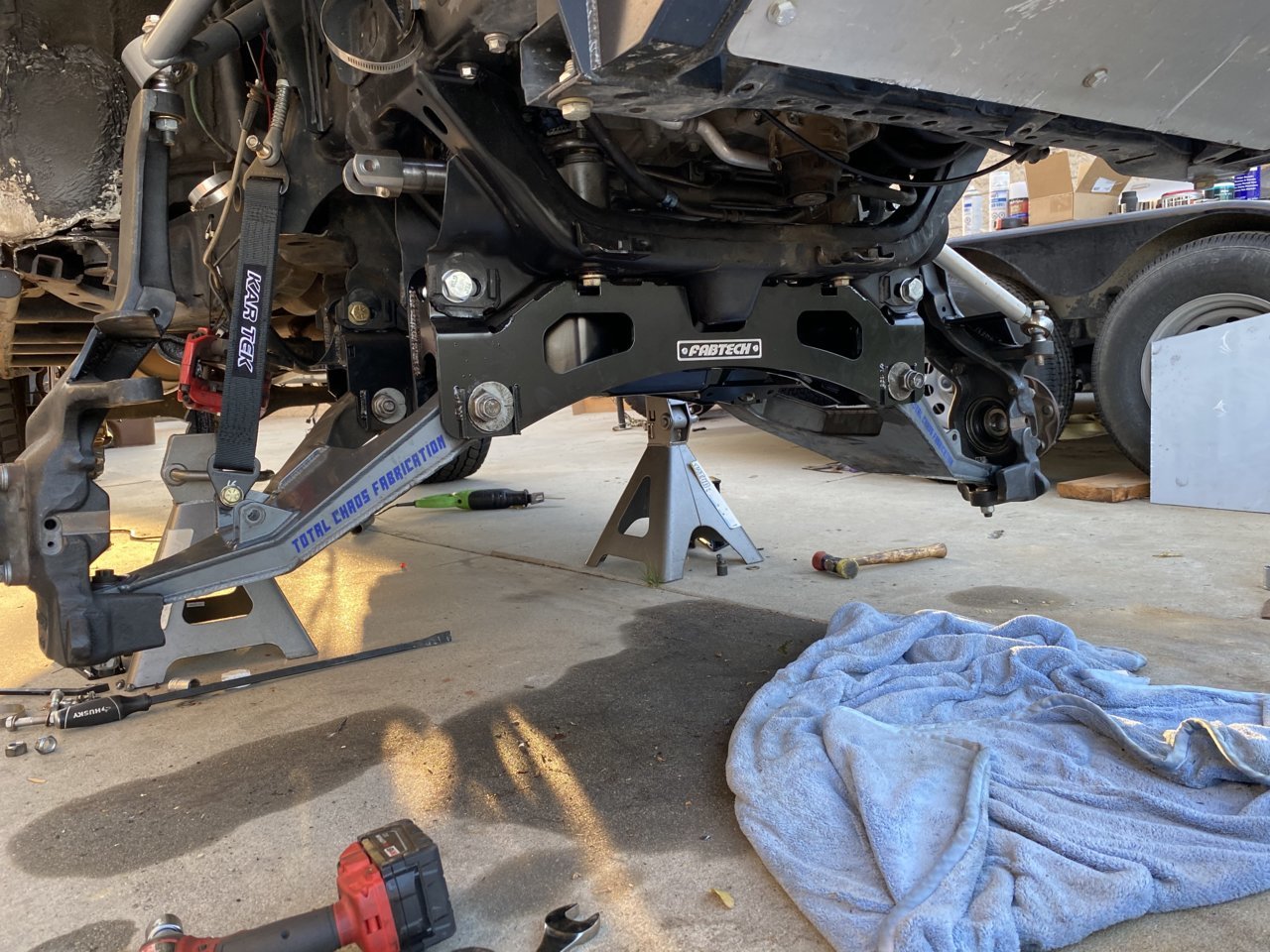

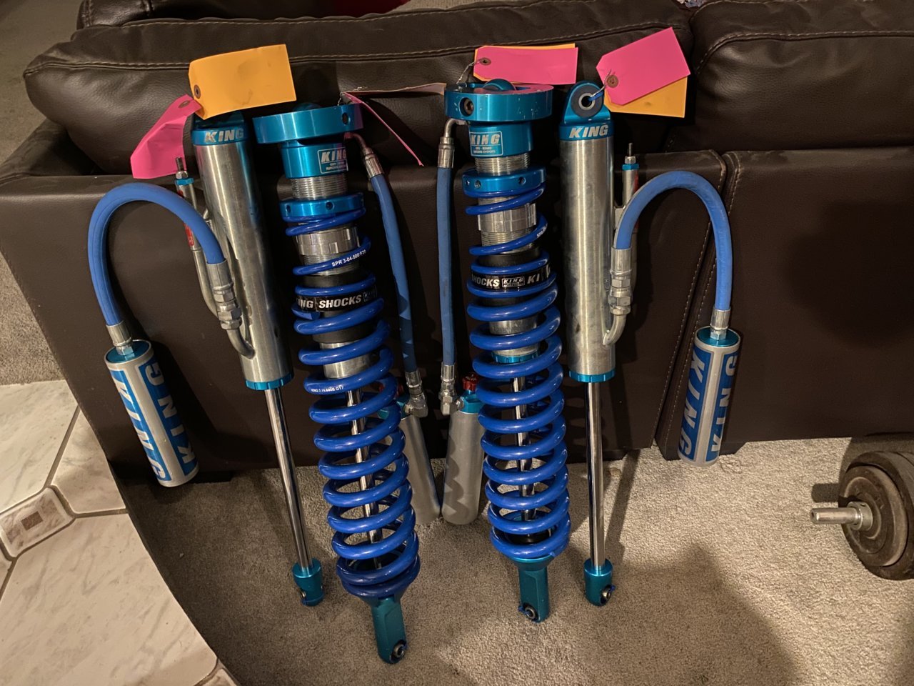

  1. Oct 13, 2020 at 7:32 PM
    #41
    Epic3rdgen
    Epic3rdgen [OP] Well-Known Member
    Oct 9, 2018
    #268872
    237
    A-A-ron
    2016 ACab OR
    +2 TC LT Fabtech 6’’ bracket w/4link on 40’’ KM3-s Raceline Wheels

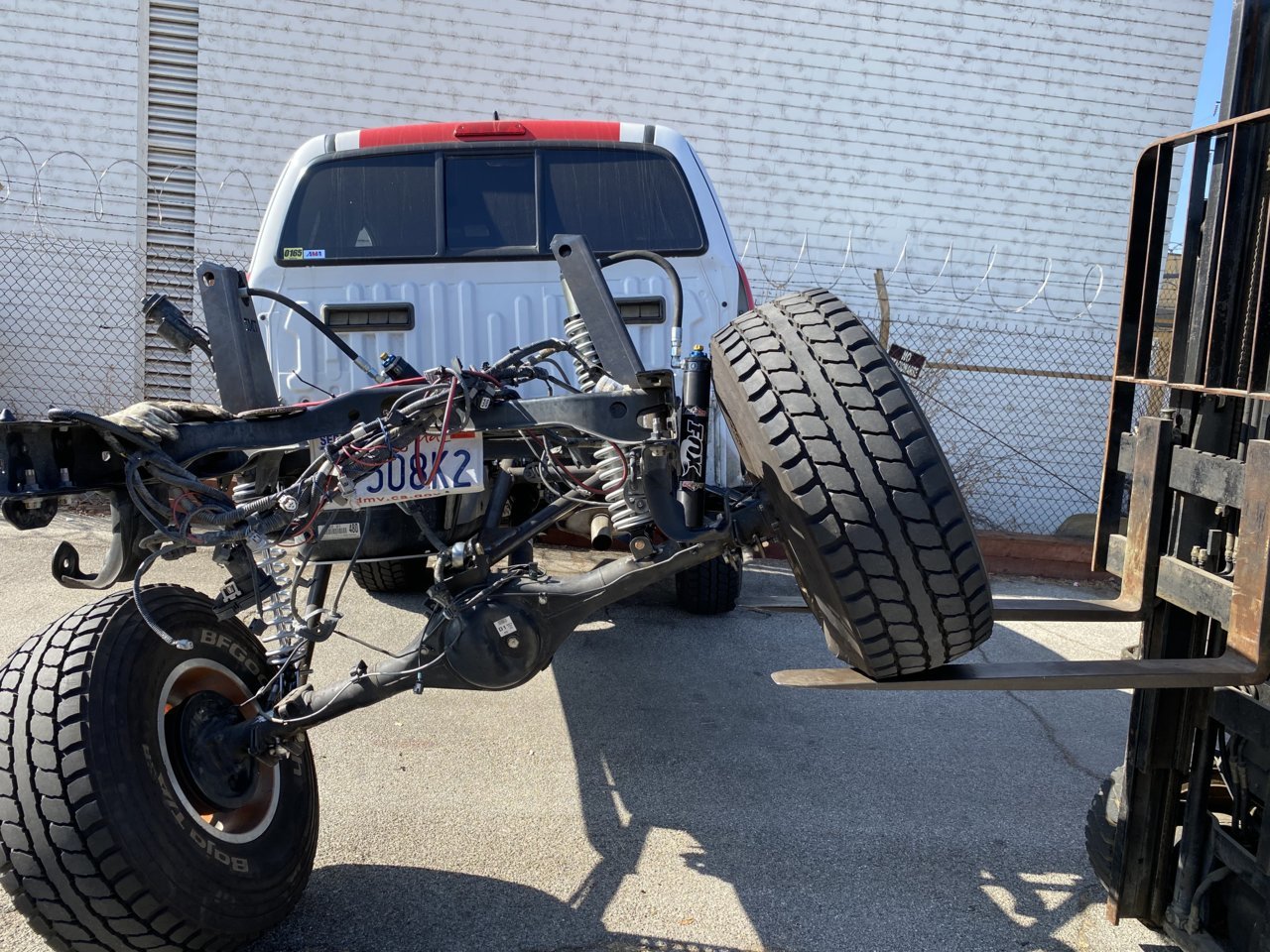

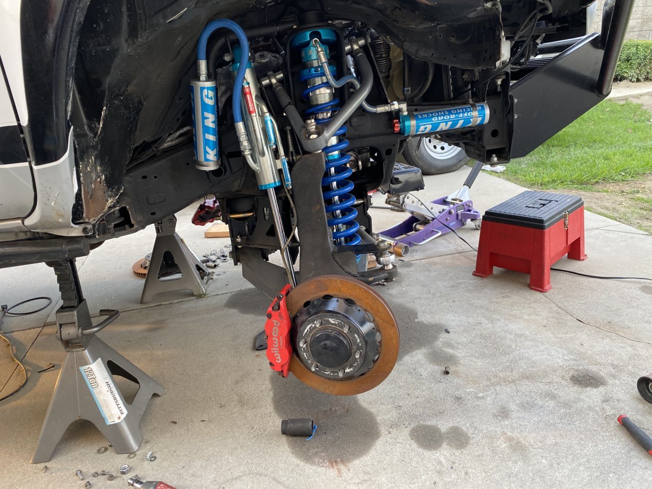

    Today I picked up the shocks from King. Now I just need the front crossmember from Fabtech and I can finish this mod and move on to the 3 link rear. King designed the shock so the first 2 inches will be plush then changed the valving. It should ride allot nicer . DDB34F6C-38CB-46A0-92EF-0C48589D9467.jpg

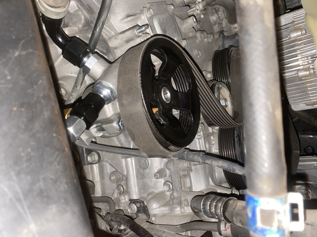

    This was a challenge but the 1450 psi pump is mounted. Howe is in ! haven’t scene anybody tackle this mod. I’ll do a write up on how to get this all together next week. As the guy who told me it could be done but shared no info on the parts needed or any details or pictures. B2CB3056-964B-4011-AFCB-7C641F2FD21A.jpg

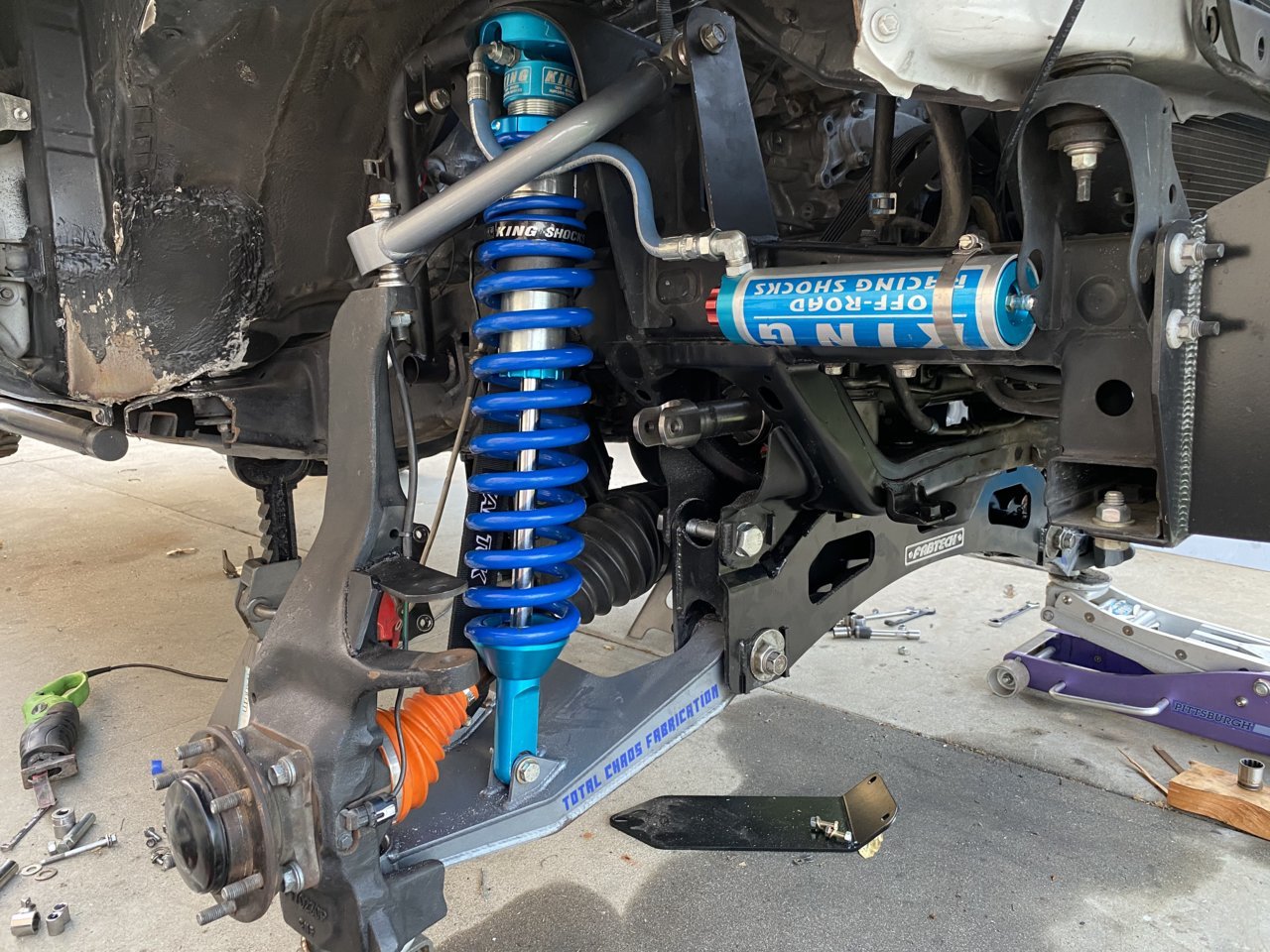

    Getting closer ...what a ton of work. E6D8C882-8903-4972-8D1A-1CC7E3ADA1C1.jpg

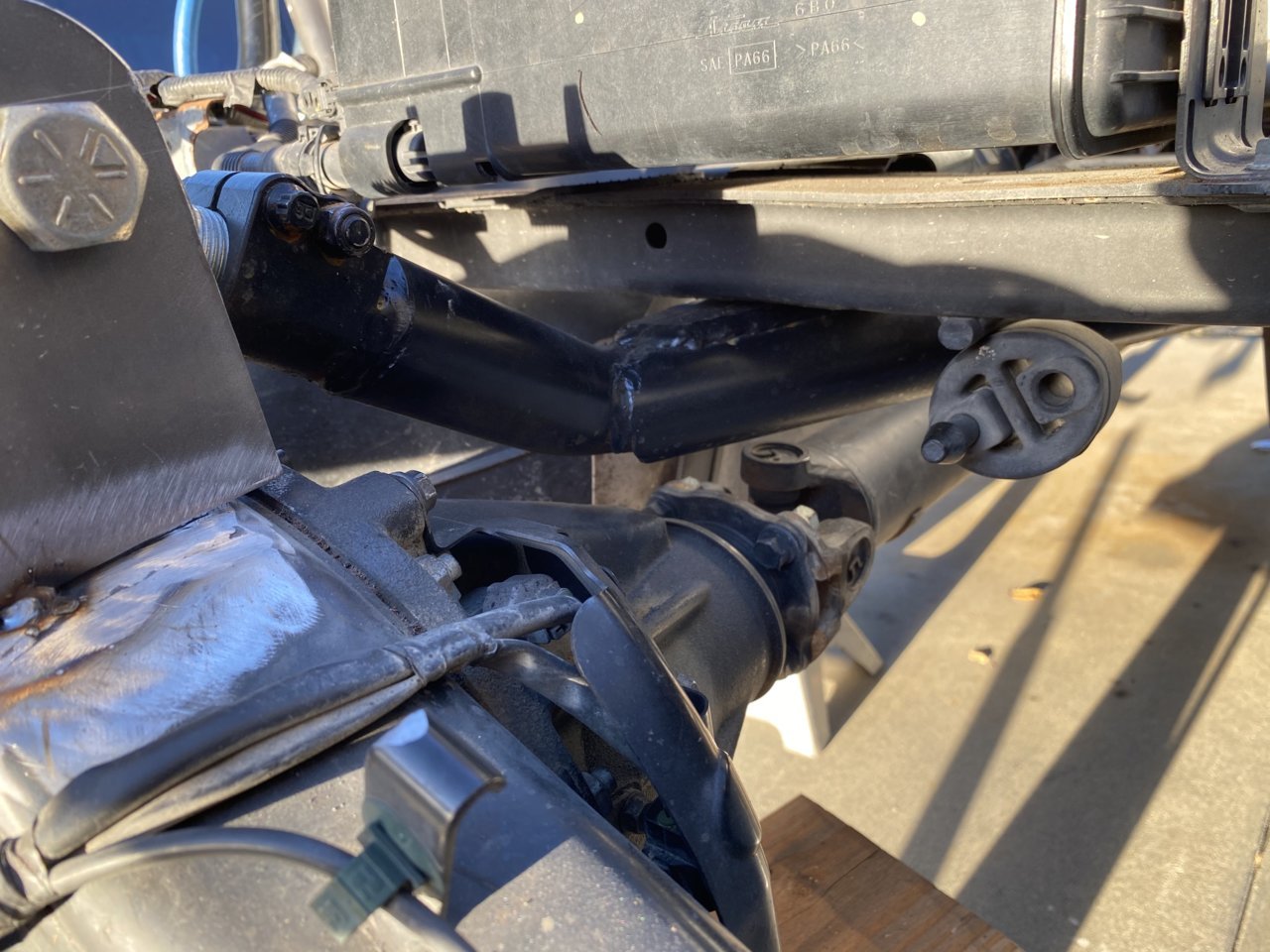

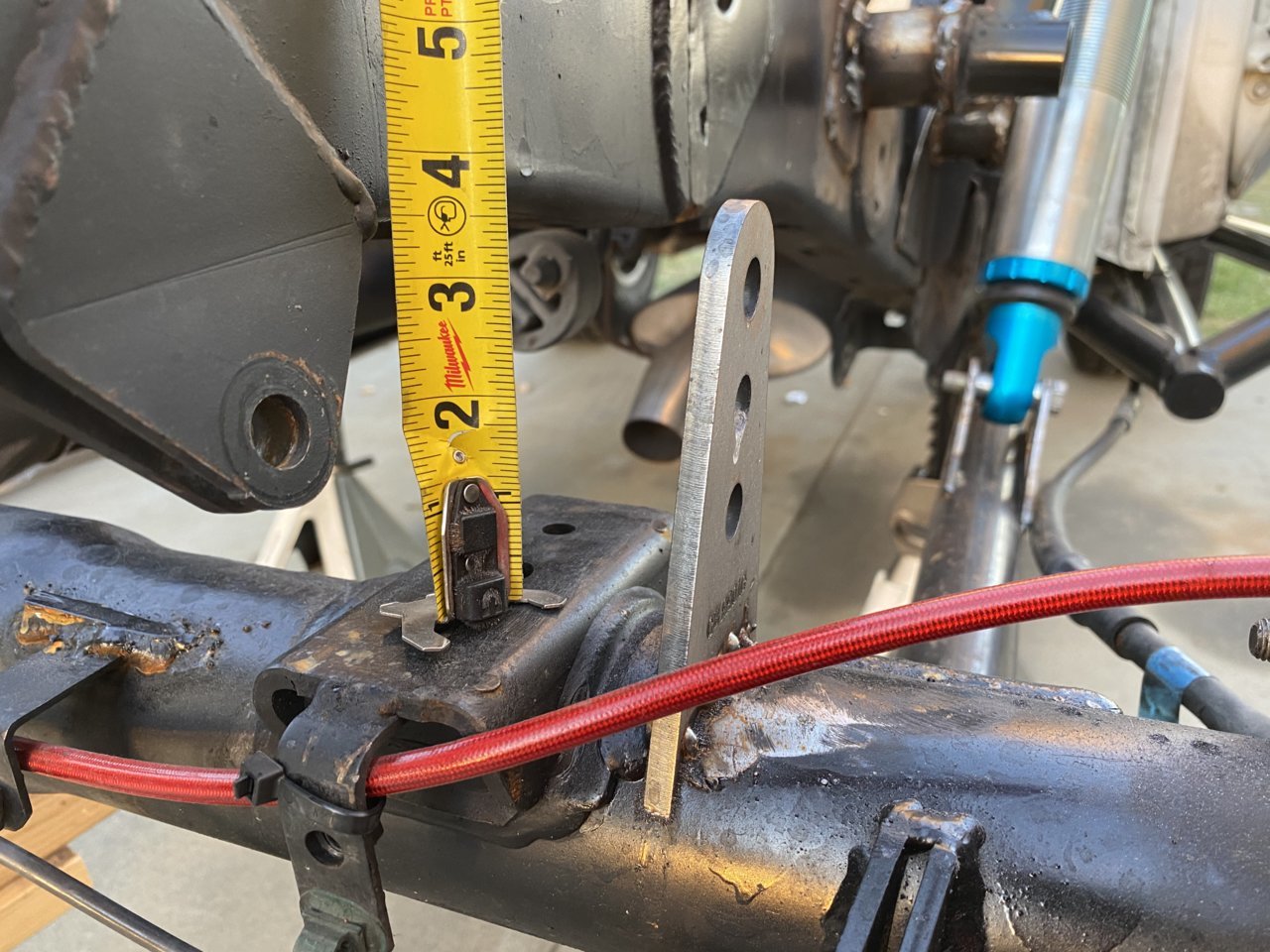

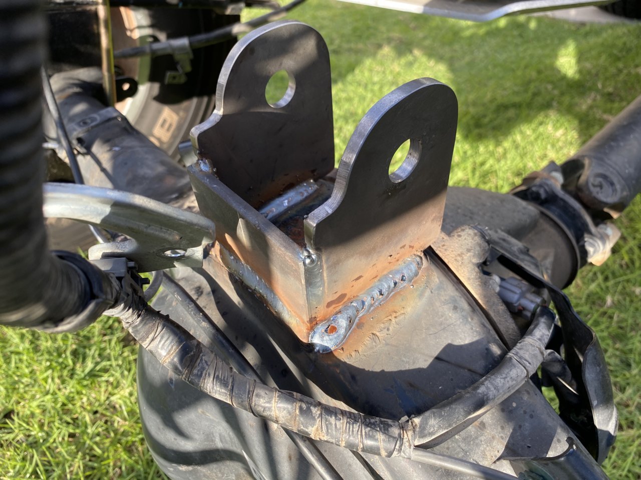

    CDDE4C34-825C-45BA-99CD-43BC4613D620.jpg 10E8B0EF-B08F-4083-9B0F-3D50BE834772.jpg Started the top A-arm mount and welded my diff top mount.

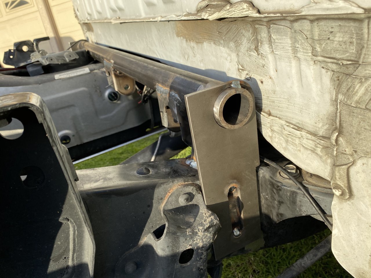

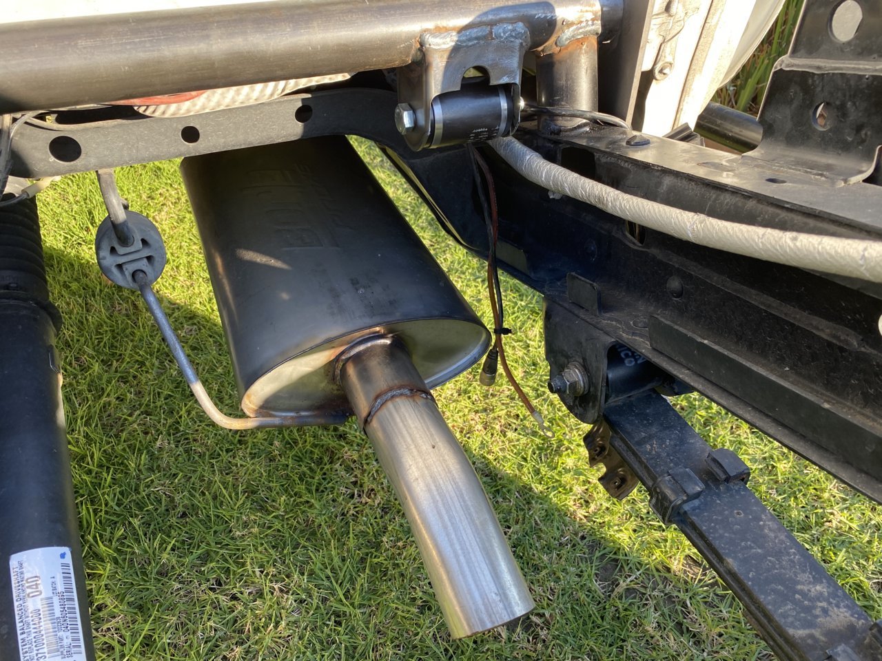

    Got my stock muffler off and the Borla muffler moved back for the 3 link to fit. The new muffler is so quiet it’s almost as quiet at the stock muffler. Got the first part of my top link installed. Tomorrow I’ll finish the rest of the top A-arm. B1C6F3CF-1F5A-41DA-BA02-E91DDAABDF8C.jpg92C50ACA-AF97-4037-BE7D-D411D8A8CA05.jpg

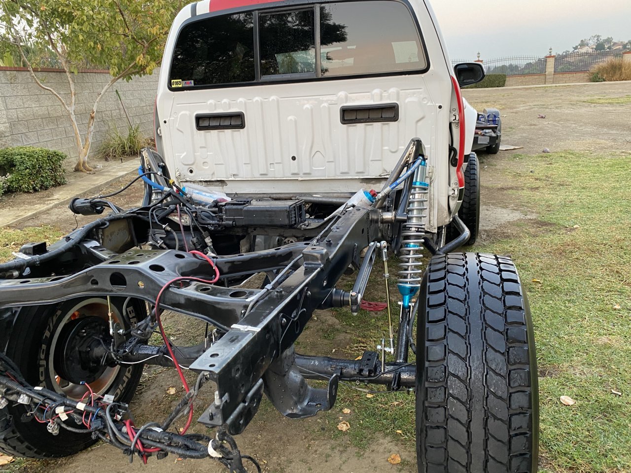

  9. Nov 21, 2020 at 7:23 AM
    #49
    Epic3rdgen
    Oct 9, 2018
    #268872
    237
    A-A-ron
    2016 ACab OR

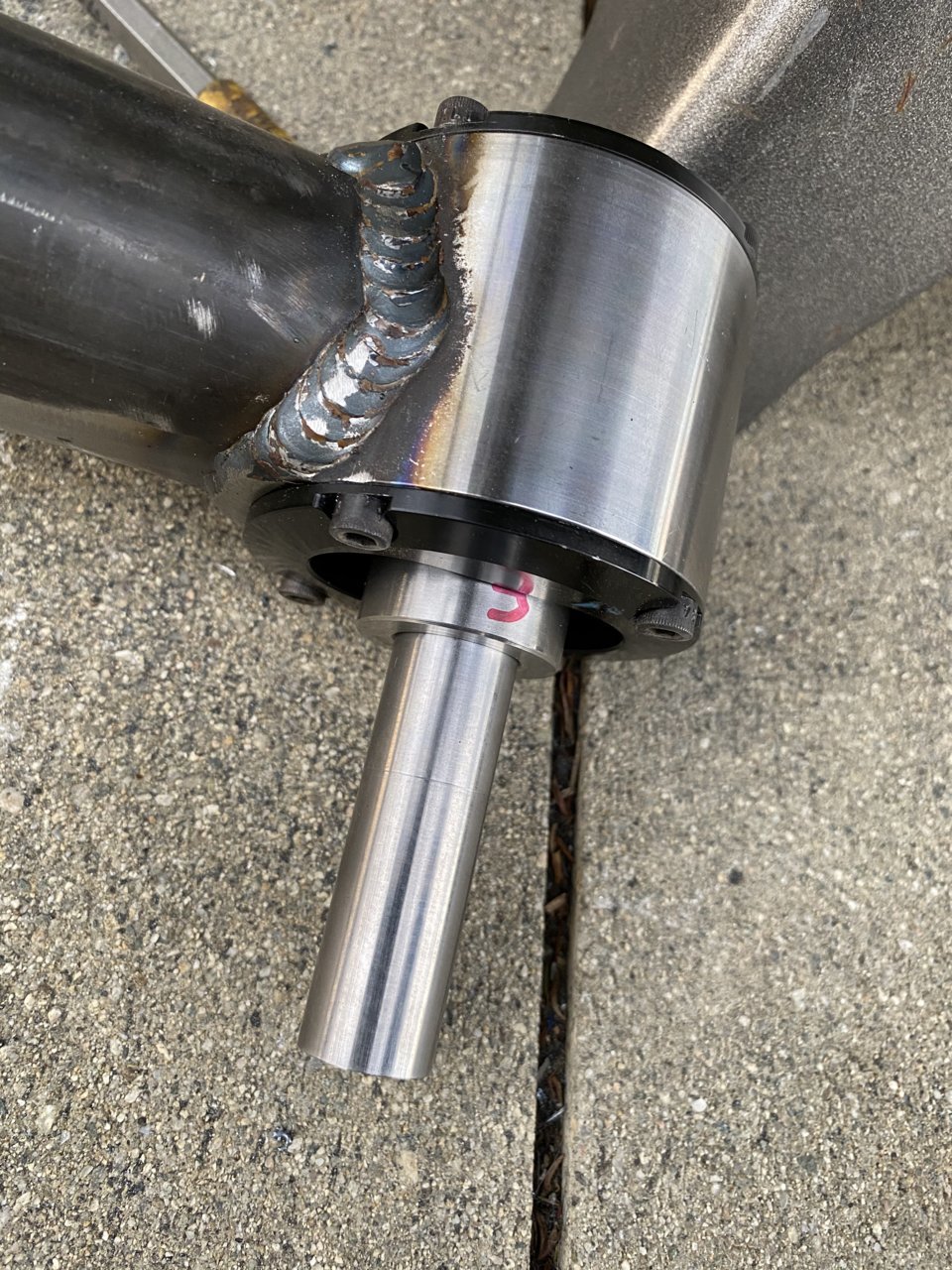

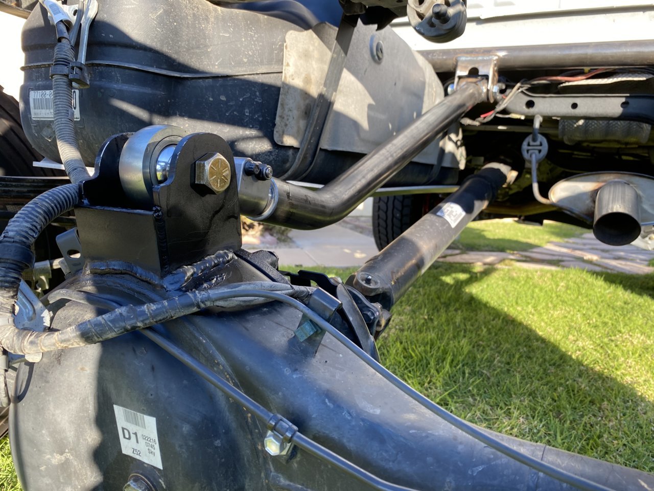

    34920E17-9A98-47A5-A8DA-7BBB72801095.jpg 64D7CA51-7D27-4A5C-9767-F12B8BFA9DE4.jpg More of what you don’t want to do. Here is #1 than #2 and the truck is not a stable this way. Inside the frame rail does not work.And my goal is to not take any bed space.. So I’m ordering some 10” shocks to mount on the control arm in front of the tire..I think I can use my 10 Triple Bypass behind that..learning curve.64D7CA51-7D27-4A5C-9767-F12B8BFA9DE4.jpg 7ECE88F7-CA0F-4D02-BD54-2C2F068FF4E2.jpg

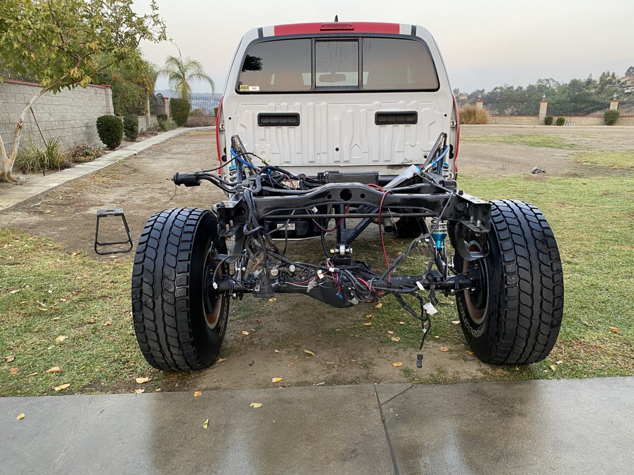

  12. Dec 9, 2020 at 5:33 PM
    #52
    Epic3rdgen
    Oct 9, 2018
    #268872
    237
    A-A-ron
    2016 ACab OR

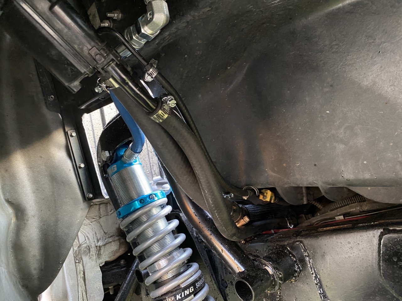

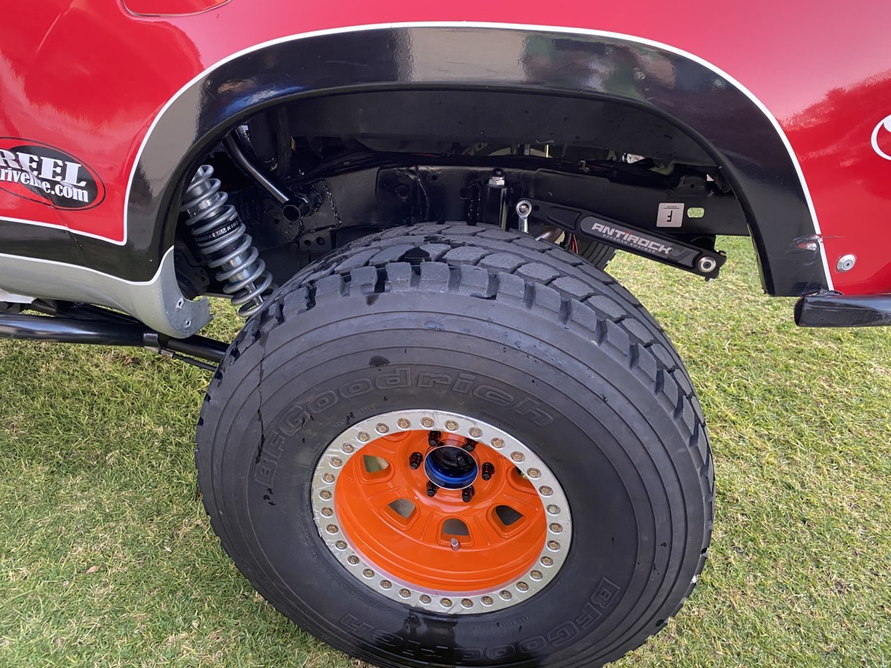

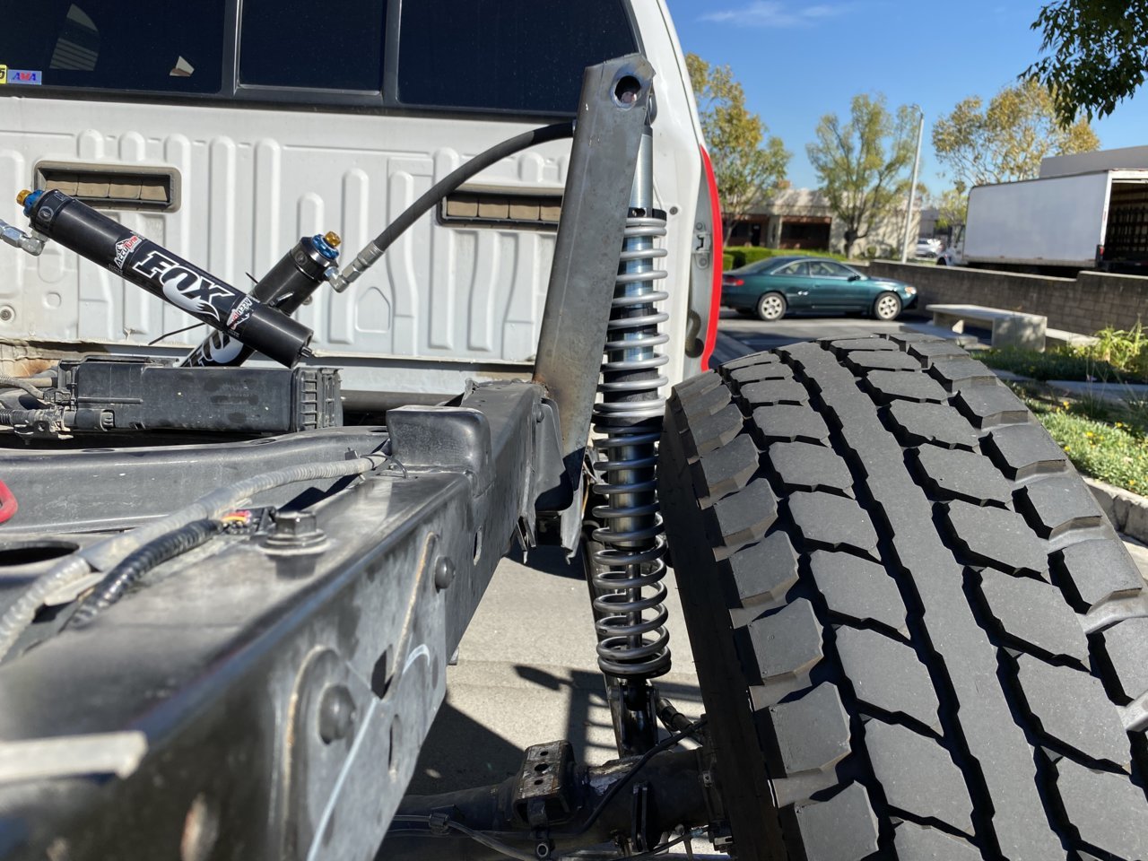

    74D6E435-93F1-4C43-B0C9-6C3A98ECEE9D.jpg 3AC8CB56-0D4E-41DE-A457-7AFDF659B00B.jpg 151D506D-46E7-47BA-B8F8-E23FAD66AD9D.jpg Yes a ton work. But it’s a hobby I enjoy it. I haven’t been happy with anything I’ve done in the rear so far. I think I’m headed in the right direction now. This is my third set of arms lol. And I like the shock mount under the fender wells so in using 0 bed space. I did have some advice given by the true crawling thread. The wabble stoppers only come in 3/4 so I made a sleeve fo my 5/8 set up. 42” eye to eye.

  13. Dec 11, 2020 at 7:21 PM
    #53
    Epic3rdgen
    Oct 9, 2018
    #268872
    237
    A-A-ron
    2016 ACab OR

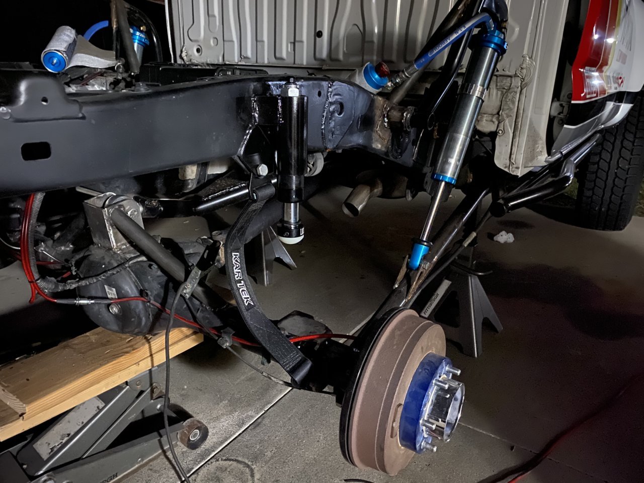

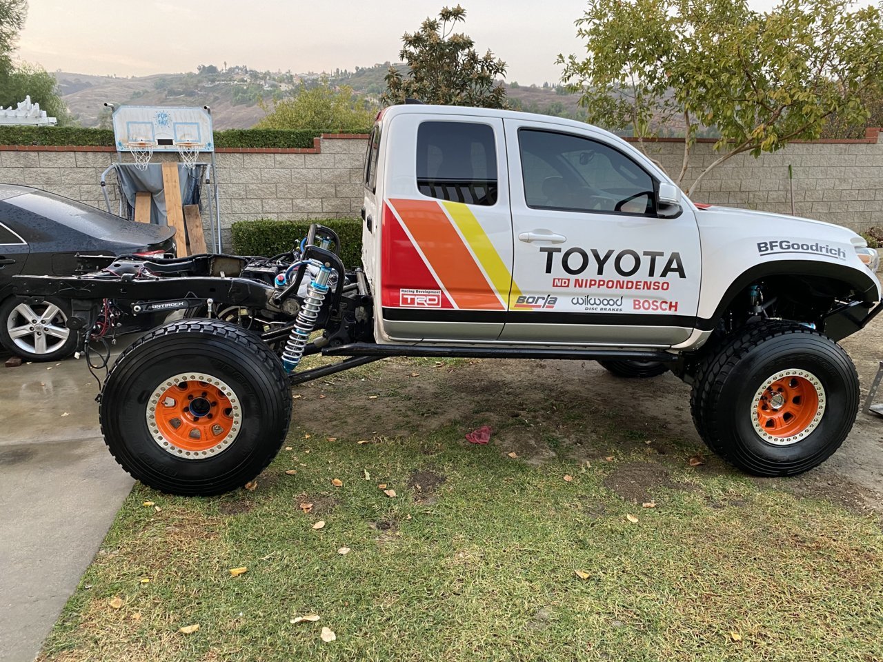

    Almost ready to get my bed back on. Add new brake lines , install the bump stops and add the limit straps. I’m happy with set up, 16” of travel 307370CD-1D12-43E1-A77E-6C337AB380FD.jpg2BB48589-4C57-4070-B11B-F833D72E322E.jpg

    Ha ha ....thank you for your input! Yes there is some angle on the shocks. But I’m not going to run fast enough and hard enough to worry about heat build up. There tuned and sprung to run the angle. No Bypass because I want it stealth under the fender flares... using no bed space. Not moving the gas tank. I want all the benefits of the 3 link and the super plush ride. The goal of my project is packaging... I have no idea why I bought the 16”foxes. What a learning experience this has been! The 10” work perfect tucked in there. No bind ... going to truss the rear axle tomorrow and add the hyd bumps and limit straps. Than I’m going to put her on the Trailor and put her through the paces. I think that is super cool of you to invite the crew over and show people how to build stuff using your tools.

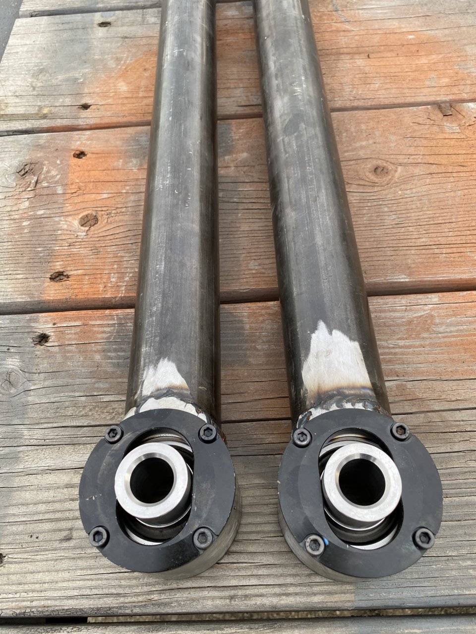

    2FF84449-182C-4473-A0A0-480A654D91BF.jpg Got to have the bend in the end of the top 3 link or your screwed.. this is full stuff ! 90C7F64E-BCB3-4373-B031-6D0214AAE0D8.jpg

    You mean a hydraulic bump stop.? Those were installed today.. so we’re my limit straps. B42B6D1D-B0E4-4B98-916C-EDAA640A6EFC.jpg

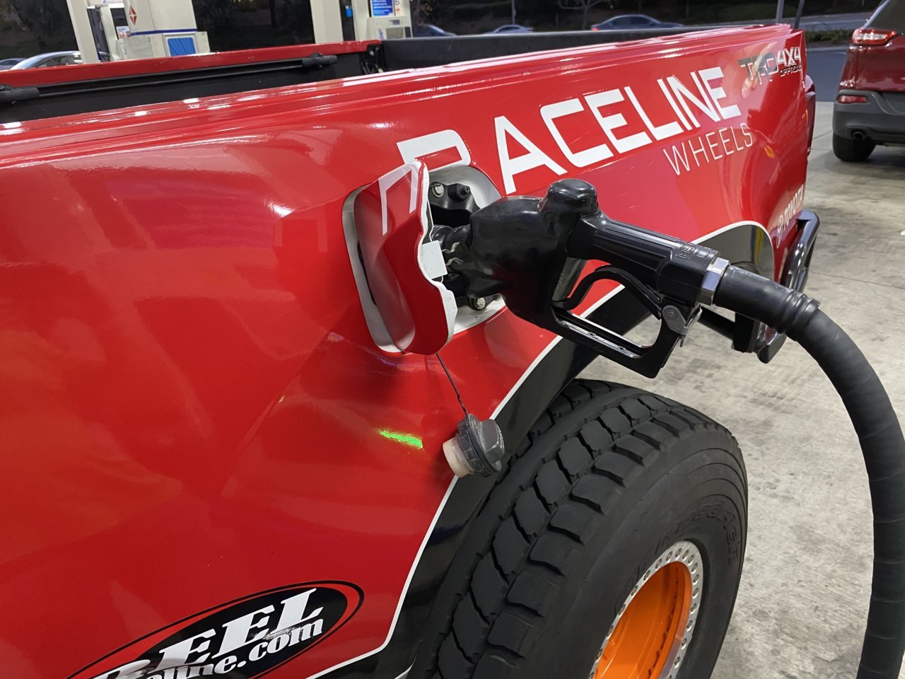

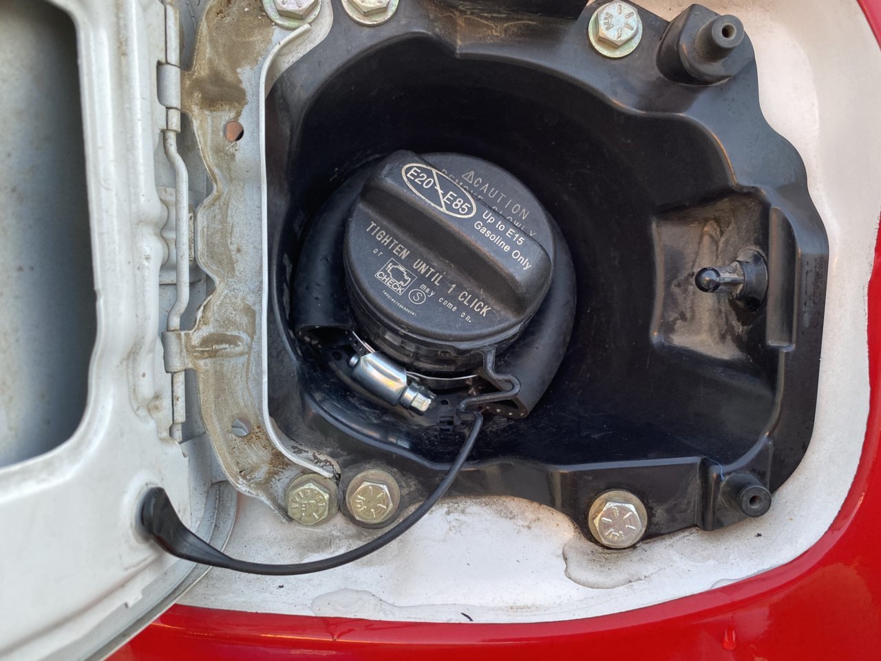

  20. Dec 19, 2020 at 7:24 PM
    #60
    Epic3rdgen
    Oct 9, 2018
    #268872
    237
    A-A-ron
    2016 ACab OR

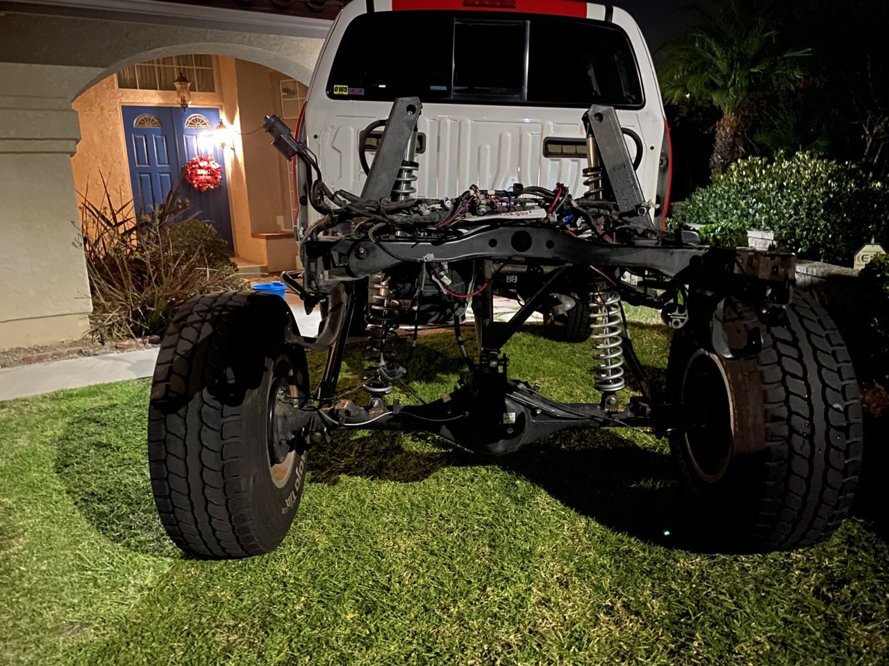

    9DEEC64A-5053-4E22-94C6-927E7CC66658.jpg 66382A45-792A-4D4B-A3E2-0F136333A7EA.jpg 1BC55808-62BC-4F55-94B9-81BD6EDBC20D.jpg 513E2567-FA7D-43A6-A448-67AB9985E396.jpg The brake hard lines striped out and folded up due to ? I had these lines so I ran them. Today was a good drive 50 miles around town.felt good to fill up the tank after 3 months on the side of the house. Took the hard gas lines and turned them into soft lines too. Check out the hose clamp around the hose that keeps the gas filler in the perfect spot. That is so redneck but it doesn’t vibrate and it works well. I still need to set my preload in the rear tomorrow as the truck has settled in.
