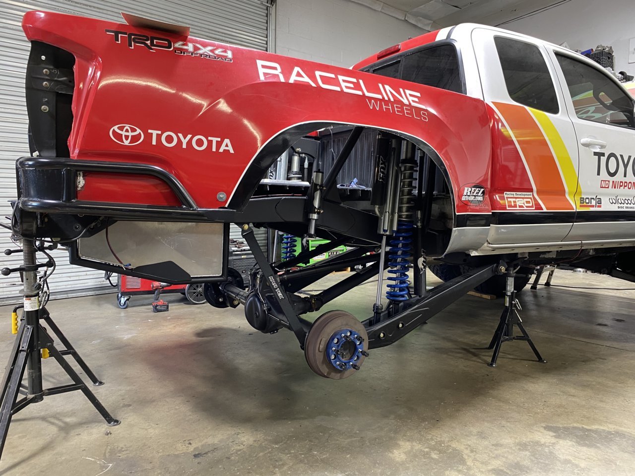

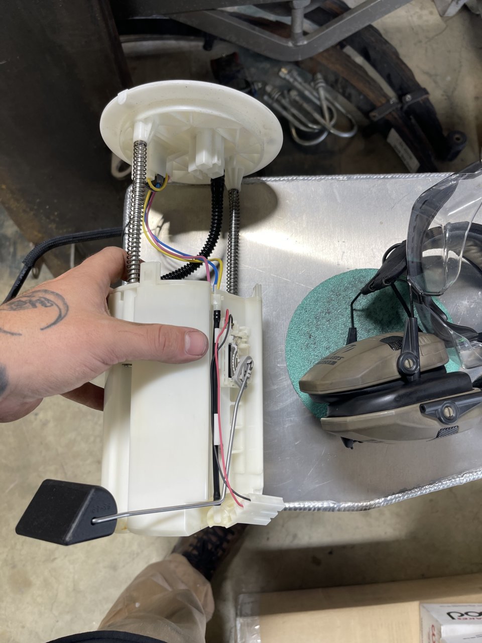

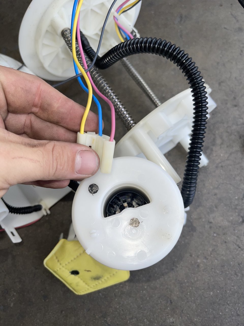

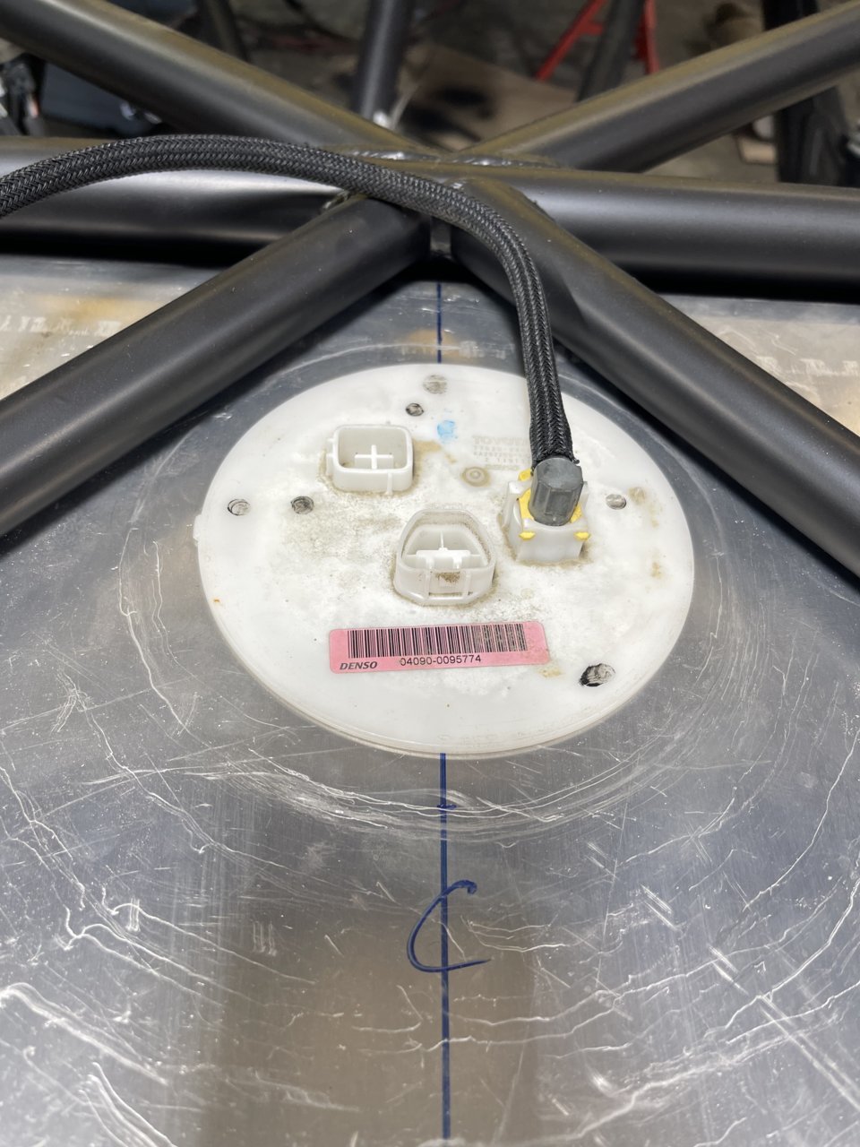

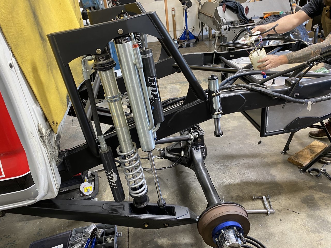

    Nope more problems. No available other pump will work with the new tacoma brushless fuel pump. The computer controls the pump and fuel pressure. We put the stock fuel pump in and sending unit. Now just plumb it like stock. I should be rolling here shortly 3106A55D-0C28-47BD-A90C-17655545303B.jpgA8B085A7-54E1-47CF-8272-59CB47CC9564.jpg BB925E8F-4C83-4FAF-9C0F-37073B5C1349.jpg

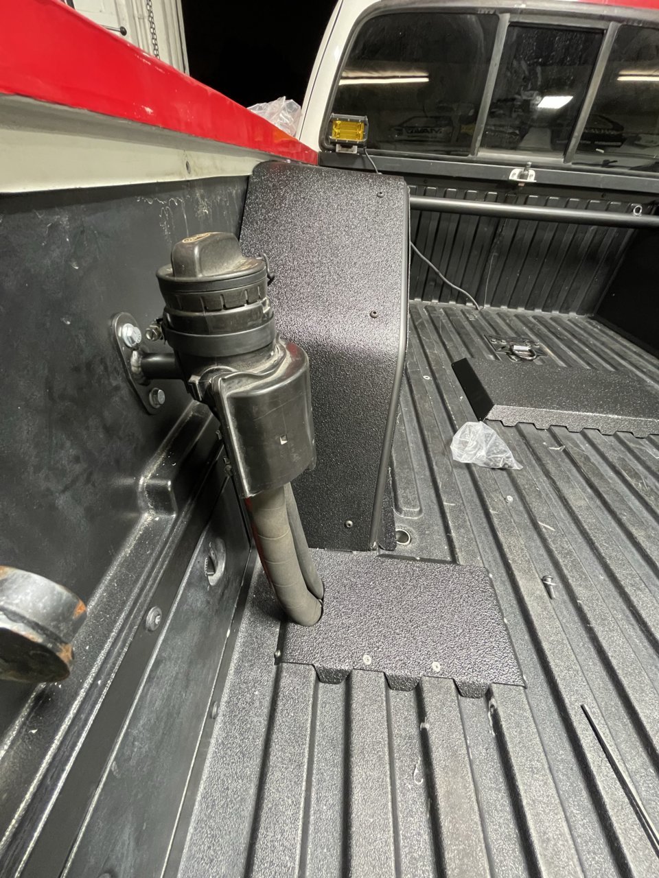

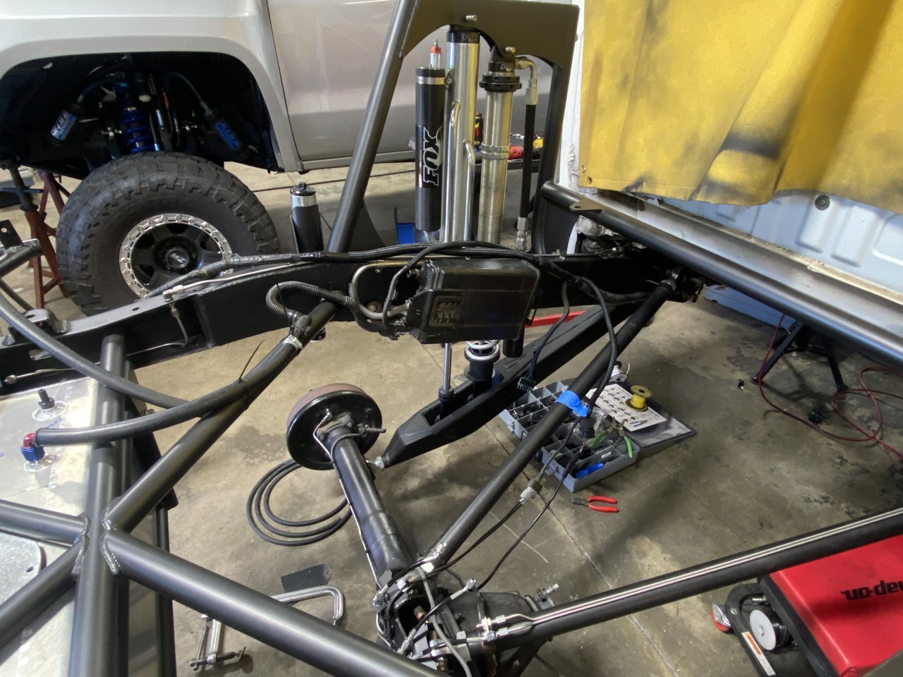

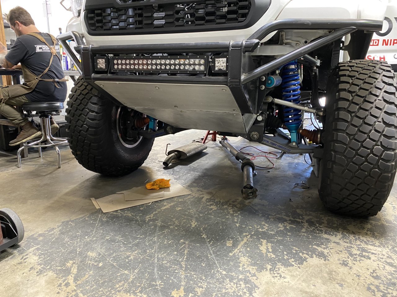

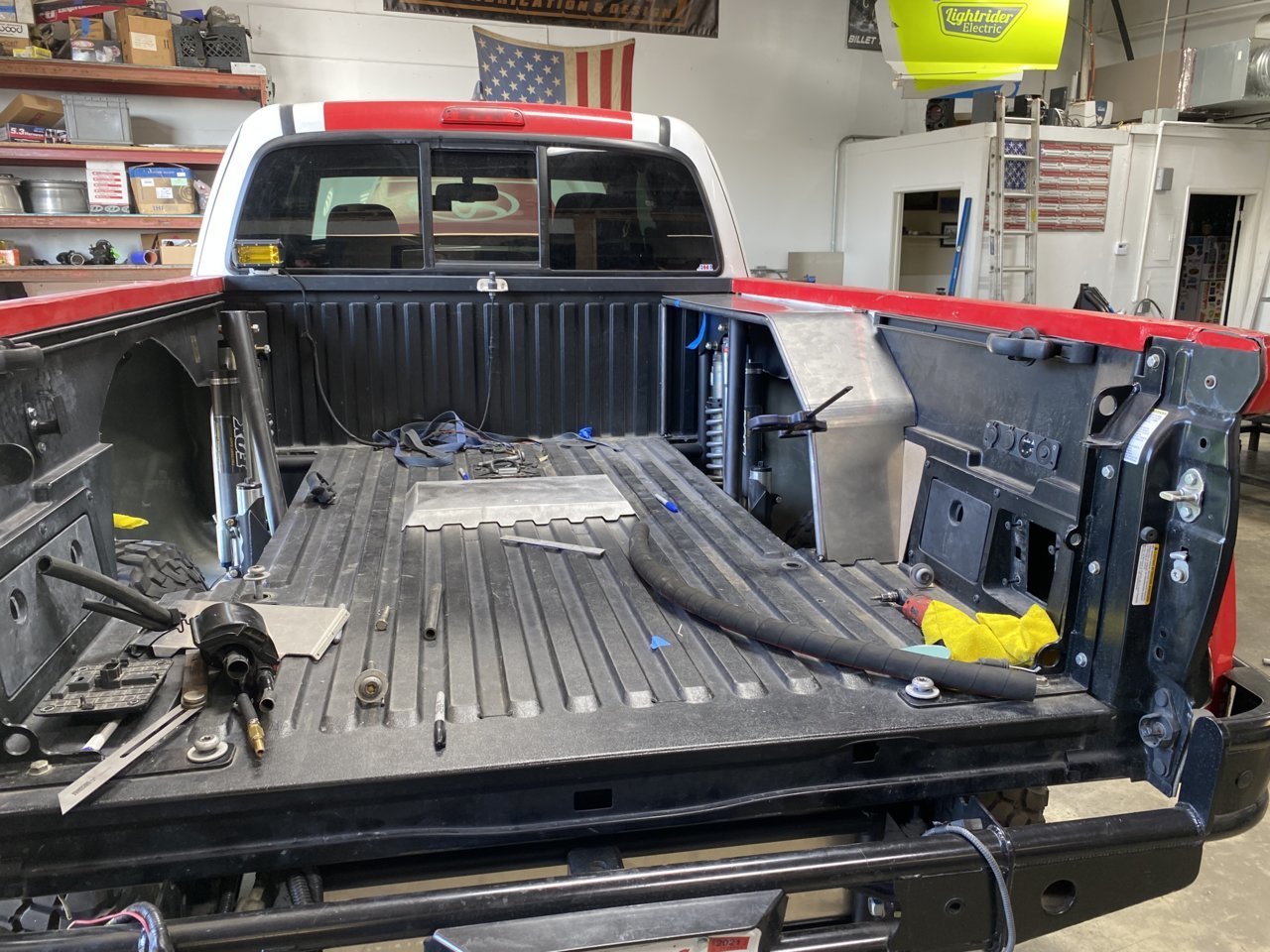

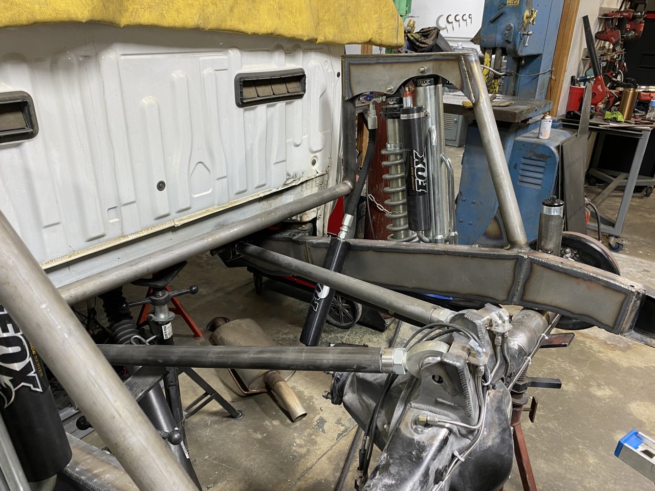

    Just motoring along. Some fab guys just take forever. Slowly moving forward.. all smog is plumed into the fuel cell. Just need to mount the bed finish the inner fender wells build the rock sliders. 10FE0901-D65D-4780-AA7C-37CB927EA1F1.jpg2AF1C928-DBE2-4F4C-87E9-5A635CFCEA49.jpg 2AF1C928-DBE2-4F4C-87E9-5A635CFCEA49.jpg 5EEEEA47-FB3B-4FD6-B816-B96553408A11.jpg

    I think there 43’’ They used Solo Motorsports short canoe arms.and there tacoma frame mounts 32 gallon tank from Solo.

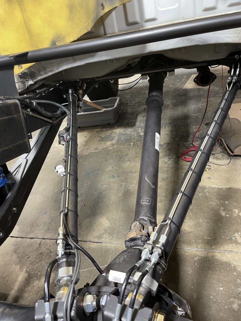

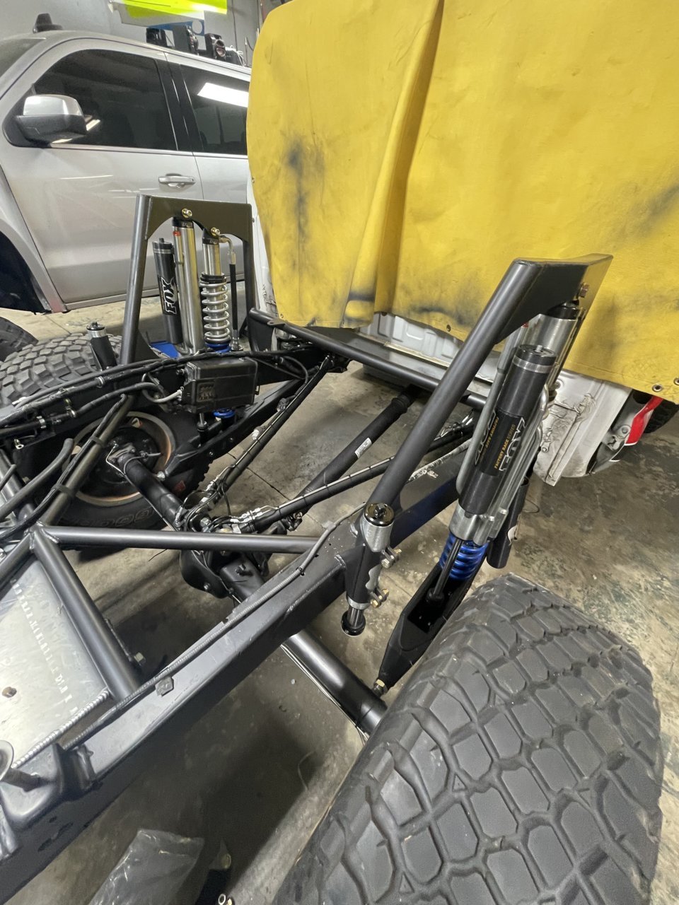

    Ok so update truck is standing on its own, brakes work. And the new Locar park lok holds the truck killer . Had to dump the e brake cable lines. Didn’t really work with the 4-link. I’ll probably drill and tap some clamps to hold the brakes lines on the top arm and the axle vent tube on the other top arm instead of all the zip ties. 916B0723-487D-48C9-BDF1-01D269BEE684.jpg 3BD01905-F605-4B4F-AC73-F54C550D63B8.jpg

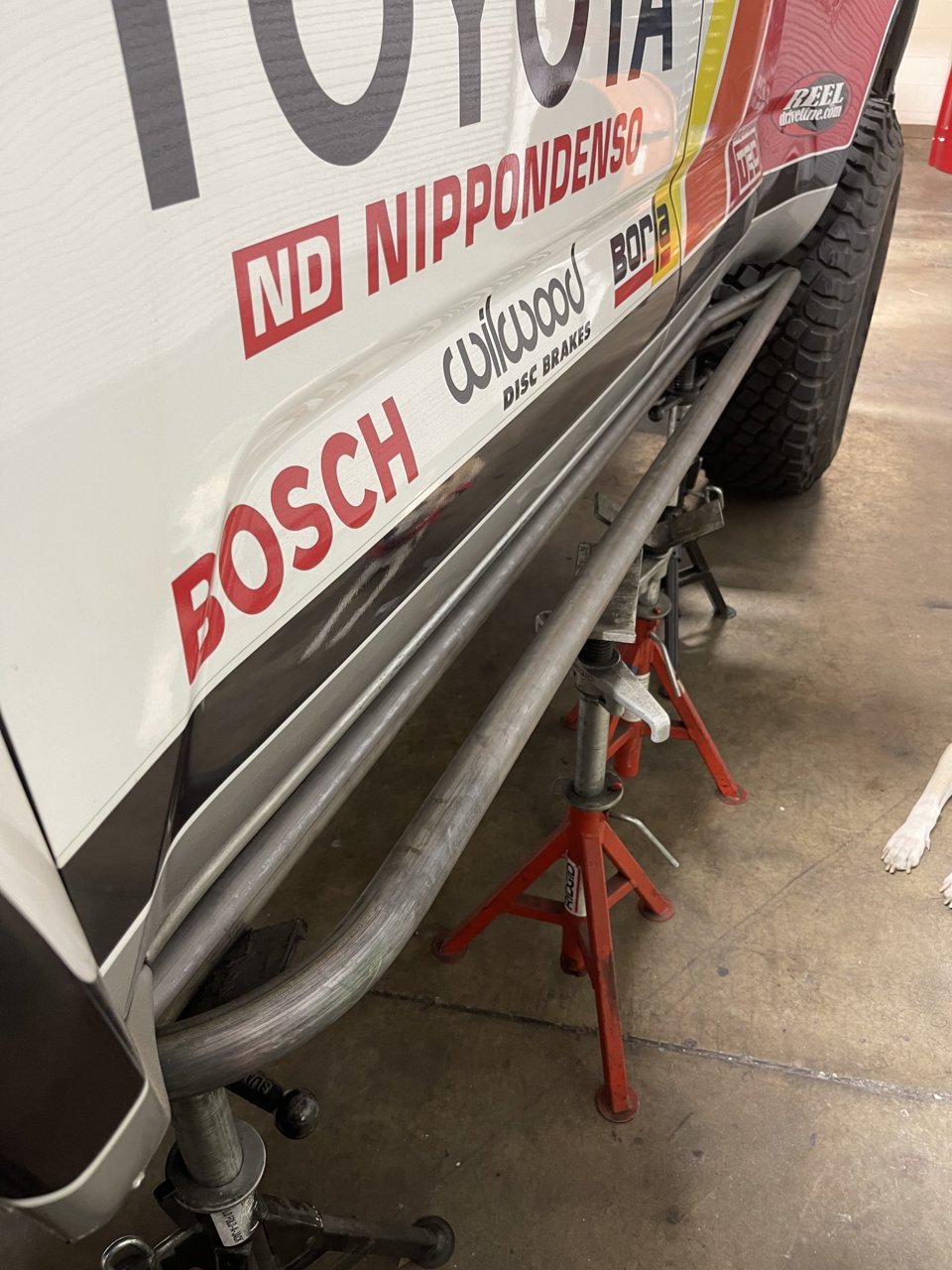

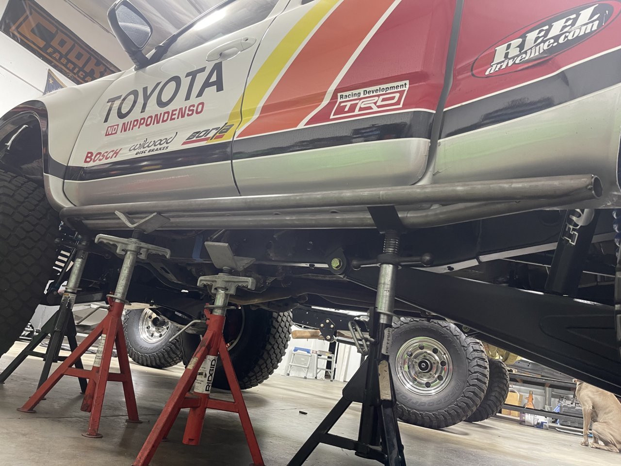

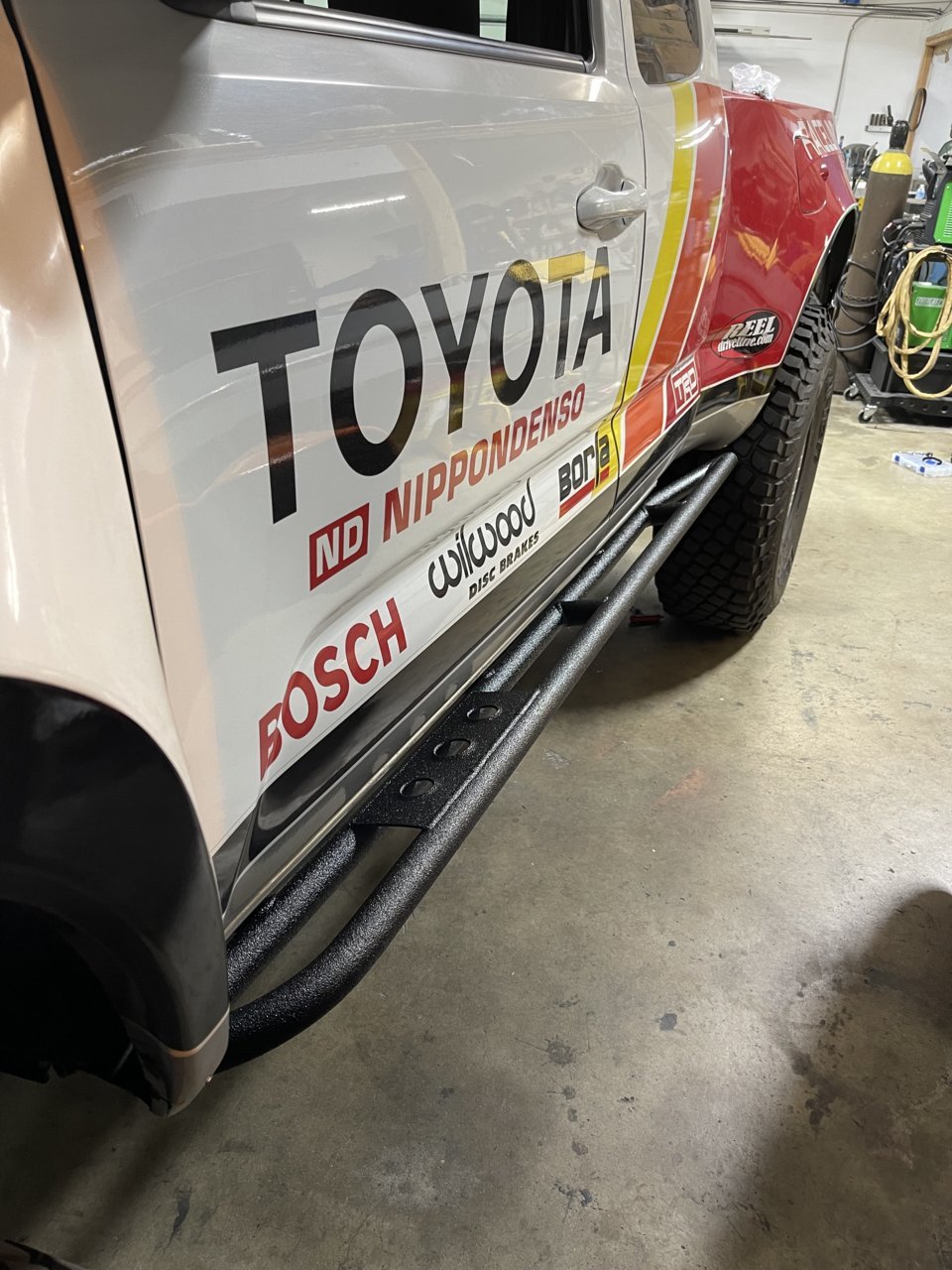

    And moving along got the sliders designed today. Truck is almost ready to fly . CD653CA1-2111-4197-BD30-D449992CF238.jpg987E5468-DBA4-402F-8FDC-052AD26F2187.jpg

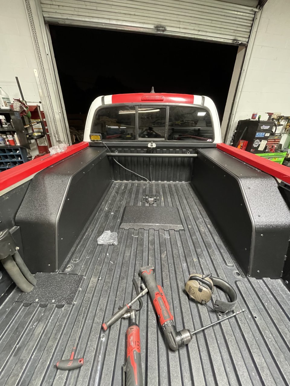

    Designed the inner fender well. Just a little at a time here. Looks like I’ll have to get the fender wrapped again. Had to cut to make the room for the 40’’. We’ll see what gets done tomorrow..950B5577-A234-4D02-8CE4-5698C954B7B7.jpg009F74BF-1C99-46CA-913A-D93568E6FA94.jpg

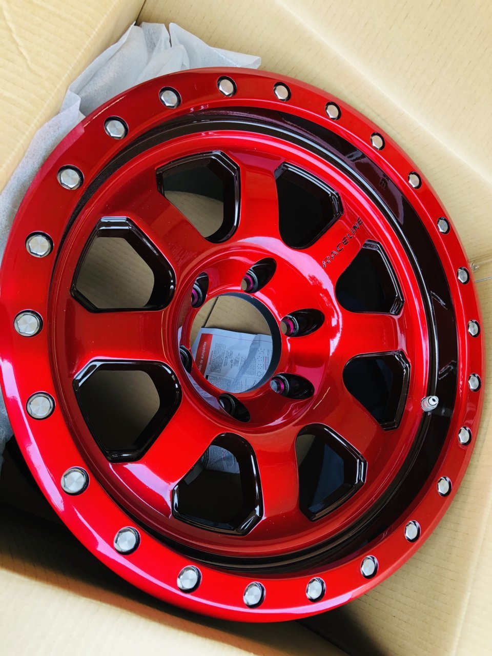

    Did Raceline powder coat these wheels red or did you outsource this?

    I order them from Raceline like that. You can chose any color you want

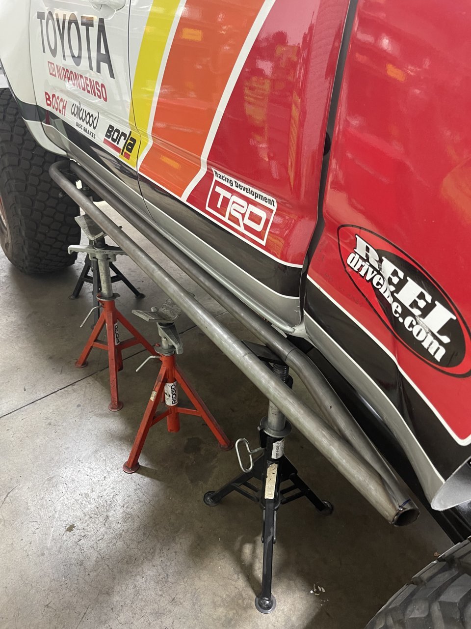

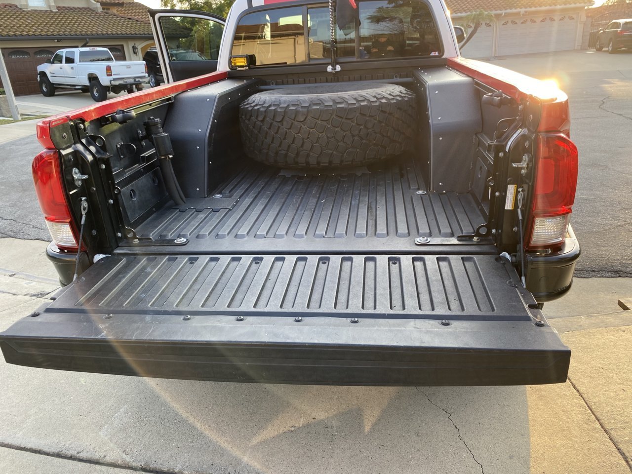

    Ready to take delivery tomorrow. And it sucks that I have to work all weekend. All sealed up what a ton of work. NExt will be taking it to the shock tuner then fix the wrap. FEE011A3-D426-405A-ACA7-4CAB4F7FB6DD.jpg951F5F1A-34C4-479C-9F17-7DADDCD4E269.jpg 8F20C147-C4D3-47E5-BBF2-3A1051F964C2.jpg
