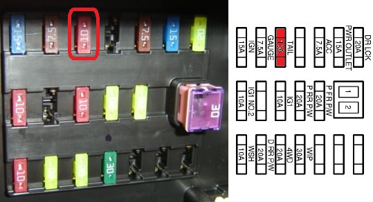

    The TAIL's fuse is in Cab...10 Amp, top row, 3rd from the left.

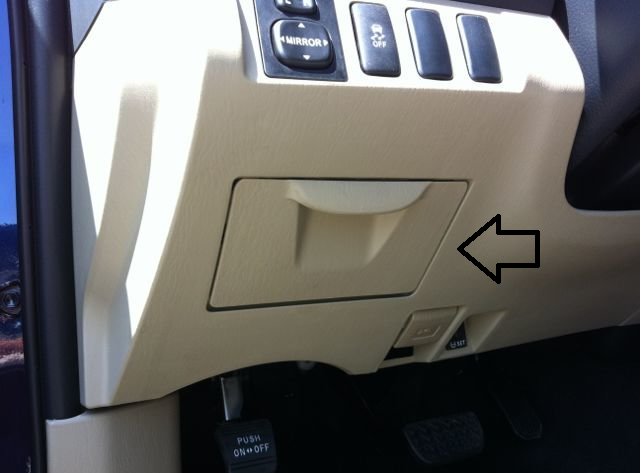

    Remove the "coin tray"...under the cab switches

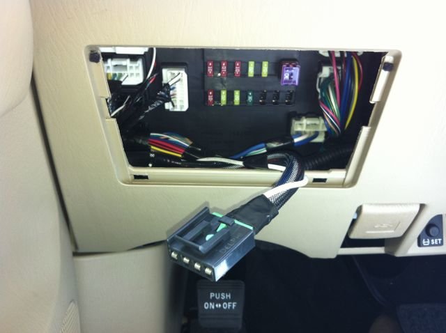

    Behind the tiny weird little secret hash compartment to the left of your left leg... below your fog light/diff lock switches...

    To the left of the steering wheel behind the little pull out change/ accessory storage compartment. Are your dash lights out too? If they are it's probably the fuse that was mentioned previously.

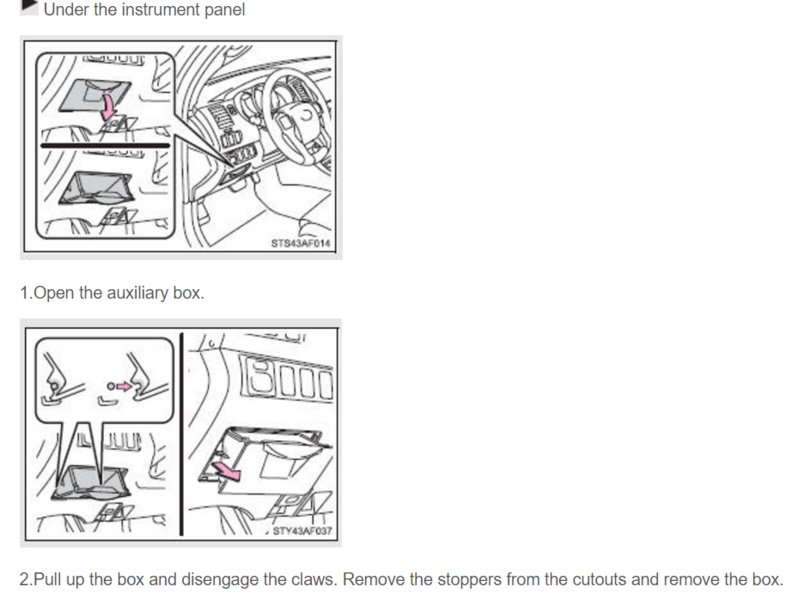

    Open then carefully rock to one side to release side tabs, the pull up and out.
