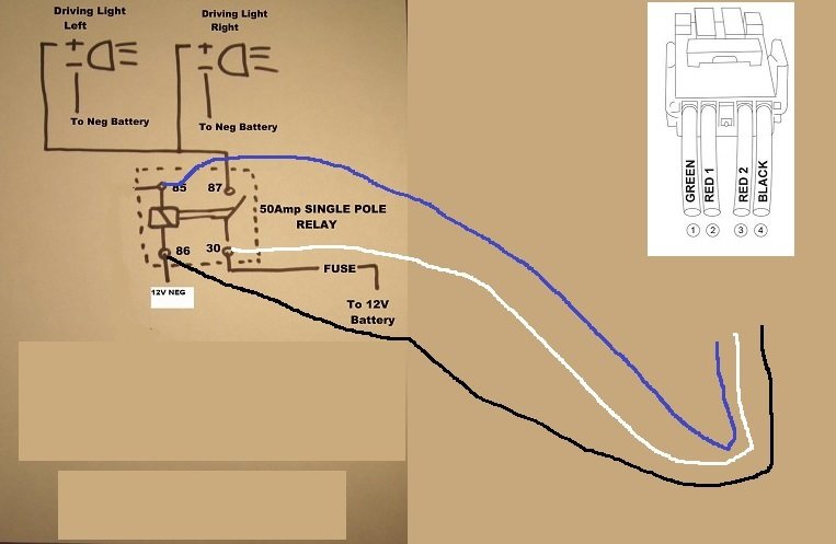

    Yet another wtf thread.
    I have a light bar and wire harness I got used. Harness looks a lot like the HF I have seen online.
    From the harness toward the switch I have 3 wires, black, white, blue.
    Black is attached to relay pin #86 and is grounded to the battery negative.
    White is attached to relay pin #30 and is constant hot from battery positive.
    Blue is attached to relay pin #85 and activates the relay with ground and given + 12vdc
    the lightbar comes on when white and blue wire are connected.
    I have tried using the white +12vdc constant, and a tap to the tail light fuse, no changes at all.
    I would like to run it through a mictuning switch, but none of the posts or videos I have seen worked.
    Below is what I have, connect the lines for me please.

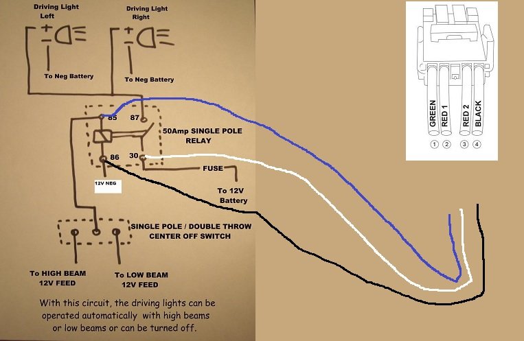

  2. Jun 20, 2020 at 8:32 AM
    caribe makaira
    caribe makaira Well-Known Member
    Feb 13, 2011
    #51121
    11,734
    Caribbean, Puerto Rico
    05 PreRunner TRD Offroad AutoTrans
    Hood Struts, My version Fogs always ON, Map & Overhead Light Mod,
  3. Jun 20, 2020 at 10:54 AM
    cwadej
    cwadej [OP] Ballerina Award winner
    Feb 23, 2018
    #245352
    1,234
    Right Here
    2011 Access Cab 4x4
    thanks. I'll give it a shot before ordering a new switch
