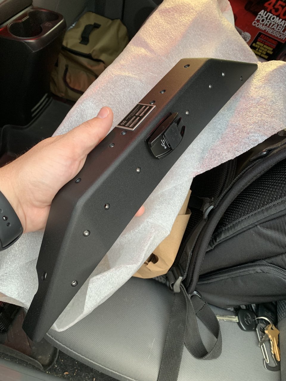

    My power tray parts arrived and I quickly assembled them while sitting on the couch watching The Handmaids Tale last night...

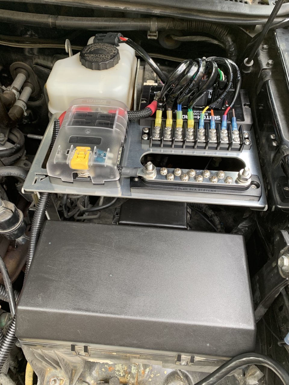

    Saturday was super productive. I started the day by volunteering some time up at our kindergarten/1st Grade building helping move mulch to have it ready for the kids next week. This was huge for my wife (a kindergarten teacher) since in years past, the playground was never ready on the first week of school. This was the first year a coordinated effort was used to bring out the community... and WOW! What a turn out!
    So... once we finished up there, I started into my Power Trays install. The installation was straight forward. At the same time, I went ahead and swapped out the OEM battery connections with the SDHQ versions I purchased earlier this summer.

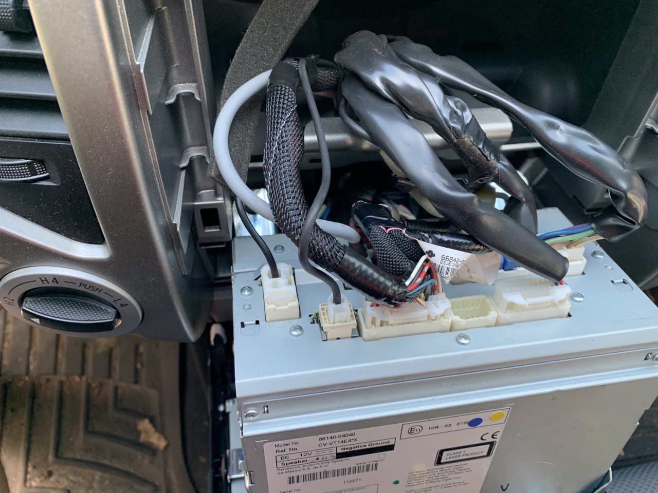

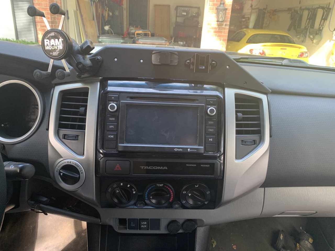

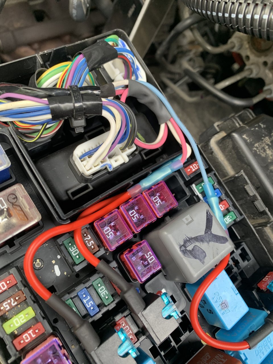

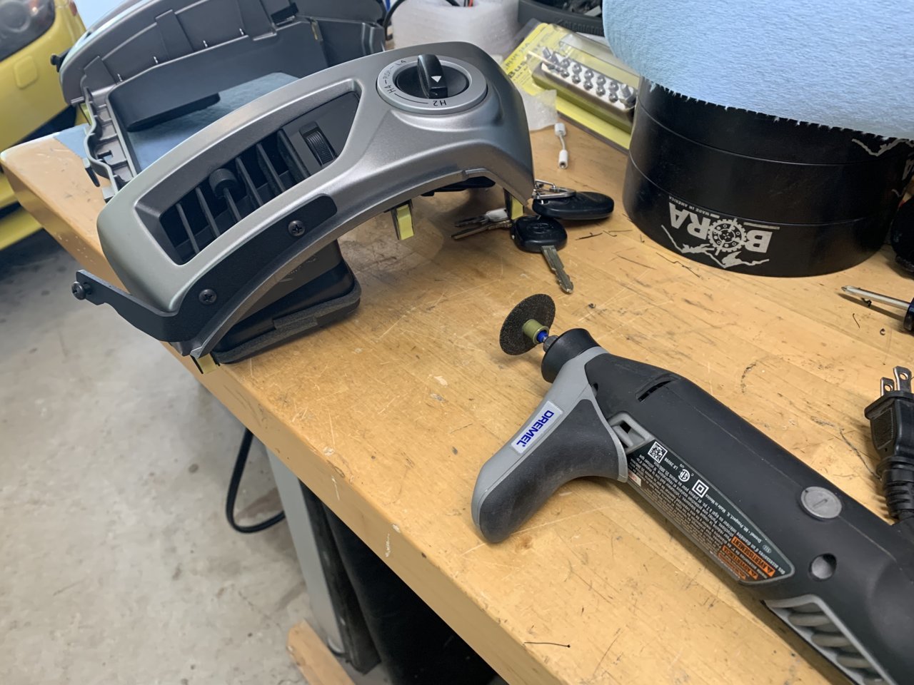

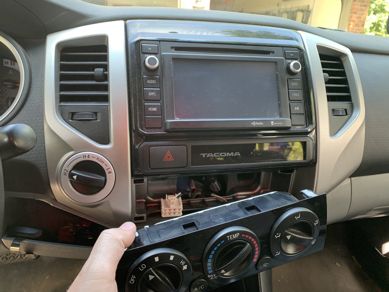

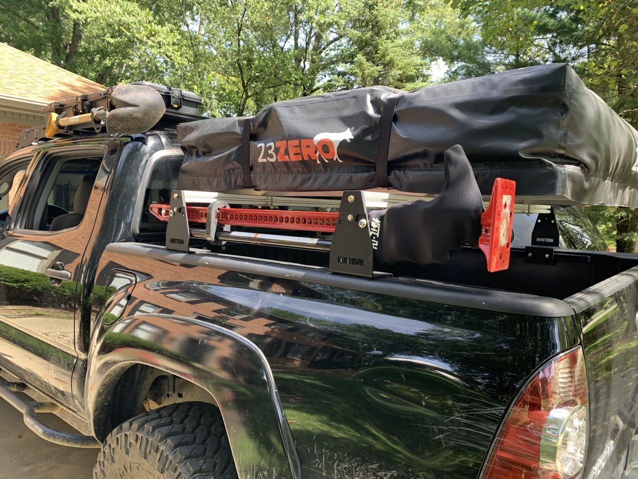

    After the installation of the tent, I realized that the location of the hi-lift jack was no longer convenient. It was mounted at the front of the bed and required that I climb in and under the tent to get it out when needed. Add in the gear that will more than likely be in the bed during a camping or off-road adventure and then access to the jack is a downright inconvenient. So.. Utilizing existing holes in the Mobtown LP bed rack supports, I installed (2) 1/2-13 x 2” BHCS, backed up by a flange nut, and standard hex nut to allow the jack to be mounted up high just over the bed side. This is much more accessible and actually frees up some space in the bed!

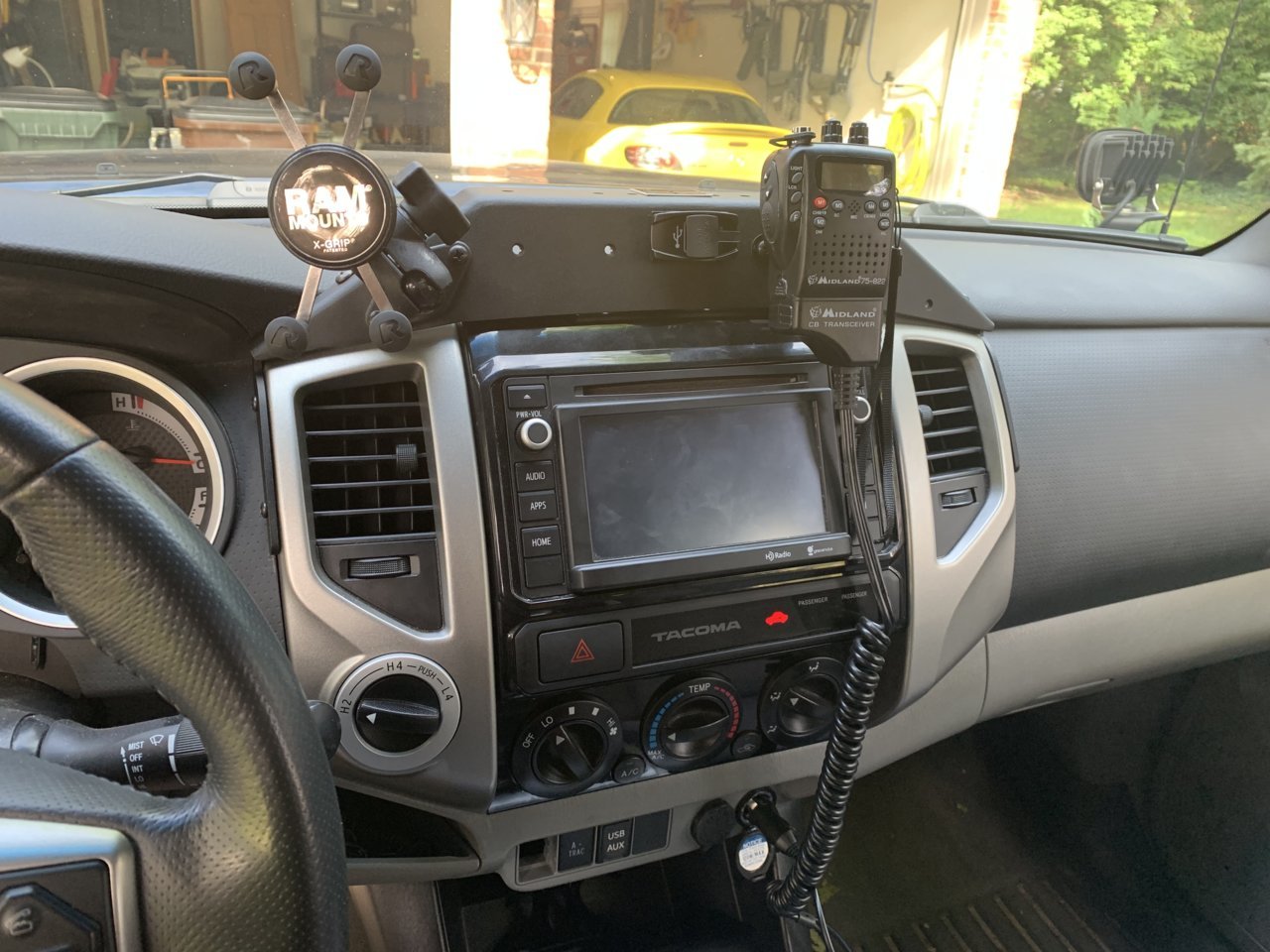

    Lastly, I dug in and installed my expedition essentials 2TPAM. They were right, this is somewhat of a technical install. I have pictures below showing some of the major steps. I will say, I opted not to cut as much of the dash trim as they recommended in their video and was able to get the dash back together and still maintain the locking characteristic between the dash to vent bezels. No I just need the last part for my iPad RAM mount to arrive so that I can test fit everything together!
