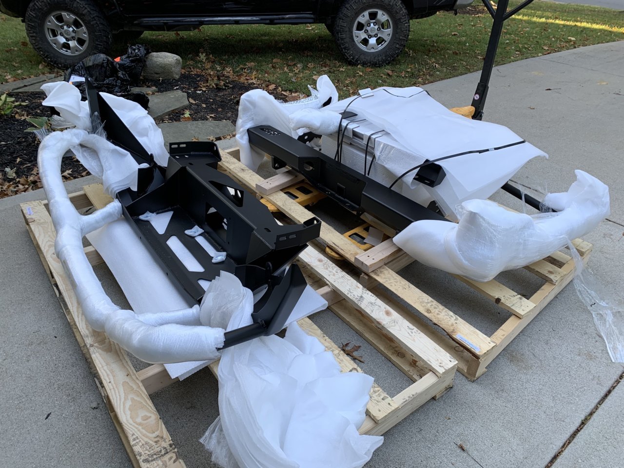

    Well... my garage is so full of parts it's getting hard to move around in there! I need help getting all of this crap installed... who's in?

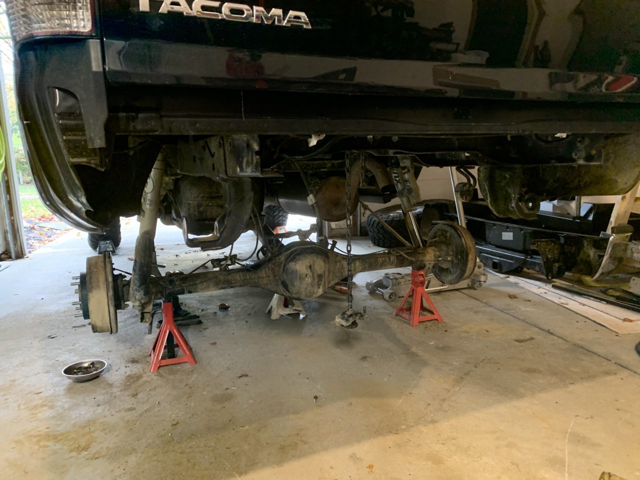

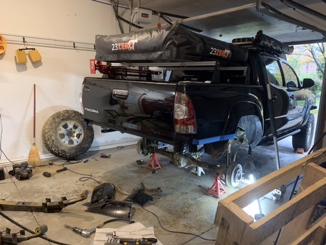

    I’m dreading this... but these need to go in today as well...
    I’m thinking I will cut the bed sides next to give me more room to work.

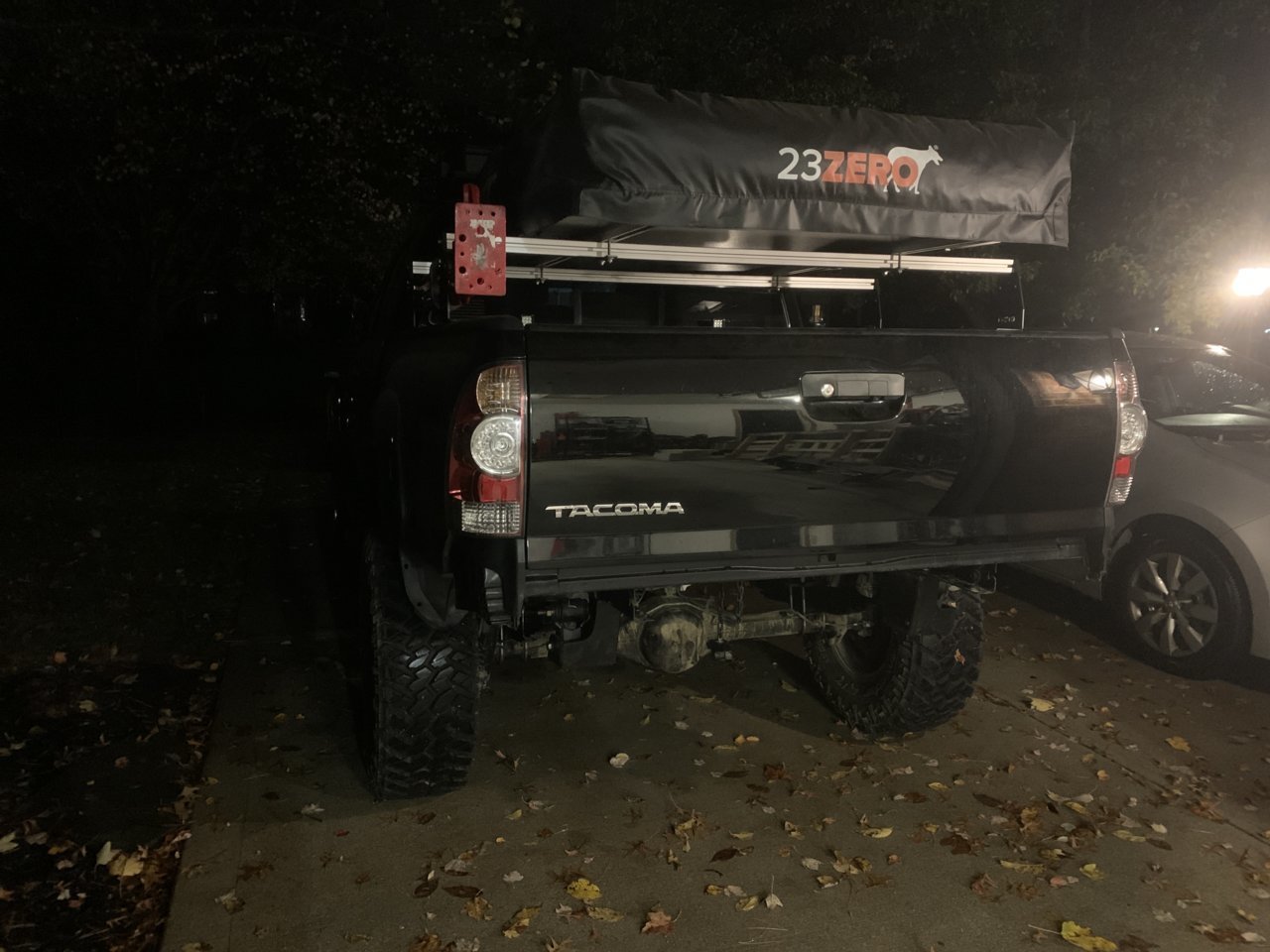

    Deaver Expedition Stg 3 leaves really give the truck some rake when there is no bumper, swing out or spare.
    dirty deeds, geekhouse23 and Casper66 like this.

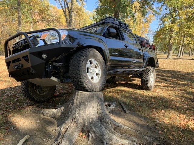

    Ok... went to a local spot and did some flex preliminary testing:

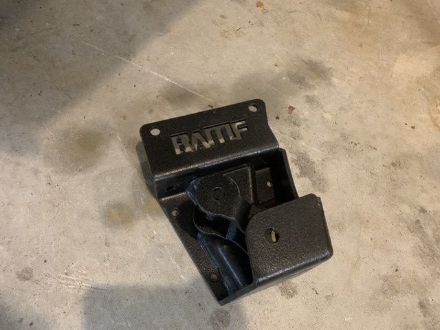

    Hope it wasn't too much of a pain. I do not regret the old shackle flip mod in the sense that the new BAMF hangers were a bolt on swap. Thoughts so far?

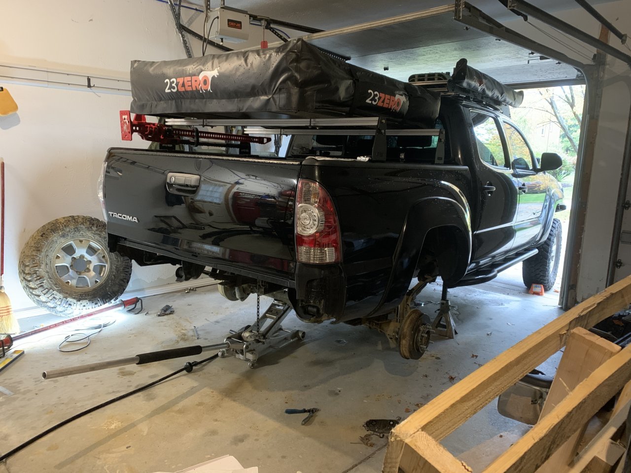

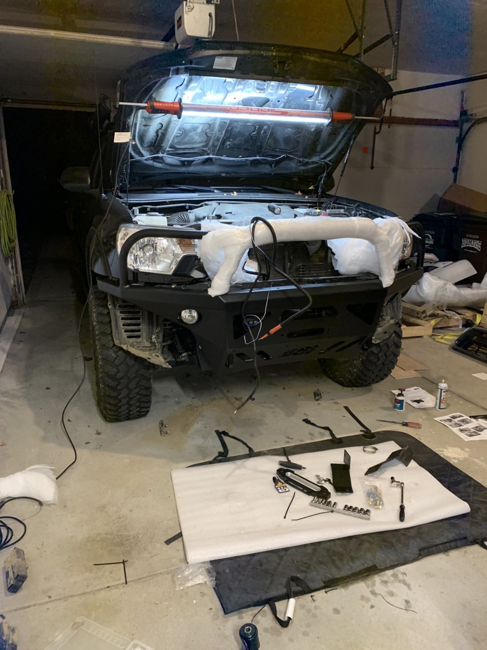

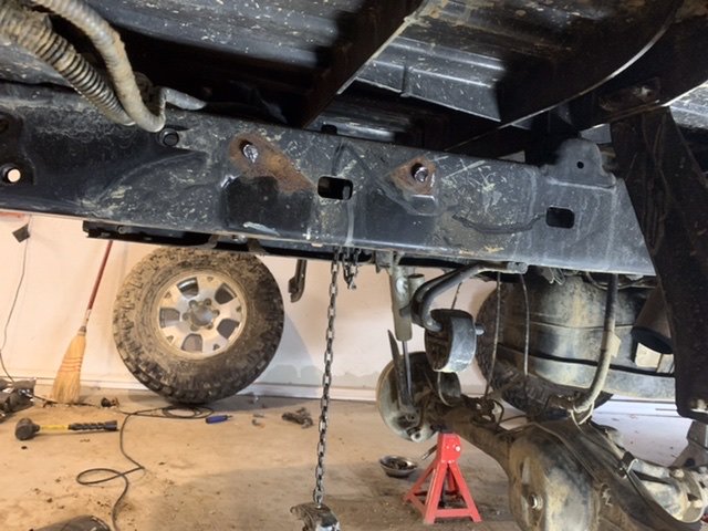

    Install took all weekend... started Friday after work and worked until Sunday evening. All in all, I ended up installing my CBI front bumper, and Smittybilt winch Friday. Then I started the install of the rear bumper on Saturday. It dawned on me that I couldn't finish the bumper install without adding the springs if I wanted to drive the truck. So mid install, I found a breakpoint and began to install the Deavers, BAMF HD hangers and shackles. Honestly, the hangers and springs took the most time to install. Partly since I was working mostly alone. It was almost 1:00 am when I had the rear suspension buttoned up and all the prep work pre rear bumper install completed.
    Sunday, I had my sons help me install the rear bumper and I was off again! I spent all day preparing both swingouts. I ran into one issue trying to get the arms to seat fully on the axles. The dead blow alone wasn’t enough, and I didn't have something I could use to get over the swing-out axle, as well as seat on the inside race of the bearing while swinging a hammer. I ended having to make a tool... I used a hole saw and drilled an appropriate size hole in a 2x4. This allowed me to get around the stub axle for the swing out and make good contact with the swing out hub. This device worked for a little bit until the 2x4 shattered. Luckily, I ended up holding onto a piece of a banister I recently installed. I did the same thing using the hole saw, but this time I didn’t let it go all the way through. The hardwood held up nicely to the dead-blow hammer and transferred the force perfectly allowing me to finish off the install with ease. I wrapped it up by installing my spare tire and roto-pax mount.
    Last thing on the list was the shakedown process, checking every bolt for tightness. Another note is I put anti-seize on everything! Except for the spare tire carrier and Roto-pax mounts… those should never come off. Those got red Loctite. I did order the camp tables but ran out of daylight and decided to save the install of those for another day.
    I have a few things to finish/clean up. First, I need to determine the best way to mount my front shock resi’s since the bumper mount takes the mounting holes for the resi brackets. For now, I have them zip-tied to the front frame rails… but will figure something out that’s more robust long term. In the back, I have purchased the camp tables for the swing outs but didn’t install them. I think I may wait until spring since this truck sees a lot of Ohio winters and salt. In addition, I need to decide if I should move the hi-lift off the inside of the bed rack to the swing-out for easier access. Also, I need to decide on the antenna length to run (suggestions welcome).
    As far as feel… Well, I can feel the weight on the truck. I'm sure I lost another MPG or two! Maybe I should have gone with 4.88 gears over the 4.56's now that I have all of the added weight (and I’m debating 35’s). With that said, the truck rides and drives great. After the flex test, I feel pretty good about my setup. I'm excited to see what it can do on the trail!
