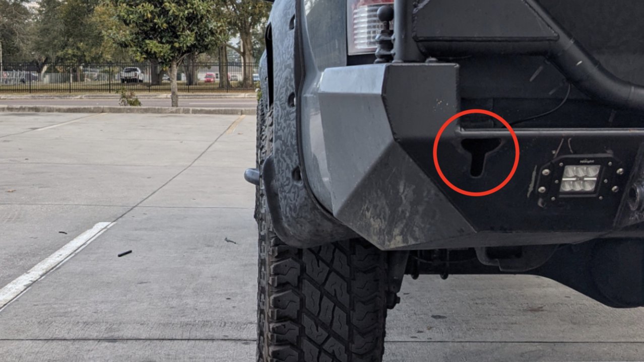

    A hi-lift is only good as a jack if you have jack points that can receive it, meaning sliders, (and I'd highly recommend a slider adapter,) or front rear bumpers with Jack T slots.
