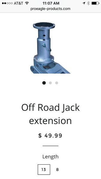

    I use this $50 adjustable jack extension from pro-eagle I bought it from a TW vendor SDHQ. When at home I use it in conjunction with a HF aluminum floor jack and works great

    Does that fit the factory bottle jack?

    It's like an adjustable brick it doesn't fasten to the jack just makes up for space trucks been lifted

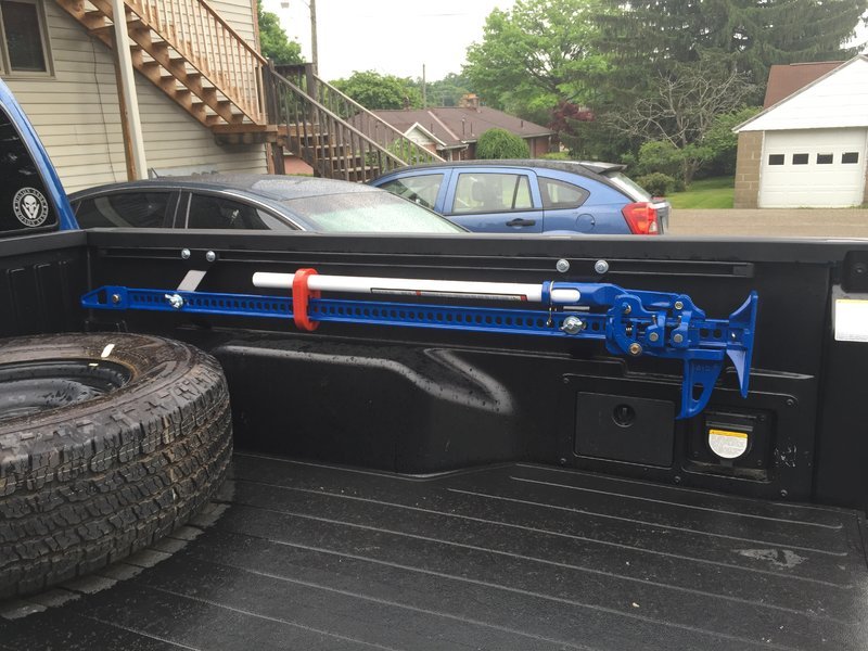

    That bed light bar, I want more info! I've been browsing around for one for my truck for months now. Gotta get sliders first but eventually I want a bar like that.

    Sketchy as fuuuuuuh

    It can be sketchy if you side load it, but fine for straight lifts notice the $300 off-road jack in post #13 that's the same extension in the stowed position when you go use it at the lifting end it's just an adjustable spacer no real side load ability.
