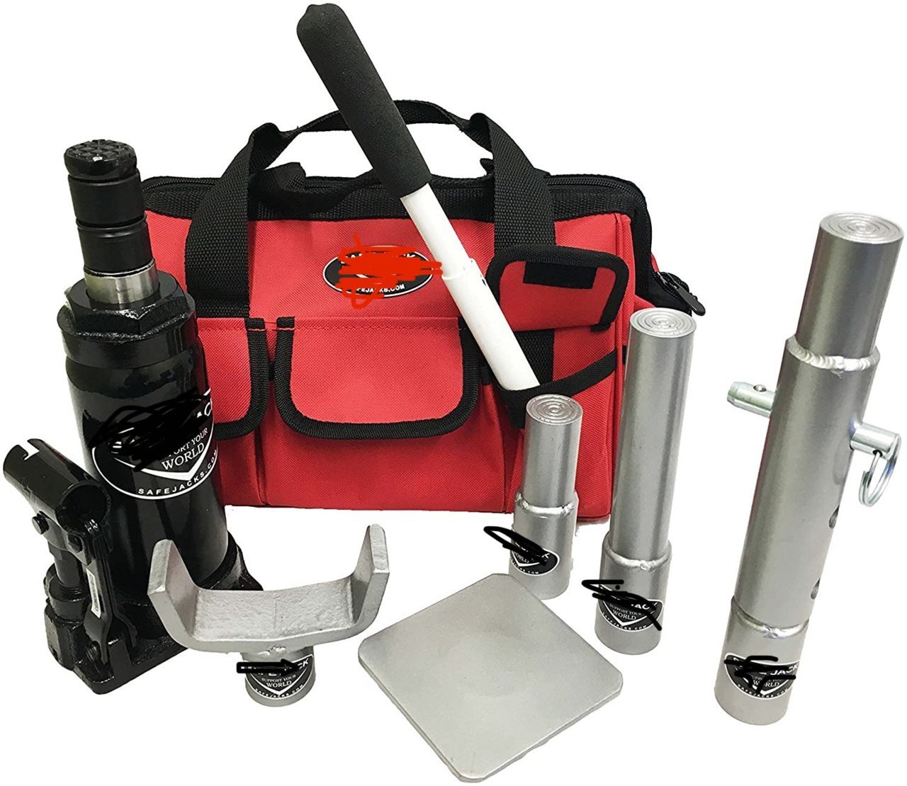

    What are the jack options for a truck with a small lift 0”-2”in? This if for road purposes and a Hi-lift is not recommended for this kind of use. It looks like a bottle jack is the best and most compact option available. The one pictured is over $250. I am wondering if there is any alternatives. I really like the U attachment of this one

    Safejack is worth it

    I really liked the concept and variable height adjustment feature, but not the price.
    So, I made my own.
    Started with a 6 bottle jack and a similar canvas bag from Walmart. Then proceeded to make two sets of 3" and 6" extentions. Had a buddy 3D print me a handful of the bottle jack screw filler piece. Seems a bit sloppy to me, so I just made me a split sleeve out of 1.5" x .25" wall DOM tubing. Much tighter fit. Also have a few different tops for different uses.
    I still need to make the one piece that is adjustable from like 5"-8", as well as a couple of different bases I can play with.
    Probably have $40 into it right now. Will see what powder coating will cost this winter when I get back to it. But for now it is functional.

    SafeJack FTW
