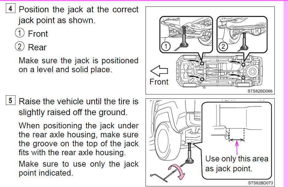

    Your lift doesn’t change a thing because the tires still droop the same distance. Your 32” tires make about 1/2” difference. The OEM jack should work fine if you used appropriately. Check your manual for the correct jack points. They are the bulge near your oil pan and the diff pumpkin. You might be able to get away with a few other places as well.

    Yeh mine are at the axle tubes. The OEM bottle should have a sticker on it with the jack points.

    For all of those arguing about the OEM jack. I have 35" tires and a 2.5" lift and the OEM bottle jack works fine. My LCA is 11.5" off the ground and my rear diff is about 10.5". The OEM Jack has a max lift height of 19". I don't need that much to change a tire.
