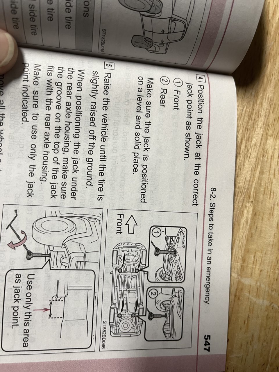

    Lift points are arms and diff, a lift kit doesn't raise those.
    Tires move diff and arms away from the ground.
    Stock 31" tire vs 33" is only 1.5" higher from the ground.
    Edit. See your manual.
    No one I work with would ever lift it from the frame, nor would I. Takes too long and its unstable.
    There's actually a 5th secret spot on the center member as well.

    I would in a pinch for sure but the actual front "jack points" are not easy to figure out where Toyota is saying to put the jack. IMO

    I agree, I would never have thought to jack it from there, but I suppose they don't like the arms for their angle.
    I just did a bunch of work on a Tacoma and Xterra at home using jacks and stands and never came close to jacking from the frame haha.
    On a hoist, the forward Toyota positions are perfect and I use them daily. You jack the rear right before the frame curves up for weight distribution.

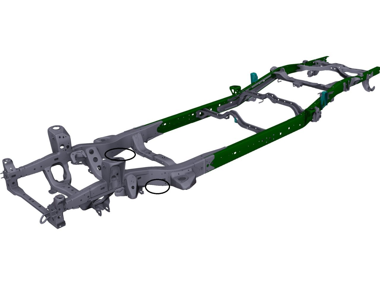

    Where the picture in the manual shows is not the lower control arms. IMO...I could be wrong. I really just want to understand because I have no friggin idea what the hell the photo in the manual is trying to indicate.

    It's the frame 100% They want a solid surface to jack from.

    Yeah, I am saying, under your truck maybe something to jack from in that location? Under my truck, nothing.

    Nothing lower than the frame I should say.

    Toyota does do a really great job of pointing out exactly where to jack the rear of the truck.
