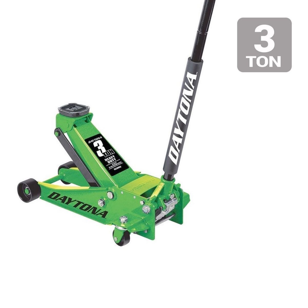

    I have the Daytona 3 ton jack ( 18-1/4 in max lift ht and is a harbor freight snap on copy) and that doesn’t actually lift the tire off the ground when using the frame as a lift point (at least in the front) so I am still some what confused….

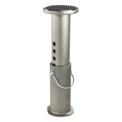

    Do I need an extension like below?
    Would a 4x4 piece of lumber be enough and is it safe?
    Can I use the control arm safely to jack from?
    (Of course if I were anywhere even remotely under the vehicle I would use jack stands)

    You will find people that tell you blocks of wood are perfectly safe. Then you have people like your dentist that still got hurt doing it (probably) the right way.
    The only real safe way is to lift from the frame with a jack that has rated metal supports and then using plenty of jack stands with redundancy.
    I think a jack extension like you posted is fine IF you then use jack stands. Another really safe option is the SafeJack system. But it’s pricey. It’s still just a bottle jack and extensions though.
    personally, I wouldn’t trust wood.

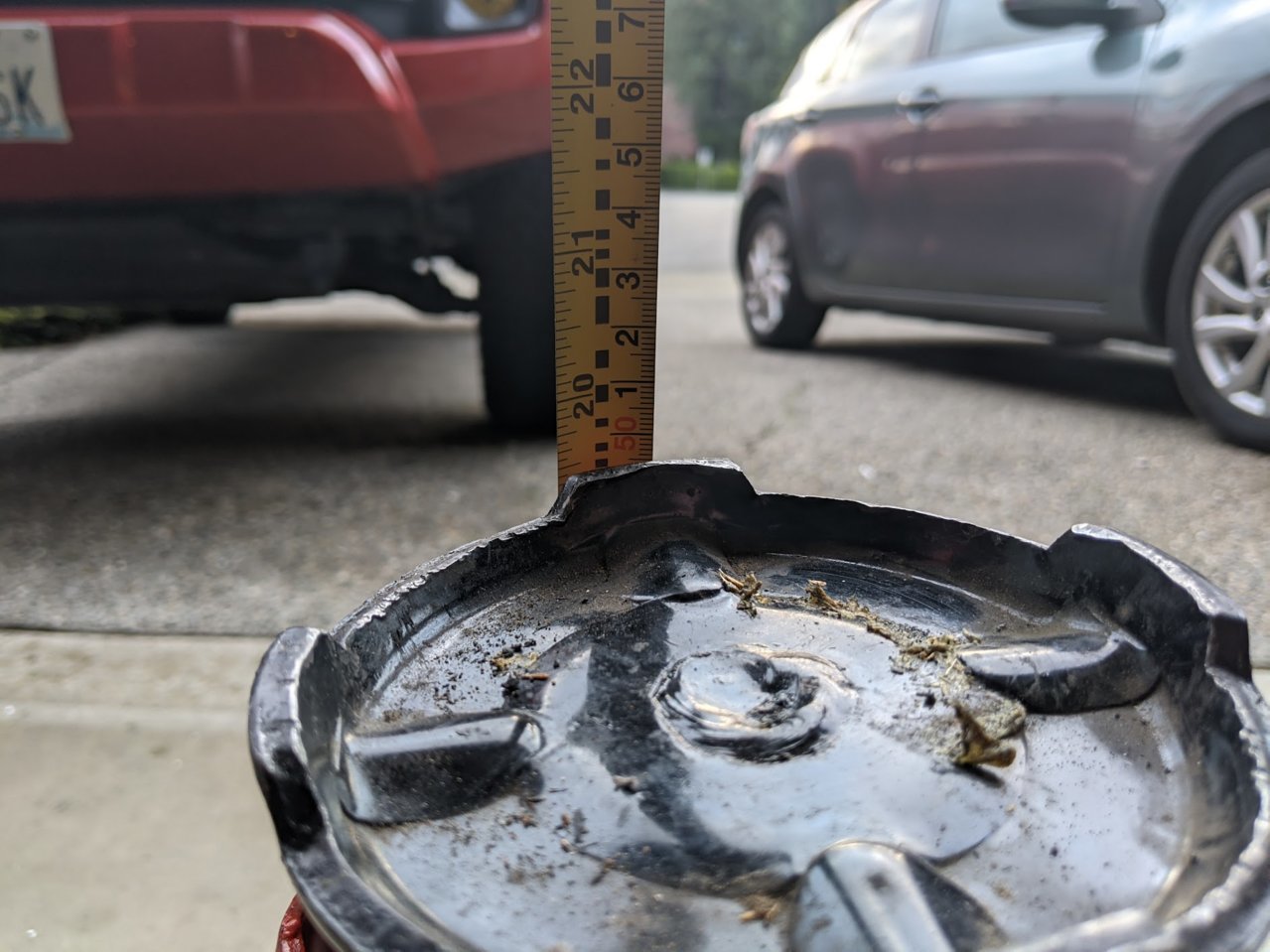

    After my suspension change, the old jack didn't lift my Taco enough to rotate tires. The solution was go get the Daytona Long Reach version. My old jack was good for 19.5in. The Daytona LR is good for close to 25in.
    This wasn't even the max height:

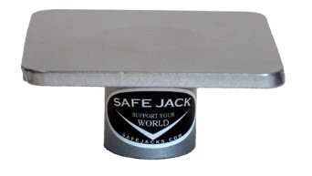

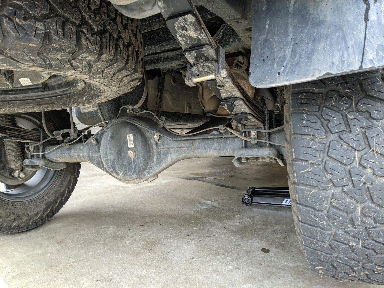

    OP, wondering after these two pages you decided on where to jack from? I am in the same boat. I did buy the safejack $220 start kit package and I carry 2 10" pieces of 8x10" pieces of wood in case I need more height. I also keep the factory jack available if I need to get a little bit of prelift in order to fit the safejack underneath. I haev a 1.5" lift and 32" tires.
    • Rear points on the axle points I am comfortable with
    • Front? Agree the manual is trash on the specific location. I figured out where it was, sorry I don't have pictures, to me it doesn't look like the greatest spot. If others have used the LCAs in a pinch just for a tire change I will consider that depending on the situation.
    Edit: the safejack kit comes with this flat base. It gives you a 4" by 4" platform for better stability on a frame point. For the rear axles it includes the second picture which seems significantly more stable than just the top of a bottle jack.
