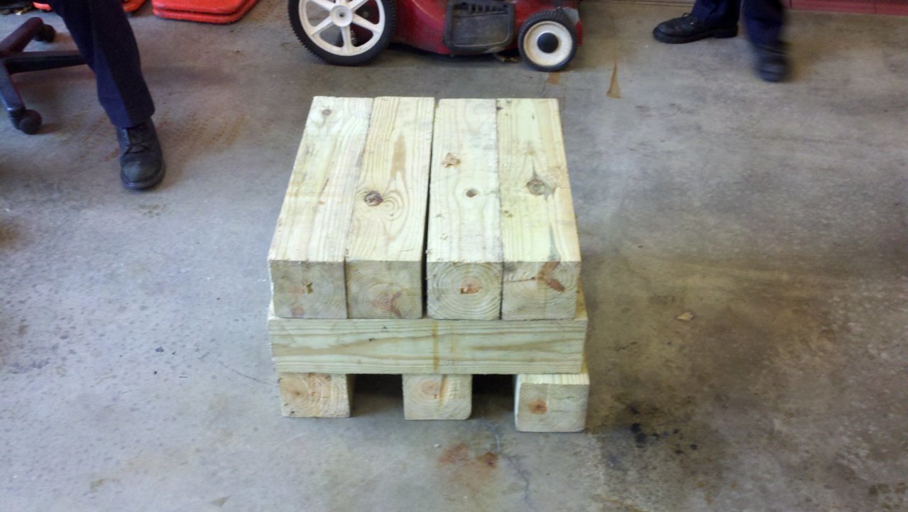

    Use cribbing to raise the jack up. And then taller jack stands. No need to replace the jack. It is still rated to lift the vehicle. This is used for heavy equipment support regularly. So done properly it is perfectly safe.2011-12-02_13-28-49_864.jpg
