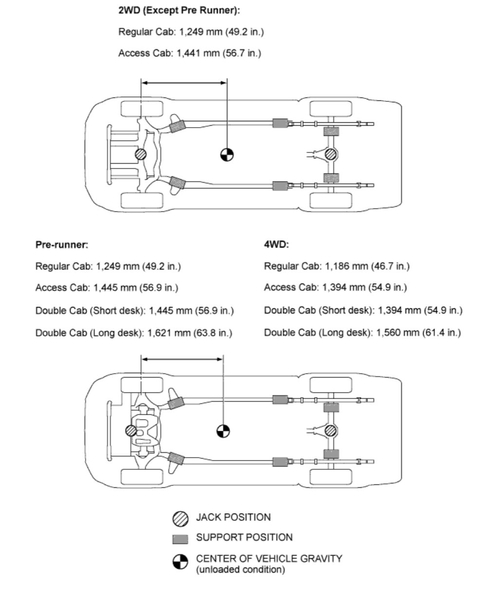

    2012 Tacoma owner. Where’s the exact jack points for the rear of the vehicle? I was thinking just jacking up on the rear diff case for tire rotation. Any thoughts or suggestions? Thanks.

    rear diff is how i do it. Any point on the frame works, but going under the rear diff means you don't have to take up suspension travel.

    I jack up from the center of diff and use jack stands on the axle near the leaf spring. That way you have both rear tires in the air.
    Consider adjusting your drums while the rear wheels are off.

    It's ok to use the rear diff as a lift point. However, be sure to put stands on the frame rails and chock the fronts if you're pulling tires.

    I never hear about or see people jack their vehicles up on the differentials. I’ve always wondered why as it seems like a good place as a jack point. Could it cause any damage to the differential?

    I do it all the time and have been for years on both my 2nd gen and 3rd gen. Never had any issue.

    Would a 1 ½ ton floor jack be enough for a stock Tacoma Extra Cab?

    Nope. Many cars have the rear diff housing designated as the rear jack point, including our trucks. In the case of solid axles, like our rear axles, the axle tubes are also often designated as jack stand points too.
