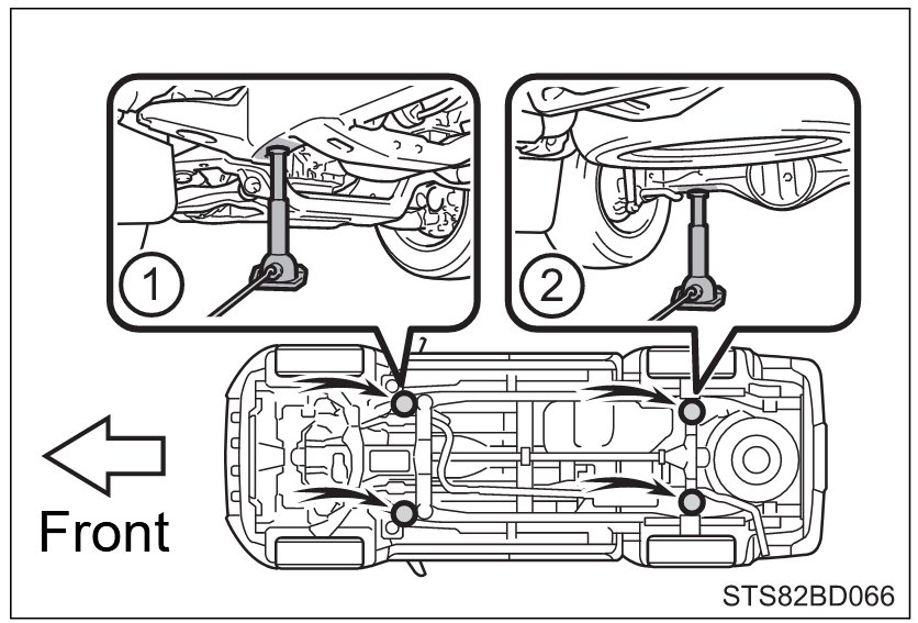

    Going to install some spacers and I also want to be able to also regularly rotate my tires
    (Sams Club did not rotate my tires as I paid them to do—I labeled them and so could tell )
    Can someone direct my to a resource on the proper points to apply jacks/jack stands on my truck, 2017 SR5 access cab.
    And any advice on rotating tires would be appreciated too.

    on the frame behind the front wheel, and under the rear axle is where I typically go with them

    Don't forget a floor jack and jack stands. And, if you don't already know, always, always use jack stands and never ever rely on the jack alone. I usually get the axle on the stand and then leave the floor jack barely touching as a backup, y'know, in case of earthquake or something. And I usually jack from the base of the shackle and put the jack stand just inside cupping the axle housing, as it's often hard to get the base of the jack stand further out with hitting the wheel. And finally, once up on stands, rock the hell out of the truck to make sure it ain't coming off the stands.

    Page 604 in the owner's manual.

    Make sure you put a piece of wood between the stand and frame. I used the stock bottle Jack and I think it possibly dented the frame slightly on my truck. So just be safe.

    Can you explain what I'm looking at in the last picture? The arrows pointing to the gray tab on the frame...

    Yes.
    pickup truck
    @moondeath took this photo several years ago....
    No need to jack 4 spots.
