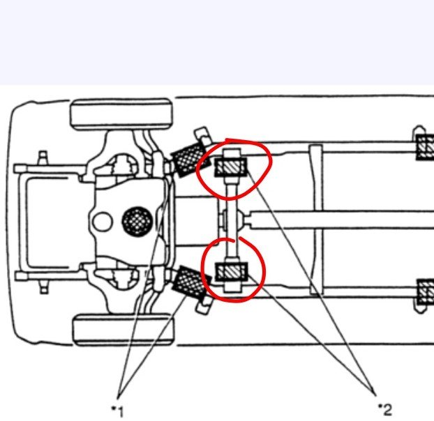

    429
    Tacoma 2.7L SR
    glad i read things on here ;0)
    didnt know i can place jack stands..

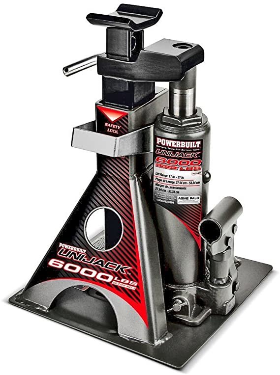

    3 ton stands will be fine. I'm going to rotate mine this weekend also with a pair of 6,000lb. Unijacks. The manual says front to back, back to front so I'm jacking up one side at a time.

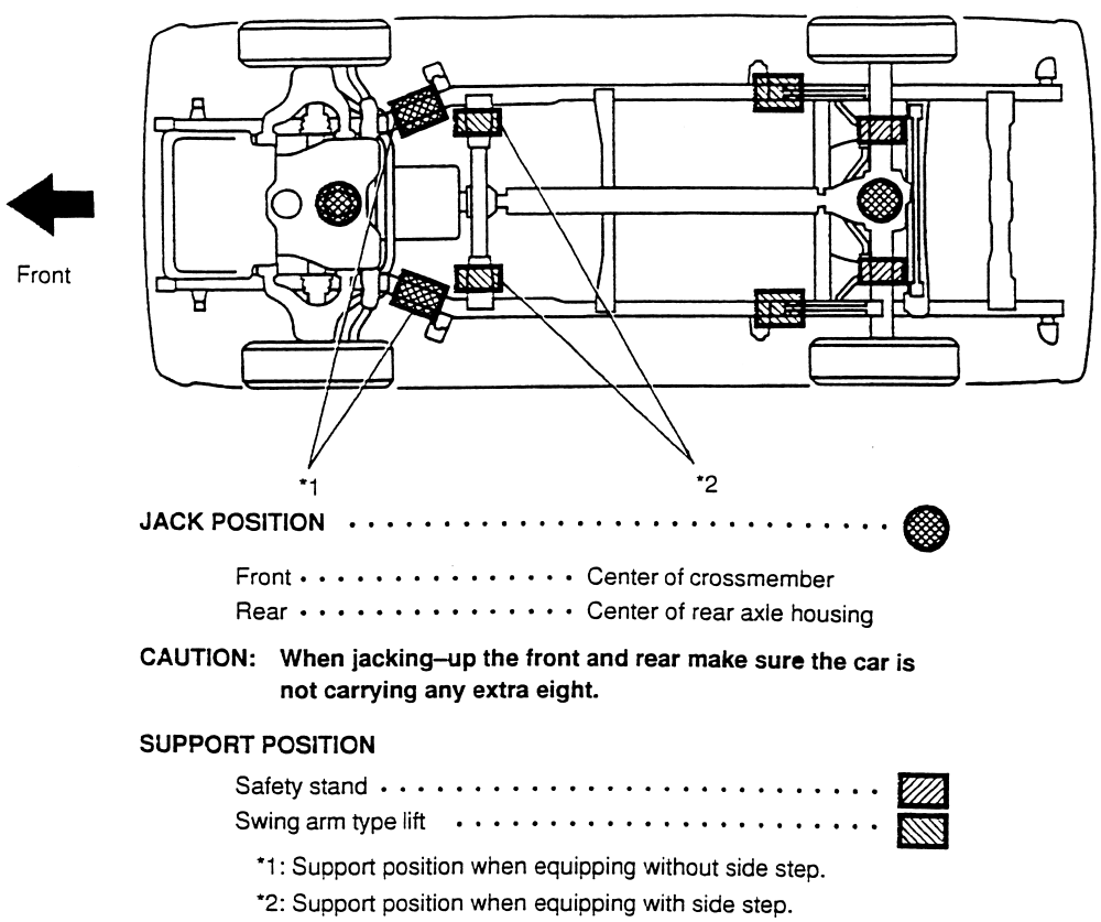

    I once tried jacking the truck up by the pumpkin with a Safe Jack cradle adapter once because of this drawing. Just as an experiment. It was unstable so I dropped it down immediately.

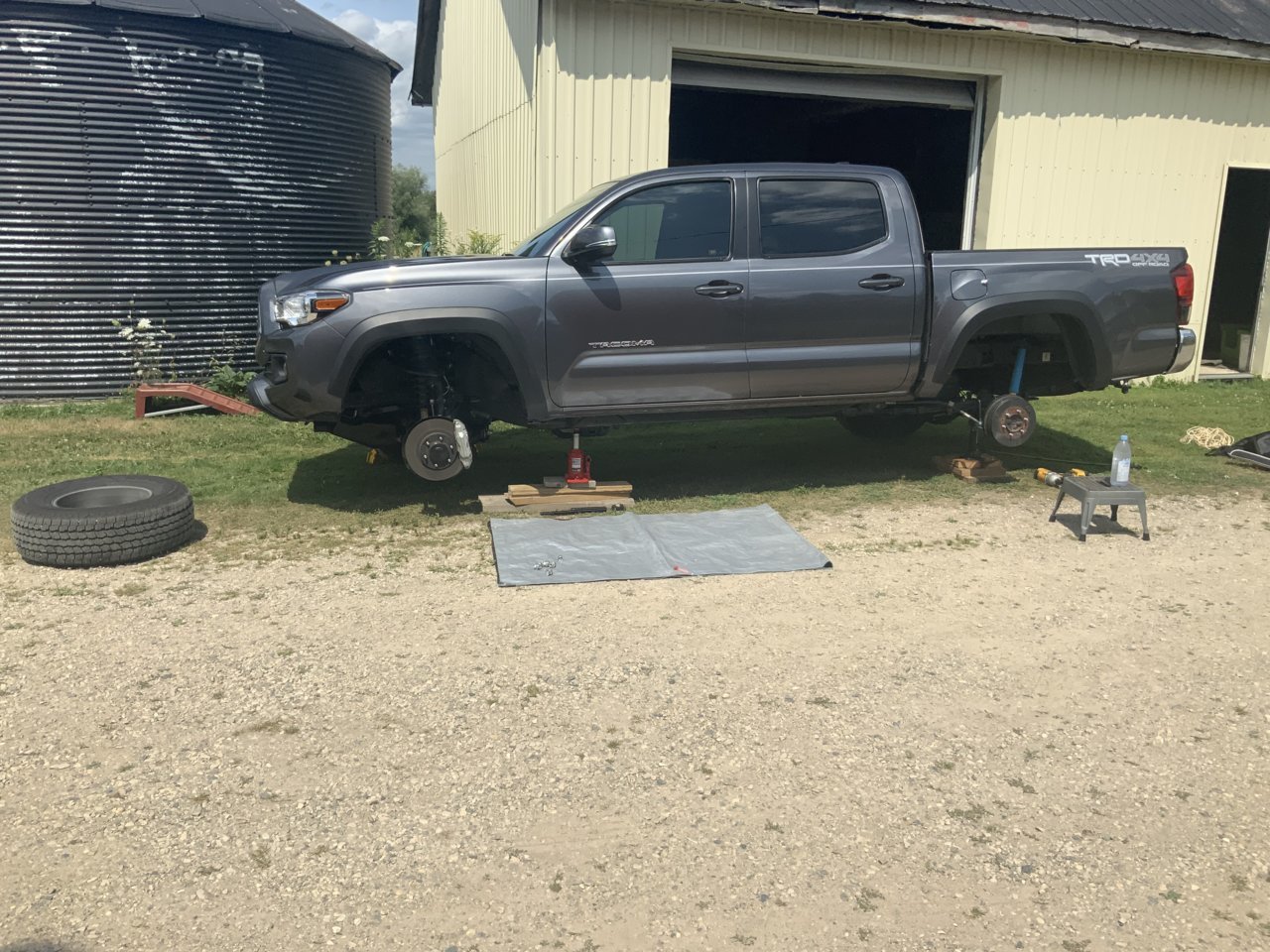

    2019 DCSB TRD OR 6M
    ARE Z series cap w/Bedrug
    Yeah, the best place in the rear is the axle tube just like the manual says. This photo is just for show. I use pieces of wood underneath for a good foundation. As you can see I have two six-ton jack stands if needed. These are from Canadian Tire and are not from China. Very solid, well made, and not expensive.

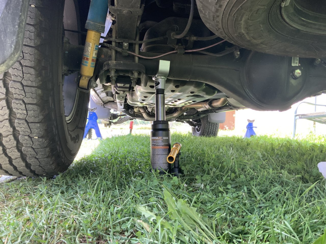

    69,557
    Azusa, CA
    It can get wobbly if the jack isn't centered under it just right, I've had that happen too using a floor jack under the diff. Just lower it back down and center it again.
    It's definitely only temporary, just long enough to place the jack stands. I would certainly never rely on the diff to hold the truck up just because of how easily it can sway side to side
