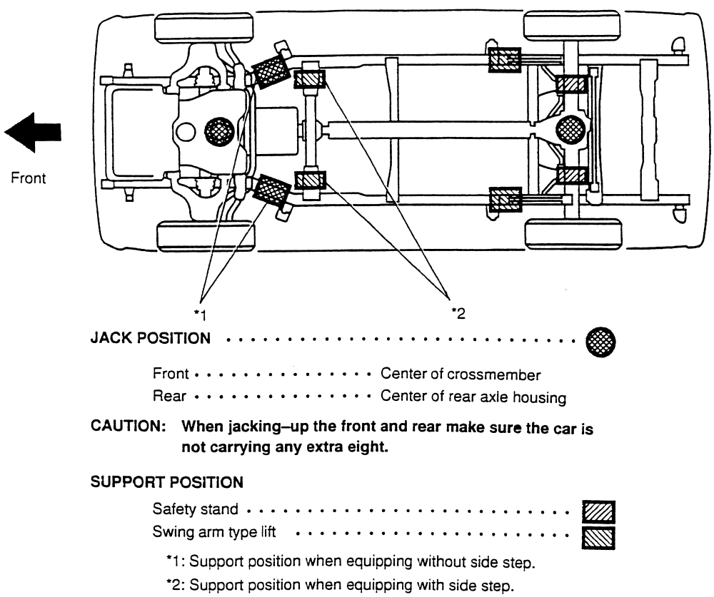

    2003 TRD Crew Cab
    None
    I want to place my floor jack under the cross member support beam directly under the engine and transmission, just as an added safety precaution, while I have jack stands under the Frame side rails. Is this a safe place to lift the truck, or will this cross member not support the weight of the truck. I know stupid question, but better to ask before hand.

    @Black DOG Lila , I didn't think so, but could I use it as a secondary safety measure, to place my floor jack under it, with just enough force to hold, after I have the jack stands in place on the main side frame rails. That way if I had a jack stand mishap, it could buy me a few precious moments to get the heck out from under the truck.

    According to our user manuals the front crossmember is the proper jacking point
    I lift mine from there all the time, no issues
    The stock skid plate even has an opening in it for you to put a jack through to reach the crossmember there

    I lift from the lower arm, the frame, any crossmembers, i mean you gotta use your head and not try to lift more than your jack capacity, as each spot you lift at it will weigh differently.
    @CrippledOldMan you can put a jack stand under a crossmember. Just think of how the weight would react if one of the stands did fail and then that stand/crossmember is now supporting it? Are you still safe? That's only factors I'm seeing

    I've done it via the LCAs before too, just not very easy to do with a floor jack because it doesn't sit flush underneath the arms. But a bottle jack under the arms works well, that's about the only place my bottle jack can lift the truck from now because of my lift lol.
    If I'm using my floor jack, I lift the front via the front cross member (same spot as in the photo above) or via the rear diff if I'm doing the rear. If using my Hi Lift I use the sliders, or occasionally I've lifted the rear using the trailer hitch but sliding the hi-lift into it. Works really well just better make damn sure the front wheels are chocked

    the front crossmember is part of the frame, welded in place and not removable unless cut out. I jack from this point on a regular basis as @eon_blue pointed out it's more difficult to get under the LCA due to how close in proximity to the tires the solid point is.

    My favorite spot to lift up the front of the vehicle equally is the front cross member under the back of the engine near the trans bell housing. This is the cross member that the steering rack bolts to. I've been using this a jacking point for a long time and it can support the weight of the front of the rig no problem. So, I agree with @eon_blue and disagree with @Black DOG Lila. I place 6 ton jack stands in the #1 position shown in the picture @eon_blue provided.
