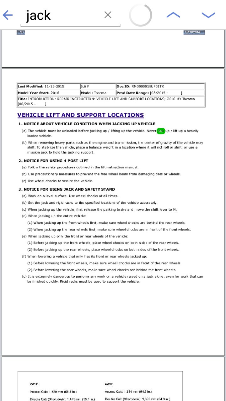

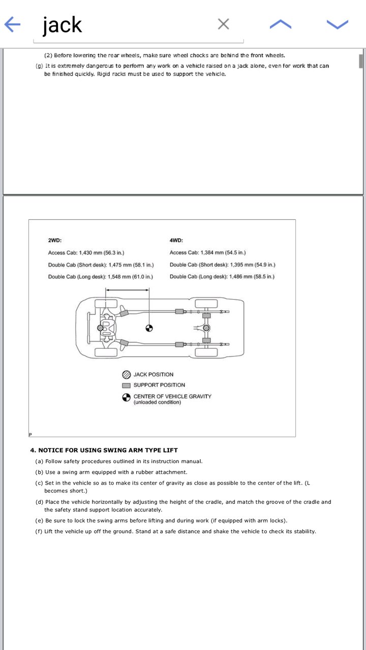

    Can I safely jack up the rear of my 2017 Tacoma using a floor jack under the "pumpkin" with a piece of 2X4 as a buffer?

    Yes. The truck can be raised via the pumpkin

    So you can put the jack stands under the rear axel, correct?
    Before you do any work, right?
    Since "safely" is a priority.

    you can do it without the 2x4
