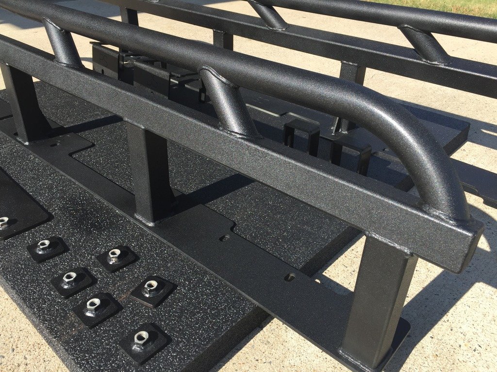

    What style bolt on sliders do you have? Many require drilling holes in the frame and a few use the factory frame holes. There's a difference in the hardware that is required for each. If you drill your own holes then any washers will do. If you have drill-less full flange bolt on sliders, then you should have been sent special nuts with a large washer plate welded to it. This keeps the nut from pulling through the very larger factory holes in the frame.

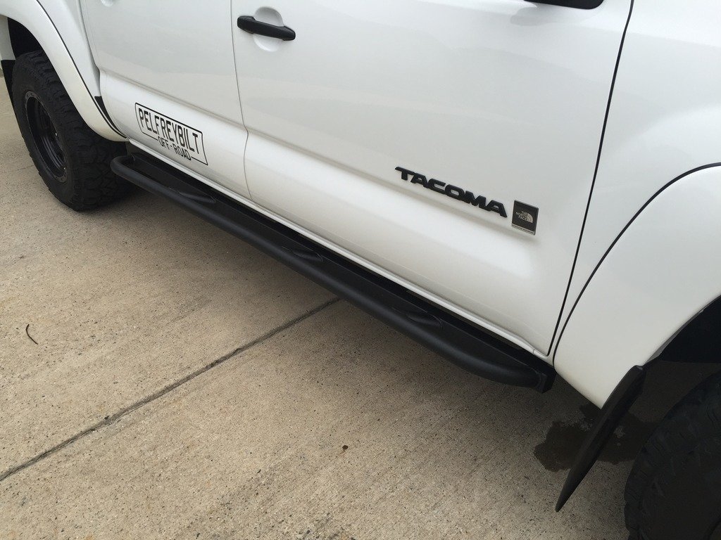

    Unless I misread your post you still didn't say what brand of Sliders you got? I've got a set of Pelfreybilt Bolt on sliders and I jacked my truck up the other day when rotating the tires just to see how they performed. No movement what-so-ever. It's always been my opinion you get what you pay for. Not saying yours are bad (dunno). But when buying armor for your truck the last thing you want to skimp on is the quality. Never mind the price.

    For the washers don't use a thin fender washer. Get yourself some square washers. They are about 1/4" thick. They sell them at Home Depot for about a buck each.

    You need washers that are at least 3/16" thick. I doubt the frame is actually twisting. More than likely it's the flanges of the sliders giving.
