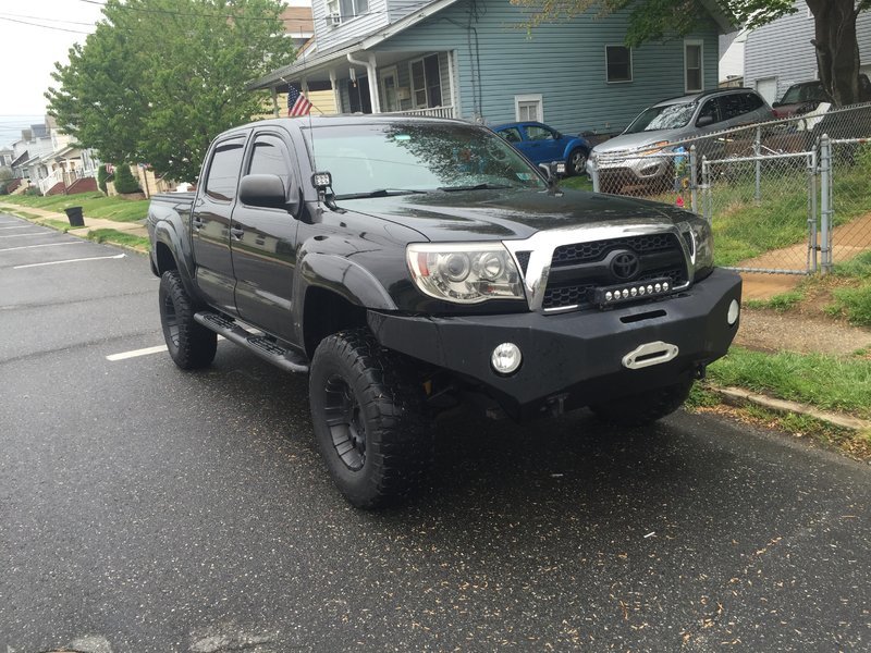

    I did the full OME 2.5-3" lift (dakars in the rear) and have 33" tires (285-75-16 BFG M/T) but you would need rims with the correct offset and I changed out my front bumper to a plate bumper (had to remove the front splash guard in the wheel well and all the mud flaps)
    always get complements that it looks mean, but not over done. The wheels fill out the wells and provide a nice height , without looking like mini big foot

    Added the prisnu rack and light bar since then.
