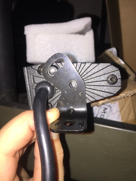

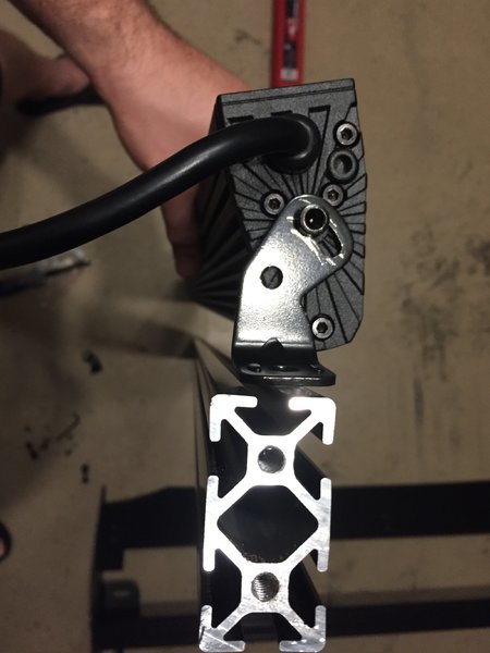

    Haha all I did was use the stock mounts that came with the light bar and mounted them to the Prinsu rack with upside down 1/4-20 carriage bolts
    Sorry to let you down boys. I made my own cutout in the Prinsu wind deflector so my light bar sits a little bit on it and basically keeps anything from moving. The light bar hasn't moved a millimeter since I installed it

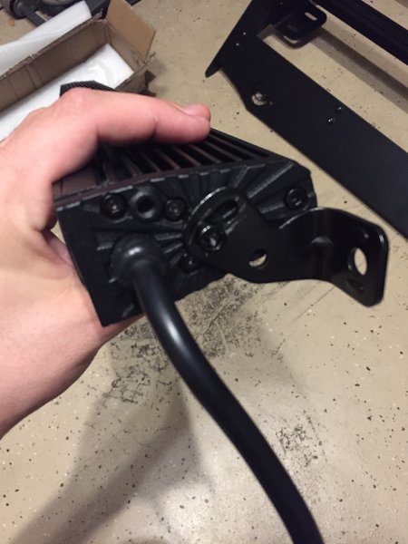

    I've never had an issue adjusting mine. Mine hung from a bar though. Maybe that's why?
    Edit: just figured it out. You got the mount backwards. The adjustable part goes on the center bolt. The top bolt is the fixed one.

    Why the hell didn't I notice this? When I was sizing it up I never considered flipping it upside down to try that out. Need to see how this will mount when I get home if I flip it.

    lol i gotta go check it out, i swear i flipped flopped and turned it every way..
    edit: ok so i see, like the light mounts under something.
    you just gotta push the bracket a little hard against the rubber around the wire to make it adjust.

    We are in the same boat :frusty:
    EDIT: But they way you suggested worked out great still, solid as a rock for the time being
