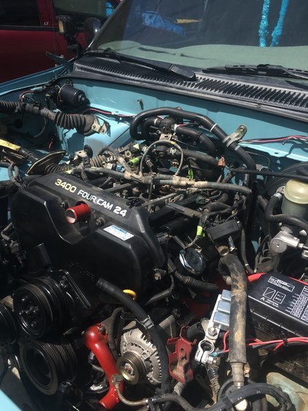

    Made some progress today. Got the motor seated, and most of the vacuum lines attached. Got a lot of the electrical hooked up too.

    Update: finished the vacuum lines. I didn't realize how interesting it would be to re-route the lines, bypassing the stock ADD system on the '96 parts truck. Less vacuum line, less failures, right?

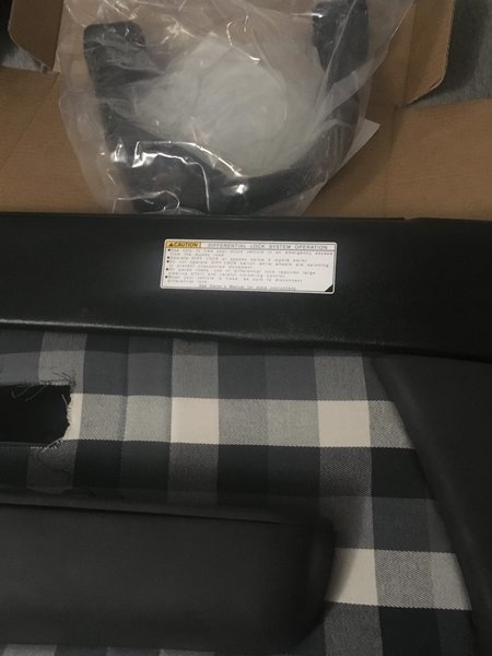

    IMG_0984.jpg Got some goodies today. I got some stickers from Low Range Off-road. The first is a new 3400 v6 sticker for the timing cover, and the other is a super cool e-locker sticker for the door panel. Also, got my SPC UCAs in today.

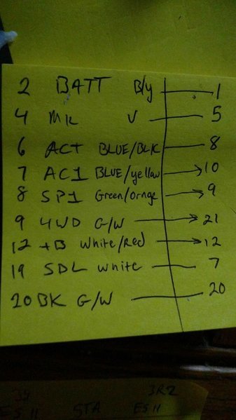

    IMG_1001.jpg Looks like I was wrong, and the body harness is different. Looks like I'm going to learn how to re-pin ecus. Luckily, a very helpful soul on on Facebook did the hard part for me. The Toyota community rocks!

    Update: according to a very extensive pin guide for the body harness plug (E-5), there are 3 extra wires from the 3rz harness that are left over with the 5vz harness:
    Nsw: ignition switch/starting relay.
    Sta: starter cranking signal input
    Fc: circuit opening relay.
    Damn, I'm confused.

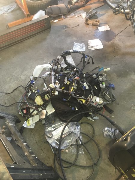

    IMG_1021.jpg Update: I'm just going to swap the damn harness over from the parts truck. Half way there:
