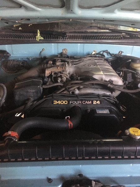

  7. May 5, 2017 at 11:17 AM
    #207
    jacobrippey
    jacobrippey [OP] It’s always Taco Tuesday Instagram #rippstik
    Apr 26, 2014
    #128494
    920
    Jacob
    Surprise, Arizona. USA
    2004 Tacoma DC 4wd
    Find me on Instagram: @rippstik
    IMG_1030.jpg Looks almost factory.
  8. May 5, 2017 at 11:31 AM
    #208
    alee891
    alee891 Destination: unknown
    Feb 3, 2015
    #147815
    5,765
    Austin
    Black Hills
    Tacomaless
    Is it in one piece yet?? ;)
    jacobrippey[OP] likes this.

  10. May 5, 2017 at 12:05 PM
    #210
    jacobrippey
    Apr 26, 2014
    #128494
    920
    Jacob
    2004 Tacoma DC 4wd
    Not yet. Motor starts, runs. I still need to burp the coolant, assemble the interior, attach transfer case, and do the driveshafts. Just about there.
