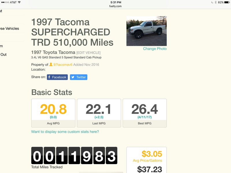

    V6 5sp,RegCab,TVS1320 Supercharger, 56mm pulley, methanol injected Haltech ECU, AC Tvs1320 supercharger,(MUST DO) every 125,000- 150,000 needs rebuild Projector headlights HID 5 speed manual Amsoil for all drive train Smaller 56mm custom pulley, (MUST DO) 2004 DESNO fuel injectors, zero ping ping, 2004 side door mirrors Dick Cepek Rims, Michelin tires LTX, ATM Pathfinders Dynopro ATM ( that last 100,000 miles) Now running Dynopro ATM mud and snow tires KN cold air intake Cat back dual exhaust with ss exhaust tip, Raised exhaust tail pipe to 2" below body line Optima*dry cell battery,red top Alpine sirius radio, 200 watt amp, focal is165 split door pod speakers Focal door speakers Subwoffer behind seat Viper alarm, Electric Locks Dark tinted windows, bucket seats corbeau lg1 Tacoma Rubber floor mats TRD fender extenders, Bilstien shocks, King shocks JBA UCA trailer iv hitch, electric brake control, Drilled slotted brakes, High carbon steel (MUST DO) EBS green stuff 7000 series pads(MUST DO) TRD engine oil cap TRD stick shift, Marlin crawl shift kit. Rear sliding window 2002 4Runner functional hood scoop cut into Tacoma hood, 4Runner dual overhead map light Gentex Auto dim + Compass + Temp, garage,rearview mirror Snow Methonal kit stage 2 Custom 3 core aluminum radiator Linex bed liner Haltech stand alone ECU, Intake supercharger gauge. Stainless steel brake lines, Custom leather wrapped steering wheel, Haltech stand-alone ECU,
    My average mpg is 20 or so with the supercharger with v6, is normal

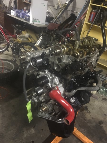

    That motor looks so good :thumbsup:

    Wow :eek: looks great. Much rare. Lots of unique

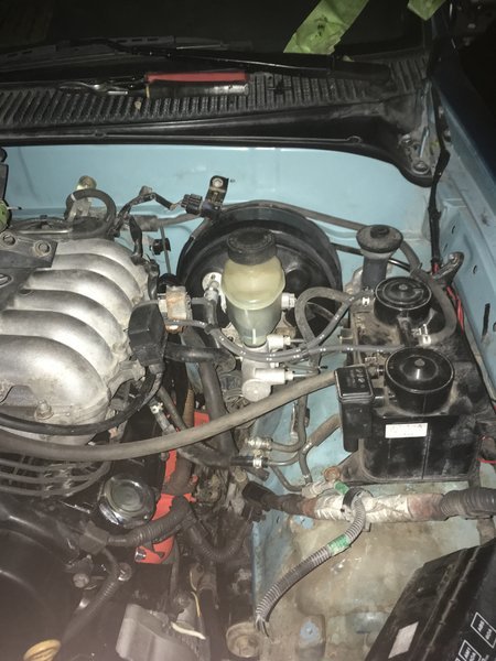

    Hey, OP, great work. I'm planning a 3.4 swap in my 96 5 Lug.
    Since your truck is a 3.4 now, what are you doing for an EVAP box. Your truck had a round can to start with right? What did the donor truck come with?

    Had to swap in ALL of the original v6 emissions equipment. I'd highly recommend getting a full donor truck if the budget allows.

    I've got so many spare parts left over from different things that I've got a donor in my shed.
    Did you have to add any hoses to the older EVAP stuff.

    Nope. I had to reroute some stuff, but everything worked pretty well.

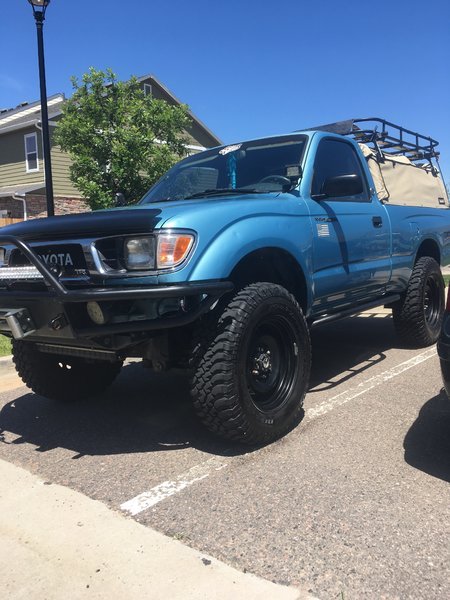

    Is this gonna be a legal swap? Is Colorado one of those super anal states like CA?

    Looks like it will be inspected by the emissions place. I called ahead. They said that as long as the emissions equipment is the same as the 96 v6, I will be fine. Both fingers crossed. It's still registered in AZ, so I'll have it inspected in Octoberish.

    Nice. I think here in CA you even have to use the same transmission and exhaust manifolds that came with the engine... and the ECU of course

    Luckily, the v6 and 4 cyl have different trannies. I legit swapped everything over. Only thing that stayed was the cat and fuel tank.

    Update: fixed the transmission leak, o2 sensor, and a broken window switch. Almost good as new.

    I also think the engine has to the same year or newer
    Op I love your truck.
