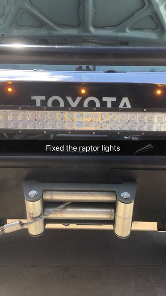

    IMG_0092.jpg Finally got the new raptor lights in, and hooked up the winch. Driveshaft is getting 2" added to the length, because it is vibrating quite badly, and a balance didn't work.

    My buddy DJ and I wired up my lights last night.

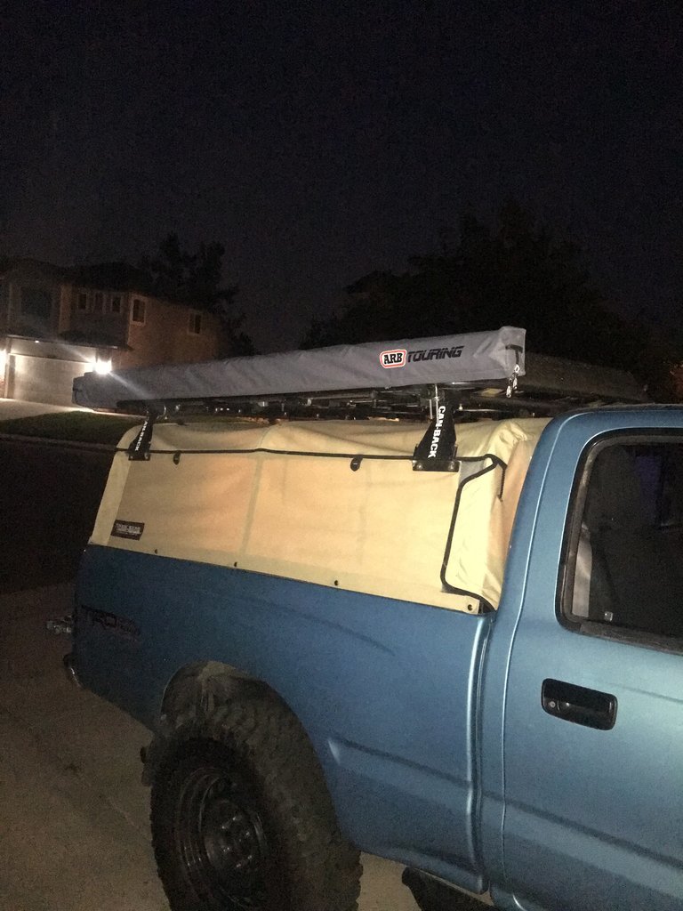

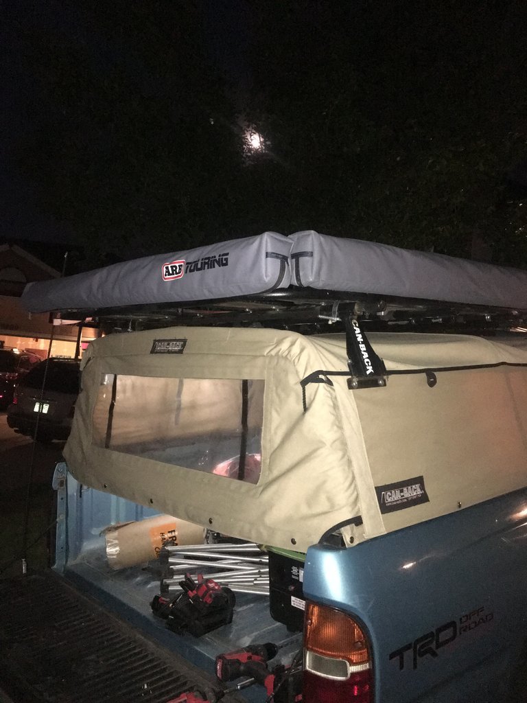

    Awnings installed. Can't wait to use them for camping this weekend. More pics to come.

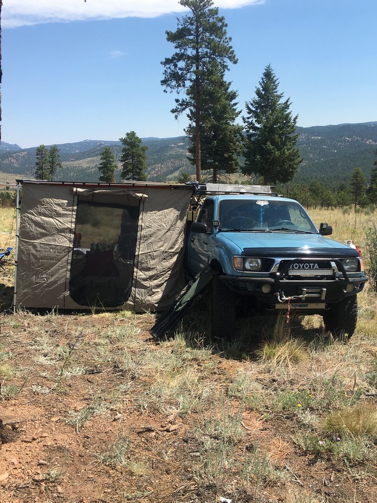

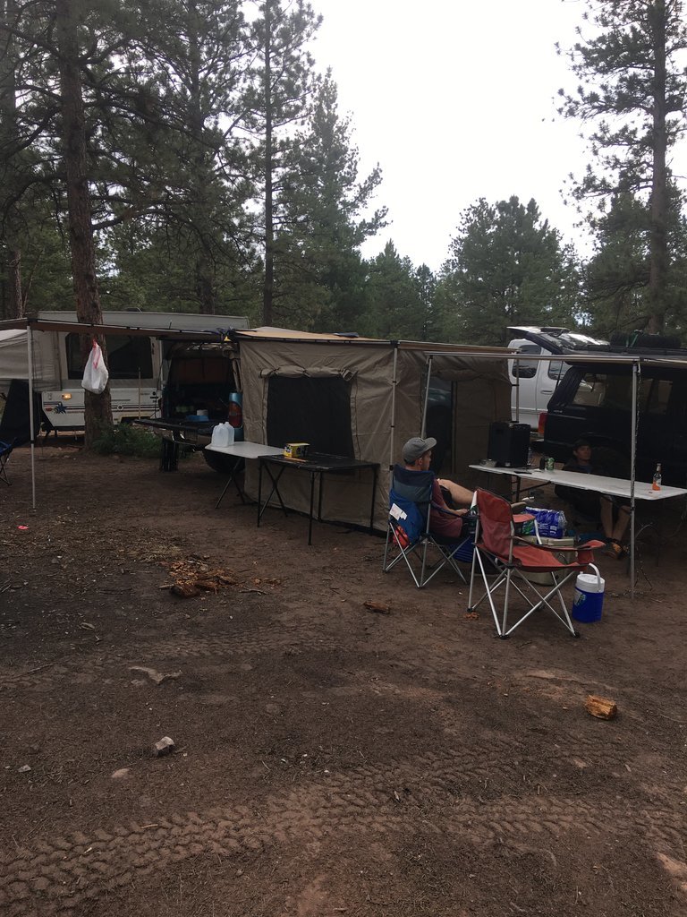

    IMG_0124.jpg IMG_0137.jpg Went camping this weekend. Got to test out the ARB awnings and awning room. Freakin epic. Easy to set up, tear down, and was really good with the wind. 10/10 recommend. Went camping with some Jeep guys, one of which had an awning. Made an awning city of sorts, as seen in the second pic.

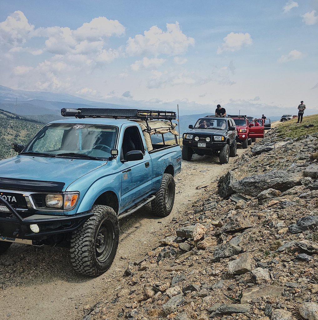

    856582FB-903D-444E-943A-9FB8ADEC8C08.jpg 8E44B70A-99B3-4876-84EB-E02BCB492852.jpg Took the yota wheeling today. It did great, as expected. I'd love some better shocks at some point down the road.
    Side note: recently, I've fixed most of the bugs from the swap. It now has a working horn, brights, etc. Now, all that's left to figure out is: 1) e locker 2) cruise 3) cams rattling 4)exhaust leak 5) a/c and heat
