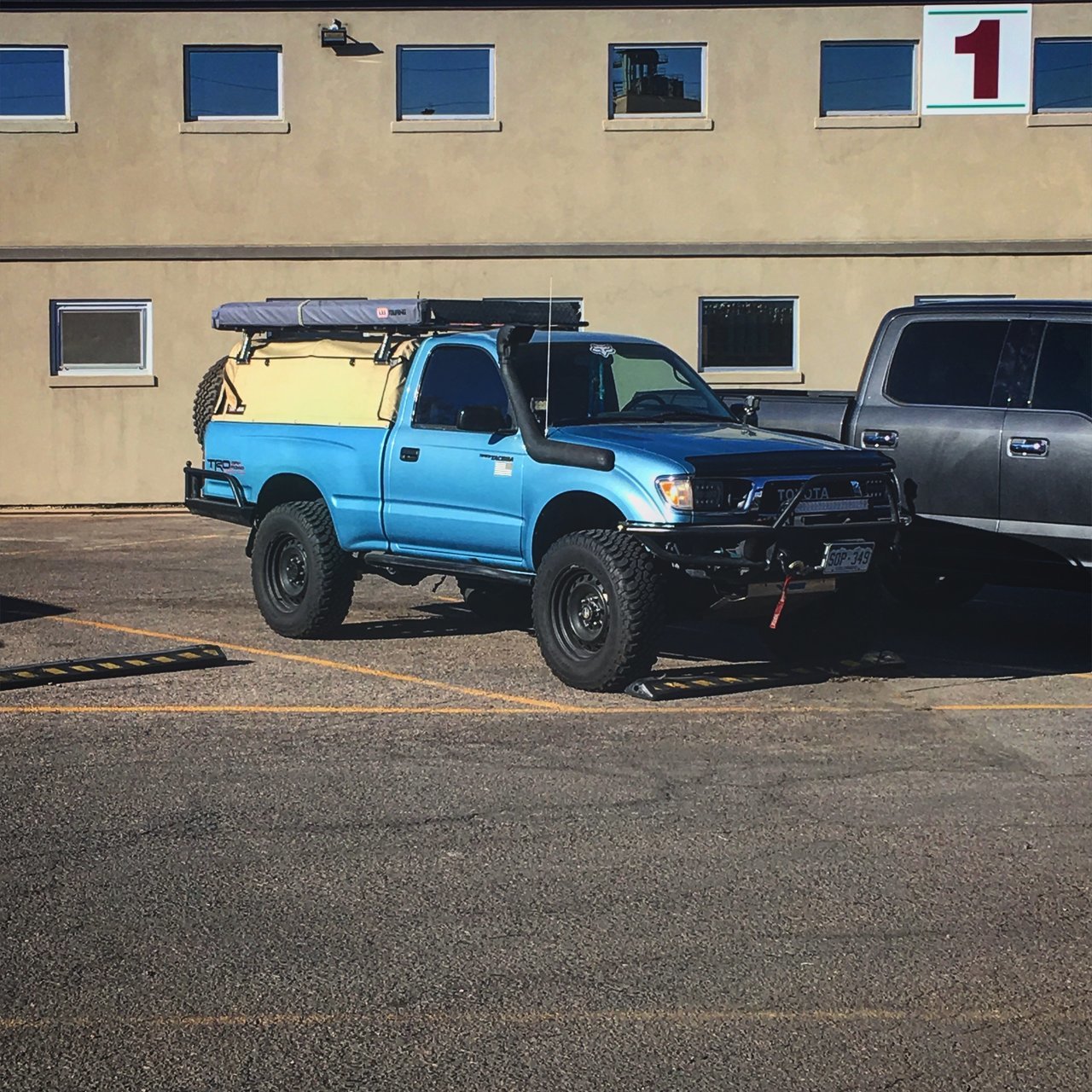

    Wow that snorkel is way cheaper than buying the arb one on Amazon. Was installation pretty easy? Where did you get it from?

    Got it from EBay. Installation was not that easy without a template (I'm sure it was included but lost.) with the template, it would be easy-ish.

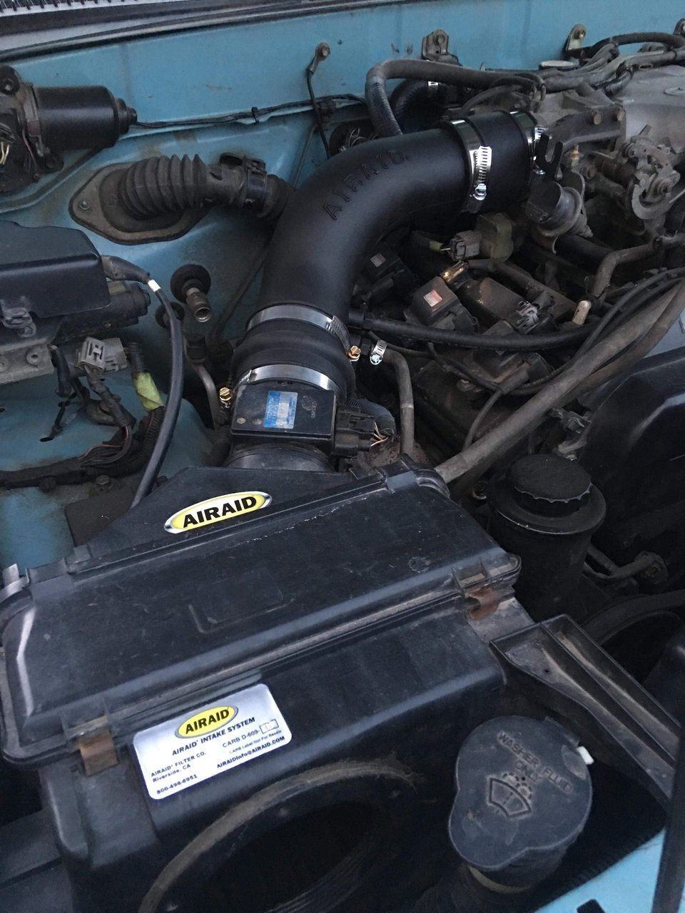

    So, I figured out why some people don't like K&N filters...
    Last weekend, I drove my truck, parked it for 15 mins, and went to restart it. It would start and then die shortly after. Wouldn't idle easily. After doing this a few times, it threw a few CEL's. I narrowed it down to a gunked up MAF sensor, due to the oiled filter. Once I cleaned the MAF, I ordered an AFE dry filter. This should fix that issue. Anyone else have issues with K&N?

    I'd really just recommend a nice OEM quality WIX paper filter. They're cheap and filter very well, your air filter isn't restrictive enough to warrant changing to some thing else unless you're boosted.

    IMG_1461.jpg Ignore the dirty engine bay, but here is the fix for my old, dry, cracked out intake hose. New air filter is coming soon.

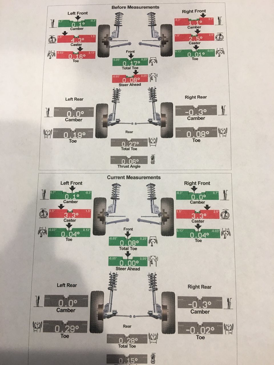

    Got an alignment today from Toytec Lifts. Blake killed it today! 10/10 recommend.
