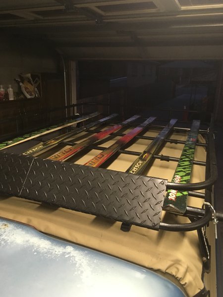

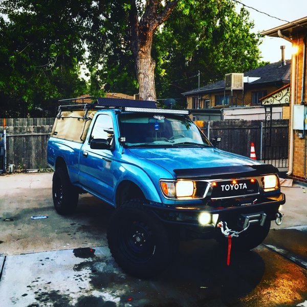

    IMG_0084.jpg IMG_0054.jpg Got a roof rack. Cl find. Bottom is made of skis! Excuse my vanity, as I lay on top.

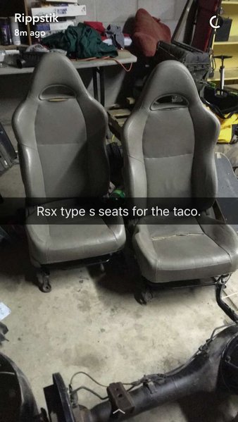

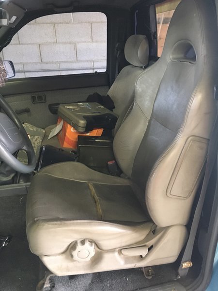

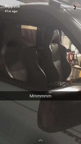

    IMG_0081.jpg IMG_0082.jpg IMG_0087.jpg Because the stock seats suck, and my buddy crashed his rig, I scored some cheap Acura RSX type S bucket seats. They are super comfortable and I highly recommend them.

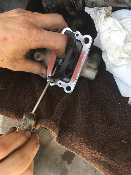

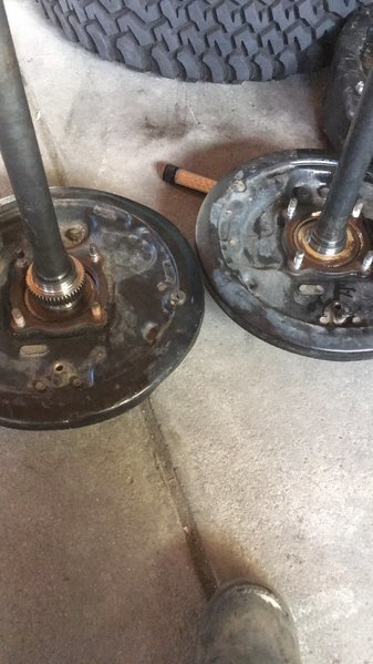

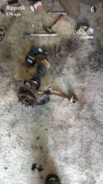

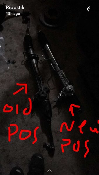

    IMG_0110.jpg IMG_0111.jpg IMG_0113.jpg IMG_0128.jpg My truck now earned its trd off-road badge. I sourced a new front diff with 4.30 gears, and rear e locker axle (4.30 gears). We modified the front diff to go from an ADD setup to a manual one. Wired it together with a 12v guy e locker kit. Also did ball joints while we had it all out. Also did a new steering rack (#3) and a transfer case seal. Two solid days of work. Realized later that week that putting a non-abs axle shaft into a abs axle housing creates bad leaks. Damn. The e brake locations are different. Later made a custom bracket, that still needs fine tuning.

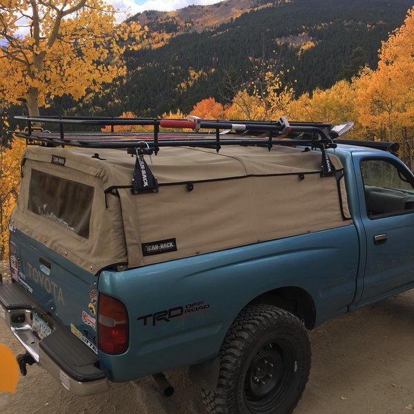

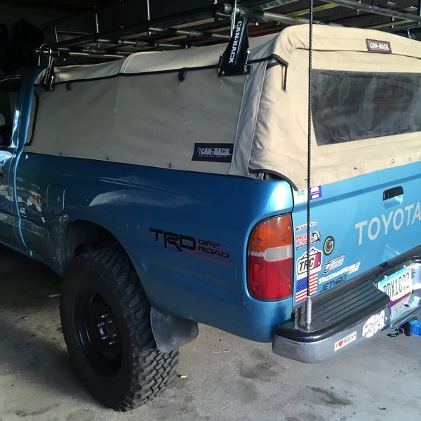

    IMG_0203.jpg Earned that damn trd badge

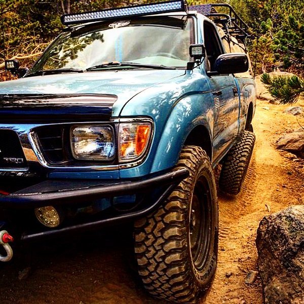

    IMG_0207.jpg IMG_0217.jpg IMG_0225.jpg Went wheeling near Idaho springs, co, to test out the locker and new gears. It was beast!

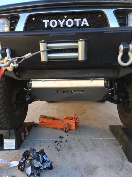

    IMG_0283.jpg Got a stainless skid plate from a group buy here on TW. I'm glad I got the auto one, because someone had installed an auto radiator on my manual truck.

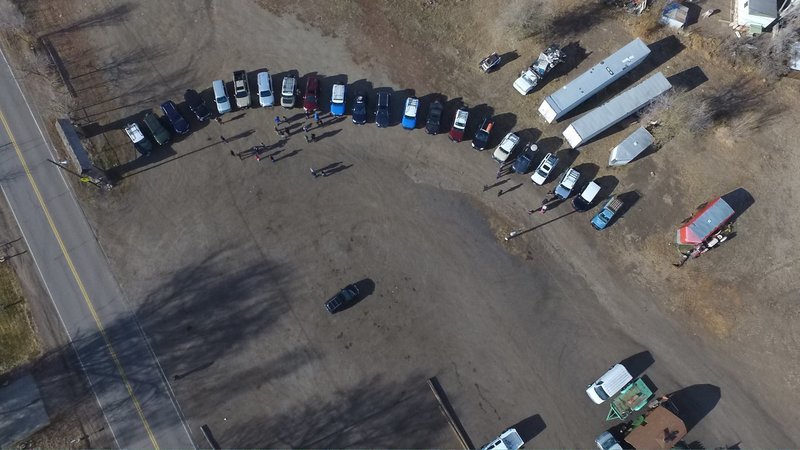

    IMG_0379.jpg Went to a Toyota FJ group's toys for tots run. See if you can spot my old taco...
