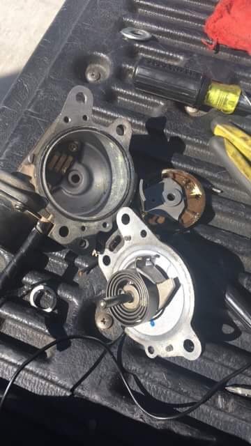

    IMG_0764.jpg Week update. A/C is fixed and is working well. Pretty stoked about that.
    Today was devoted to fixing the ELocker. Spent over 10hrs getting it working. What a bummer. Rewired it with the 12V guy harness. Wouldn't work. Tore it apart. Spent many hours fiddling with the actuator (pictured). A few things were up with it, but apparently, the electromagnet was gunked up. Installed and the axle locked...and wouldn't unlock. Fiddled with that for a while, and came to find that the actuator fork was pretty seized (after a year of sitting). Finally got it working. What a PITA.

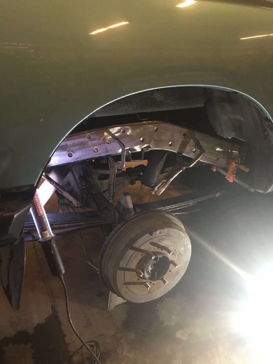

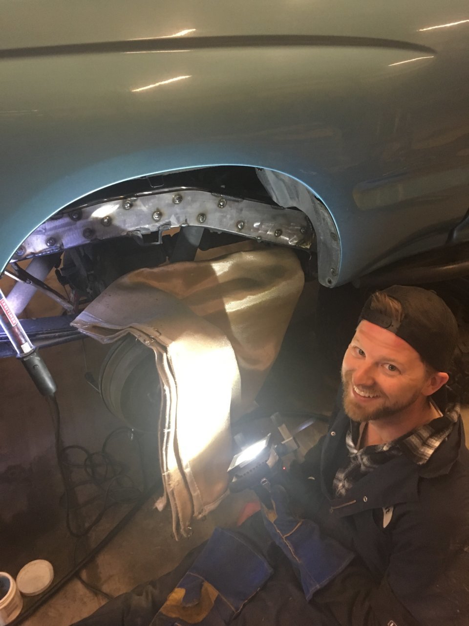

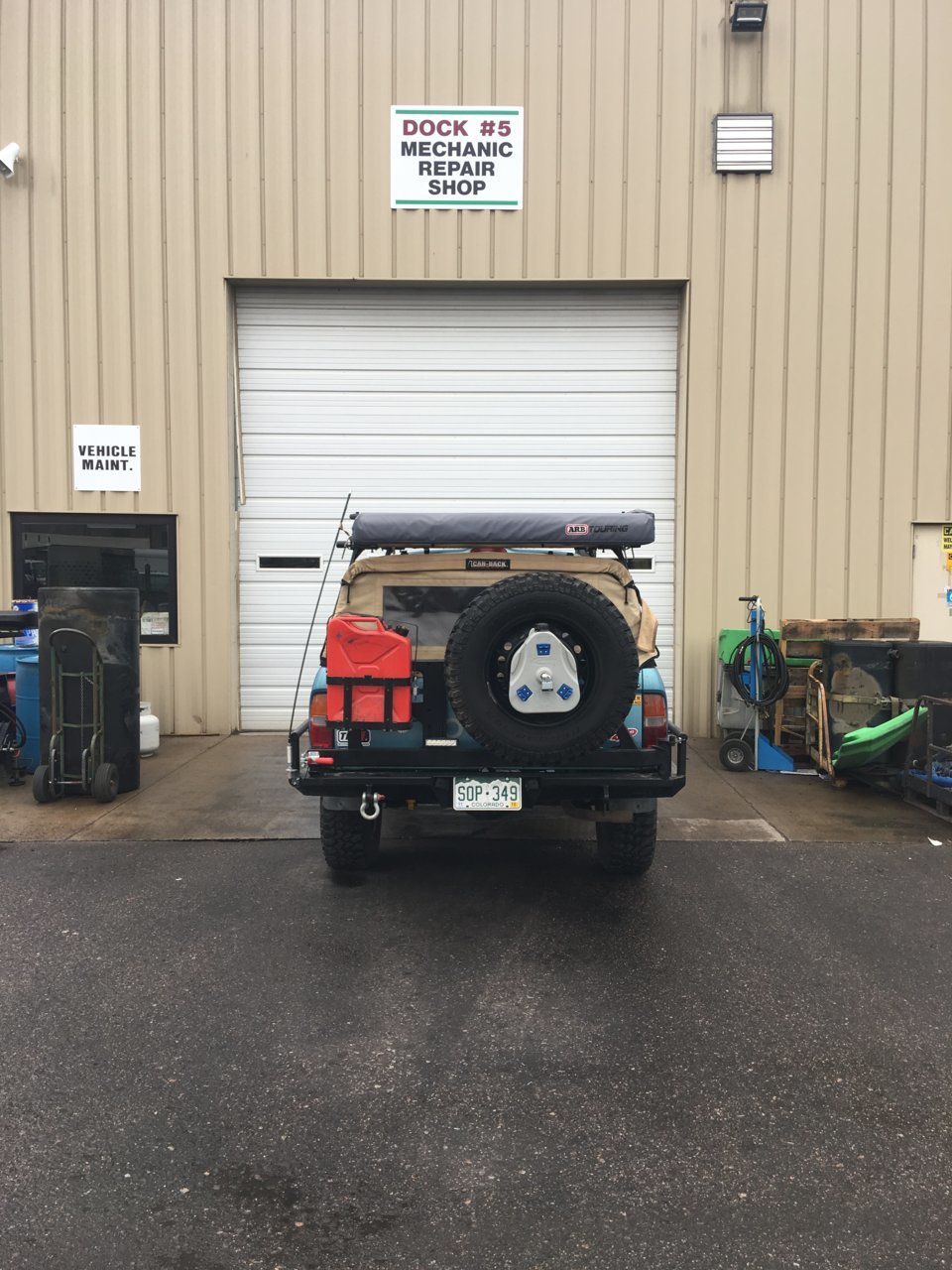

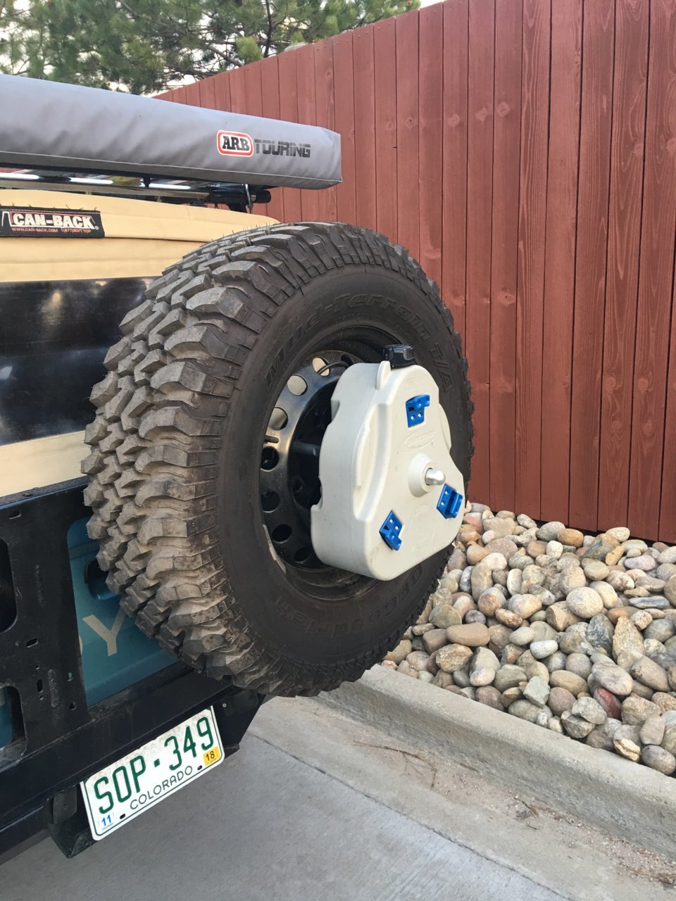

    EE9246CE-76CB-48A9-8CEE-92391438CD16.jpg CCFDD4DA-43D7-4DD3-A4F5-290230170343.jpg A474B75F-998B-4DDE-A306-E2336ADFAA98.jpg
    Got the CBI frame plates installed. Thanks to my friend, Tim (pictured) for welding them in. I also installed some bigger 4Runner mirrors today (hoping to wire them as power mirrors eventually).

    0E544042-4E8B-4800-9622-94C1725CEED9.jpg All clean! Happy Sunday.

    Find me on Instagram: @rippstik
    Update: the frame plates have made a monumental difference in ride quality. If you have a heavy rear bumper, do yourself a favor and get those plates.
