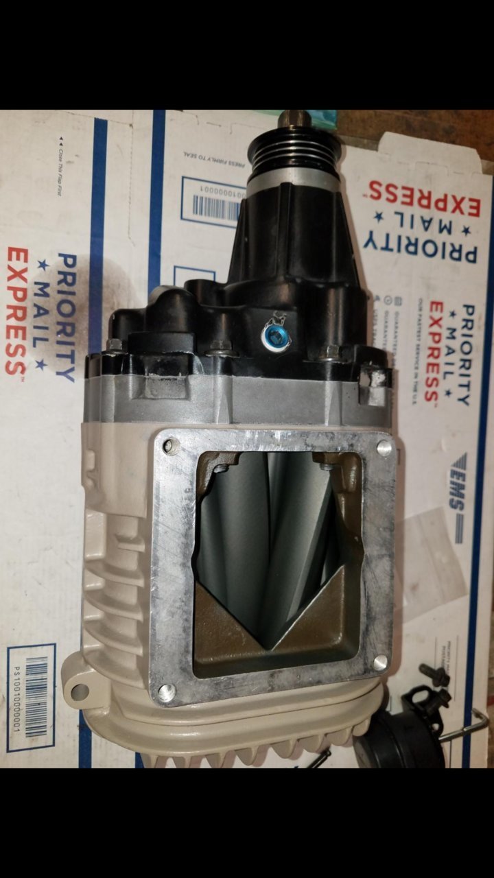

    All is good thanks, did a bunch of maintenance too, plugs, wires, all the hoses and vacuum lines, heater core hoses, Airfilter, fuel filter, valve cover gaskets, replaced front diff bushings and had the supercharger rebuilt and inlet and outlet both ported.

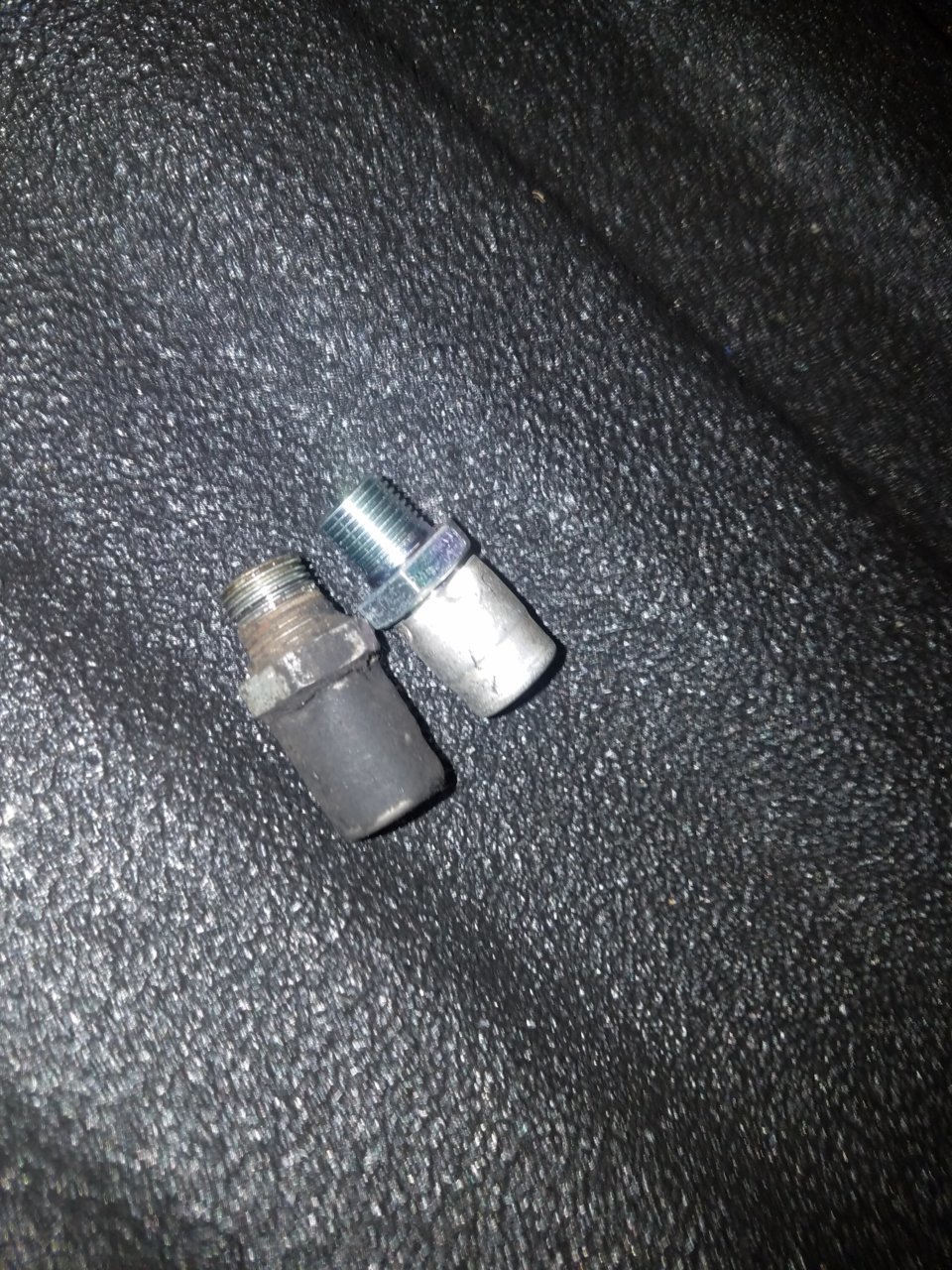

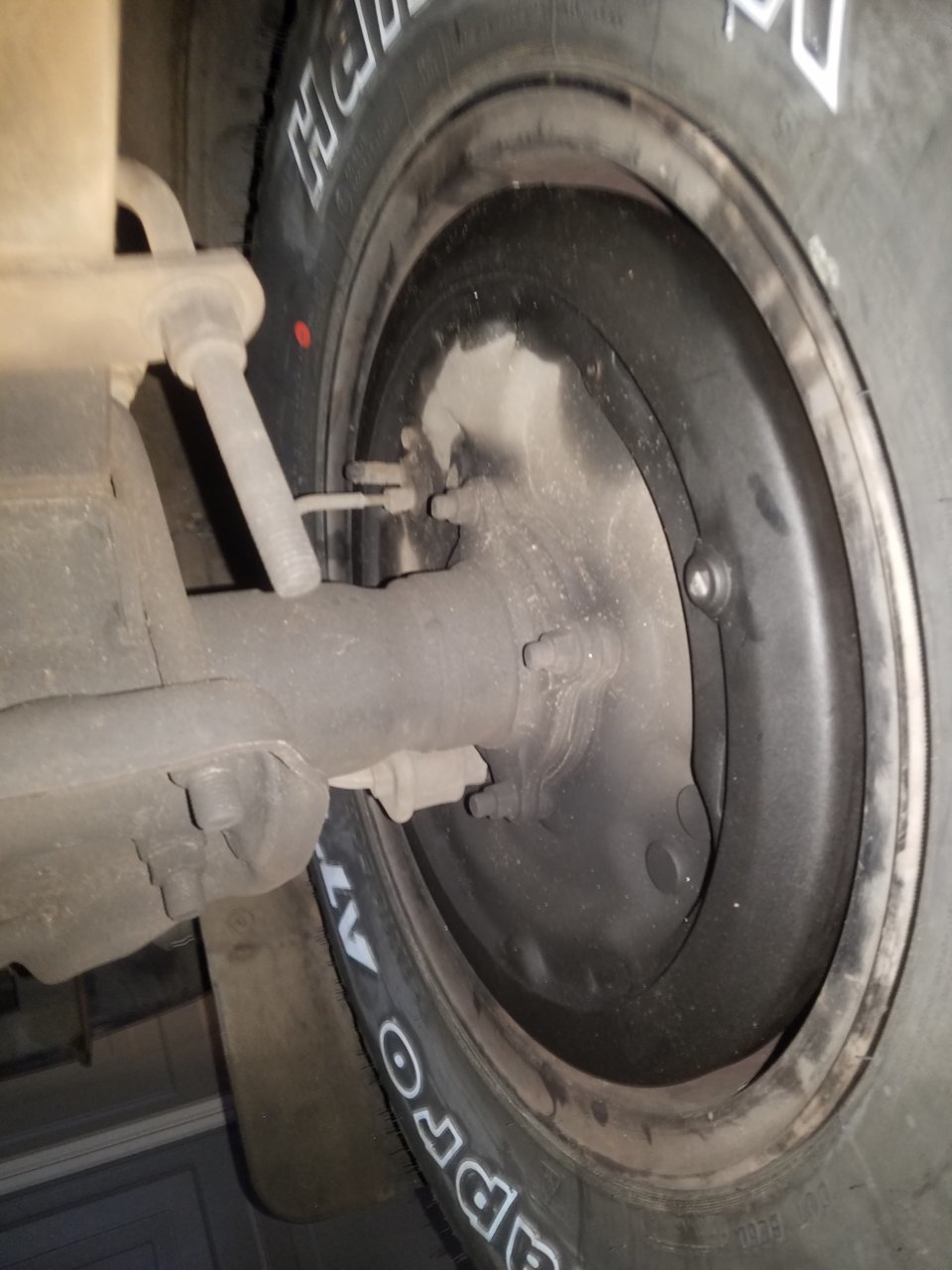

    By the way, make sure you add to your maintenance list to clean or replace this 12.00 rear axle breather vent.
    If it gets plugged you will blow out your axle seal like I did. Mine was plugged up from dirt and grime.
    I didn’t know bout this issue.

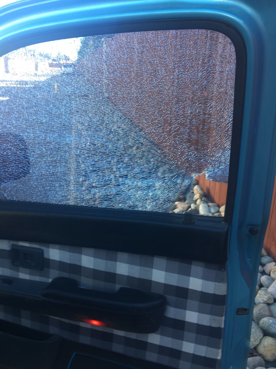

    A0A1269E-BE8D-4DCB-84D4-578D8FA3F5F0.jpg I hate thieves. Second time in 2 years.

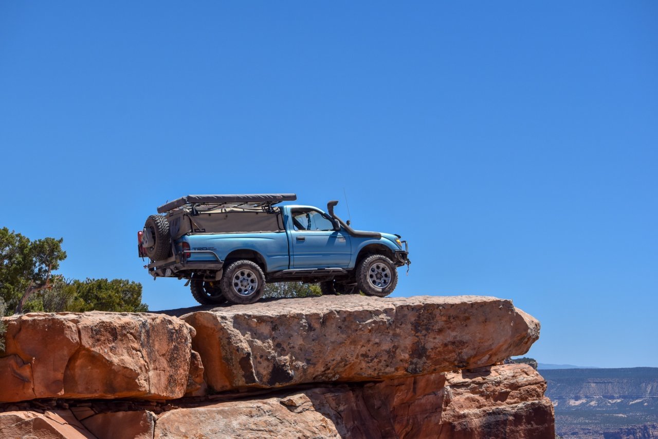

    B3165B4F-024A-4A5C-A619-9BE932D47FA4.jpg 141D0185-606C-4EC0-869F-BCC27AC4A046.jpg One of my wheeling buddies (Instagram @co.tacoma) sent me some pictures from my trip back in May to Moab. Here are the pics from Top of the World!

    Wow! That looks awesome!

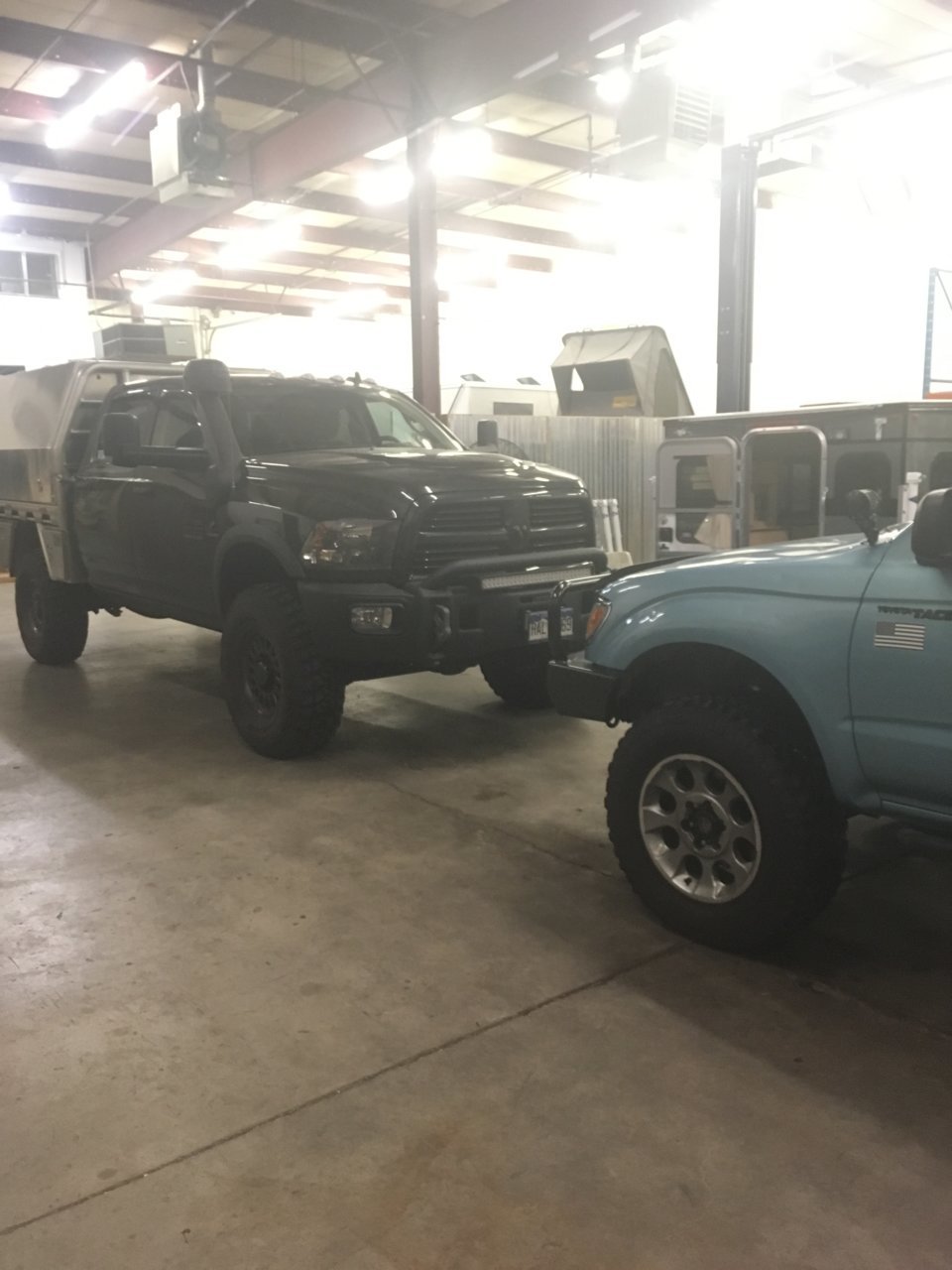

    E3A254B6-5652-4CC9-BF34-32496CCD3934.jpg 9DCC6316-8FE5-4FBE-A6EC-20E9C4A3B063.jpg One of these trucks is not like the others...
