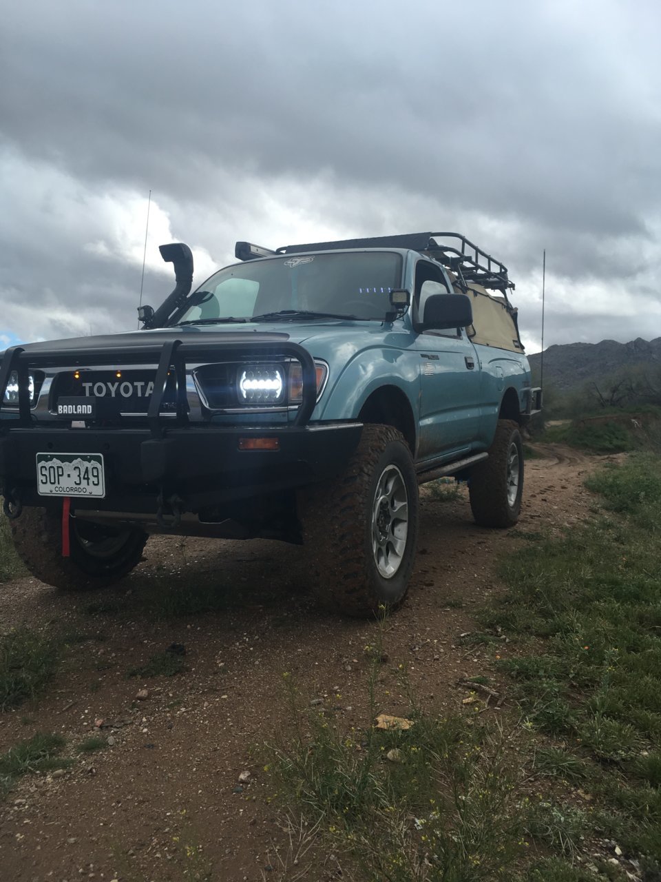

    A6A1439A-9191-481A-B0CE-93301F49B426.jpg Caught the Offroad bug and had to hit the trails. Went mudding...here’s to 3 hours of fun for 3 years of crap falling in your face. (Pic is before my truck got caked).

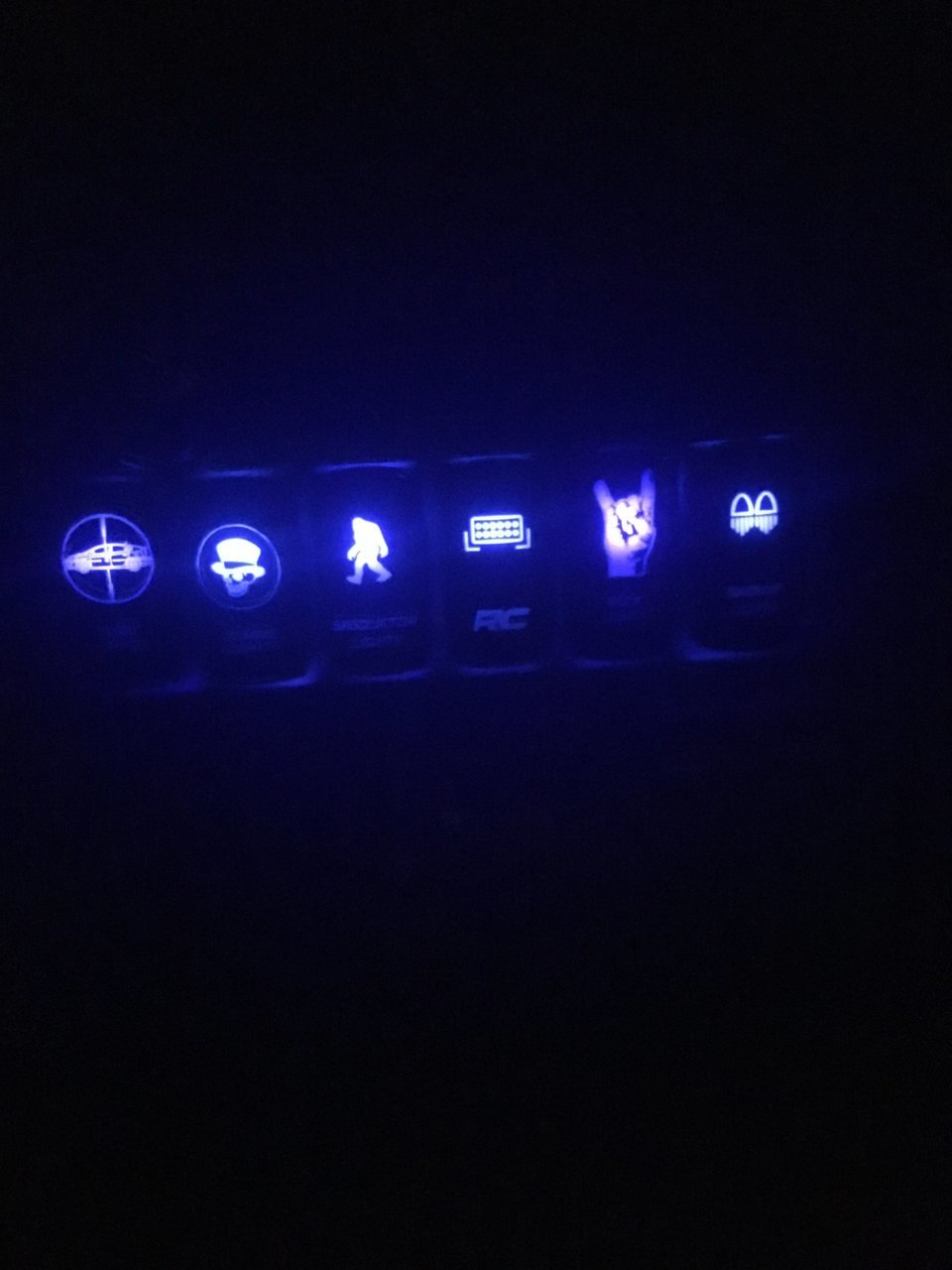

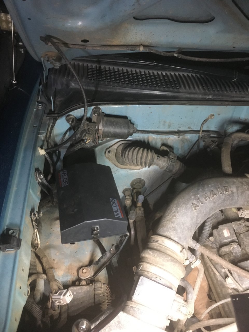

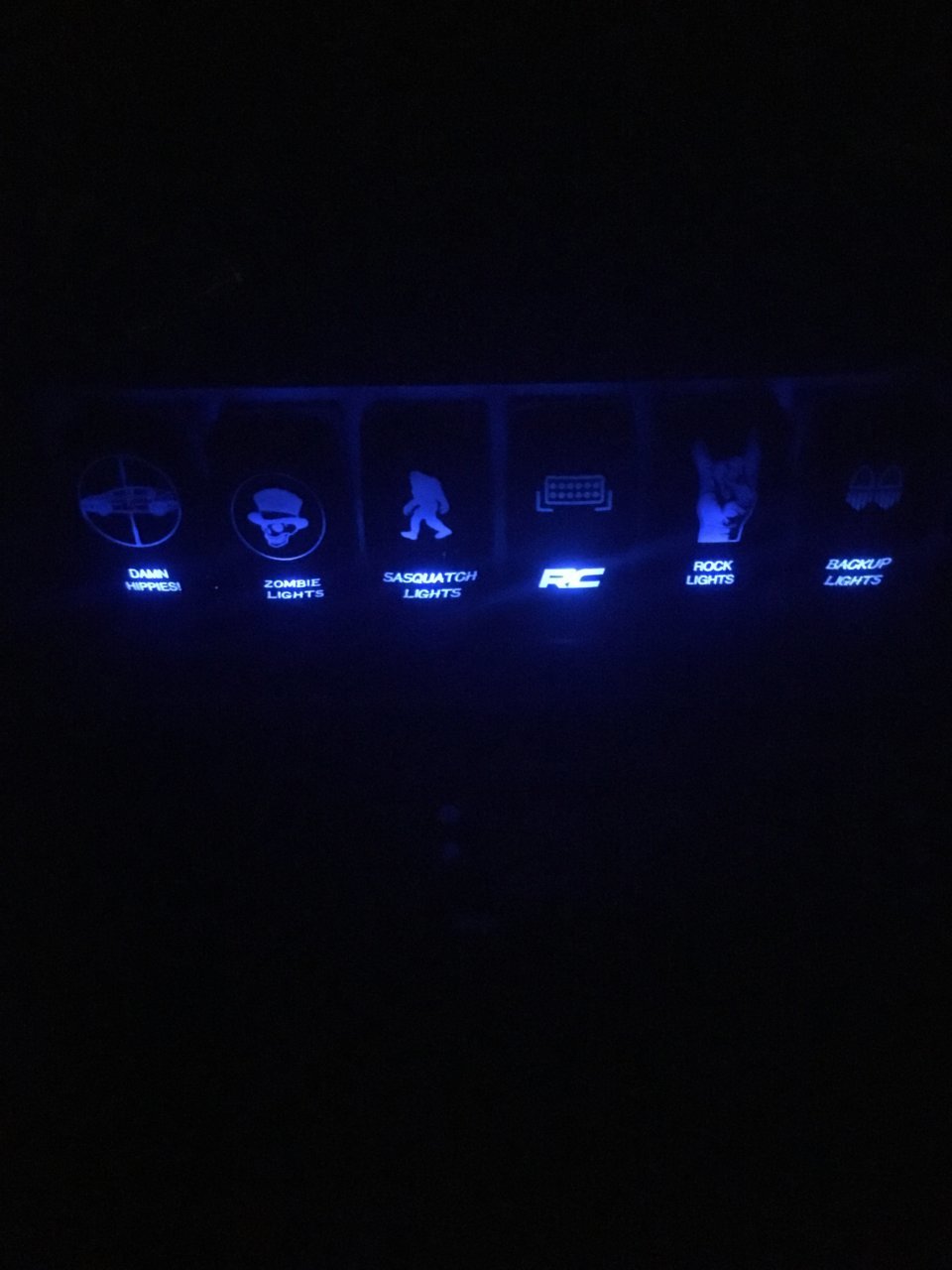

    4A021946-E512-4C51-BCDB-AFE5AC2914F3.jpg 1844919C-113C-49A8-8BD0-48A4B81C9901.jpg EB948FE1-54CF-4BA9-AF28-732FD9A08BB5.jpg It’s been a while since I’ve done anything to the Tacoma, so I decided to start the arduous task of re-wiring the lights. My last set up was sketchy, so I decided to find a plug and play harness/relay setup. Couldn’t find anything directly for a first gen Tacoma, that would be affordable, so I went to the dark side...Jeep parts.
    This rough country lighting setup was the ticket. (Link: https://www.roughcountry.com/mlc6-m...Y3g9LhNFntV77ByZjAvuwkQk2vacAbioaAmbgEALw_wcB)
    I re-used some brackets from my faulty cruise control motor, and wallah! I still have to finish running the wire, but the hard part is done. The beauty is that it can work with my Paranoid Fab switch panel (https://www.paranoidfabrications.co...st-gen-tacoma-din-switch-plate-6-switch-holes).
    More updates to come!
    Edit: the location of the relay box has been fiddled with to look a bit better.

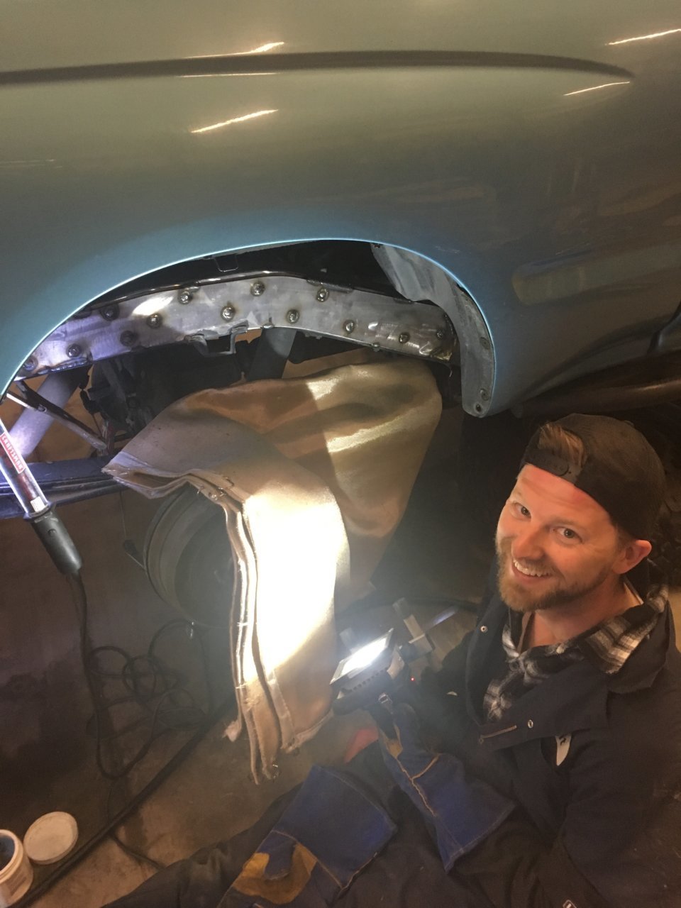

    Did you weld all along the outside of these plates? Or just every 12” or whatever was close?
    I see all the inside holes are welded and was curious if you welder the complete outside edge too?
    And did you strip the paint on the back side too?

    We ground down the paint on the frame before welding. We also welded the sides of the plates on, in Addition to the holes in the plates.

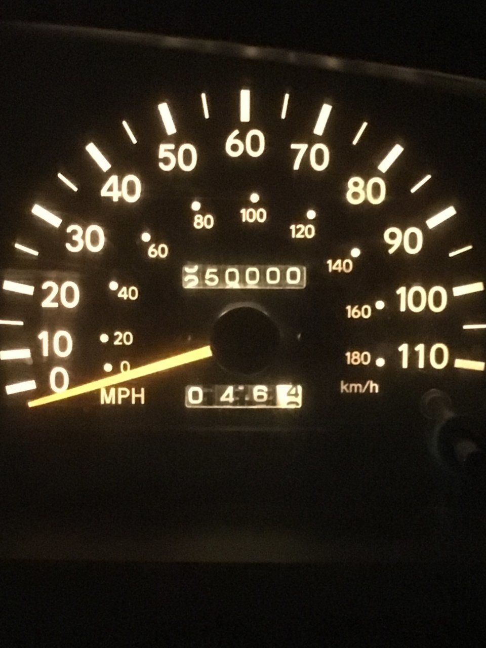

    314AAEDF-AA55-4A4F-BF36-68F3BABB86B0.jpg Hit a milestone yesterday! 250k miles!

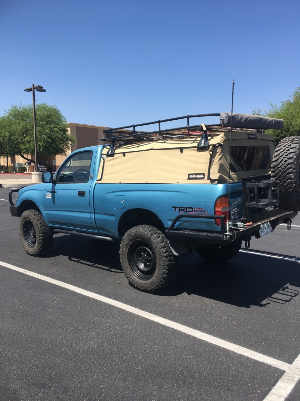

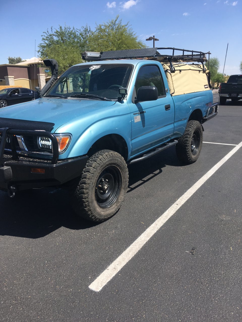

    I missed the steelies look, so they’re back!
    DA65CDE6-1882-4A3D-92DB-DA7B9C5A6C54.jpg 0BC6D14B-7A28-4CA1-BF2B-E21DDF421FFF.jpg

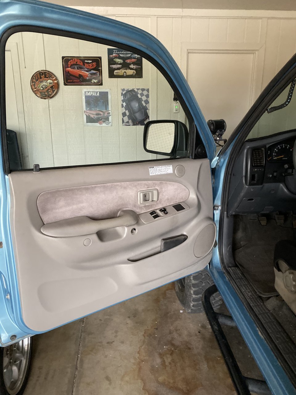

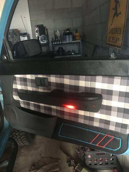

    The plaid door panels disintegrated on me. So, I found a set of newer 01-04 Tacoma door panels. Do they fit? Yes! Are they plug and play? Nope! Plugs into the passenger side just fine. Drivers side will mess it up. Had to source a drivers side 01-04 door harness. Plugs in; but when you push the lock button, the dome light comes on. Fix it by unpinning the gray wire on the under the dash plug, and putting the L/B wire in its spot. Works like a charm! Thank you to @nzbrock for the guidance in wiring this.

    Glad you got it figured out! Now I realize that you swapped the whole door harness, so that’s why you only needed to do that pin at the IH2 connector. I was thinking you just swapped the switch.
