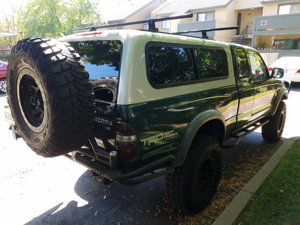

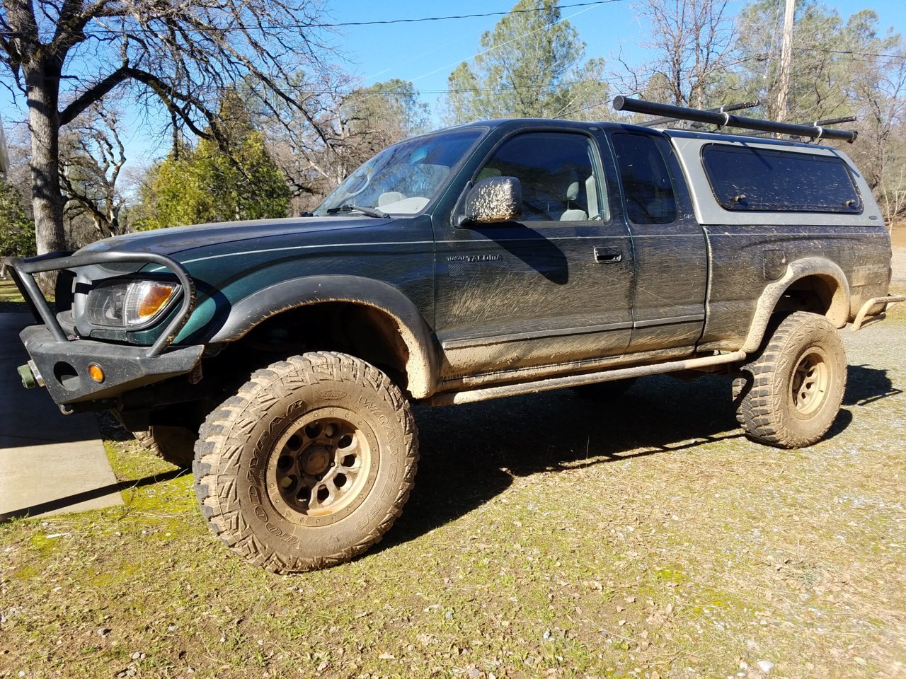

    Snagged a camper shell from Craigslist, debating wrapping it on just running the silver, it looks suprisingly good.
    Also added the Dakar aal and she's barely holding all the weight prob gonna have to swap for expedition leafs at this rate

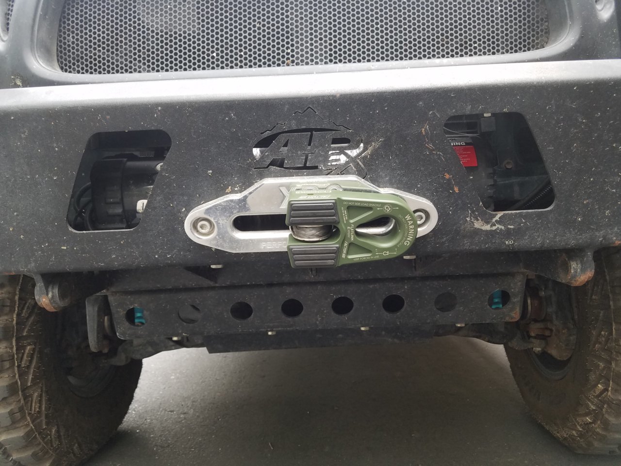

    Finally got around to installing the brackets for the arb and installing the factor 55 expert flat link

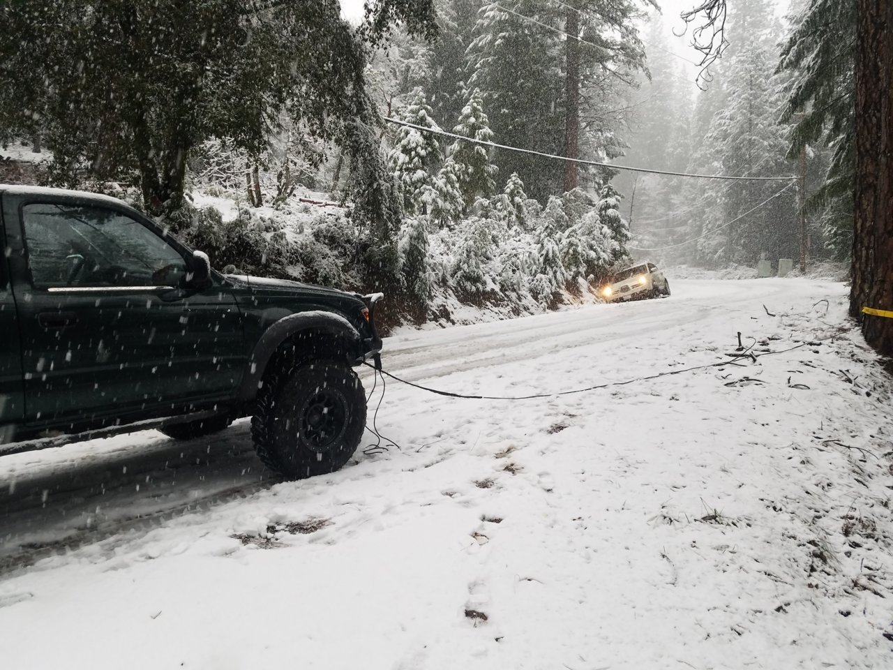

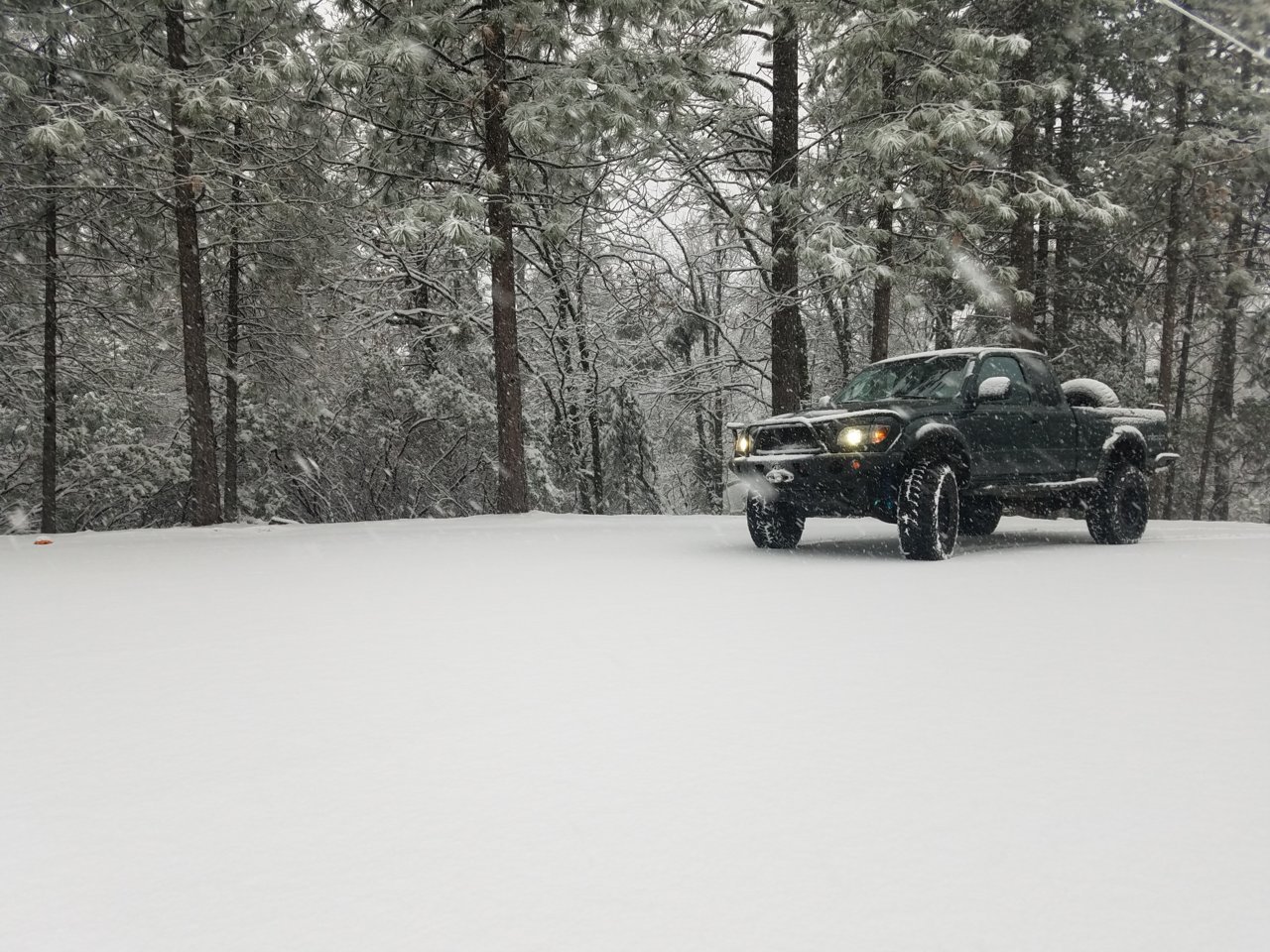

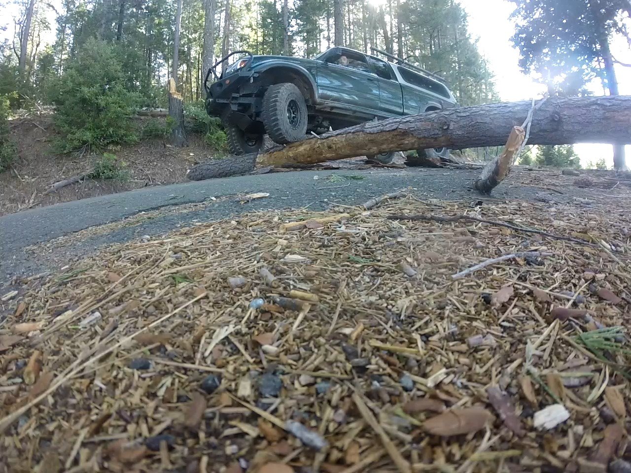

    Finally popped the winches cherry last storm and explore some fed roads near Placerville. Work permitting, hopefully some trips will be in store this summer

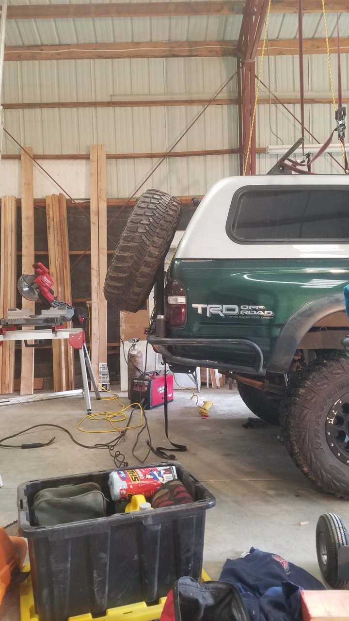

    Trying a new position on the tire carrier. Time will tell if its better or worse or if I need to modify it again for 35s. Its about 1.5" closer to the camper

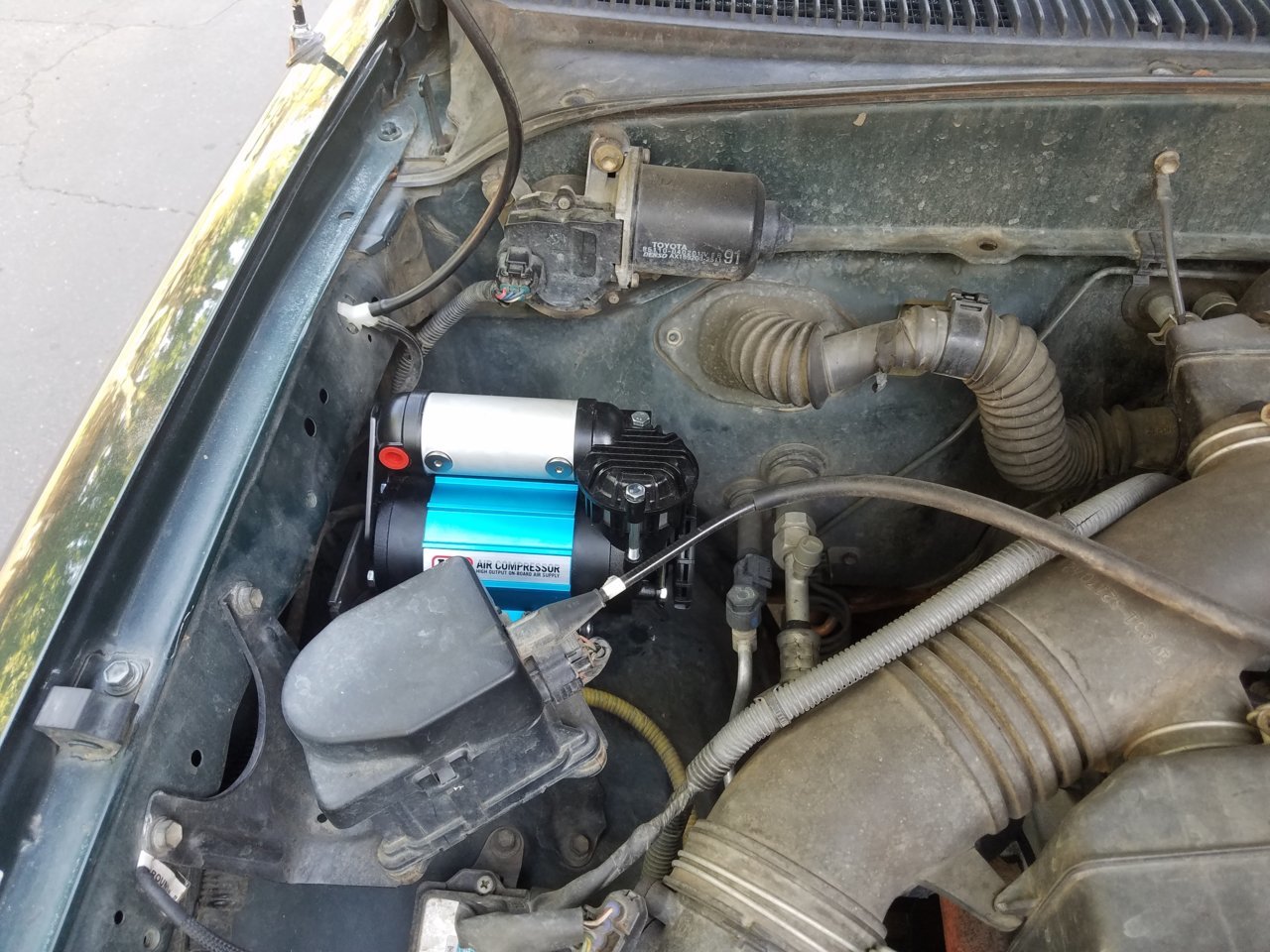

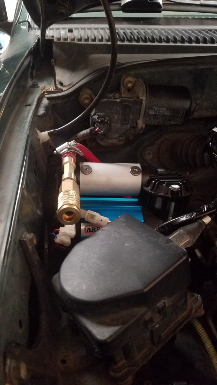

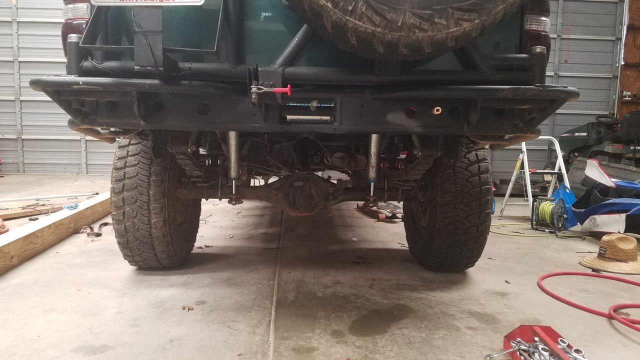

    Air supply finished. Put 2 connections just in case. Got 50' of airline for the whole project so from the front or rear I can hit all 4 tires.20200318_142915.jpg 20200318_142932.jpg

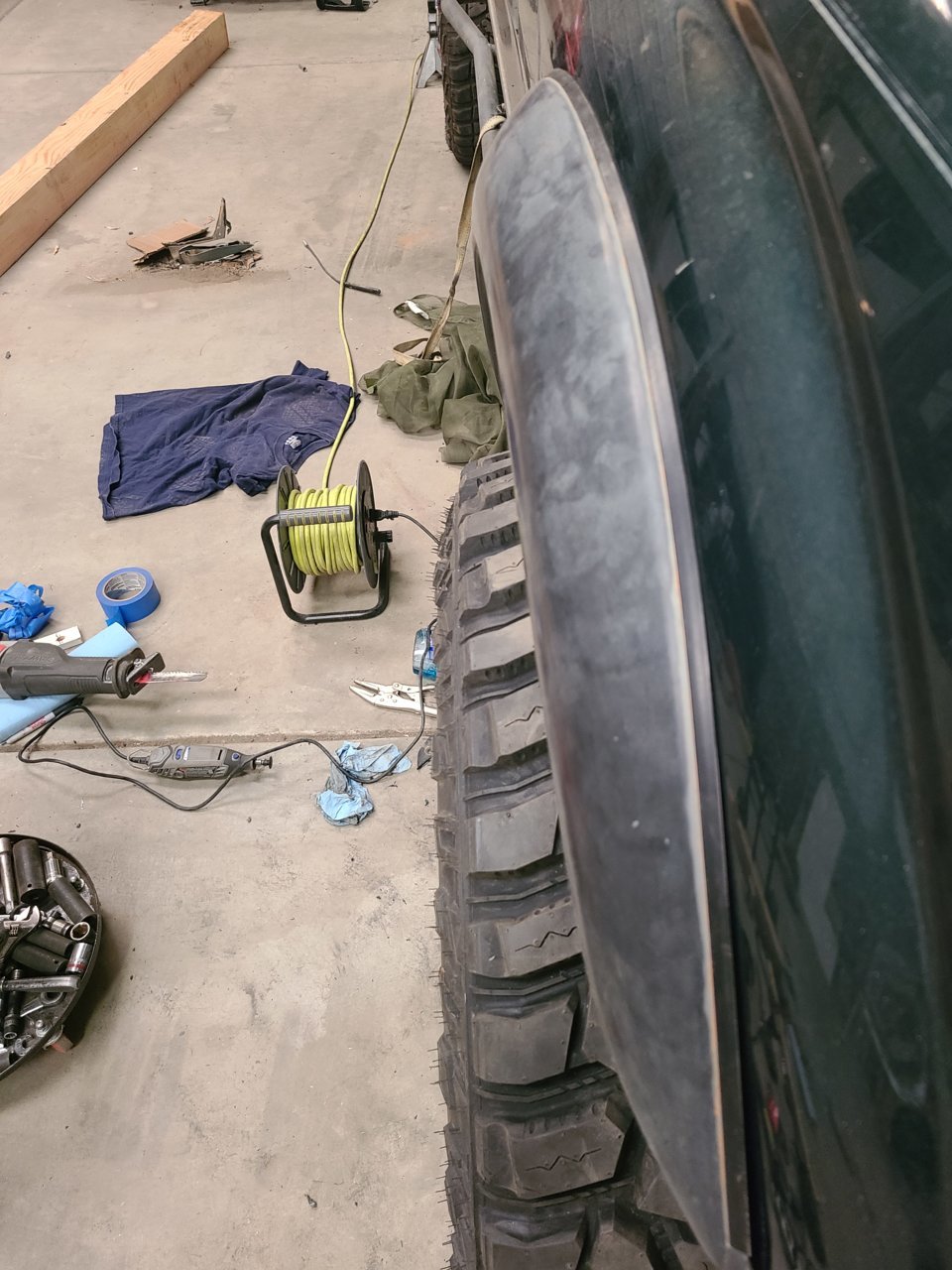

  13. Sep 16, 2020 at 10:13 PM
    #33
    waldeeeeen
    waldeeeeen [OP] Well-Known Member
    Sep 10, 2014
    #138016
    412
    Walden
    Mosquito CA
    01 Tacoma 4x4 SR5 TRD 5sp

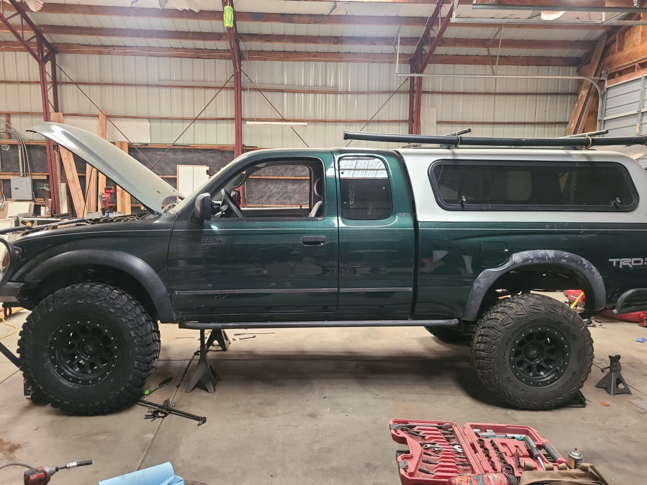

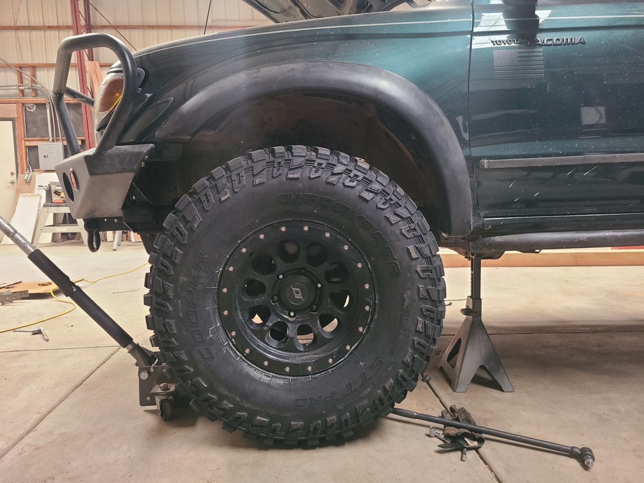

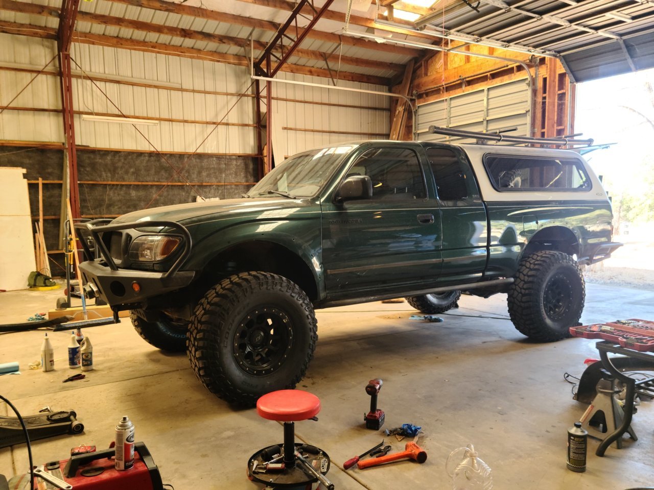

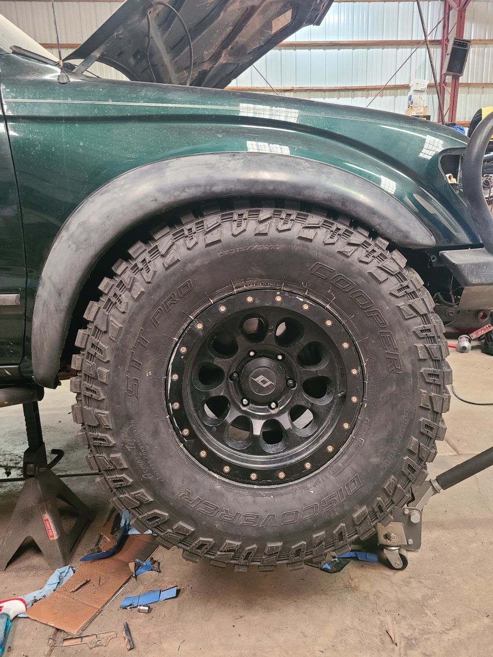

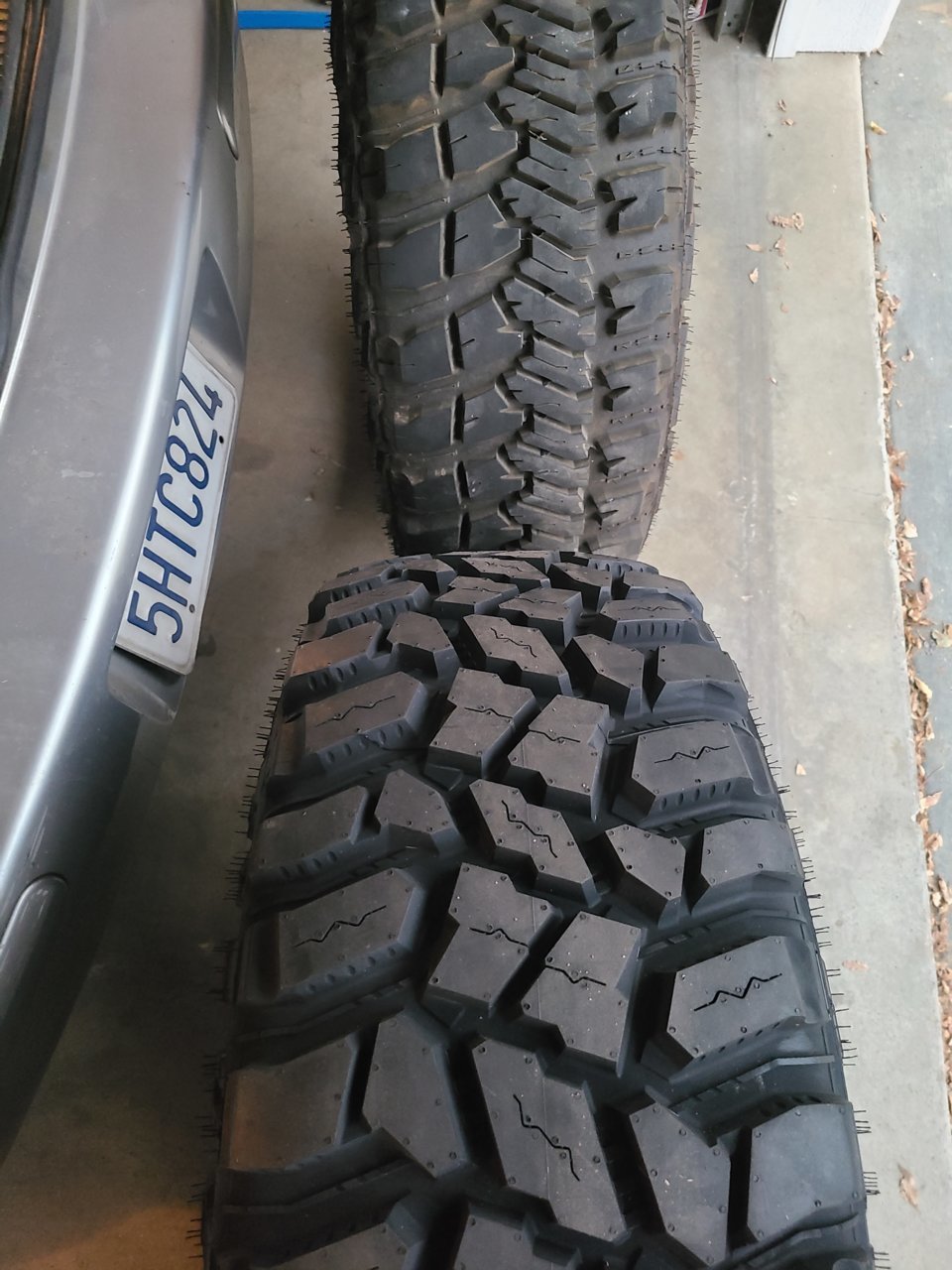

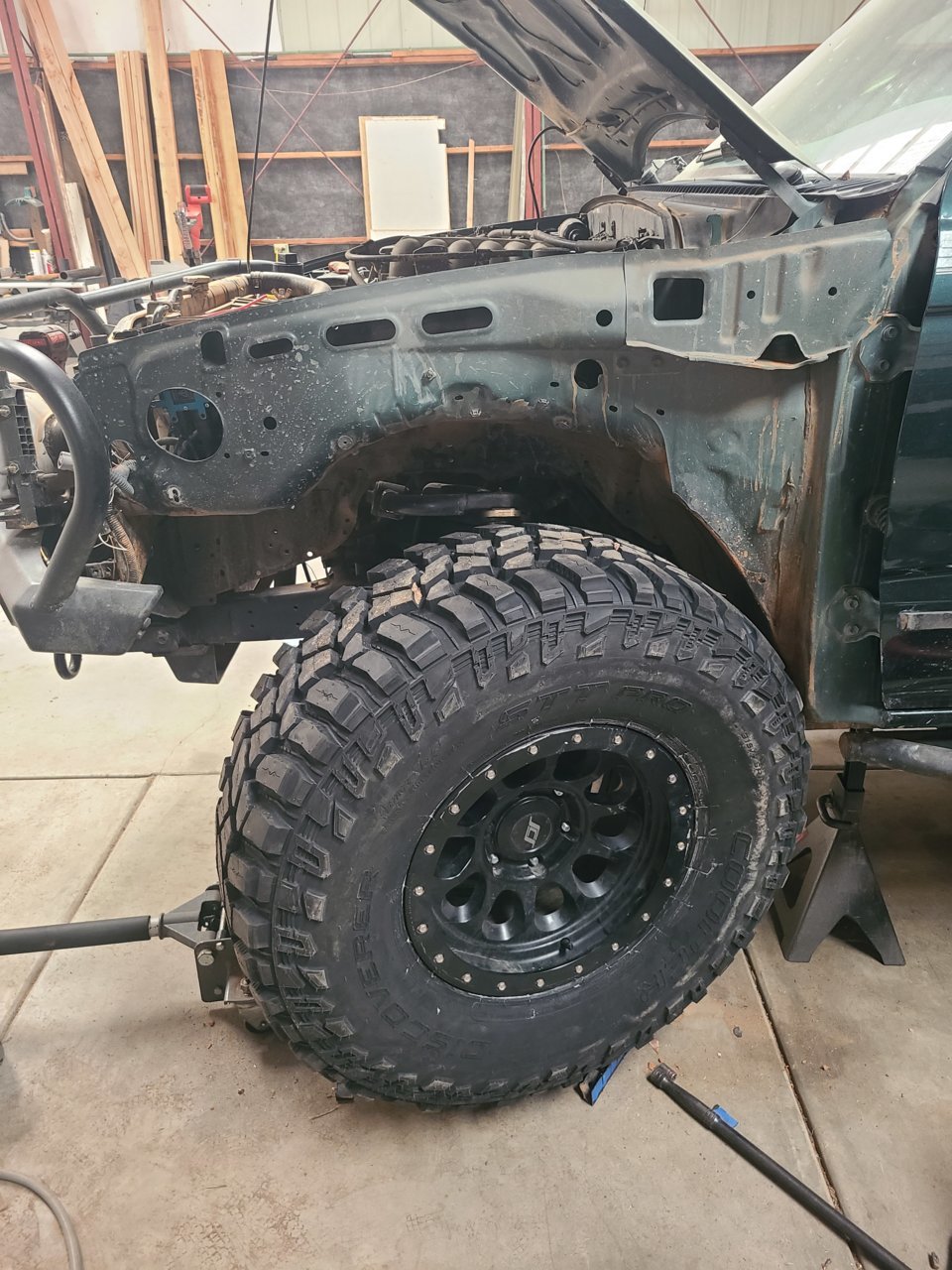

    Finally decided to make the jump to 315/75/16
    Dalandser and jubei like this.

    Fitting
    jubei and betterbuckleup like this.
  15. Sep 16, 2020 at 10:26 PM
    #35
    betterbuckleup
    betterbuckleup Well-Known Member
    Jun 26, 2017
    #222483
    4,771
    Ian
    Concord, CA
    2000 Tacoma SC 2.7 4x4 5spd
    Looks great! What's the backspacing on those ray10's?
    The fender flare looks pretty much fully intact. Did you not have to cut into it at all? From what i've seen it seems that most people that run the flares with 35's have to chop out the whole underside of it.

    Photos got somewhat jumbled uploading. They are off now but I plan on trying to keep the flares. Like @jubei and similar to @Blackdawg @cynicalrider @mrbeggins
    Ray 10s are 4" bs and I have 0.75" bora spacers.
    jubei and betterbuckleup[QUOTED] like this.

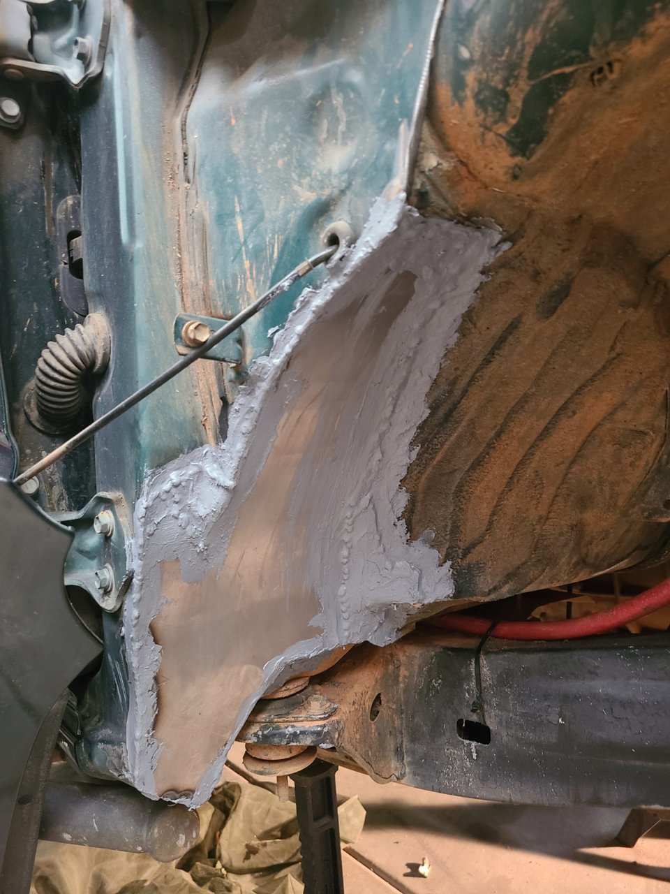

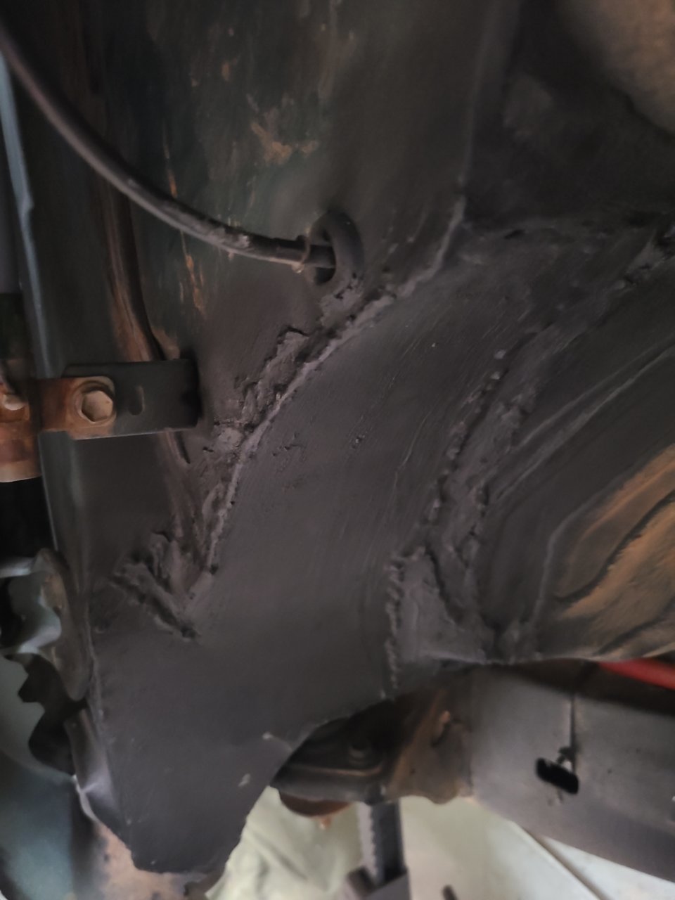

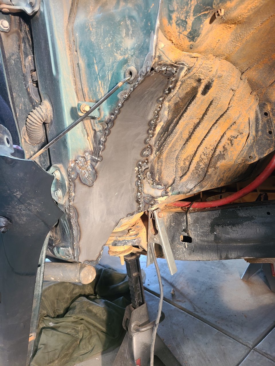

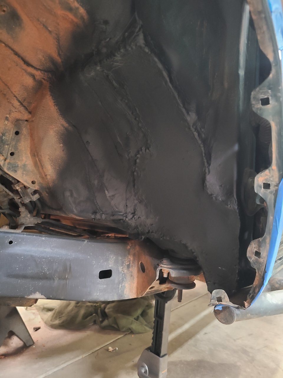

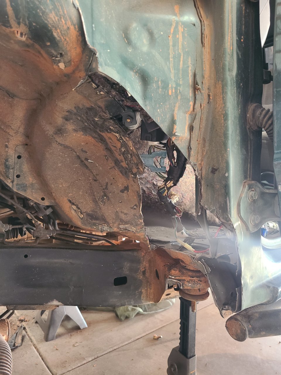

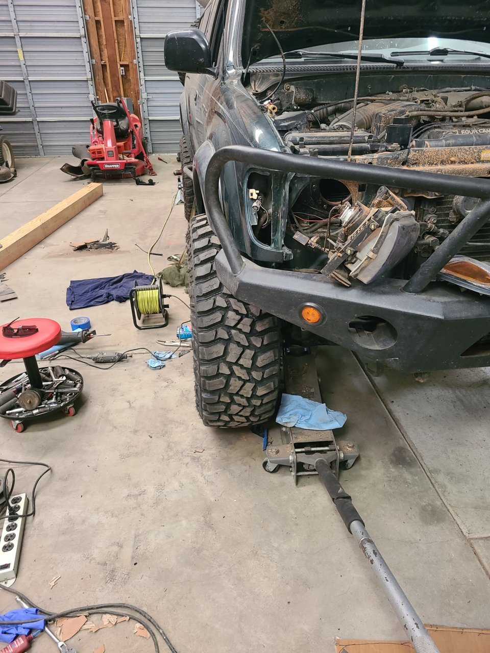

    Much more time consuming than expected. Only got one side completed today. 20200917_154734.jpg 20200917_171331.jpg

    Waiting on some new fender clips and maybe it'll be enough to hold other wise ill figure something else to keep the fenders.
    Doubled down on seam sealant since my welds aren't all that, didnt prep as well as I should have but it might work. Tire doesn't touch anything but the frame on the rear at just about full lock.

    The Bed is stock...ish
    With the tire tucked, to the wheel.

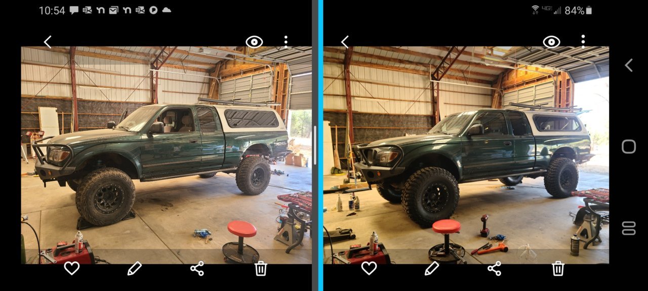

    Walden
    Mosquito CA
    Well here is the before and after. 4.88 with the 315/75/16s is better than 285/75/16 with 4.10. On relatively steep hills it will hold in 5th for a while then I drop to 4th and can accelerate up it at 70.
    Now I have to figure out the fender flares, finish the break in and oil change, install the skids and fab a transfer case skid.
