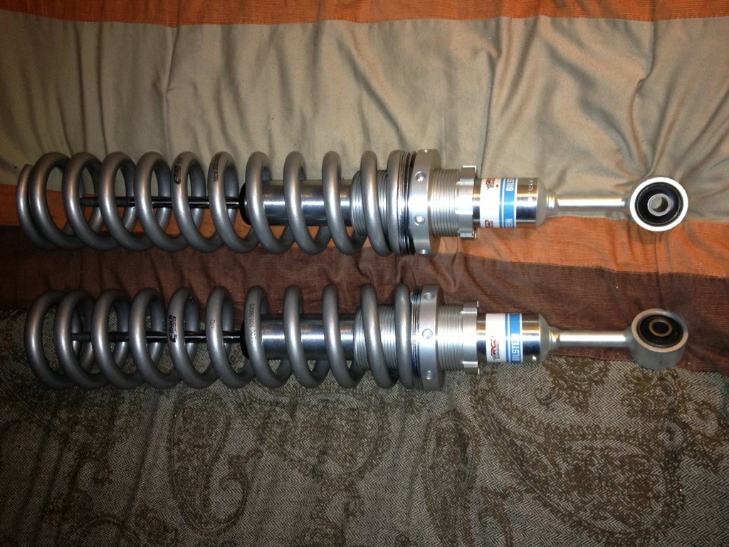

    Love the way your truck sits. I ordered the same lift kit as yours. most trucks i see with the 5100's all around dont sit like that though. did you do anything else to get it like that? also what notch do you have the front shocks on?
    ooh and do the cambergs do anything to make it sit differently? or is it just better for the suspension?
  14. Mar 25, 2013 at 10:12 AM
    #34
    Jakes09taco
    Jakes09taco [OP] Well-Known Member
    Feb 4, 2013
    #96838
    84
    Jake
    Buckhannon, WV
    2014 TRD Sport DCSB
    6" BDS lift
    The bilsteins are on the first notch, since i have the toytec adjustable coilover kit. i have them turned up to a full 3" lift over stock. Measured against the stock ones at the dealership. Rears just old man emu full leafs for lift. The Camburg arms don't effect lift height they just help add castor and camber. Castor was a bit low even with the arms since im at a full 3" lift. That and they help get a little more down travel since the stock ball joint limits down travel, that and they look good too. :D

    Beautiful truck, what did you set your billies at up front?
  16. Mar 25, 2013 at 11:58 PM
    #36
    Jakes09taco
    Feb 4, 2013
    #96838
    84
    Jake
    Buckhannon, WV
    2014 TRD Sport DCSB
    6" BDS lift
    Thanks.
    1st notch, i have the toytech coilover kit and thats what the instructions called for.

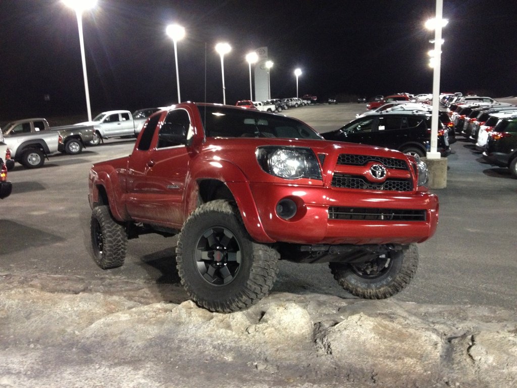

    Got bored and decided to flex a little on the rock display at the local dealer.
