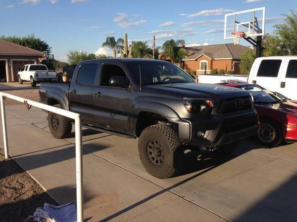

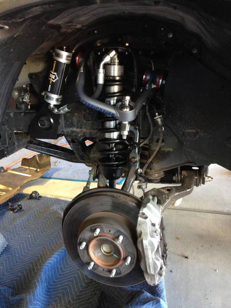

    Looks good! Make sure you check everything in about 500 miles and retorque it all.
    If you need we can do the check over/ Retorque. Usually like a half hour, so $47.50. But looks like you guys got it handled!
    And you coils will settle a bit a the front will drop a hair. maybe .25"

    It wasn't too hard to install. Just the fact that total chaos doesn't plug the zerk whole from powder coat

    Set up looks good man!

    Thanks bud its settled a lot but once i put the rear set up in then ill crank the front up a little bit

    Hah yeah it had a lot of lean. You going for a full 3" in the front? My extended studs finally came in so I'm really trying to decide which UCA I'm going to go with.

    It dropped a ton its almost level now... I just want it to be a little nose high when I install the rear. what uca's do you want?

    Yeah that's kind of what I'm looking for to. I am leaning towards the Camburg Ball Joint's. I don't need a Uni-Ball, the stock arms are strong enough for my use. I just need to get the alignment in check, I would do the Light Racing's but the Camburg's just look so sexy. I just don't know if I want to re-use my ball joints with 70K miles or risk pressing in some Moog's.

    I guess when we were taking them off we messed up the rubber boots on them

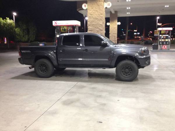

    :spy: sure looks familiar.

    Damn, sweet lookin' build
