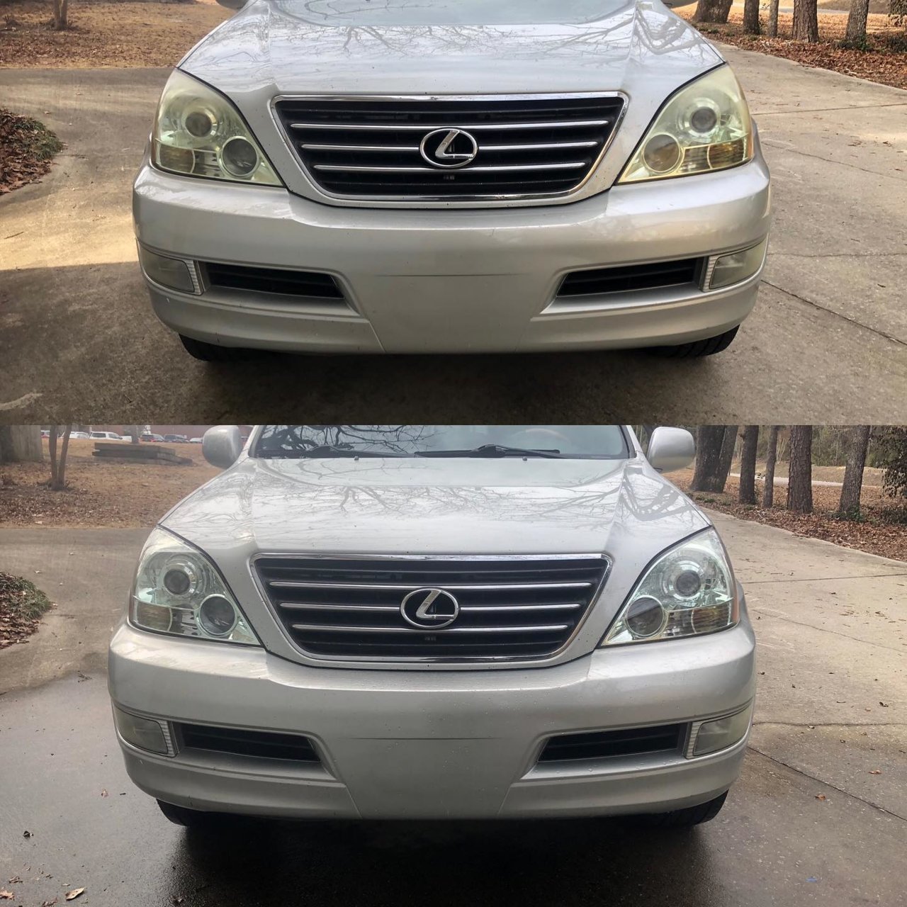

    Feb 2021 update:
    Nothing has broken (surprise surprise)
    Got the windows Tinted :cool:

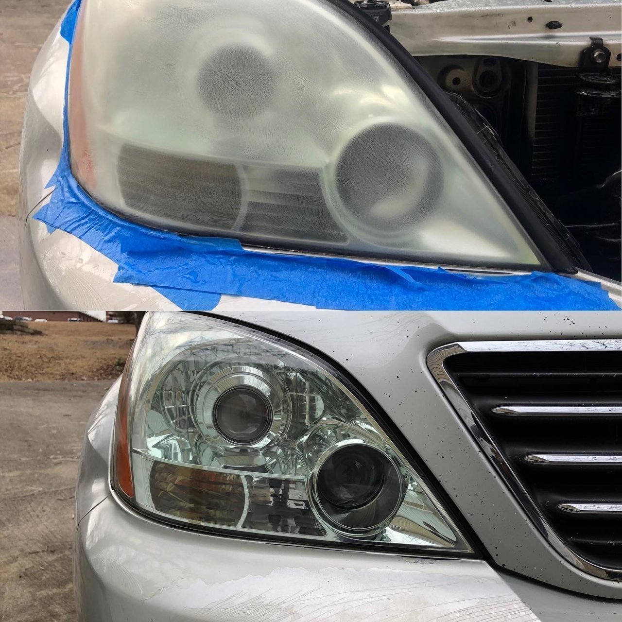

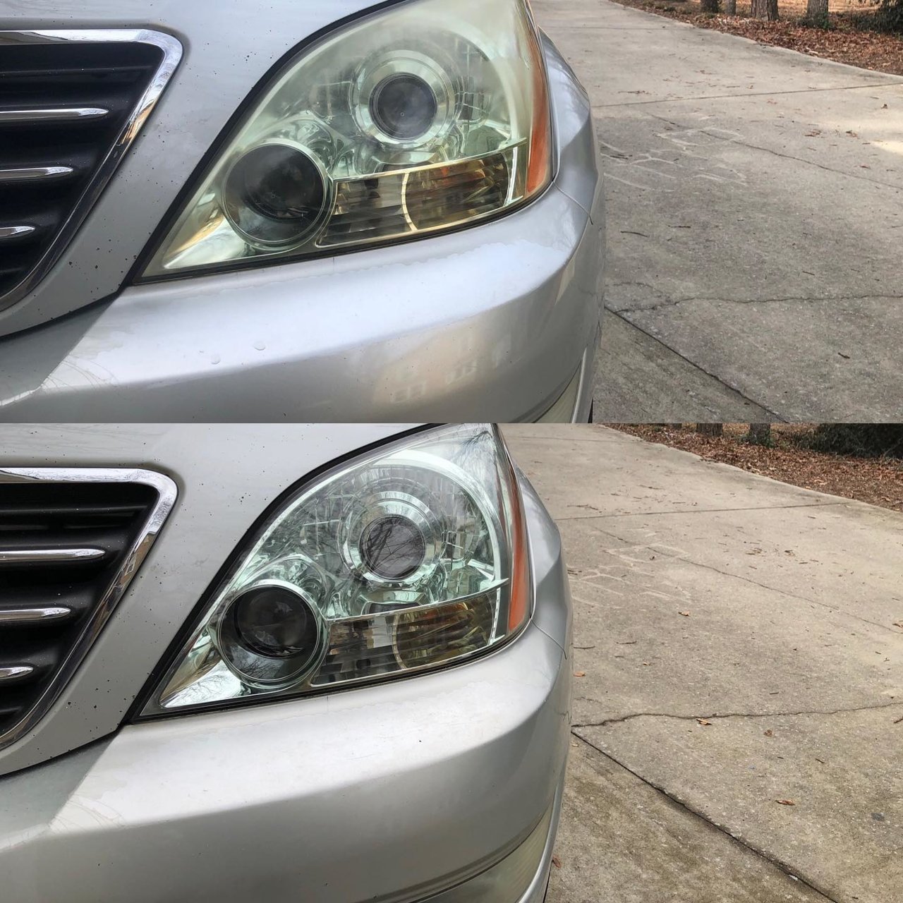

    Restored teh current headlights. Heavy oxidation has refreshed the look 10-fold and im looking at doing something with the fog lights now. I realllly want a front bumper but im resisting lol.
    146887217_10214732742351670_820134254332_8107a04ae4cee3412ca9fcd794470d08a919ec2f.jpg
    146405332_10214732742311669_699069750863_077161d353ada1e8600e9babc97544867636bdc0.jpg
    146880359_10214732742271668_710817603694_07ab70080a0b50249ad36e2991c06d74df6d34e1.jpg

    Looking good, what did you use for the headlights?

    I loved using this kit because you attach the 3 in pad to a drill and that saves your hands big time from wet sanding.
    500 grit (gold disk) / 800 grit (white disk) / 3000 grit (grey) and then polish with the supplied orange cutting pad.
    I've got some meguiars headlight coating on the way so i can make sure it doesn't fad immediately

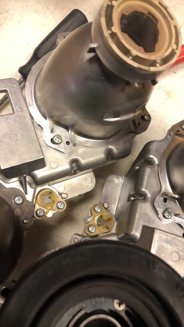

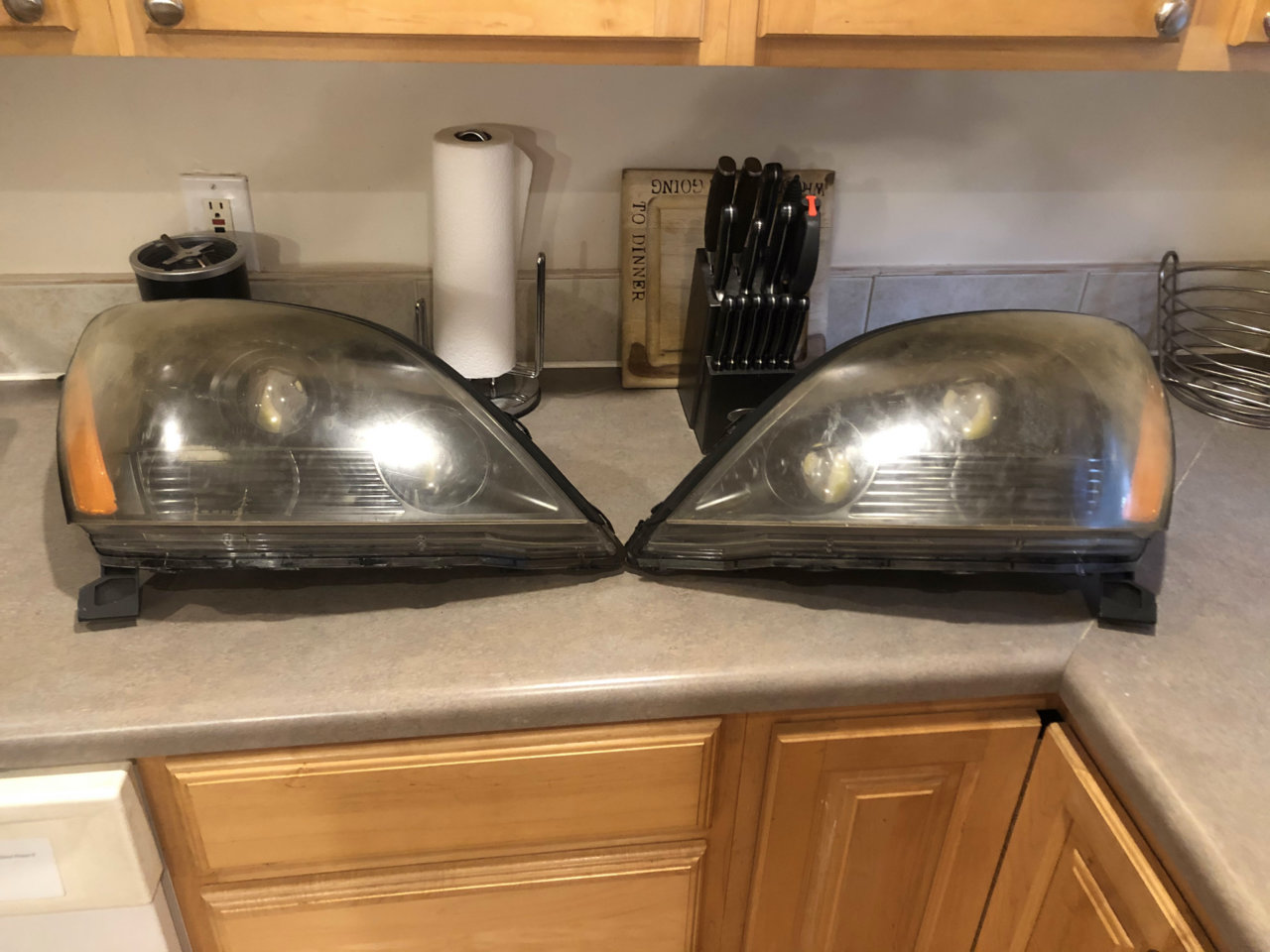

    Reached out to Andrew and Ambiguous and after some back and forth i settled on this kit. The output from these are supposed to be sick. 4 Bi-Xenon low/high beams are gonna be a massive improvement on the stock halogen setup.
    I bought some used GX470 off FB marketplace for 120$ shipped and remarkably i was able to separate the old internals without damaging the tiny plastic piece that holds it all together.
    BXBuilt had a coupon code for 20% off as well so i had to cash in while it was active :cool:

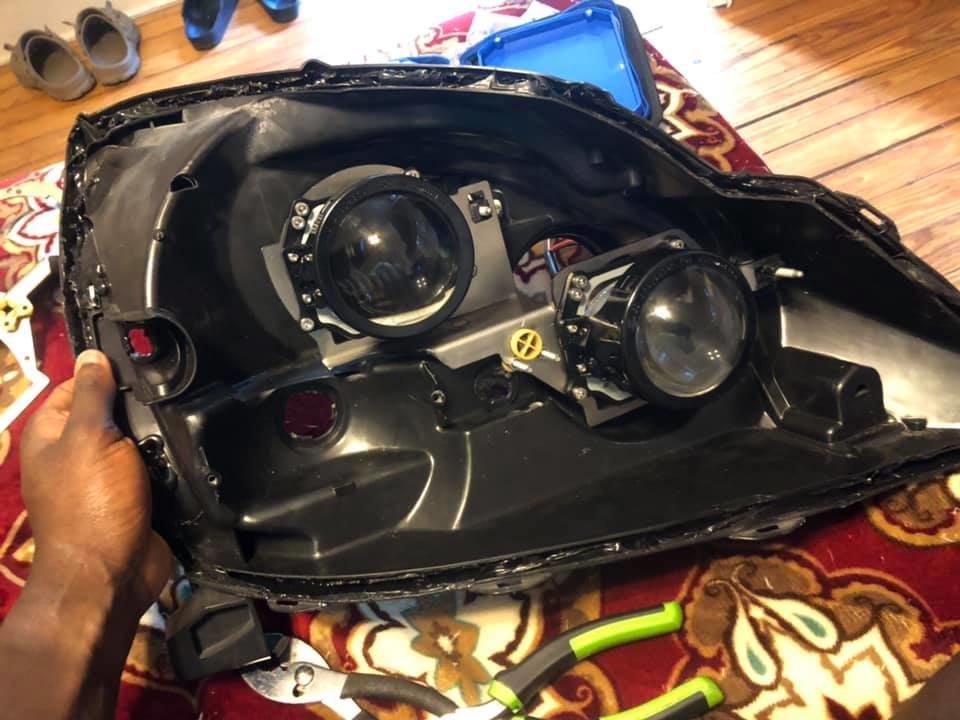

    Painted the internals black and they'll cure for the next few days until this stuff comes in. Looking forward to getting it back together.
    The tiny tan pieces that have to be preserved or you gotta buy a whole new set of headlights (my cheap ass wasnt going to do that lol)
    159853081_193169632569141_19280474808844_2a158b85002c15aa8e30ea74c66f65c220919201.jpg
    The housings painted
    160512903_869452906932403_74651806910233_70251e4bdd3dcd4bdfc2c0a66d19786611ec41bd.jpg

    Making progress on the Retrofit :popcorn:

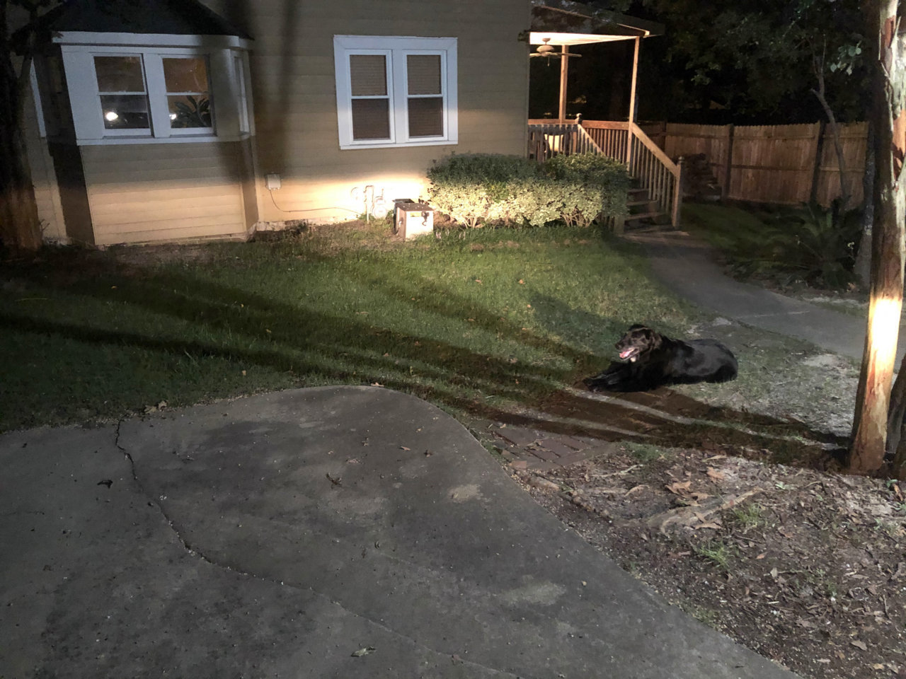

    Made some more progress on the retrofit these last couple days.
    Original ouput:
    After dicking about with aiming for an hour last night. Brought it to the station today to fine tune it. Pretty impressed.

    Finished aiming the retros last night. gonna get them sealed up this weekend hopefully.
    Night and day
    Stupid output.

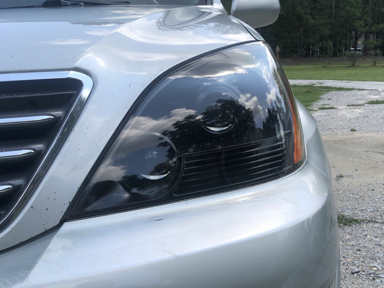

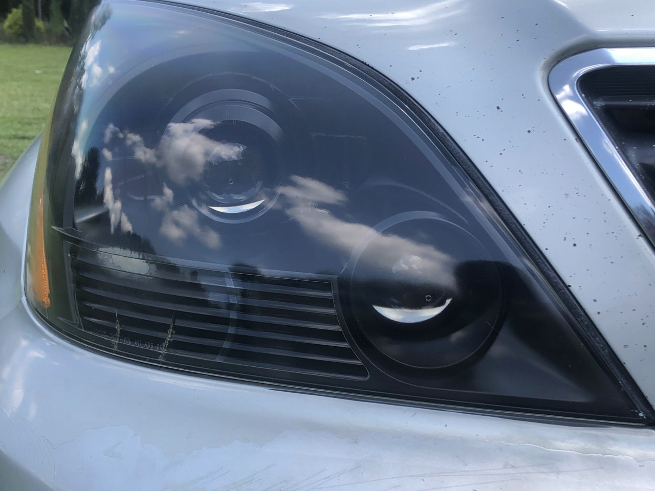

    It's done boys. I refinished the headlights and got the GX back together.
    All in all it was a month long journey. Came out looking great!
    Next for the GX are brakes.
