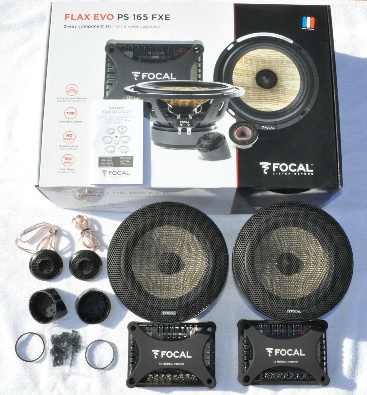

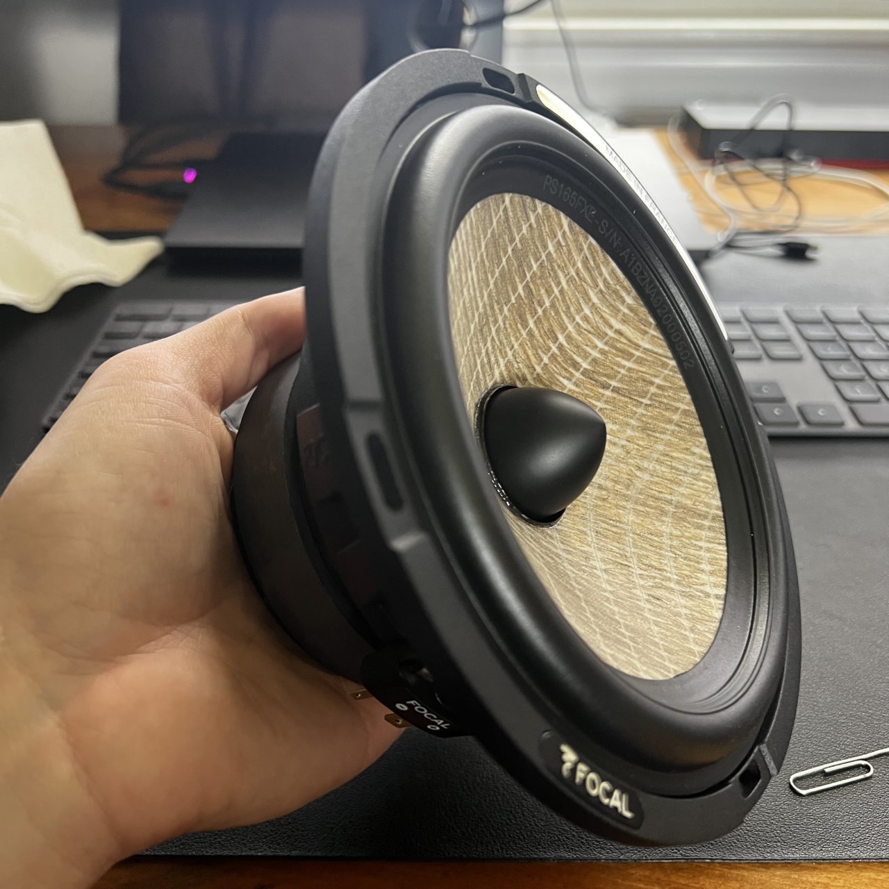

    Focal PS 165 FXE Flax EVO, eBay Yes, eBay. I did some digging on this seller and they seem to be authentic down to there location. Fingers crossed. I'm hoping to use the tweeters in dash since they are using an inverted dome for better off axis listening. I'll move them to the sails if I need to.

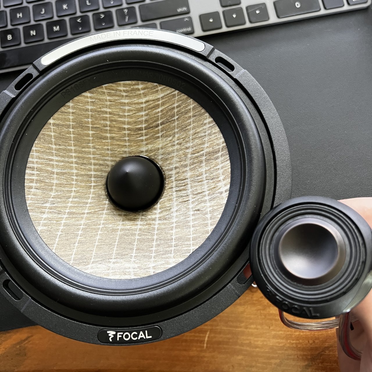

    I like them, much better than stock with a smidge of mid base you won't hear in the Kicker tweeters. I'll be taking them out this week to try the Focal's in this location.

    Quality on these speakers are amazing! Speakers are authentic, seller is an authorized seller. I checked the serial with Focal and registered the warranty. Warranty probable will be void though seeing that they were purchase from Poland. Warranty applies to the county they were purchased in. Apparently I like riding that fine line of $ vs function.

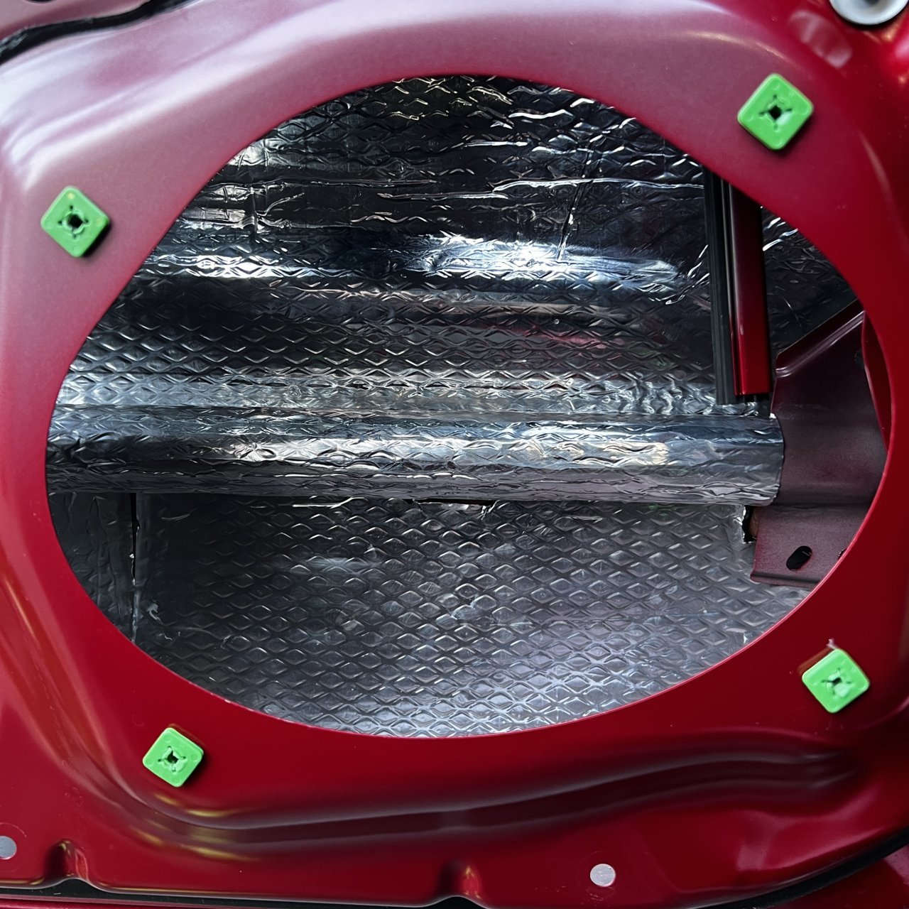

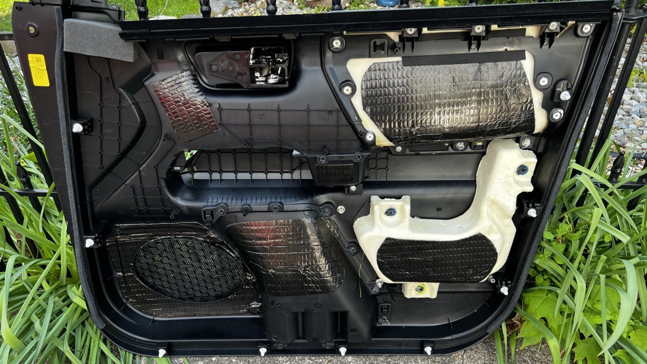

    Started sound deadening interior doors.

    Looking good bro. Looking really familiar. Lol. That will make a huge difference by itself.

    I hope so, EVERYTHING I read says this is the most important thing to do. I'm going full ham on it doing the inner, outer, speaker adapter, and door panel. I've got butyl, closed cell foam, closed cell egg crate, and foam tape to use. I'm not fucking around.

    Yeah. You don’t have to go full baked potato. You can do the outer shell and add some to the inner door panel itself too. That’s the part I have to do next is add some to the inner panel. I wouldn’t cover the window access areas just incase it needs to be serviced. But any large areas should do

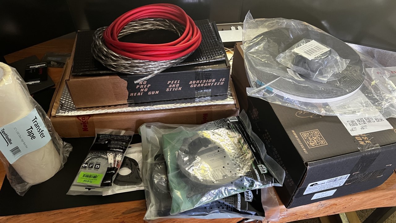

    Also, got some more stuff in. Adapters, wire, transfer film, butyl, closed cell foam, foam strips. More still coming.

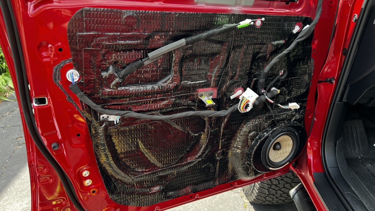

    Left driver door butyl done. Gotta say it’s a pita. Wires wrapped in foam strips. Also added some to the door panel along with some tesa tape and foam strips. Haven’t decided yet if I’m going to add the closed cell foam. Door seems to deadened enough as it is right now.
    Decided to install one of the speakers temporarily to get a feel for it with the stock system. Sounds like ass of course. Helix M Six DSP has been ordered so it’ll sound better soon.

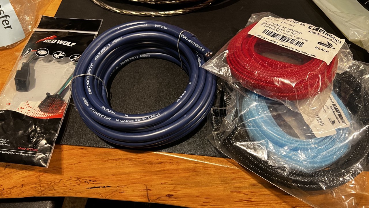

    Got some more stuff in the mail. Speed wire, braided sleeve, speaker t-harness.
    Oh and ordered some SoundSkin ring kit too.
