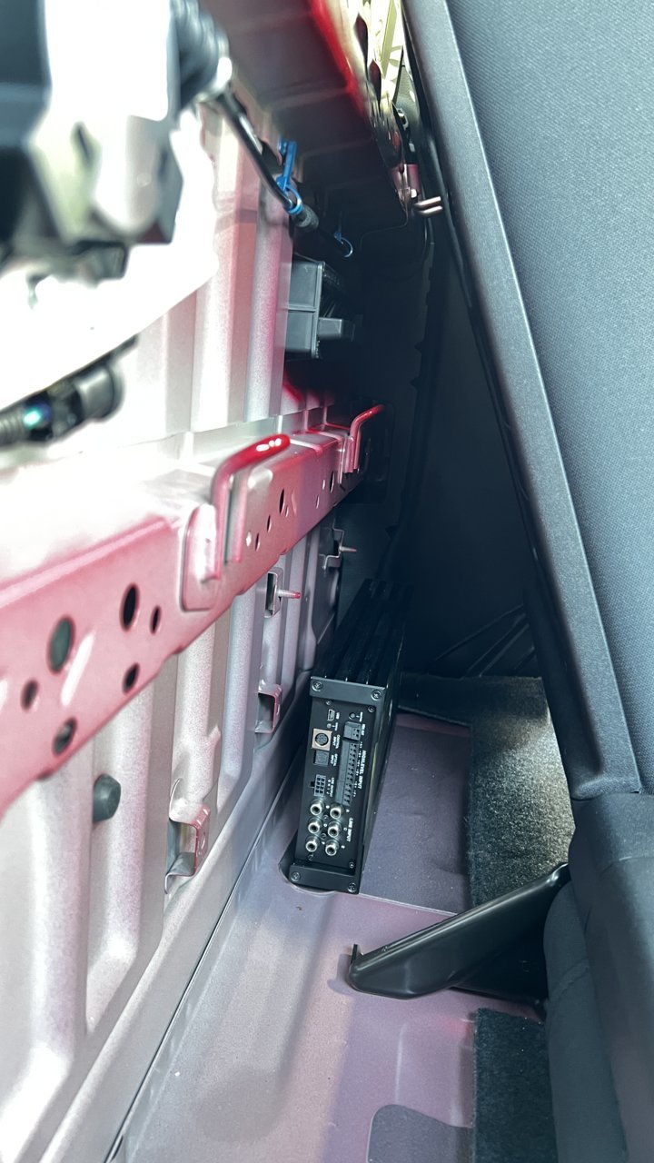

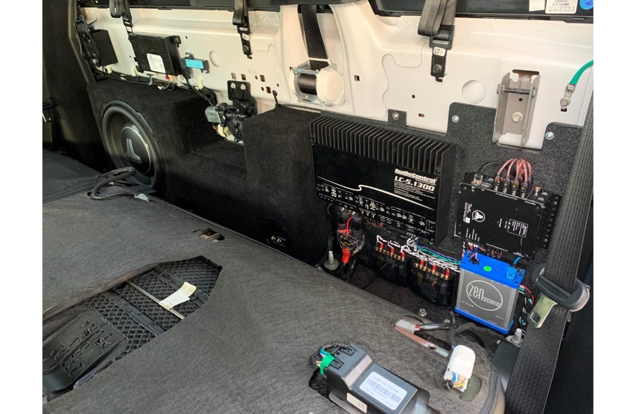

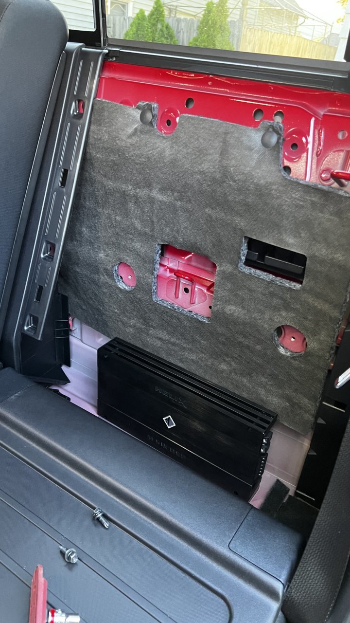

    I initially wanted them under the seat but it's too cramped for my taste. I'm going to mount them on the back wall on a piece of 1/4" PVC. Plenty of room back there without the plastic.
    Setup similar to this:

    Preliminary layout

    That seems like a good plan.

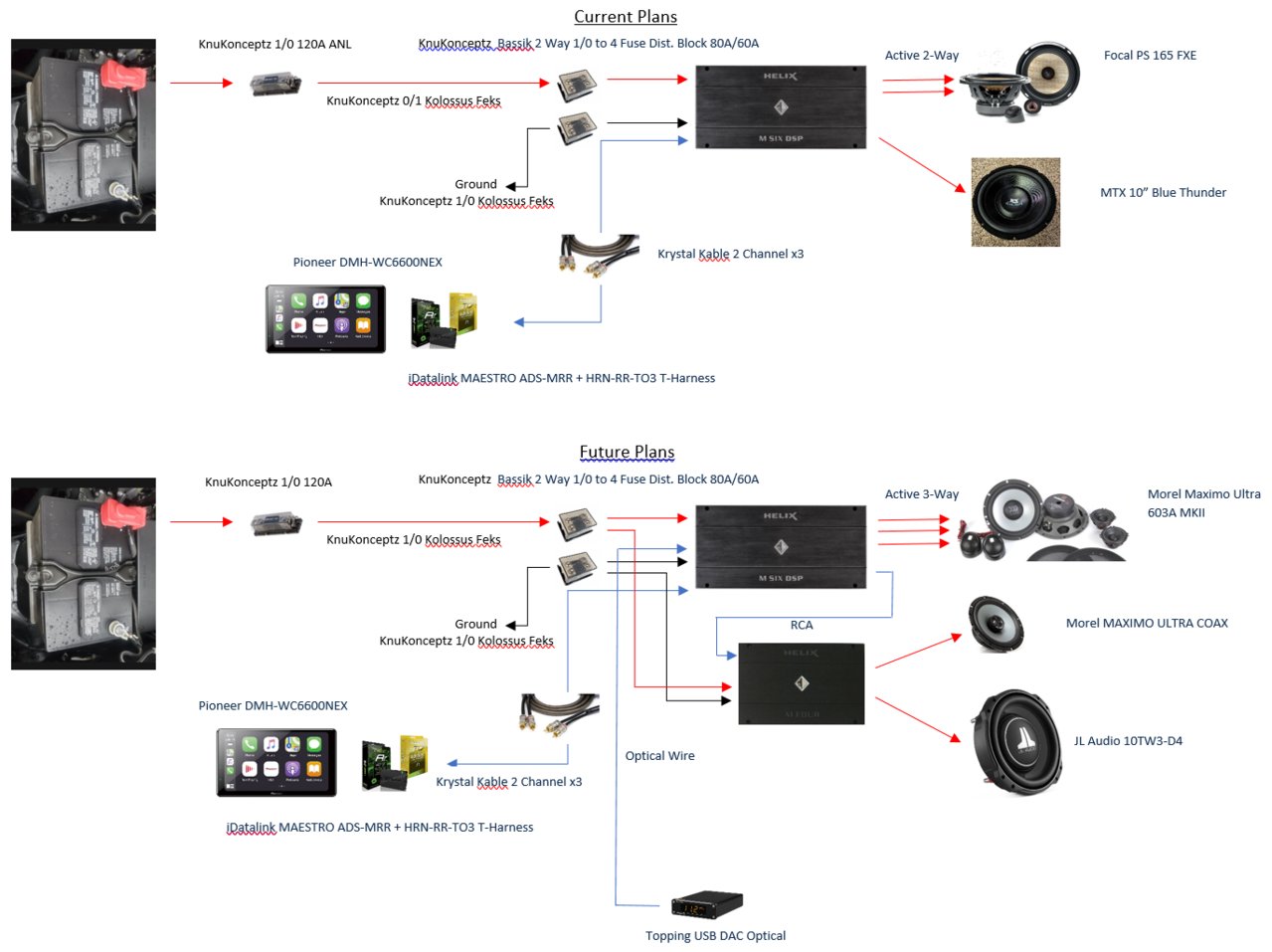

    Are you planning to run 0 gauge to your distribution block? I did all my calculations just running to the front seats and settled on 4 Gauge but your run is a little longer to the rear. Also I don't plan to run the M One X at 1 ohm and most likely about 600w @ 2 ohm to a Sundown SD-4 neo. Ended up totaling 143 amps for the pair of amps at 80% efficiency (staying at 2 ohm on the sub amp).
    I wonder how that JL will sound off 200 watts. I thought about doing that too, like 2 phases. Are you using their stealth box?

    I was going to do all 4awg but then said Fuck it and will do 1/0awg to the dist. block then Y 4awg to both amps. I was going to do the M One X too but changed my mind. I’m not a total bass head that needs to shake the windows so the M Four will fit my needs. I’m more of a SQ guy. If I was doing something with more power like you I’d go for the M One X too. Im going to get it all professionally tuned when I’m done and that will make all the difference. Thought about the stealth box too but since they upper the price I said no way. I’m making my own box with 3/4” birch and all the proper SQ measurements meant for the JL.

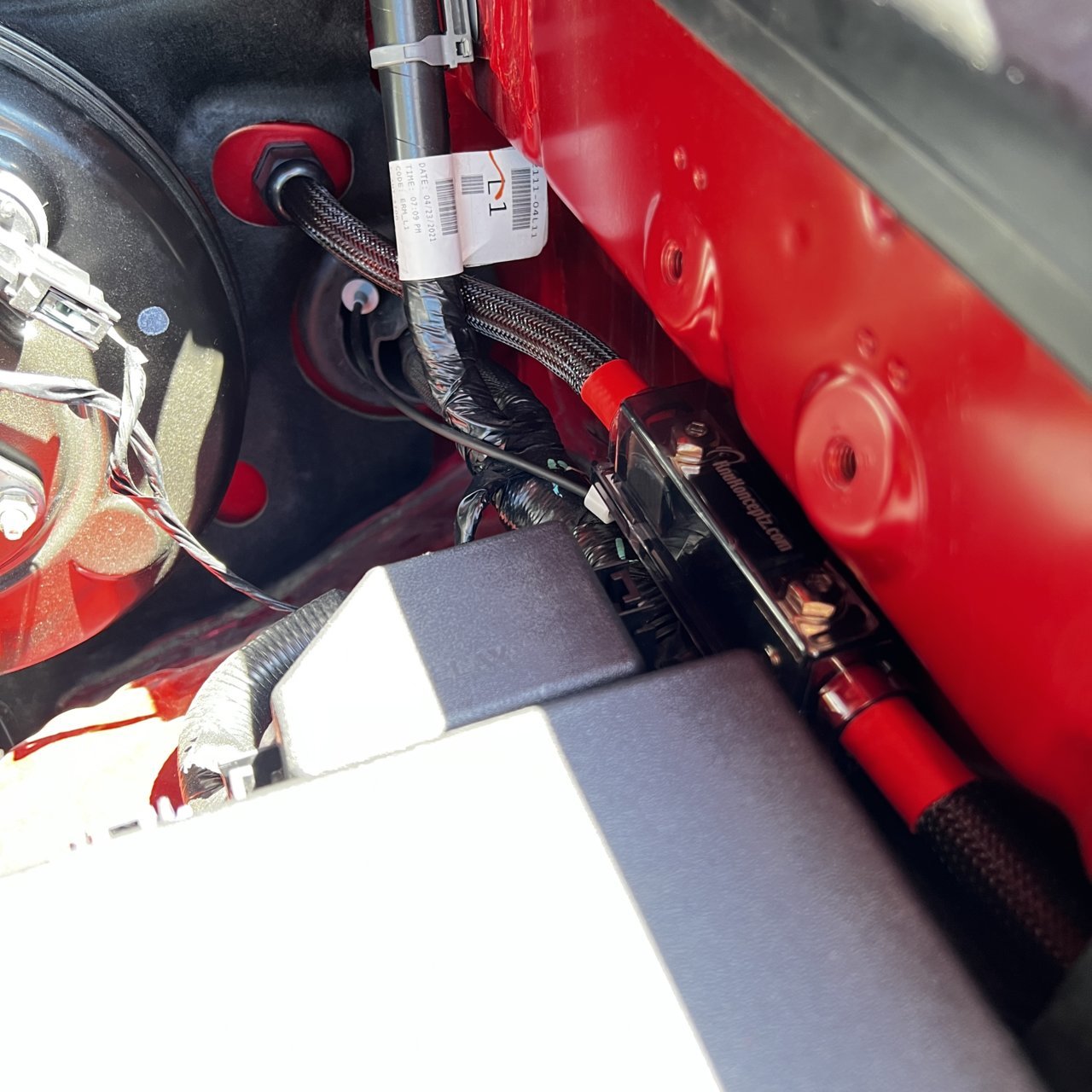

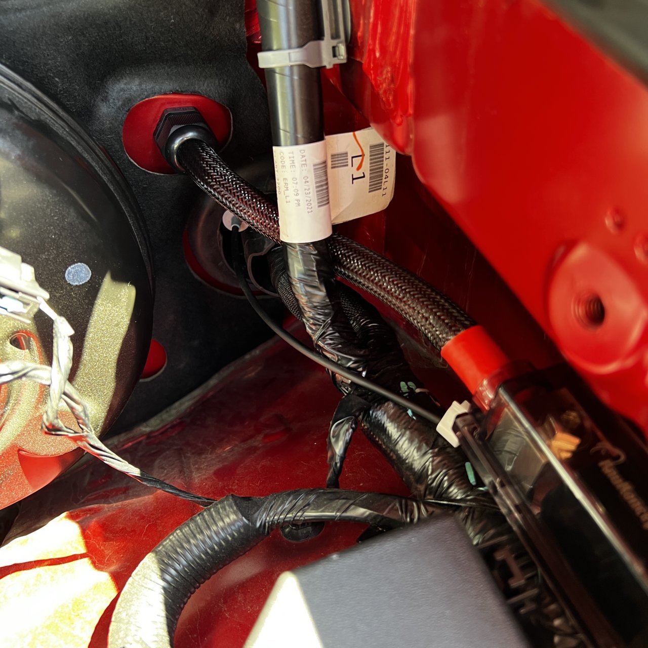

    Fuck, welp spent a shit ton of money on a new receiver and accessories. Got the Pioneer DMH-WC6600NEX, Maestro, and all associated cables.
    Got Power wire, speaker wires ran and some speaker wire in the doors. Running this Knukonceptz speaker wire though the rubber grommet in the door is a PITA. Wrapped the power wire in loom as well for some extra protection and isolated from the speaker wire.
