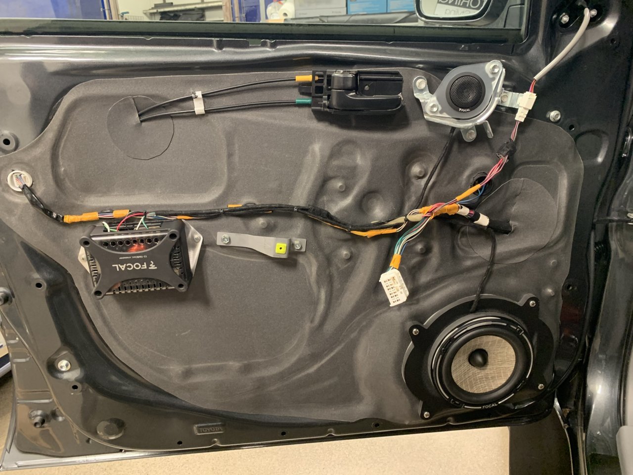

    If you're unhappy with any of the Focal items feel free to send them my way. ;):rofl:

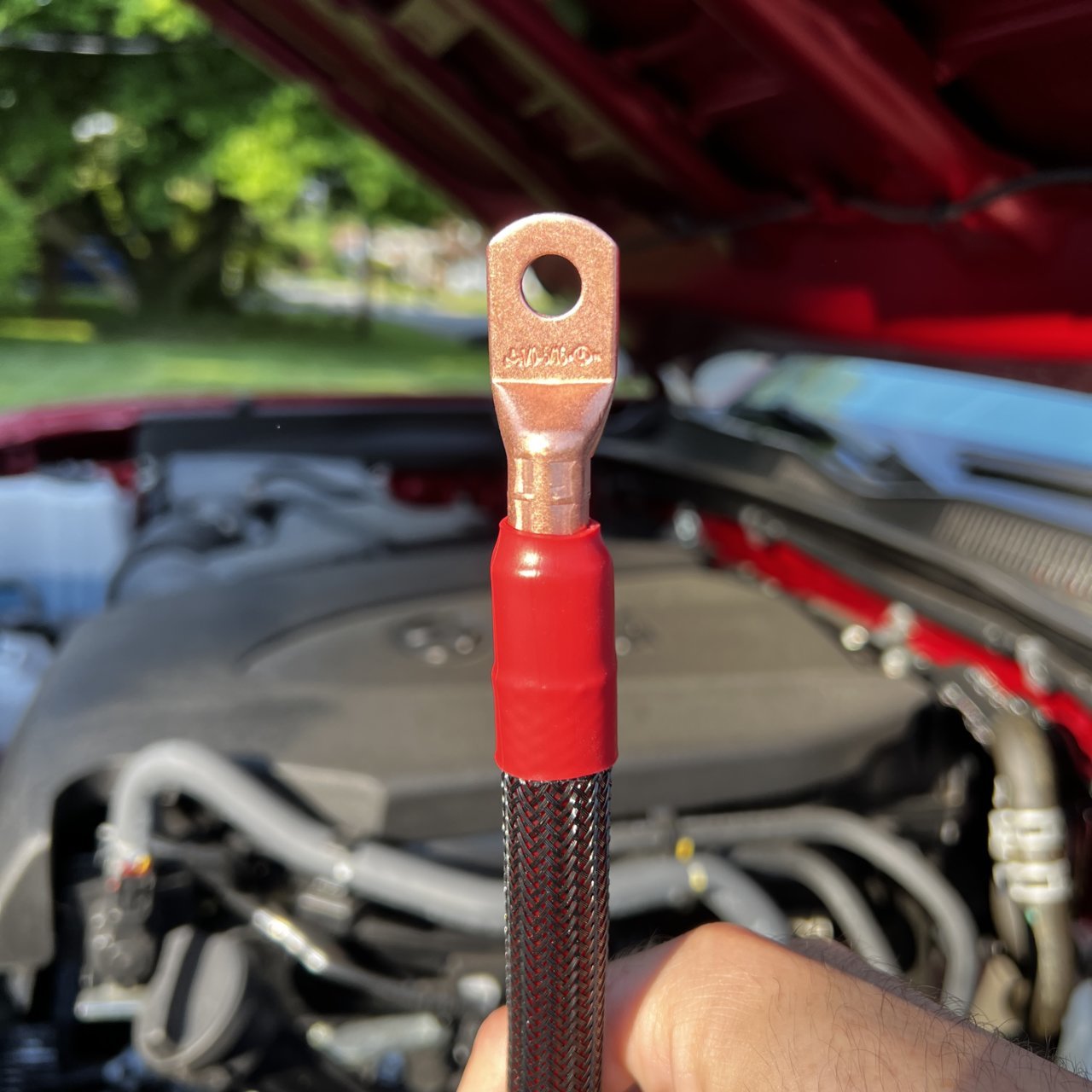

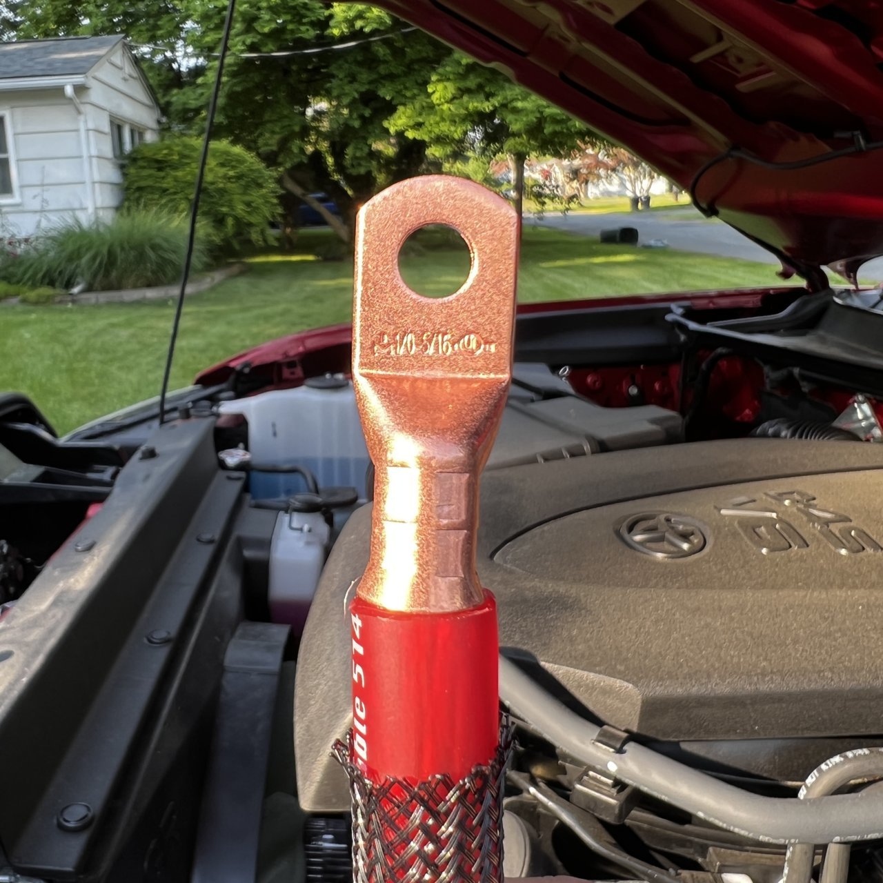

    Oo Mr fancy pants with real crimped lugs thinks their better than the rest of us who just use a sledge hammer and a rock.....
    *Yes I used a hammer and a rock the first time, second time I used a blow torch and some solder.

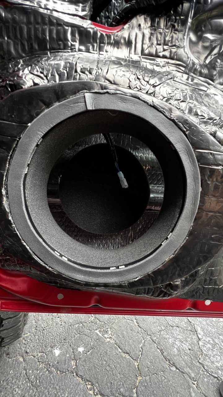

    "No Prep" laughs in Rapid Remover.

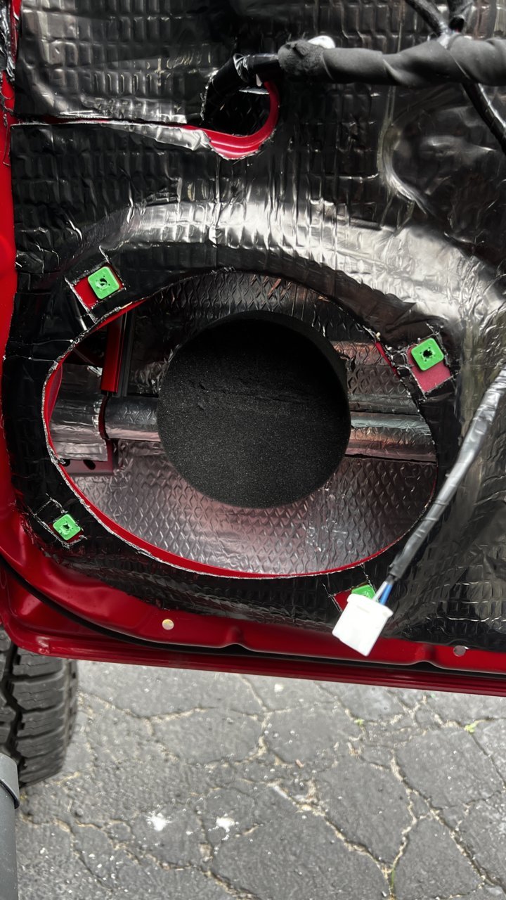

    Do you have Dynamat or something similar to go in the doors? It changes everything.
    Those speaker rings make a notable difference in your mids.

    Stinger RKFR6 fast rings kit (will replace later with closed cell foam)
    SoundSkins ring kit
    Low-Density PVC Foam Tape, 1/8"x1/2"
    Siless Liner 157 mil (4mm) sound deadening
    Siless Black 80 mil (2mm) sound deadening
    Noico 80 mil (2 mm) sound deadening
    More pics on page 2
    GRNT4R and Taco 422[QUOTED] like this.

    I scrolled right past that somehow.
    Awesome build, I hope it's pleasing to the ear as you progress.

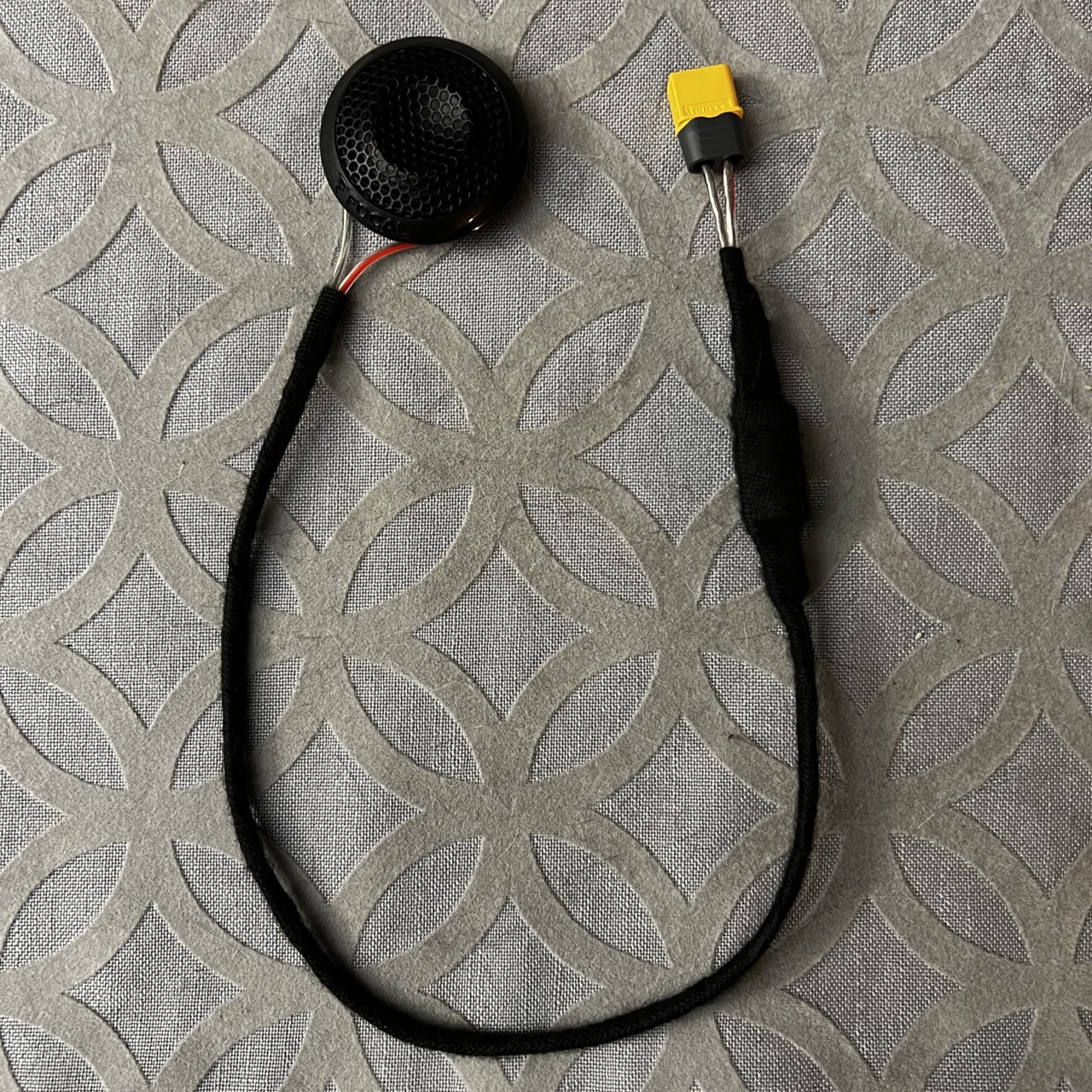

    Tonight I got 1 tweeter wired up. Gotta get soldering arms though, trying to solder without them is a PITA. 22uF cap in line. Took me quite a bit of research to determine what uF to use on these. The video from Mark at Car Audio Fabrication was super helpful.

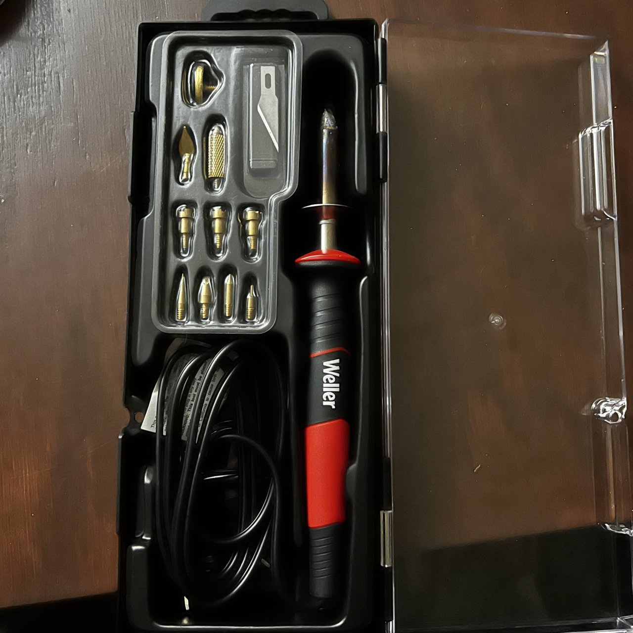

    Which soldering iron and solder are you using? I need a new one and I need more soldering practice.

    Got this one from Home Depot but if I did it again I’d get a better one with an adjustable temp and stand for it. The Ryobi looks nice.
