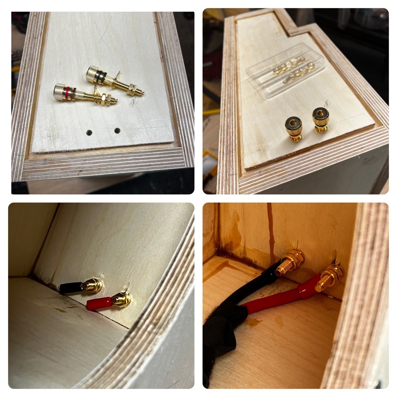

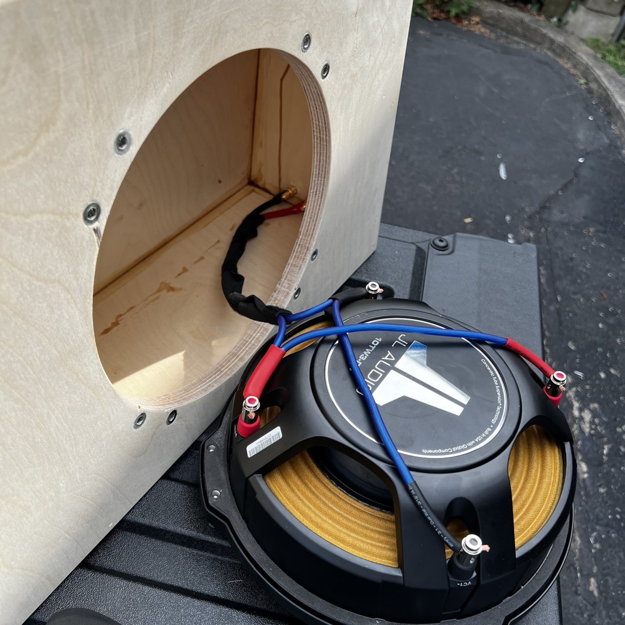

    Those look like the dayton audio binding posts.
    If so, they are solid. Shouldn't be a problem

    Yeah, they are the Dayton ones.

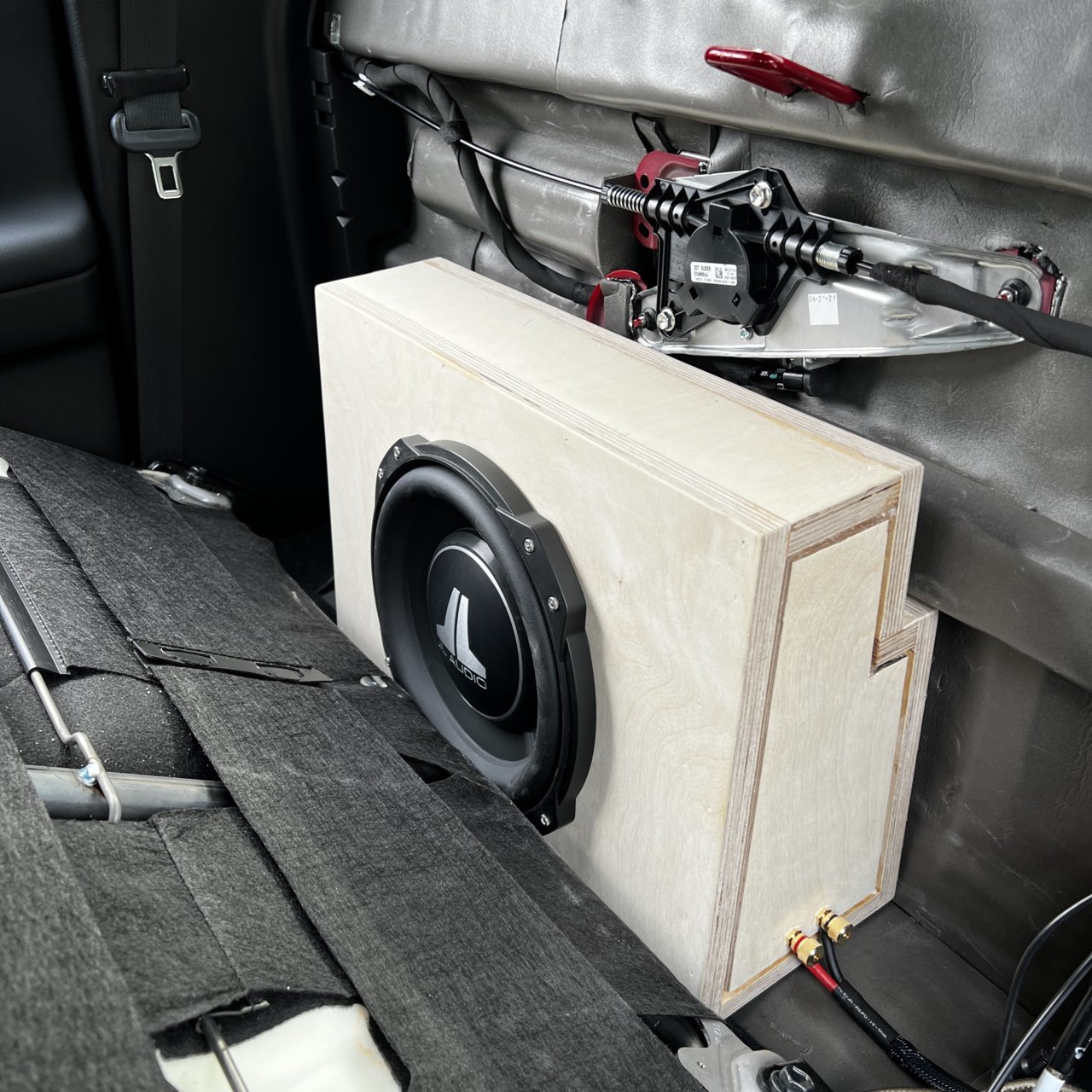

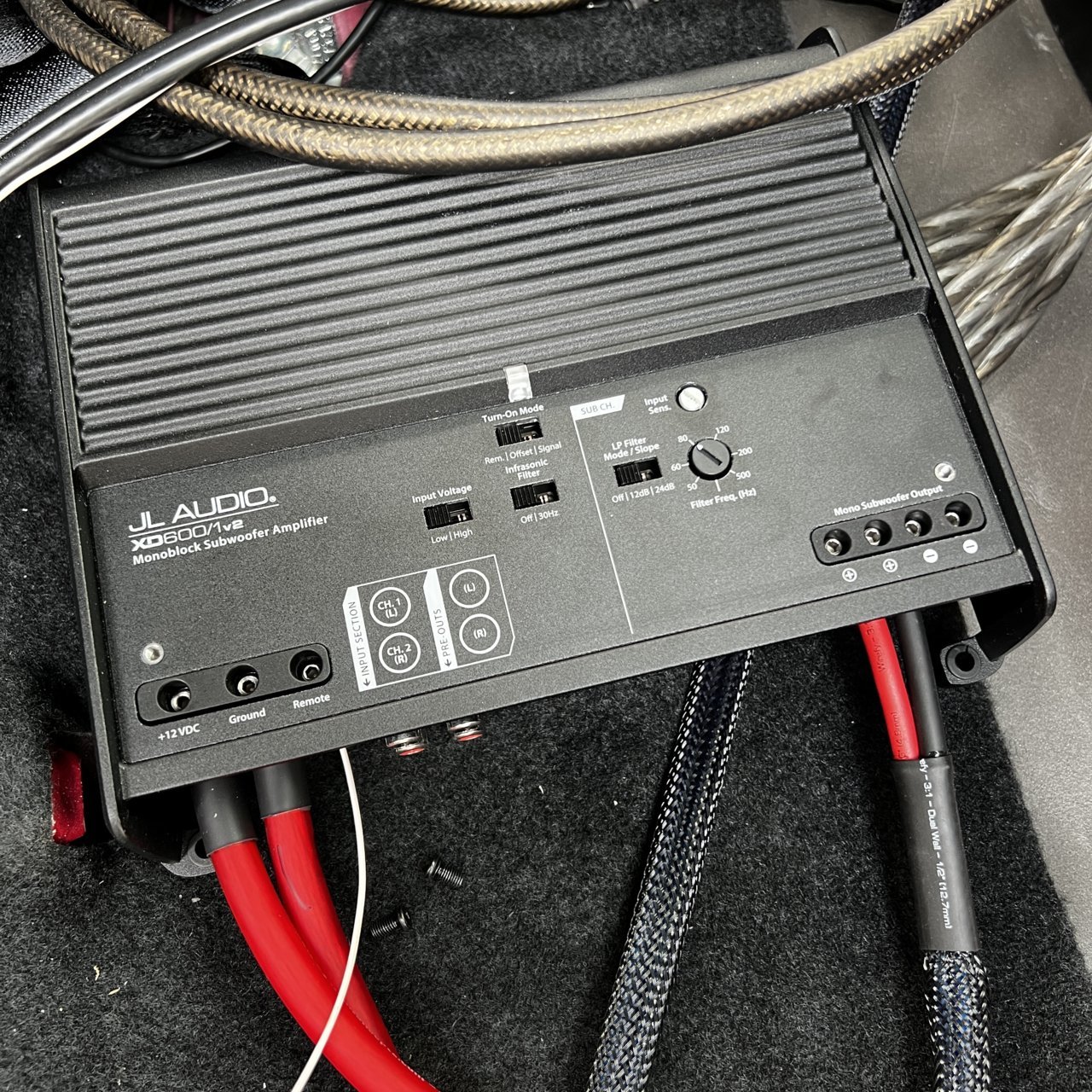

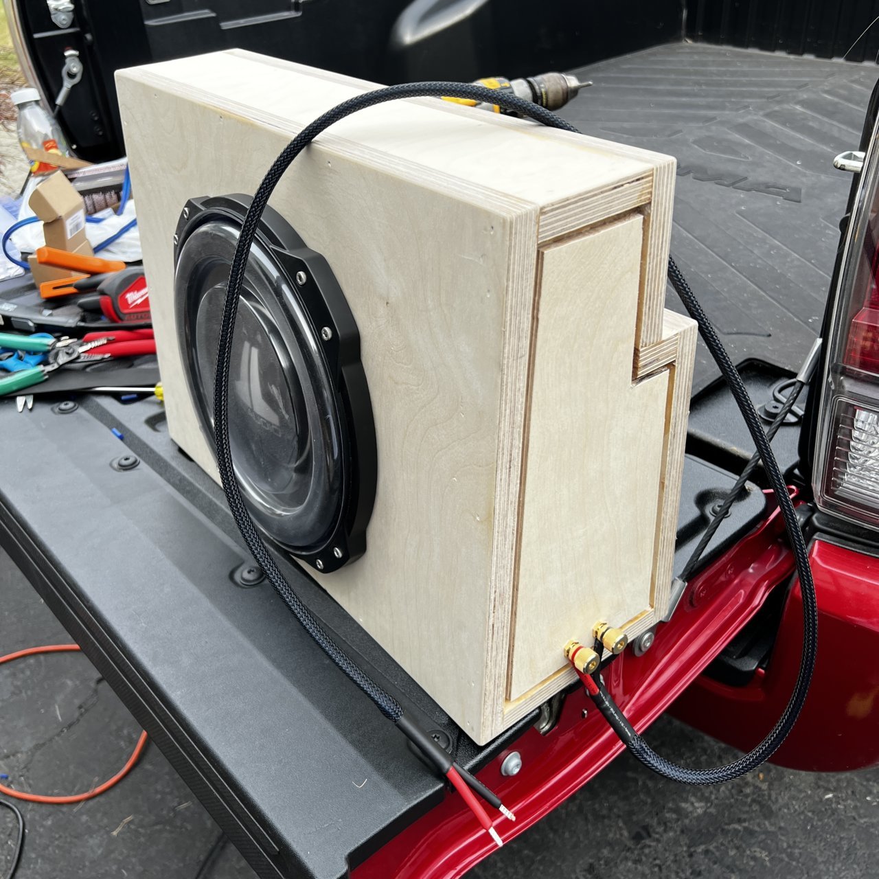

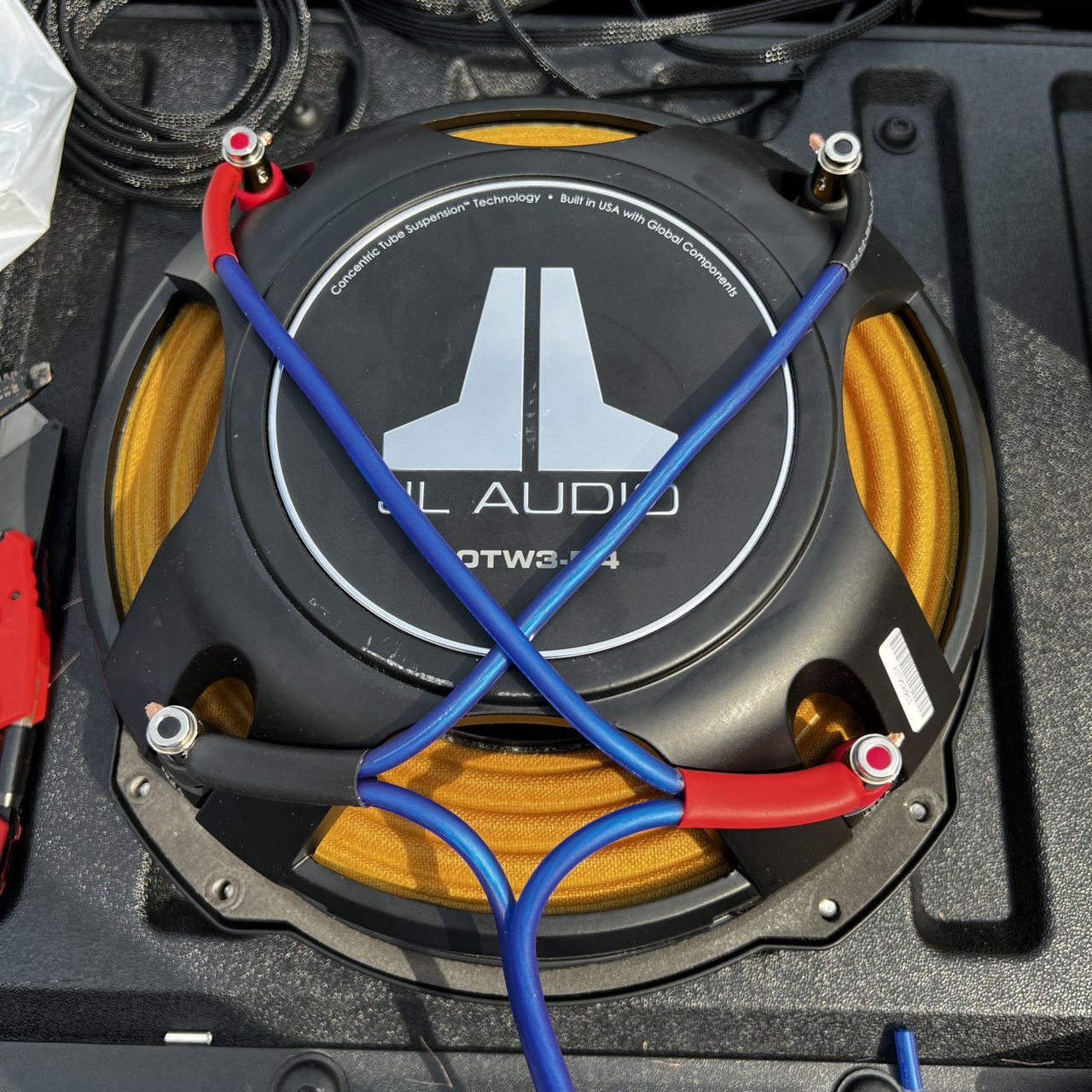

    Got the box at 90% today. Only thing left is the carpet and secure it. I’m going to test it a while before then though. With windows down it sounds pretty good but windows up it suffers pretty bad. I’m going to build a ported box next. It’s running off a JL XD600/1 @ 2ohms.

    Ditto. This is my first sealed box. I’ve always had ported boxes. Now that I know I have room for one that’ll be next.

    i highly recommend some fiberglass/rockwool insulation in the box to line the walls to dampen some of the internal resonances. i don't do polyfil, it doesn't have the same thermal conversion characteristics.
    all of my past boxes were way too boomy without some sort of internal dampening.
    https://www.avsforum.com/threads/polyfill-vs-egg-crate-foam-vs-fiberglass-insolation.1018700/
    note, i'm not implying it will make up the difference between sealed/ported, only that, when properly done, it will definitely improve the response characteristics of the sealed box.

    just try to line the box walls with it. if you can pull the insulation into thinner sheets, usually about 1"-ish thick is plenty good. but jamming a big hunk of it in will have the opposite effect!

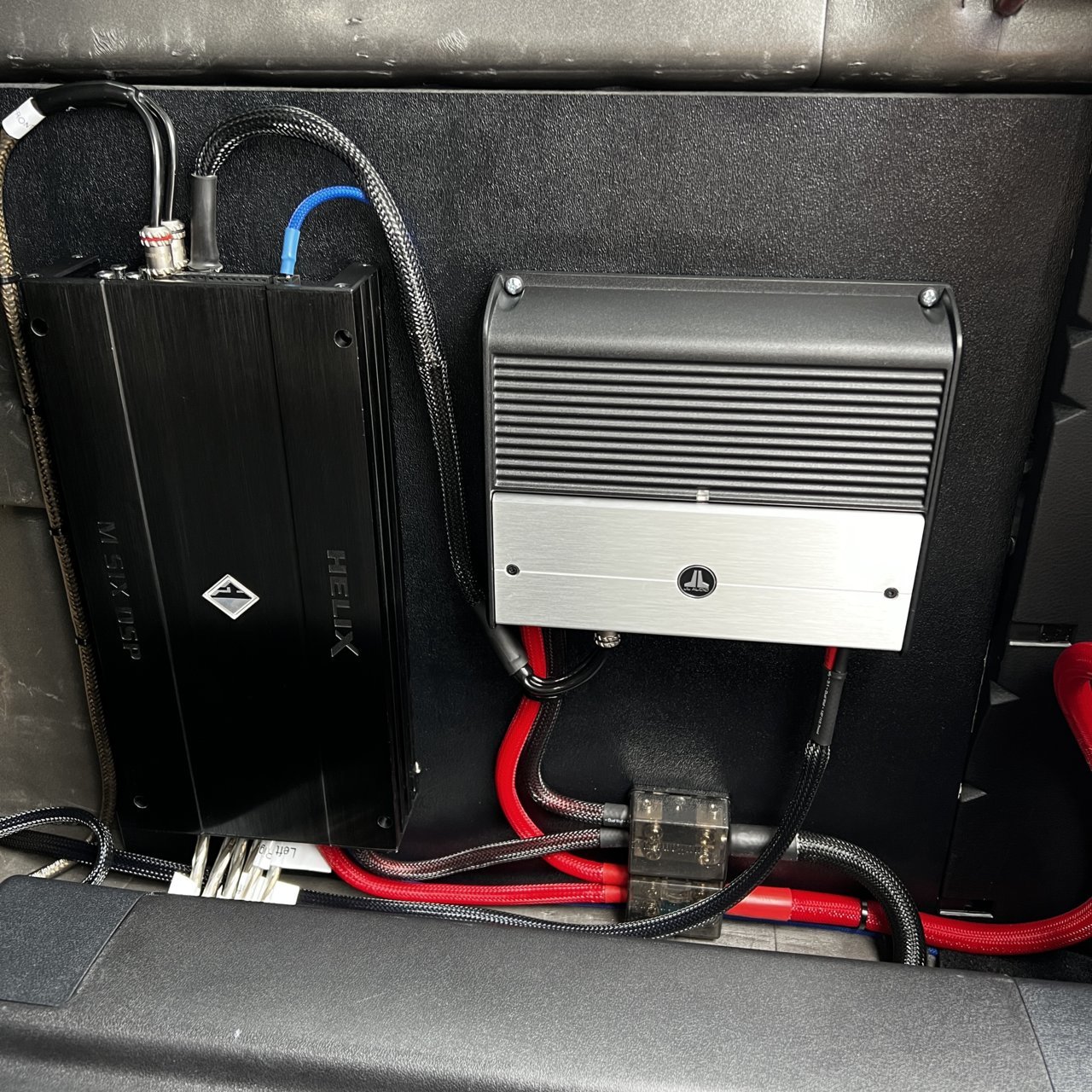

    Small update. Reconfigured the amp layout. Moved the tweeters from the sails to the stock location in the dash. Still needs to do a few more things but for the most part I'm done until I get a good DSP tune.

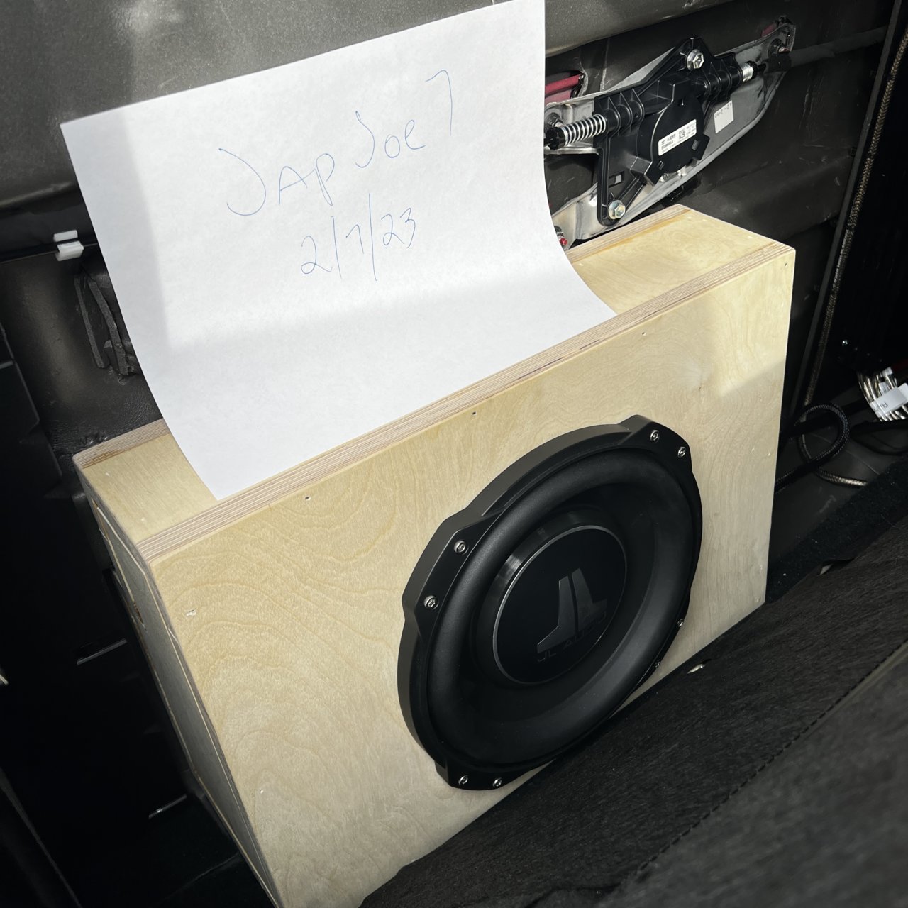

    Got the audio itch and now I want to try something different already. Have only had this a few months. Well maintained and taken care of. A beast and will shake the mirrors.
    3/4" Baltic Birch
    Sealed box volume: 0.51 cubic feet per sealed spec
    I have carpet and spray adheasive as well that I can include free if you want it.
    $500 shipped, buyer pays PP fees

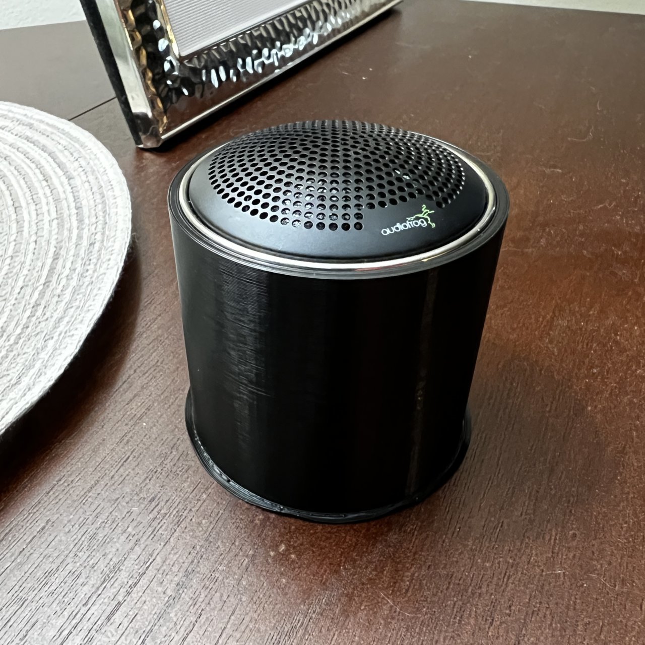

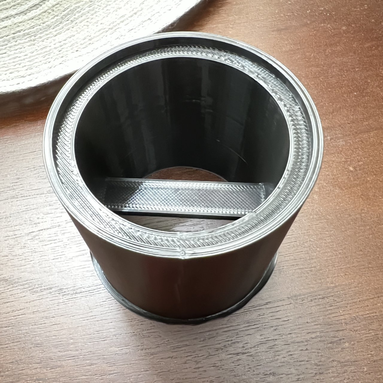

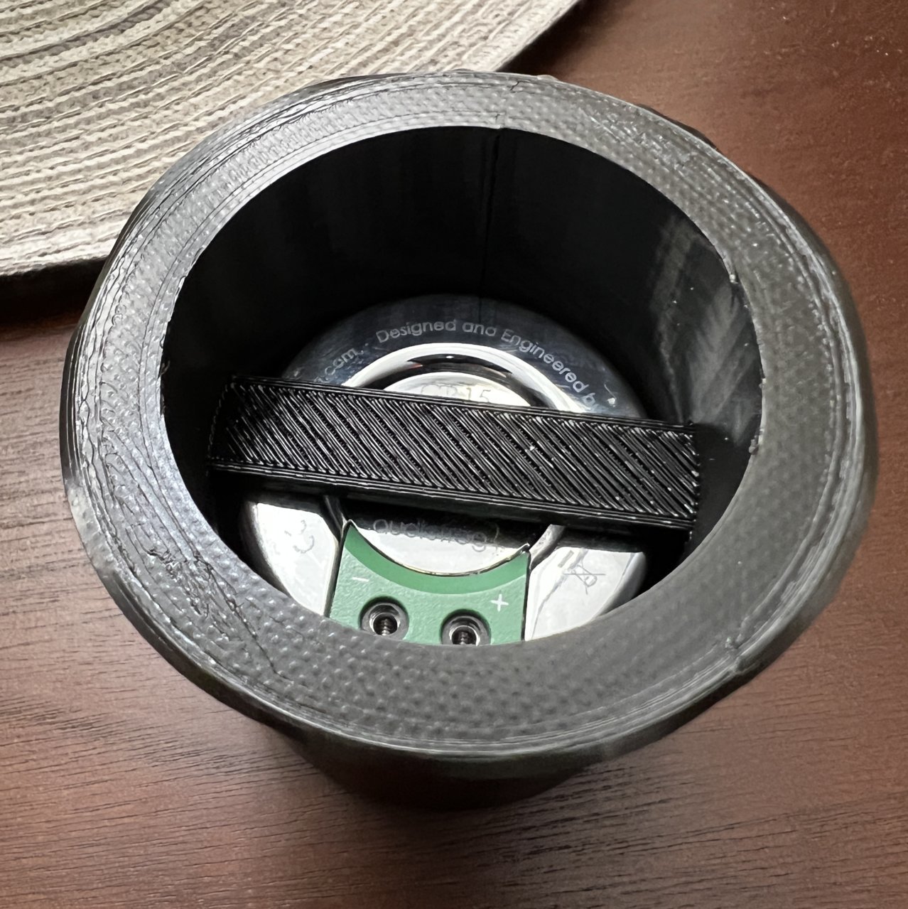

    Welp, caught the bug and couldn’t leave well enough alone. I’m going to build sails for GB15’s. I’ve been collecting all materials and 3D printing mounts. I’ll add my list of materials and where I bought everything shorty. I'm a Patreon member for Peter and am trying to follow Marks video for the sails build, Tweeters MOLDED into Sail Panel! - PERFECT OEM LOOK
    Here's the 3D printed mount I think I'm settled on. Created in Fusion 360 and sliced in Cura.
