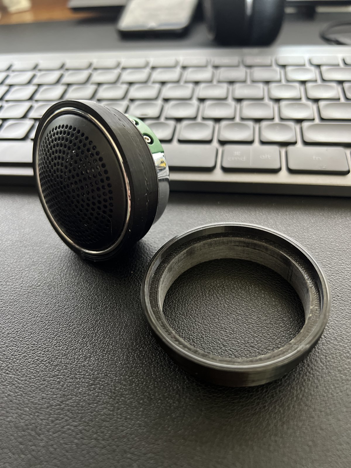

    instead of the kittyhair, i would recommend the fibertech instead.
    kitty hair is a longer strand courser fiberglass filler, where the fibertech is more of a smoother body filler with small reinforcing pieces of fiberglass for strength. it will sand a lot smoother and allow you to go straight to the finish filler like easy sand, instead of using the rage gold as a middling step.
    kittyhair is great for structural projects, but tweeters pods are hardly structural ;)

    I had contemplated this before I purchased but wasn't completely sure what I needed. I may not need it anyway but I'll use it if I need to. I don't want to spend any more money since I already have the kitty hair. Although, I've already changed my mind on the mount and am thinking of using a different structure.

    I didn't build an angle into the 3D mount. I used popsicle sticks glued in to the 3D ring to make the angle and then filled it will body filler.
