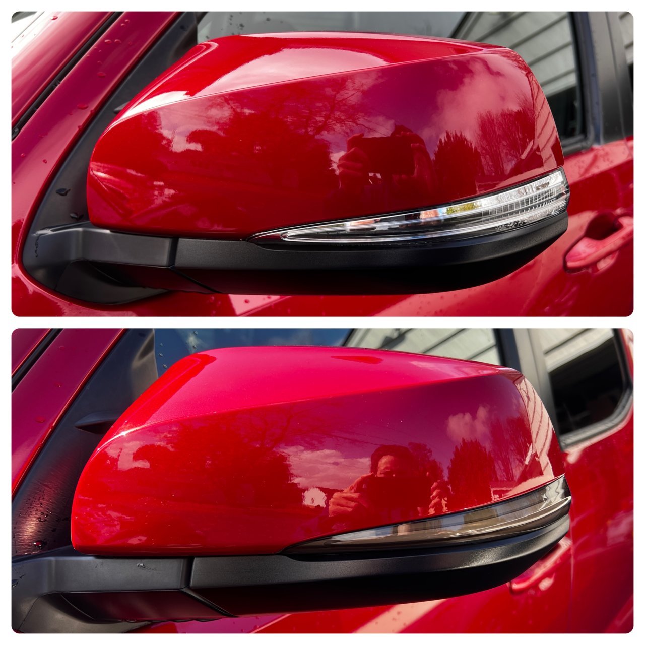

    10.30.21
    Rep TRD Pro Grill and side markers

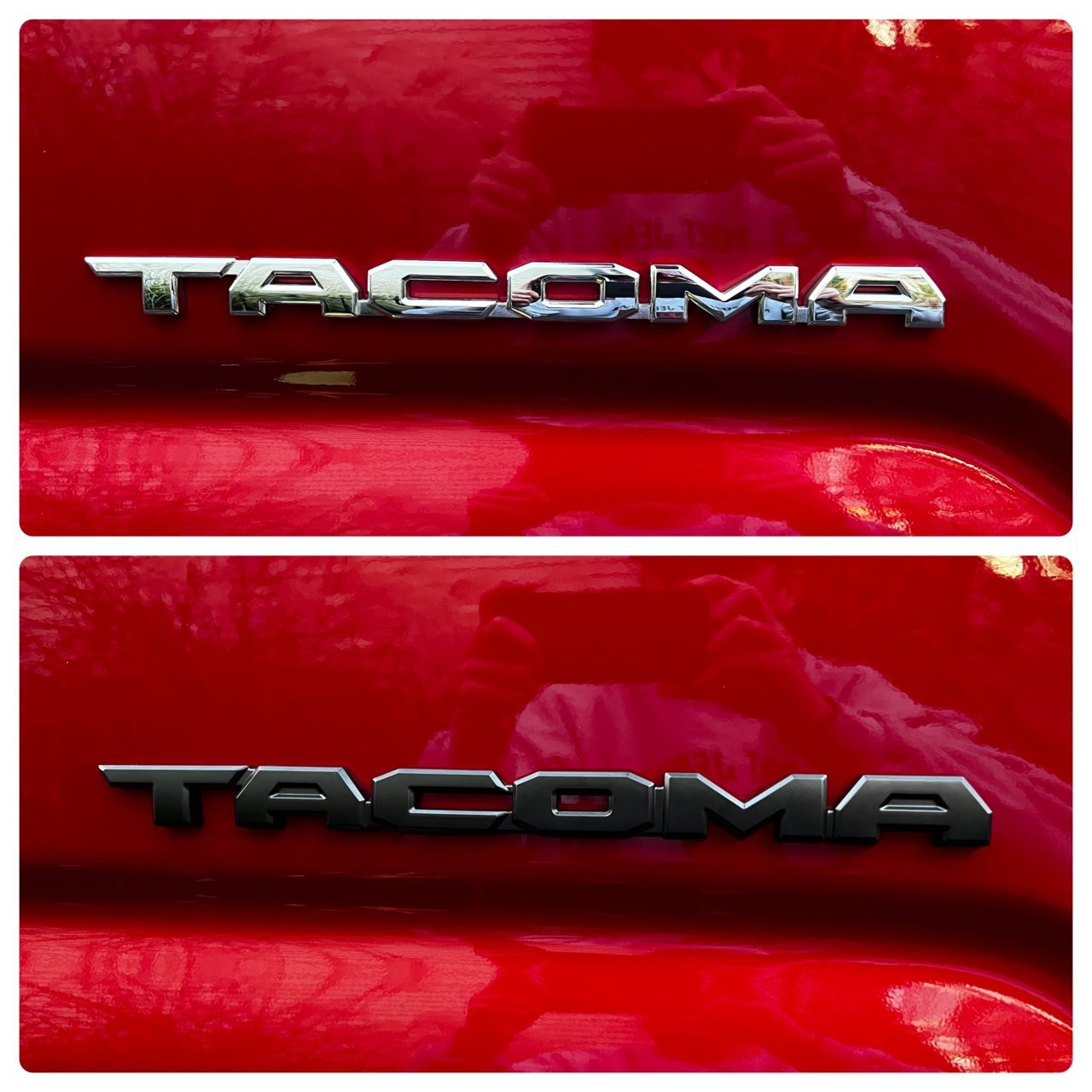

    eBay black emblem overlay. Perfect fitment. I honestly can’t see spending $100+ on OEM overlays when these fit perfect for $40.

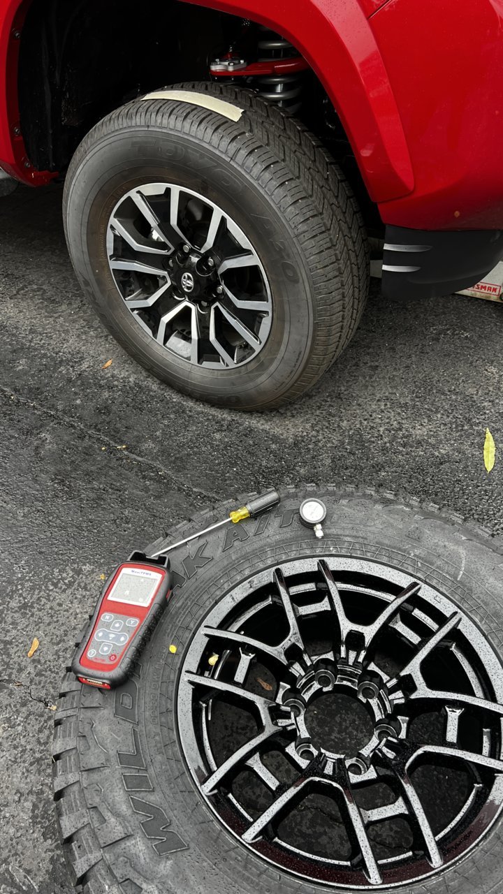

    Wheels mounted, road force balanced, ceramic coated wheels, and TPMS programming

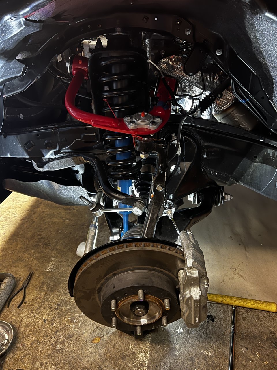

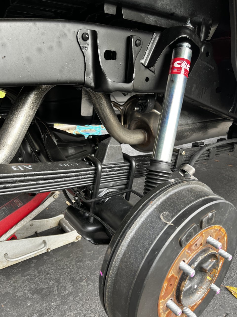

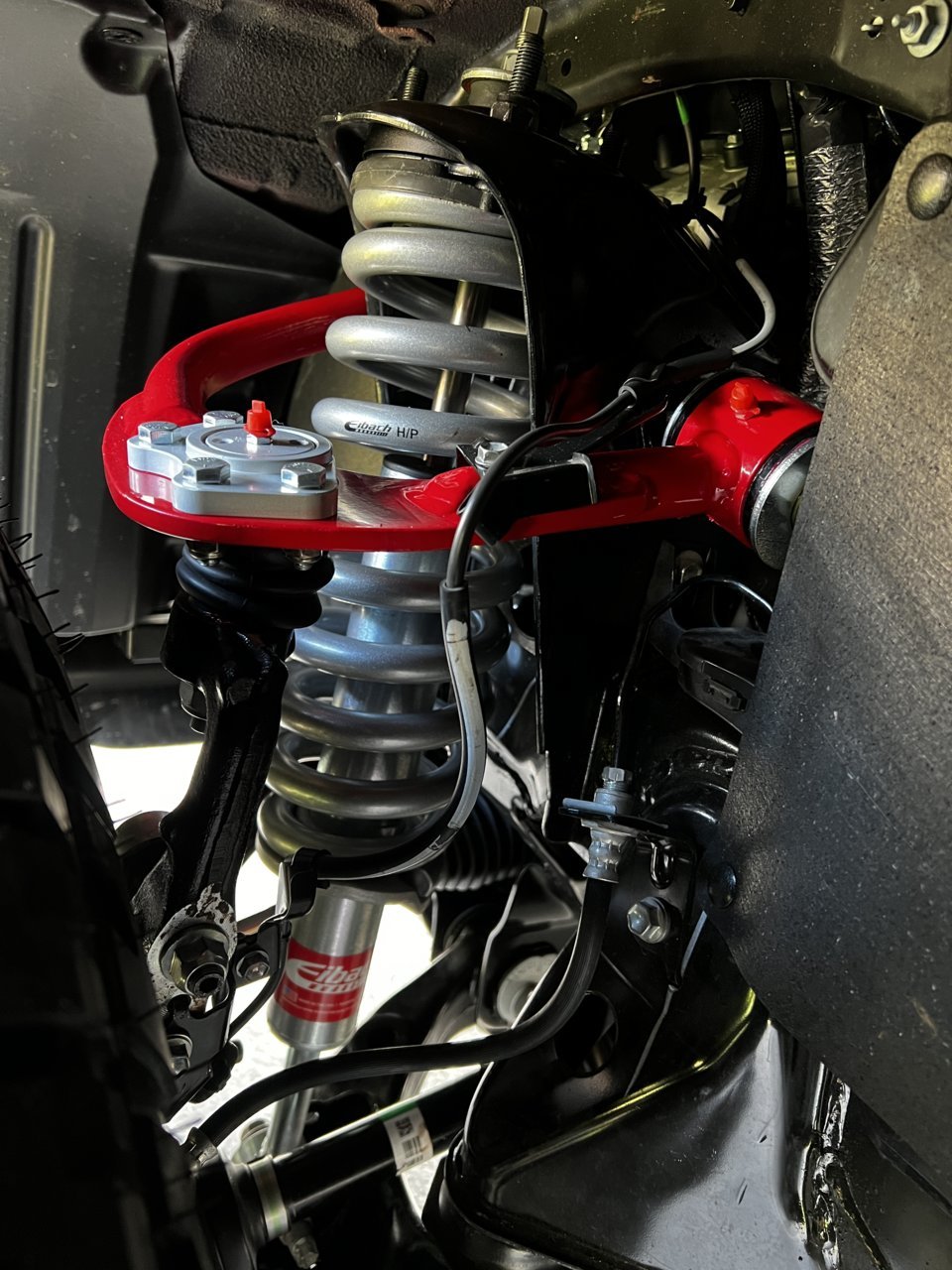

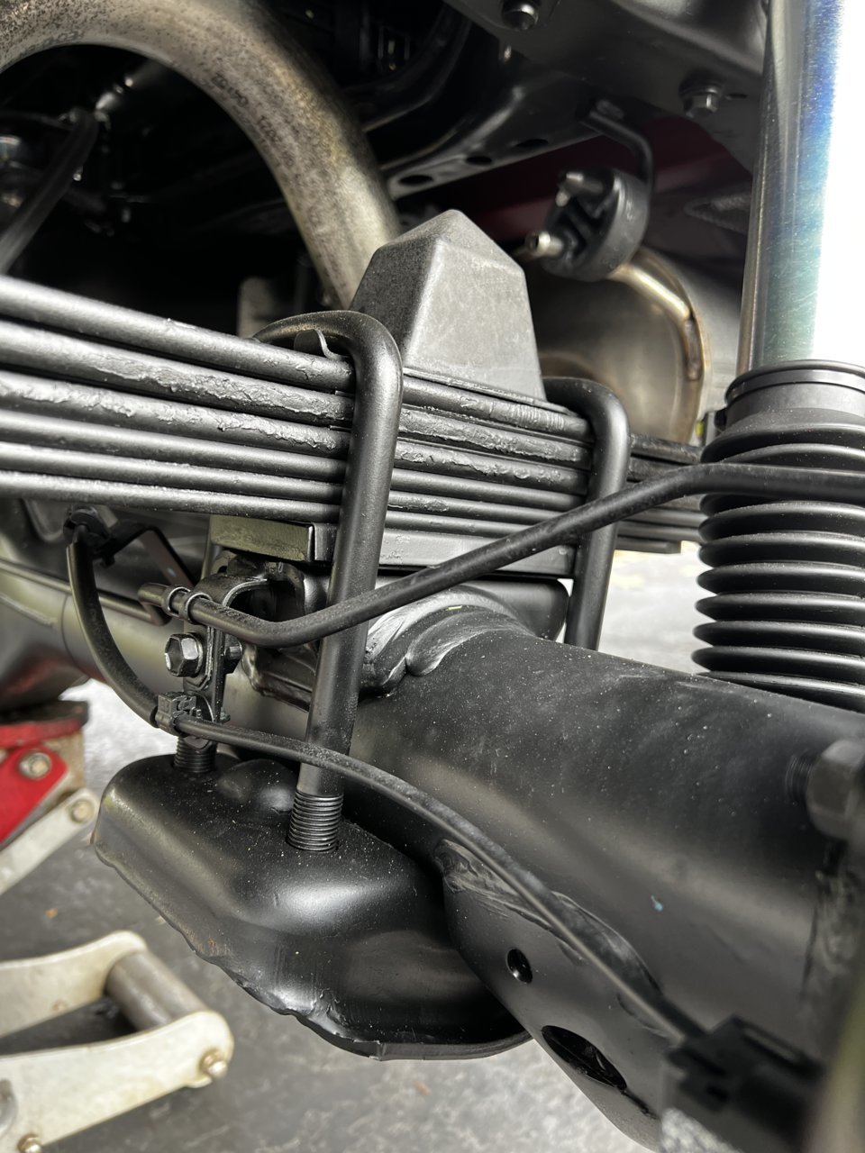

    Replaced needle bearing w/ ECGS bearing, installed Eibach lift kit (1st clip) w/ Icon AAL, removed overload, .5" rear blocks, 1/4" spacer on right front / 1/2" spacer on front left, sway bar spacer, and JBA high caster upper control arms.

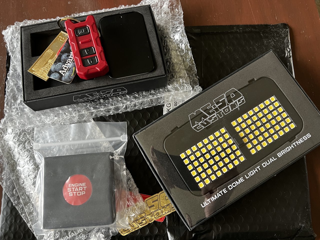

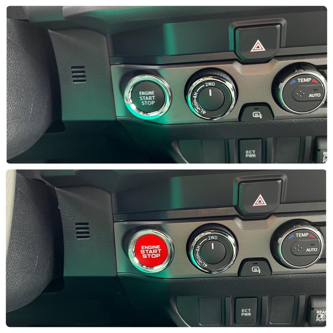

    Meso customs minimalist key fob, dual brightness dome light, red PTS button

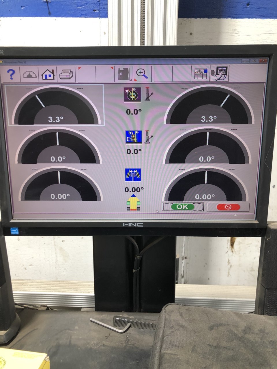

    first alignment after lift

    I've got the infamous clunk coming from the left front after putting in the lift. All bolts are torqued to spec twice and I don't see my sway bar end link hitting the spring. I did pinch the outer tie rod boot removing it and lost a lot of grease but I don't think the clunk is coming from that. I'll replace the tie rod with another OEM one soon. Didn't get an alignment yet, will wait a few weeks for the lift to settle. The clunk will happen over a medium to large bump no matter straight or turning.
    Got some video of the clunk, https://youtu.be/W4mdGvUJjfY I've checked all bolts and everything is torqued to spec. No rubbing from sway bar and spring. It only started after I installed the lift and only on the left side. Gunna check the cab mount bushing, radiator mount bushing, and skid plate next.
    EDIT - 10/29/22 Welp, found where the clunk was coming from after doing my first oil change, it was the skid plate. After removing it and re-installing it after the oil change the clunk has went away. God damn!

    Any paint missing on the springs? I forgot to put the swaybar relocation bracket on when I first installed my coilovers and I noticed the clunk immediately when test driving it around the parking lot.

    Actually, there is some missing. I’ll have to see if I can match it to end link bolt.

    Been a few weeks since the lift has been installed. Been driving ok but could tell alignment was off. I wanted to let it settle before getting an alignment. Shop did exactly what I wanted them to do.

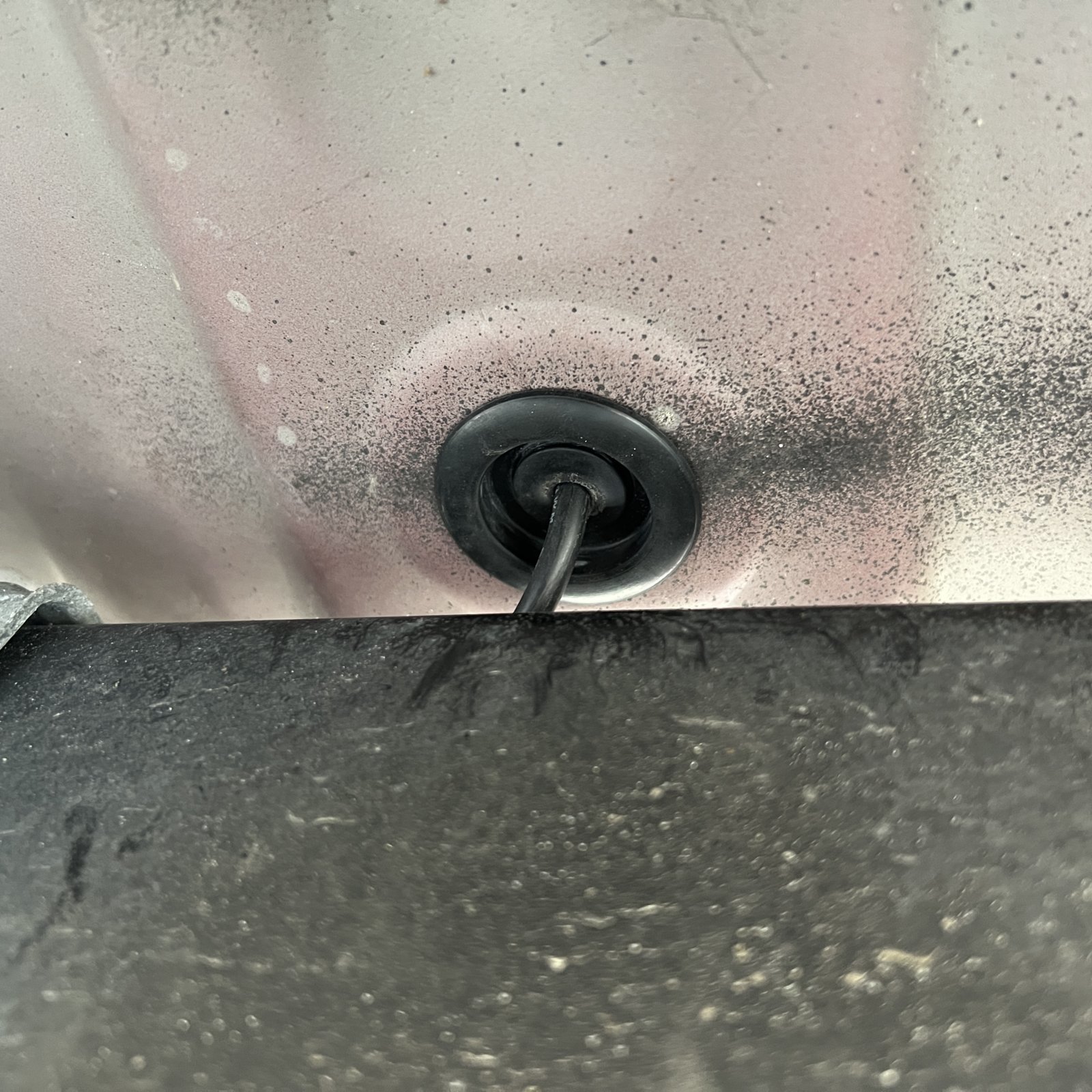

    03.17.2024
    Finally put in the pop-n-lock. Pretty easy, a little annoying running the wire. I have a set of hole punches so I made a super clean, snug hole in the grommet to run the wire through.
