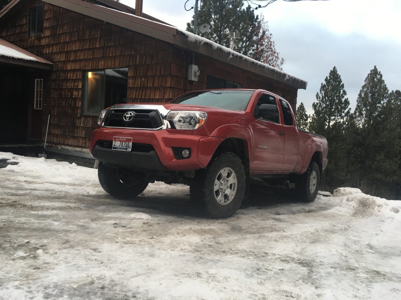

    How she sits today
    02/24/2020
    Purchased a 2015 access cab TRD V6 6 speed in December of 2019 with 25,000 miles on it to alleviate the daily driver duties of my beloved ‘04 while it’s being built up. Also wanted a daily driver I can escape to the mountains with. Check out my first gen build page!

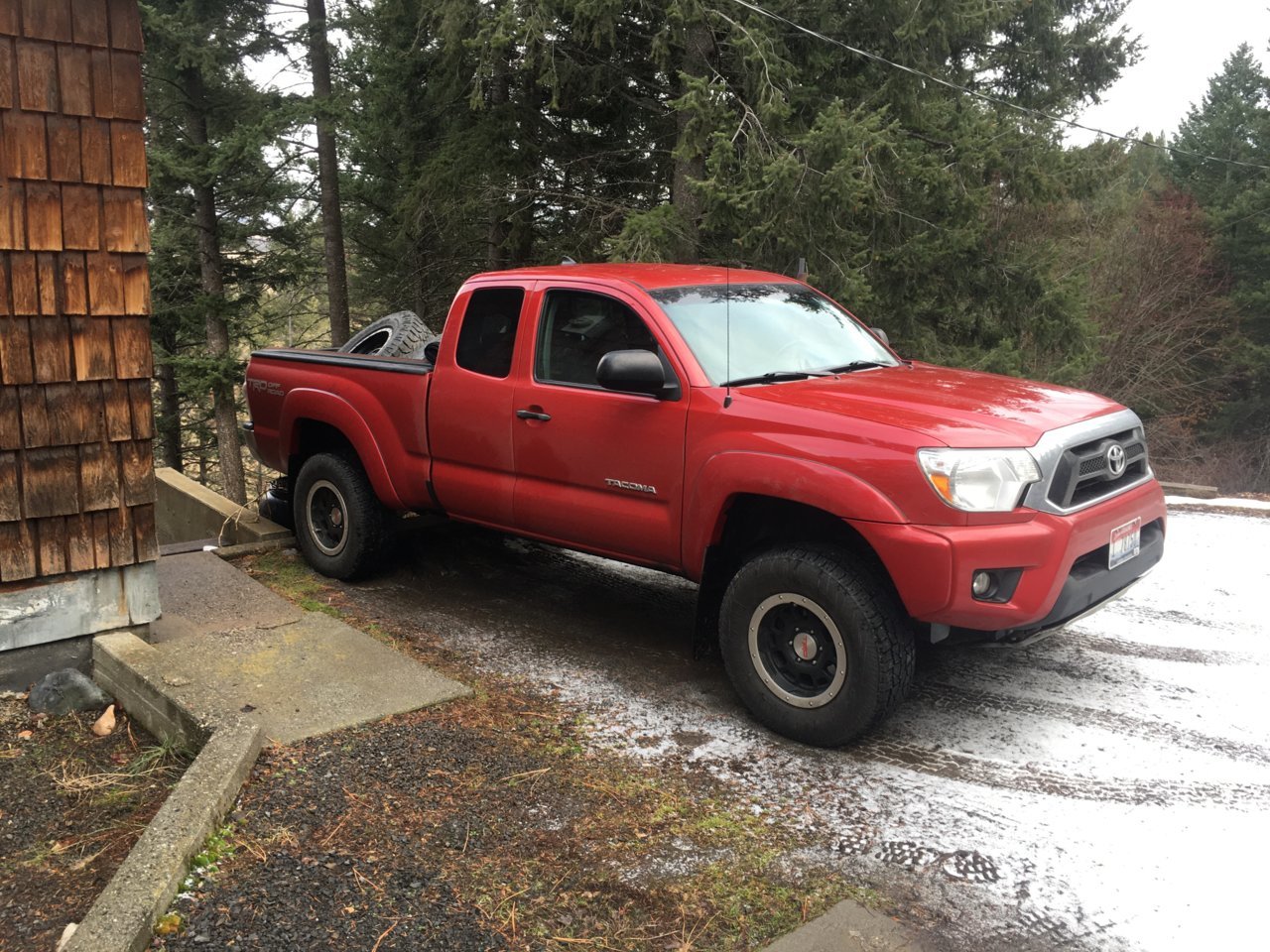

    Here it is a couple of days after I picked it up with a set of used beadlocks and 285/70/17s for my first gen in the bed!
    12/11/2019
    The thing that almost made me walk away from this pickup was the rubber undercoating that was sprayed on it and that it obviously came from a salt region. (Was originally sold in Canada)
    Didn’t notice it on the test drive, probably because of the shitty roads in Spokane, but the steering wheel had an intermittent shake to it at highway speeds. Would come and go without rhyme or reason. Steering also felt really loose. Like driving an old Cadillac. Everything up front felt tight, but the bushings seemed really weathered for their age, so I decided to put poly bushings in and get to work on removing the rubber undercoating. Before I did tear it apart, I took my wheels and tires from my ‘04 and put them on the ‘15. Went for a drive and no more shake... the old tires looked very new, the old wheels looked very new, so I’m not sure what the hell. Found a tire shop envelope in the glove box with a warranty form, but no invoice or anything giving an indication to the milage on the tires. Maybe a separating tire? Kinda hesitant to sell them to someone if that was the cause of the shake.
    Here it is with the 1st gen wheels and tires on it

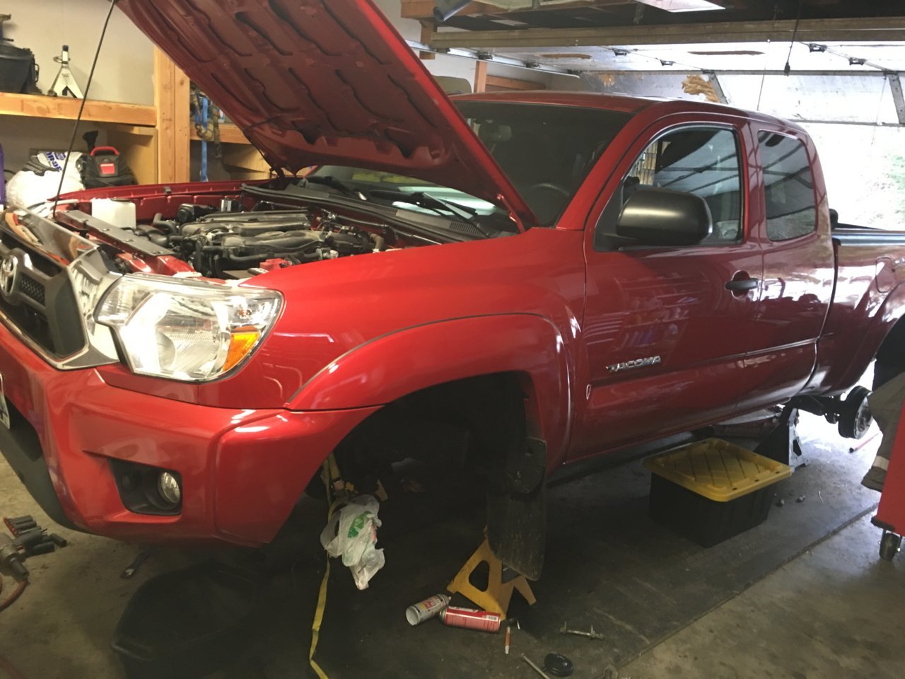

    and the front end all tore apart for bushings/undercoat removal and repainting:
    12/20/2019

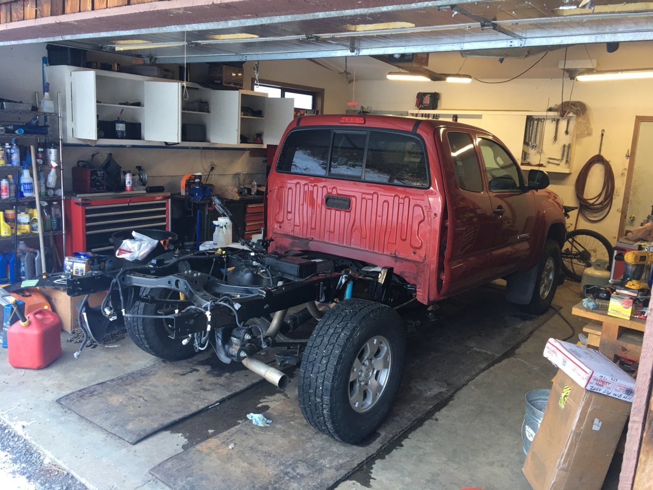

    I tried all sorts of shit to remove the undercoating. Started with a heat gun and a scraper, a flap disc on a 4” grinder, roloc scotchbrite pads on a die grinder..... finally found that very liberally spraying diesel on it with a spray bottle over the course of a couple of days and then scraping it with a plastic putty knife and then scrubbing it with a kitchen dish scrubber was the best/fastest/least amount of impact to the frame. Very messy though. Having recently done them on my ‘04, the bushings were easy minus the steering rack. I did manage to get it out without having to completely take out the ac compressor, but it took a lot of finagling and a lifetime’s worth of swear words. I did cut the UCA through bolts and put new ones in backwards. I couldn’t stand the idea of bending the hell out of my pretty fender with a set of channel locks.
    Went back to work on the east coast Jan 3 for 30 days, so the project sat idle with the front end work completed and paint done under the front fenders. The rest of the painting and undercoat removing would have to wait until I got back from work in February.
    02/20/2020
    About ready to put the bumper back on, and the bed. Just have a little touch up paint to do and I’ll let it sit most of the day before I pull it outside to put the bed on.

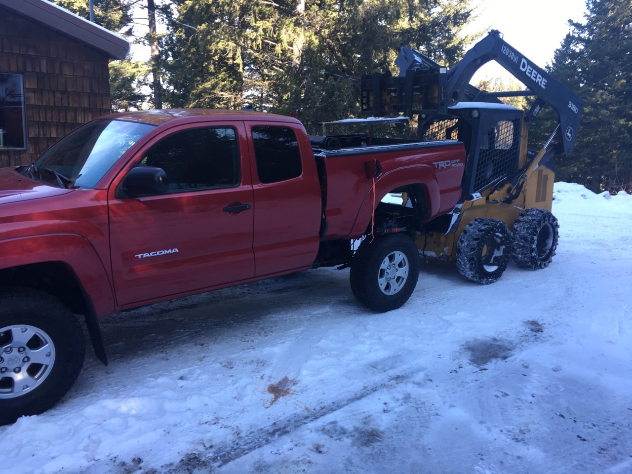

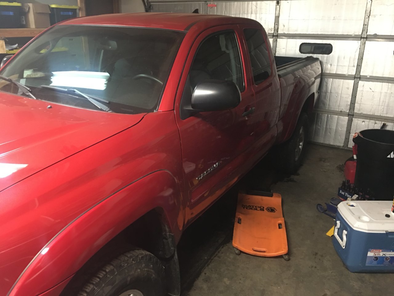

    Tried to put the bed back on by myself.... messed with it for 20 minutes or so before I decided it wasn’t worth it. 8BAE1EE8-A04B-459F-8053-E305181D03F9.jpg056A0811-190B-403F-9D35-2289941DA878.jpg
    didn’t work out too well. Had to wait for someone to run the skid steer.
    Ended up putting in my 2 low module from @Up2NoGood.
    Works great. Get them while they last!
    Finally got it back together once help arrived.EA0AD33E-C9AF-4606-9A9A-519626C34559.jpgalignment scheduled for tomorrow. Get the skid plates back on and then (hopefully) it’s time to drive it for a while.

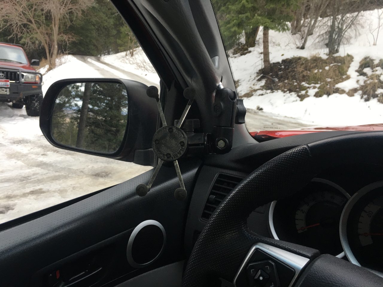

    Ordered a rammount motorcycle handlebar mount to ditch the suction cup I’ve been rocking for years in my vehicles and mount it to the a pillar. Looks like there are plenty of good write ups on it here on tacoma world. Going to order the same motorcycle mount to put in my ‘04 and another xgrip so I don’t have to change the one between vehicles. Looking into running designated power through the a pillar on both pickups too.
    This picture was the test fit. I pulled it off to spray paint the exposed silver metal black so it doesn’t catch your eye as well.

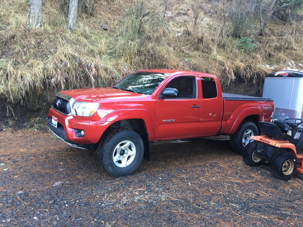

    Done a few little things to the girl in the past year. I’m going to be better about updating this as i should start working on it a little more.
    put a softopper on it Thanksgiving of 2020. I’ve been really loving that! 704FBE38-0CE8-4D1B-9377-B6126164F432.jpgD453681A-E670-4ED3-BE6F-002BA335E732.jpg
