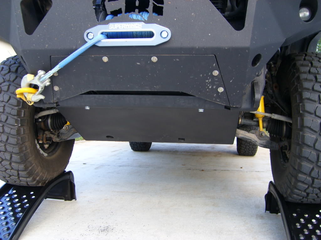

    I'm sure I'll make it eventually I'm just not sure I'll get to it before citrus. I've already got it cut out width wise I just need to figure out where to cut it across to accommodate the bend.

    How wide did you make your skid 19"?

    Put the 886's on the truck this afternoon. The truck sits about level now with ~.5" rake so when they settle and the skids are on it should have a little bit more rake.
    That would be like a thong for the truck. It's 31" all the way back.
    You can play some propaganda to scare the rocks into going into the ground more and thus have the effect of more clearance.
    Thanks. They'll actually be useful when they are on the truck.:eek: I'm going to pick up the bolts tomorrow so I've got my fingers crossed they are the right pitch.

    no width not length

    Yes, it's 31" across. I wanted it to cover up the alignment tabs and exhaust and everything. It's about 7' long.

    oh ok i think my lowers would contact the skid if i made mine 31' across

    If you made it 31' across you won't be going anywhere under the trucks power. :p
    It's close at full droop so with extended coilovers it may.

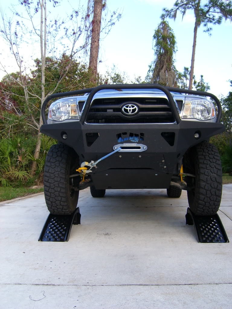

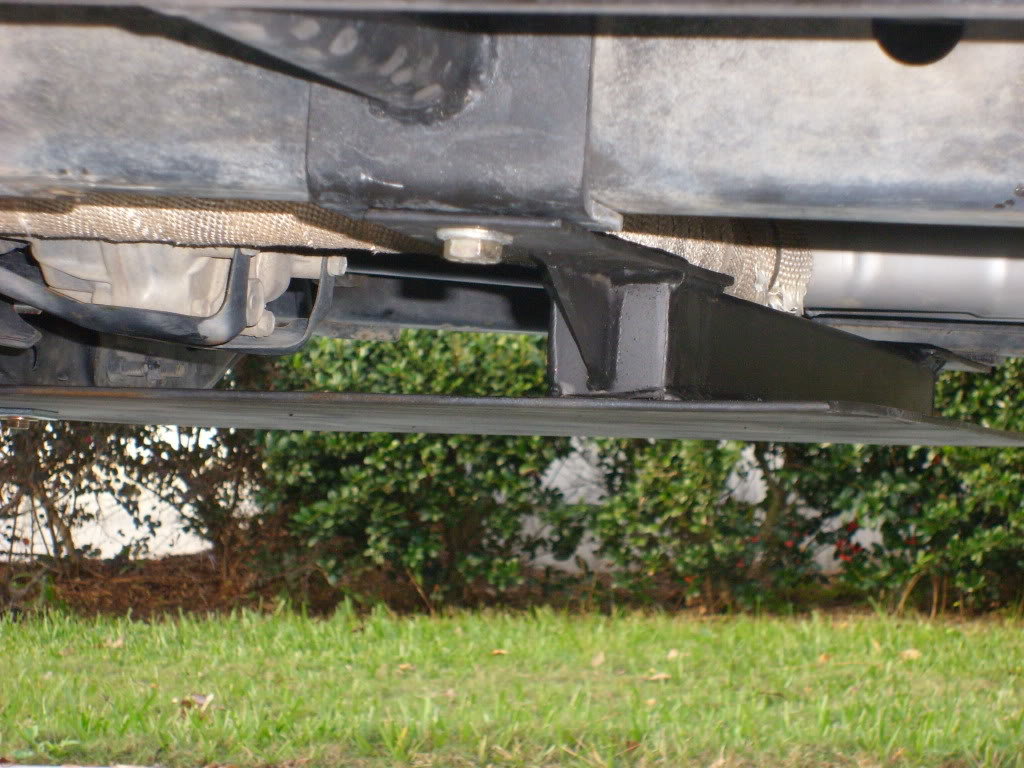

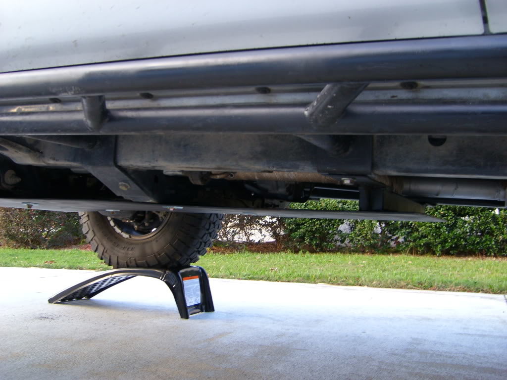

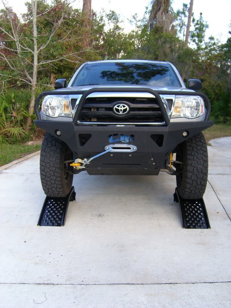

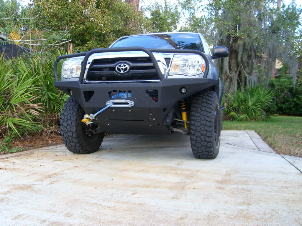

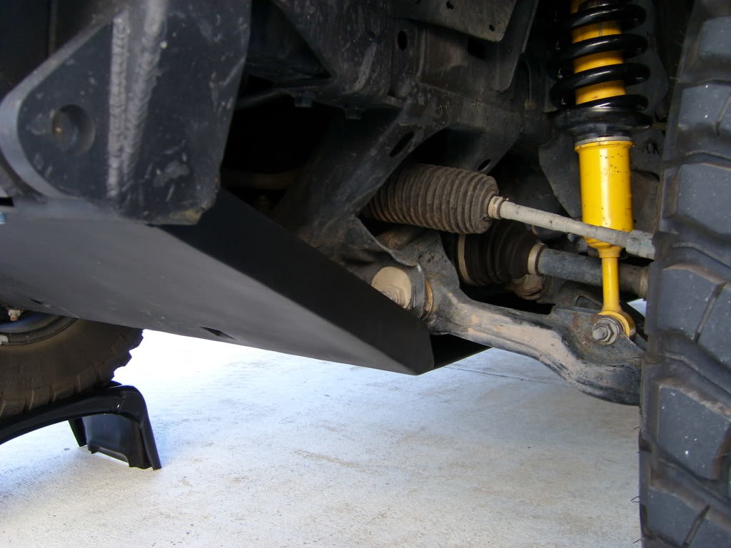

    I finally got the bolts in so I could mount the skid today. Picture dump warning!

    Damn fine work. Might I suggest kicking that last bit of plate up at an angle so you don't snag it on stuff in reverse. Very nice.

    Thanks! That's a great idea. I'll just nip that last bit off and angle it up eventually.

    just use a BFH

    Haha! That may work for somebody with 200 some odd pound behind the hammer but not so much for me.
